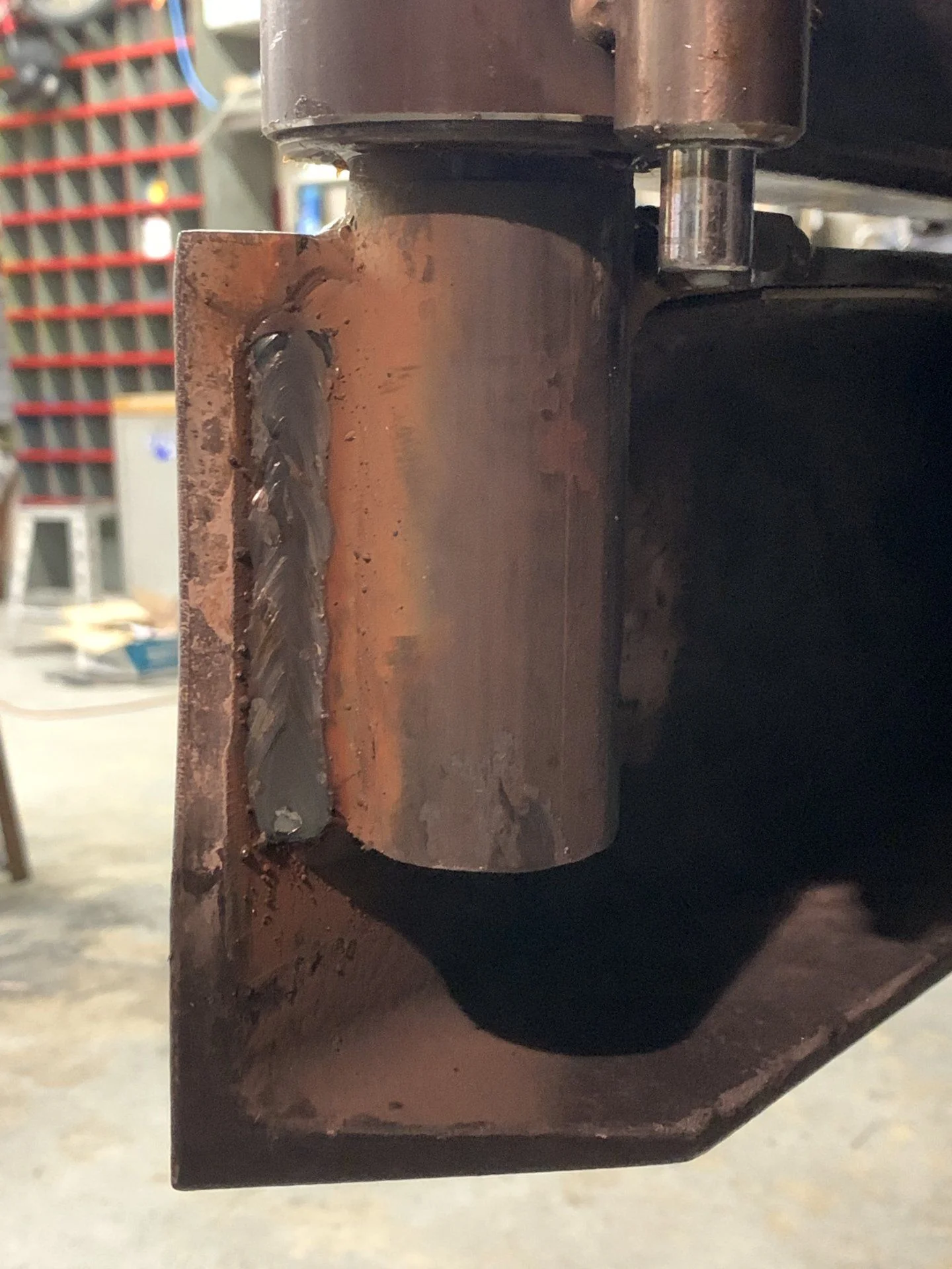

What kind of failure would you expect where it become a big issue? Do you think the spindle would shear off? I think that unlikely even on a cheap spindle. But then again, I've never seen or used on of these so my opinion isn't based on any knowledge. But that's par for the course around hereWhat happens if the cheap spindle fails on the roadway?
Thats not exact a part to cut a corner on in my opinion. It's a critical part to properly securing a heavy and large item.

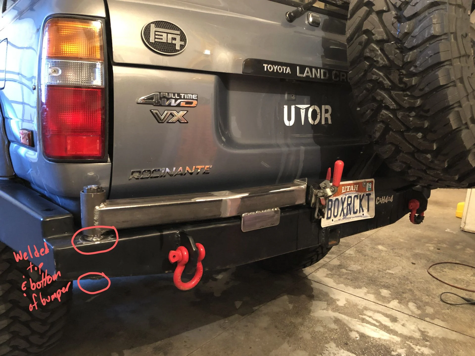

Spindles can definitely shear off. Seen a few over the years. Most definitely worth getting a quality spindle and one with an appropriate rating. Also makes a big difference if it's welded in a single shear or double shear design. Best option is to have the lower spindle welded near the top and bottom of the section below the bearing/hinge area, AND have a retaining tab at the top bearing cap. That is the most sturdy and least likely to shear the spindle.What kind of failure would you expect where it become a big issue? Do you think the spindle would shear off? I think that unlikely even on a cheap spindle. But then again, I've never seen or used on of these so my opinion isn't based on any knowledge. But that's par for the course around here
On mine I don't have a tab at the top bearing cap, but I have the lower spindle passing through the bumper top AND bottom and welded both ends. Next best method I guess for a spindle without a top retaining tab.
