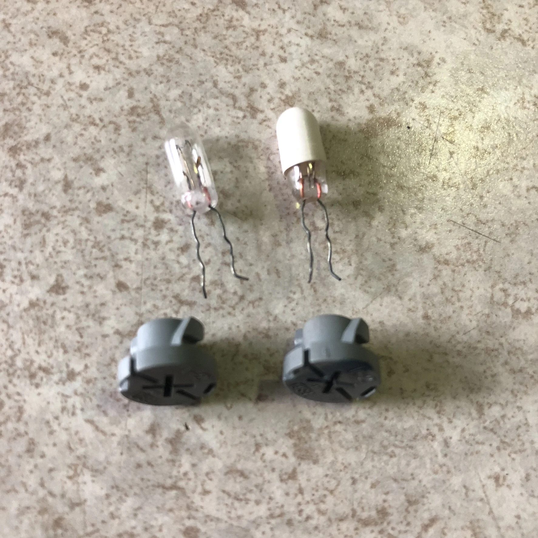

  • Remove Old Switches using a Flat Bladed Tool like a Skinny Straight Screwdriver
  • Twist out the Bulb Holders.
  • Using a Utility Knife or Tiny Screwdriver Undo the Wires from Bulb Holder

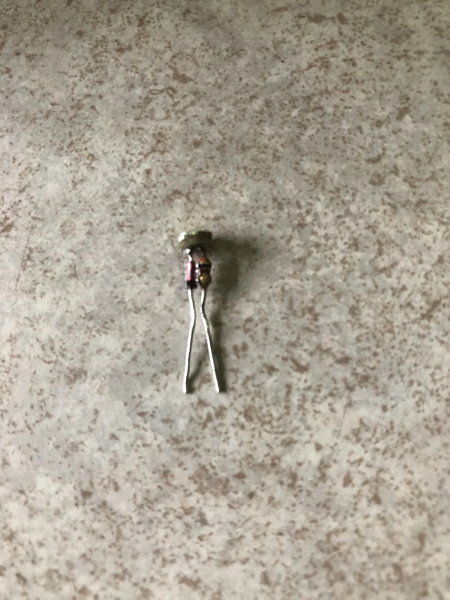

  • Remove Wires from New LEDS - Wires are Larger

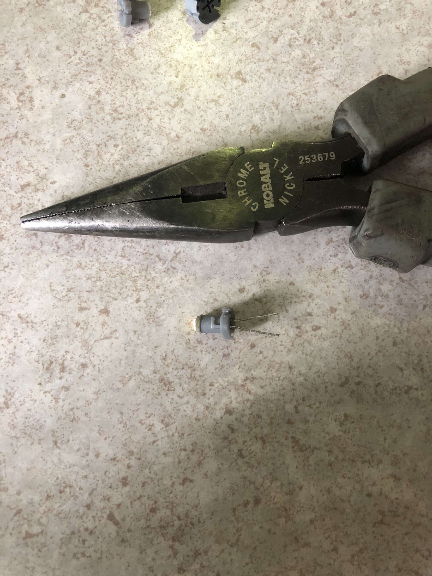

  • Straighten Using a Needle Nose Pliers and working in a Circle.
  • Using Thumbnail Seperate LED from Base.

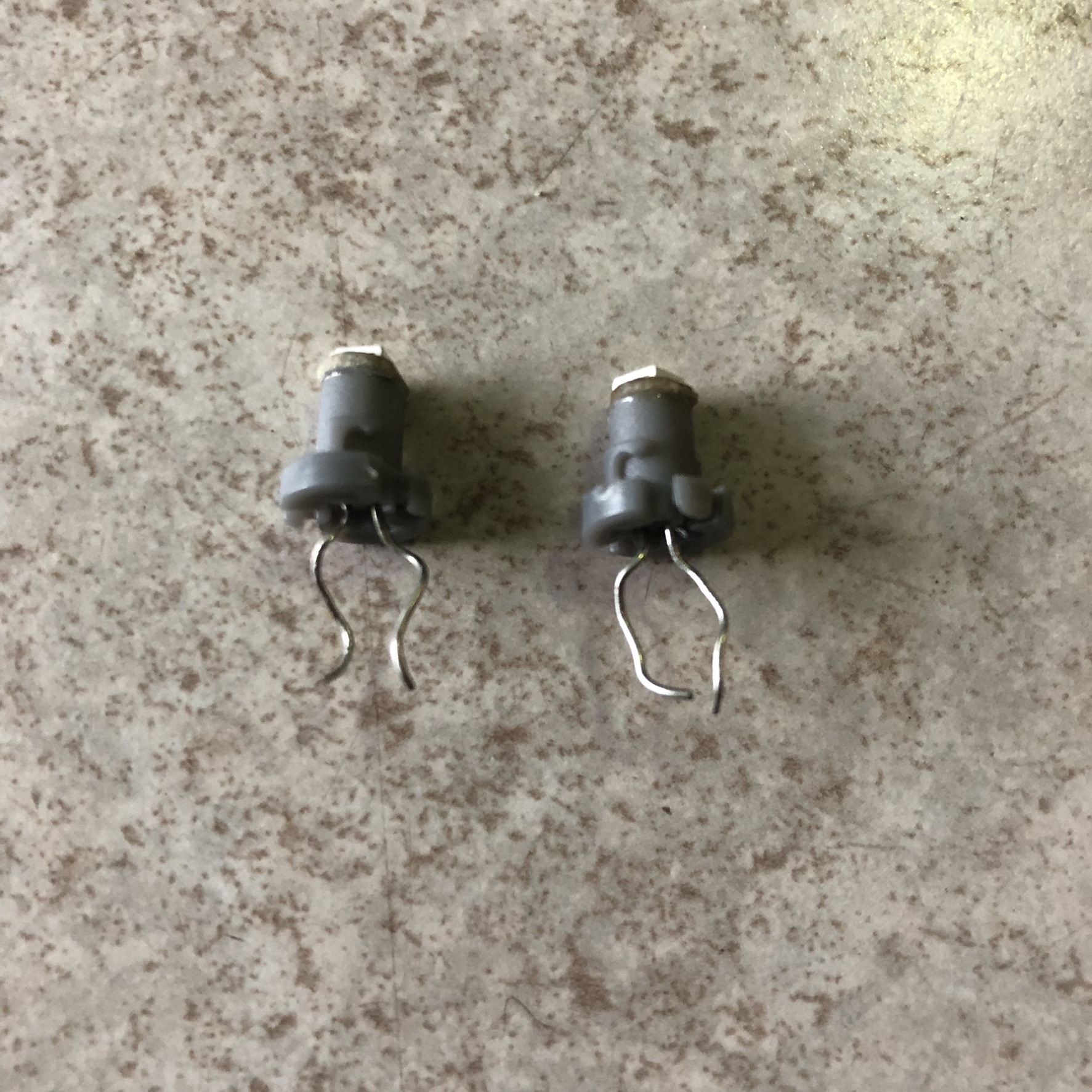

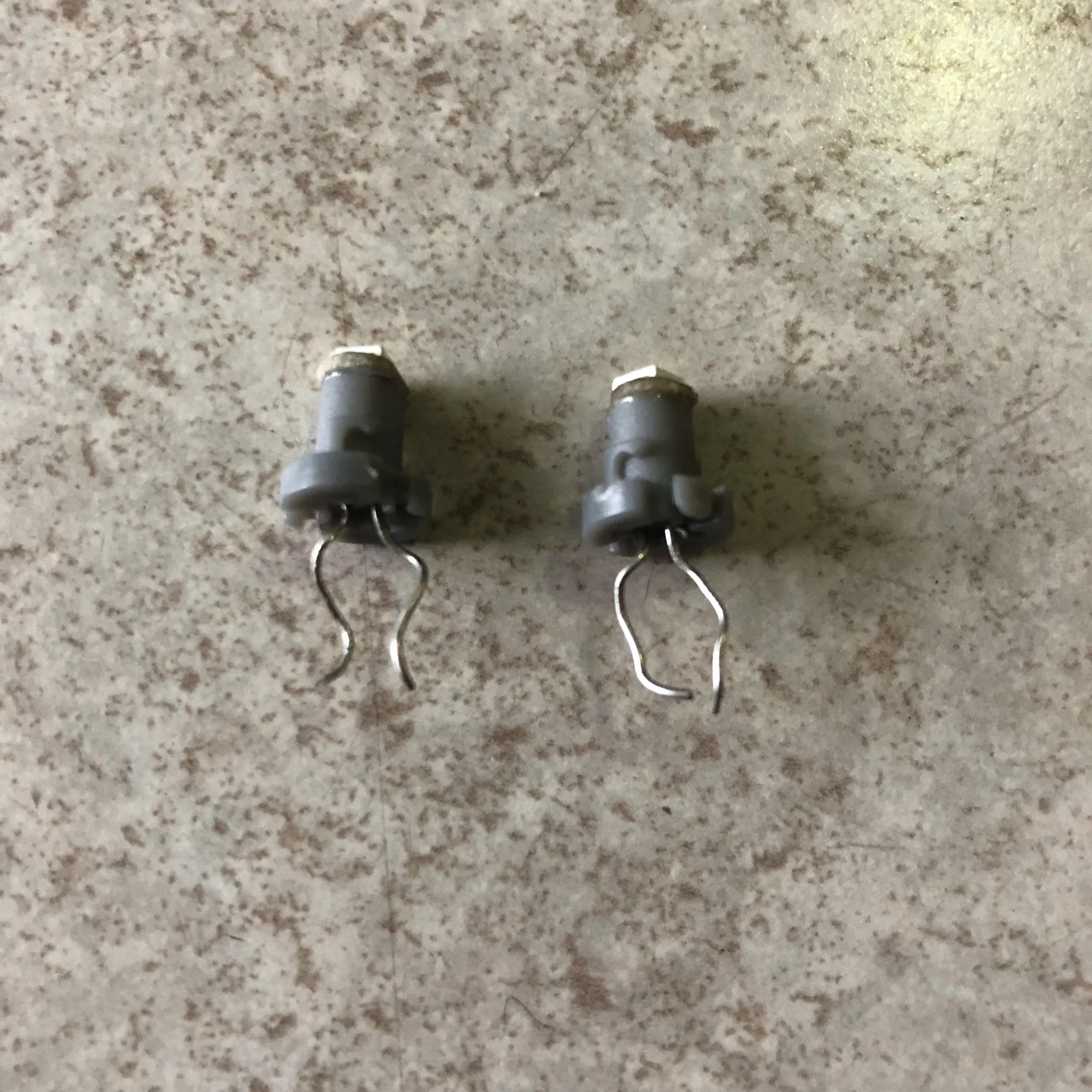

  • Replace these in the Toyota Bulb Holders and bend wires to Fit but Leave the Tag Ends.
  • Install the New Bulb Holders in Switches and Plug in Switches. Confirm they Lite - Polarity Matters with LEDs. If they do not light. then turn Bulb Holder Half Turn and Try Again. Cut off Ends when complete and enjoy LEDs for the rest of the Vehicles Life.

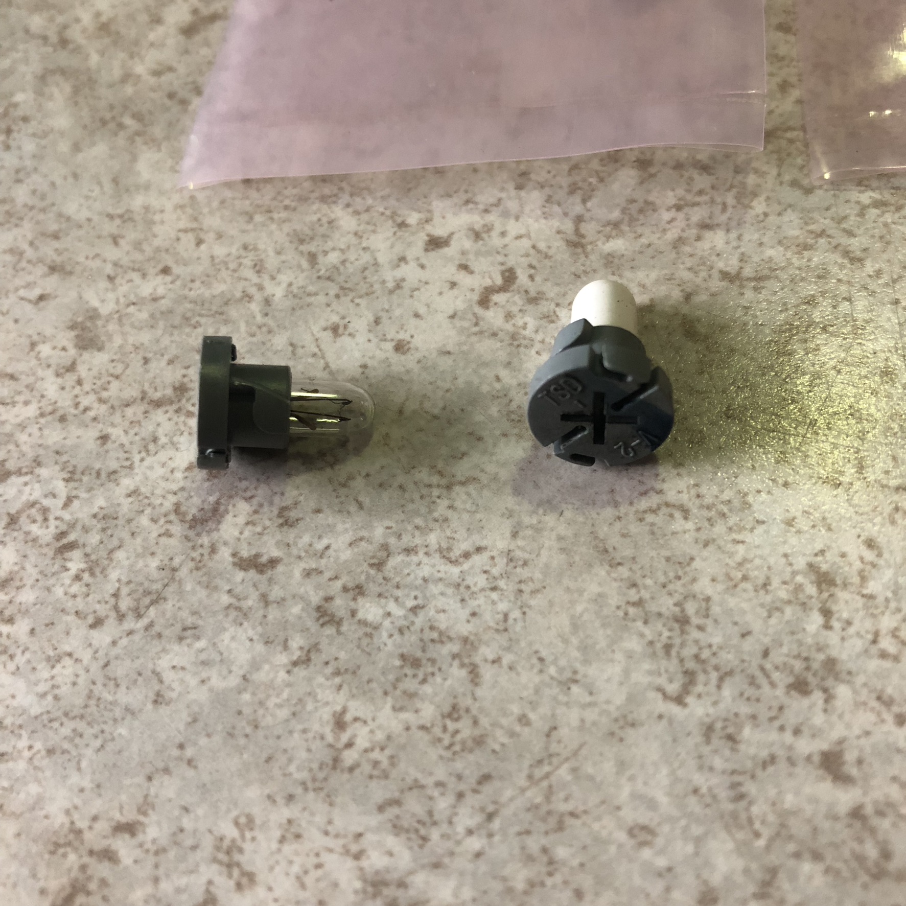

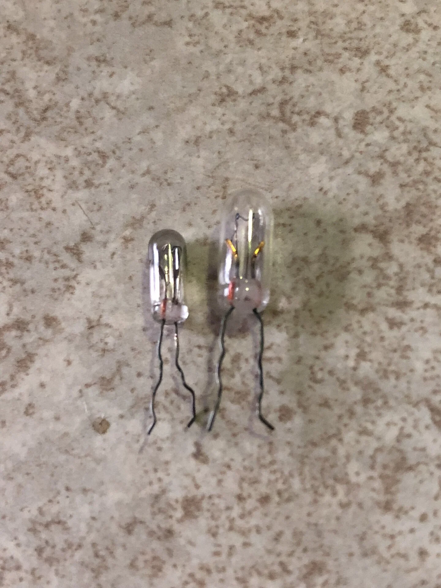

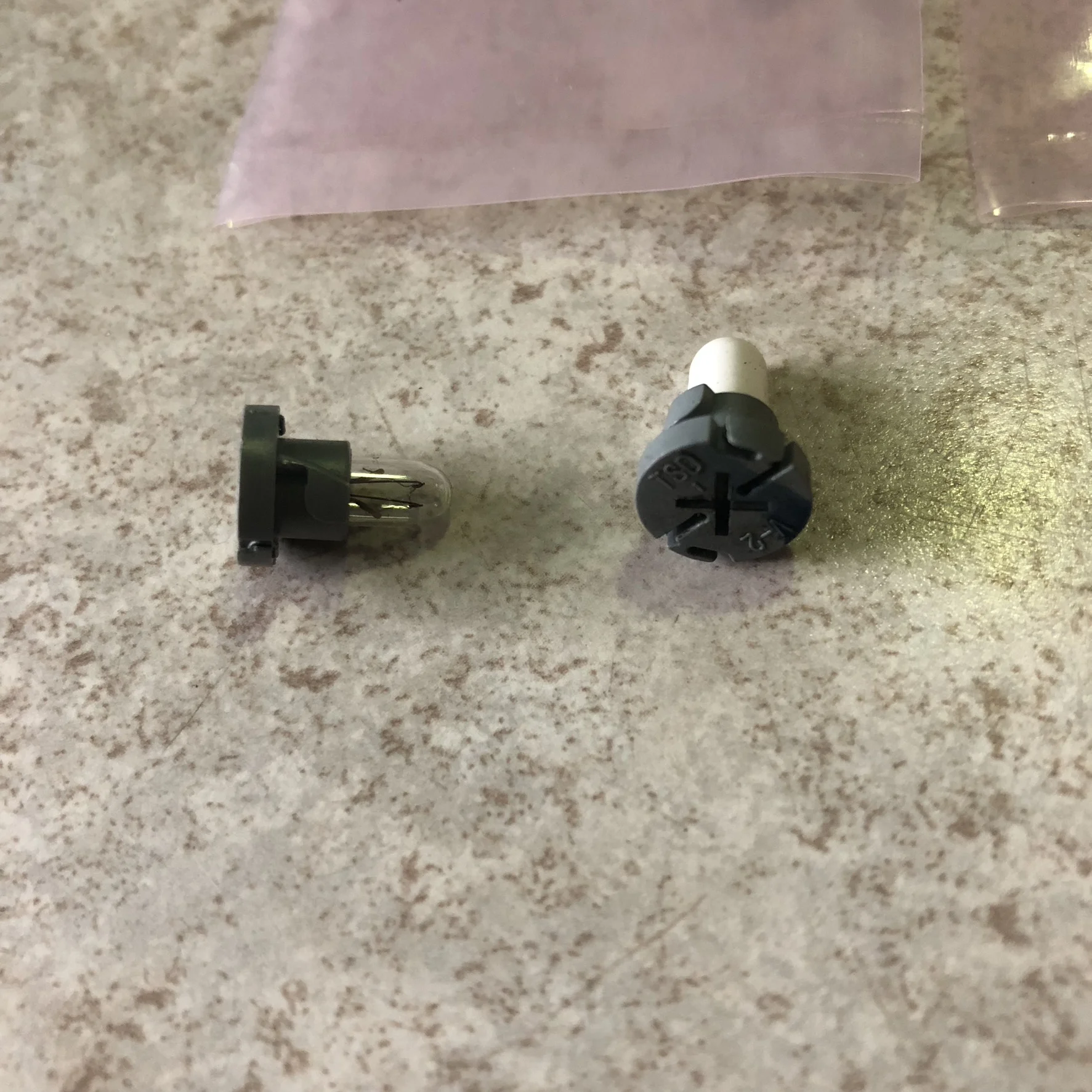

OEM Bulbs - 2 Sizes
Left - OEM Bulb with Cover Right- LED
New LED Removed from New Base
Straighten Wires On New LED using Needle Nose Pliers
New LEDs before Removed from base which is Too Small.
OEM Wires after removing from OEM Bulb Holder
New LEDs
