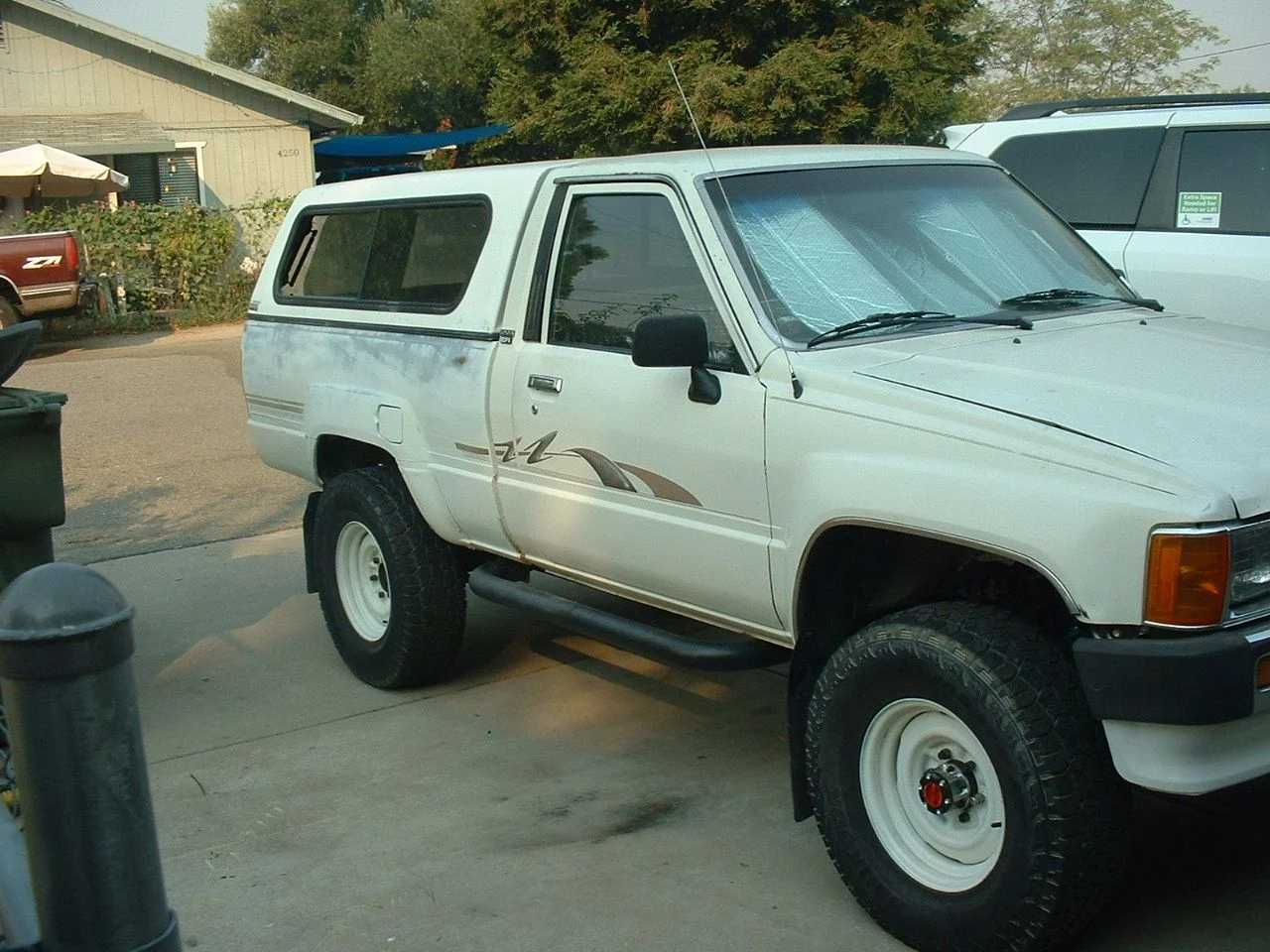

Here are a few pictures, cuz everybody loves picture, 88 standard cab, new 22re performance built motor, new radiator, alternator, LCE header,
ball joints, shocks, wheel bearings, rebuilt hubs. front diff is rebuilt (stock), Transfer case rebuilt(stock), 1" M/C, V6 calipers, and 1" wheel cylinders.
Rear wheel bearings next, finish interior and drive the snot outta it, till the next round of upgrades.
