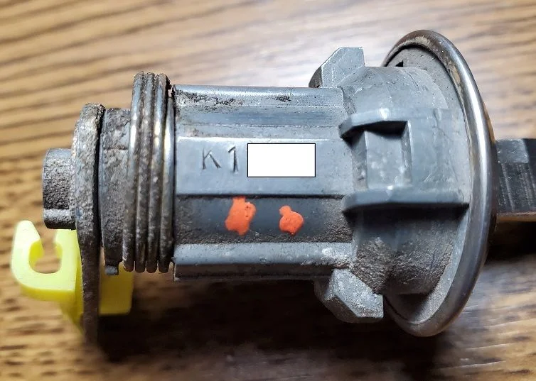

Went ahead and pulled the pass door tumbler.
Does this look about right for the key code? Took me awhile to preserve that marking to a clear enough state. My own eye balls can at a glance through a real magnifying glass see a 4 digit number. Maybe a K in the bottom right corner.
The picture is best I can do through a magnifying glass app on my phone.

Should be K#### format.
There is NO way there is a clear as day K#### format. Grasping at straws with whats there. Trying to find out if thats to be expected as a marking or if I should cut my losses on that.

K1### on this cylinder.
