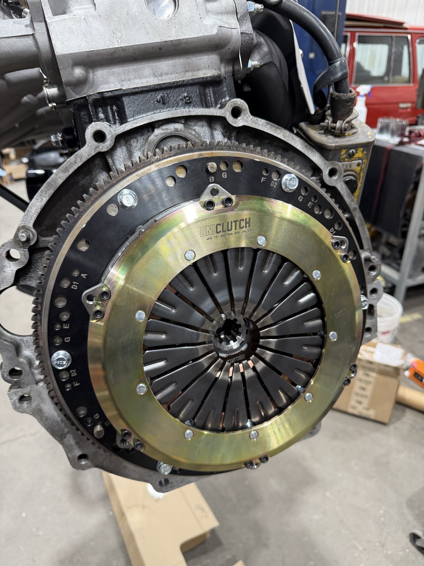

I've been reading up these clutches and they're super cool that the center input is swappable for whatever input shaft you're running. I was wondering when someone would start using them in Land Cruisers.
Install of the clutch was fairly simple. Instructions could’ve been a bit more detailed but we got it done. The kit comes with some spacers and special hardware. Once the order of everything is determined then it goes on easily.
For future reference this 4Terrain setup with a 311mm PCD 1FZ flywheel used 6 mm of spacers and when done the ring will have a press fit over the clutch body and sit flush with the body of the clutch. It was a little misleading at first because the ring will not fit over there clutch body by hand but once the hardware was installed it pulled it all into place and torqued to spec nicely. Be careful when installing the center splines it does have a specific direction it needs to go. Can’t wait to see how this thing feels!
