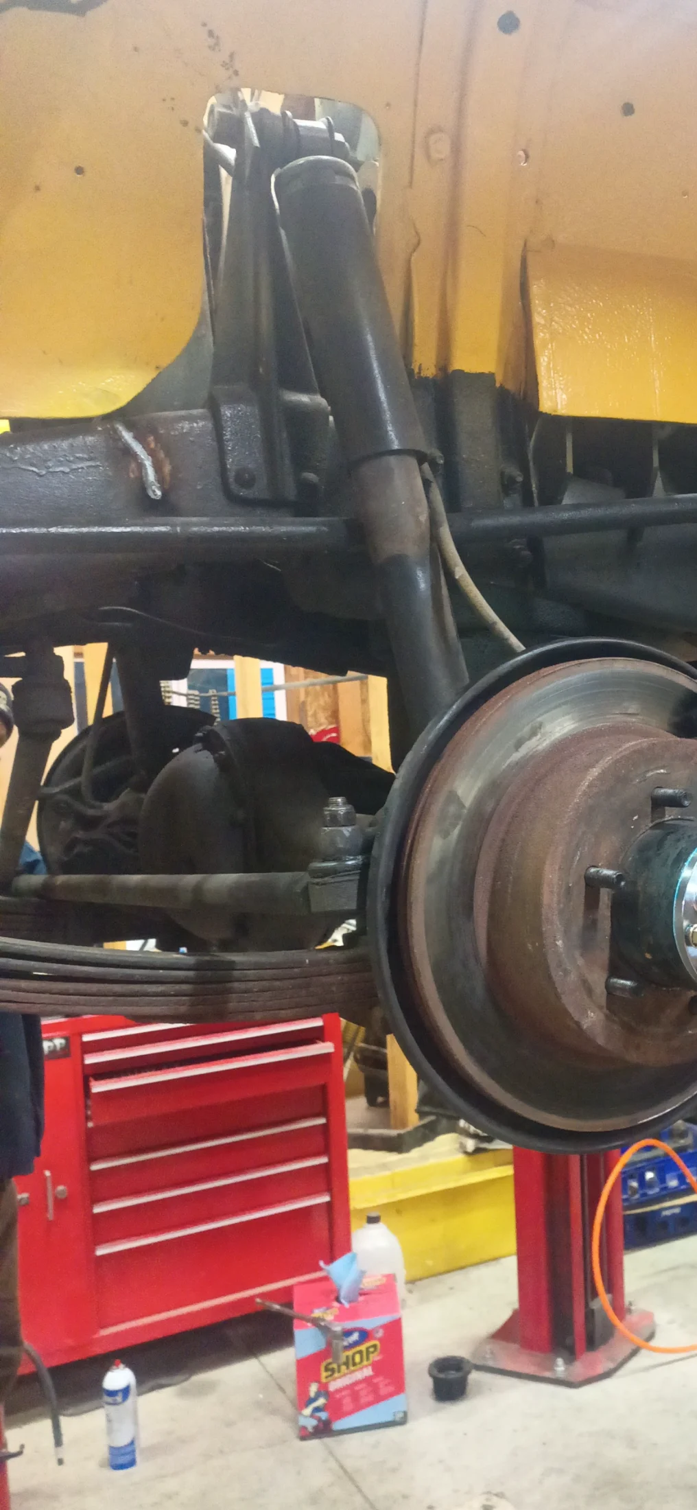

**My Neighbor said that Vertical welds on Commercial Frames Dangerous - I made a Mental Note, but never Verified. I trust him.
I'd post pictures of Any Repairs both before and after so we can all Learn.

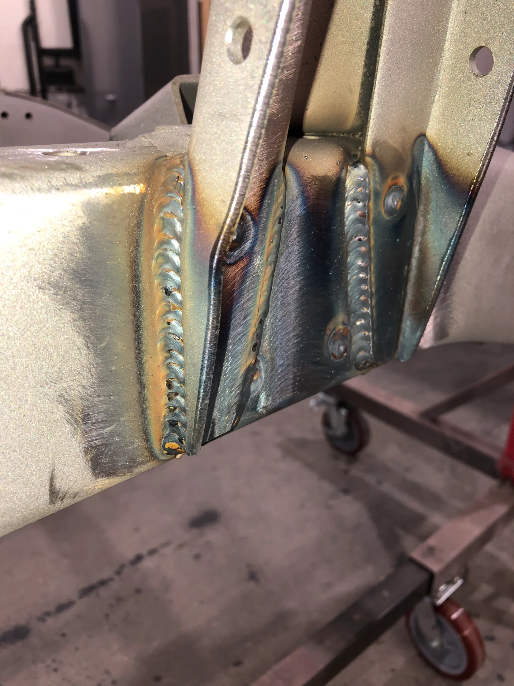

For context these photos show some vertical welds that were posted on another thread. They are part of a beautification project and those welds are on top of existing factory welds.
The frame appears to be on a rotisserie and not on a frame table when this work was done. The question is "even through this goes against everything some of us think we know does any of it really matter"
@Hornd your neighbors right. @J Mack welding a frome on a rotissire instead of a platen or frame table is like welding in floor pans without cross bracing the pillars🤔🧐 You are asking for trouble. And if the heat is focused all in that 1 spot at the same time you are gonna cause more than distortion, it will jeapordize structual integrity. I've been doing this for a lot of years with all types of materials in precision, military, structural, and pipefitting. I've seen all types of welds on all types of materials, and would not weld over anyone elses weld without total removal 1st🤔🧐 no matter how pretty.

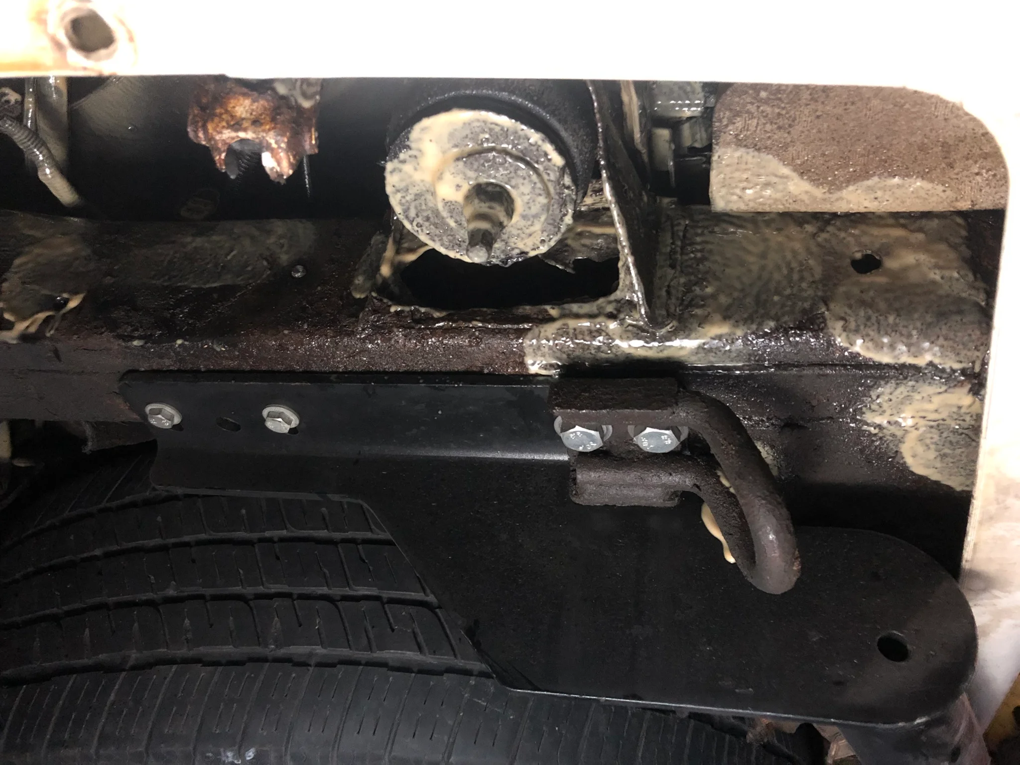

@J Mack You don’t remember I thought those were to ur welds on that front cross member ?
No I bought off bat. Had it shipped out to Oregon to my folks to do some work on before shipping it to Hawaii. Rebuilt front axle, bearings hubs seals all the typical front end stuff, drivelines, brakes all the way thru. Plumbed in a heater and defrost tubes, swapped out front grille and aprons for 40s stuff, welded up the frame in acouple spots from a lifetime of abuse. Then had it shipped to Hawaii. This was the day after they picked it up in southern Oregon and it fell off the transport truck on the grapevine. Then got smacked by a semi as it rolled down I-5. Was an insurance nightmare all the way around.
