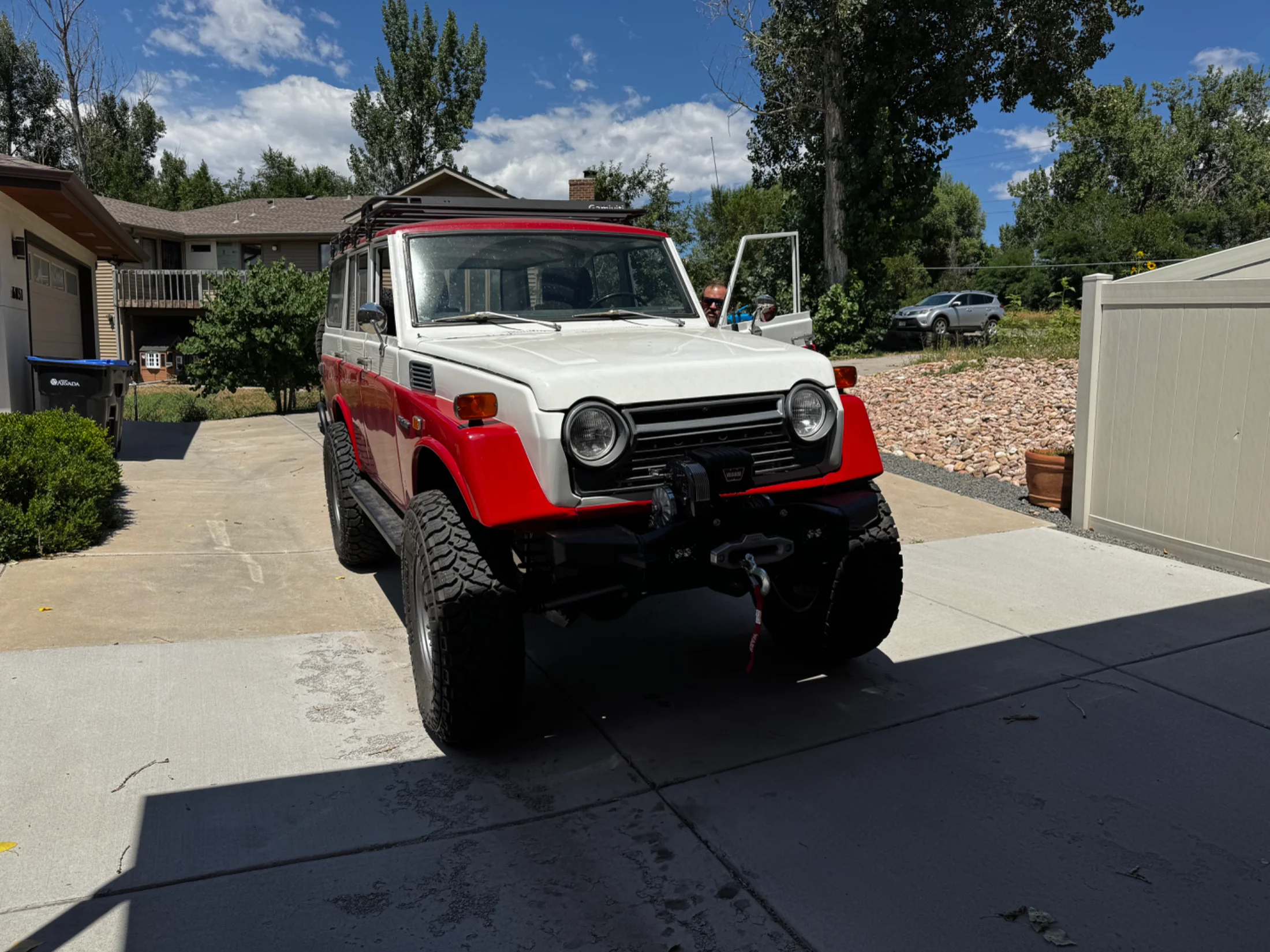

You can’t trigger me. I got to drive my pig today for the first time in many months.
I am beyond excited for you, no one deserves to drive a new pig project more than you! I cant wait until you get to drive the rest of them..

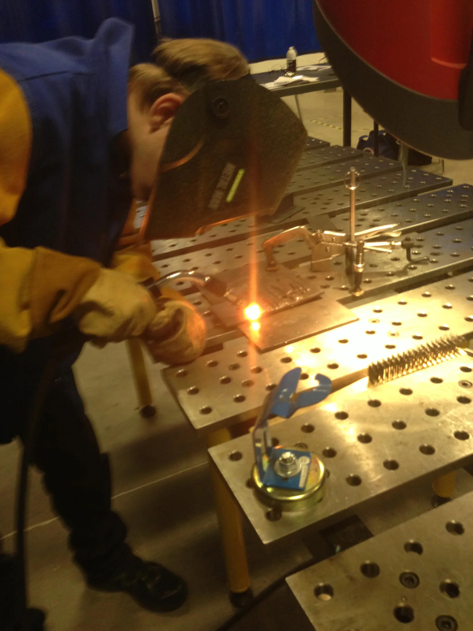

(pic of my son welding over a decade ago included for ... distraction.)
That makes my day when I see kids doing stuff like this, my shop is always open to friends and relatives that have younger kids. We'll stop work for a day or two and just hang out making cool stuff on cool tools..

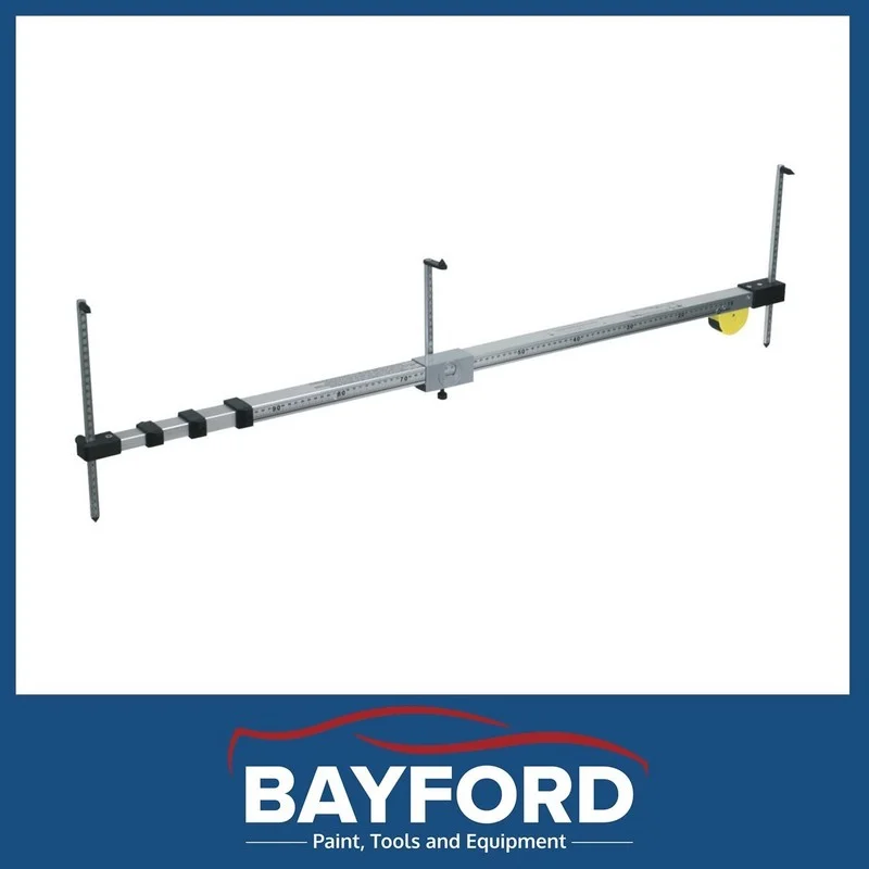

One last thought for those that may not know back in the day before computers we would get a frame spec sheet that looked something like this.
We would hang tram gauges from points along the frame that looked like this.
These gauges would hang down at a precise distance from locations along the frame rails and had a center pointer on each, once you had them all set you would sight down from the rear and the front and between the center pointer and the level or out of level beam on the gauges you could visually see exactly any out of square or bends in your frame. The reason I bring this up if I were going to tackle a major frame project I didn’t have a frame table or jig I would make some quick tram gauges to hang from my existing frame (1/2” conduit and 3/8” all thread would work for this) and map out my frame. Once you’re done hang your gauges check all your center points line up and all your bars are still level to each other. This will give you a fighting chance to get back to where you started, the more the better but for what we are doing here 6 would be a great start.

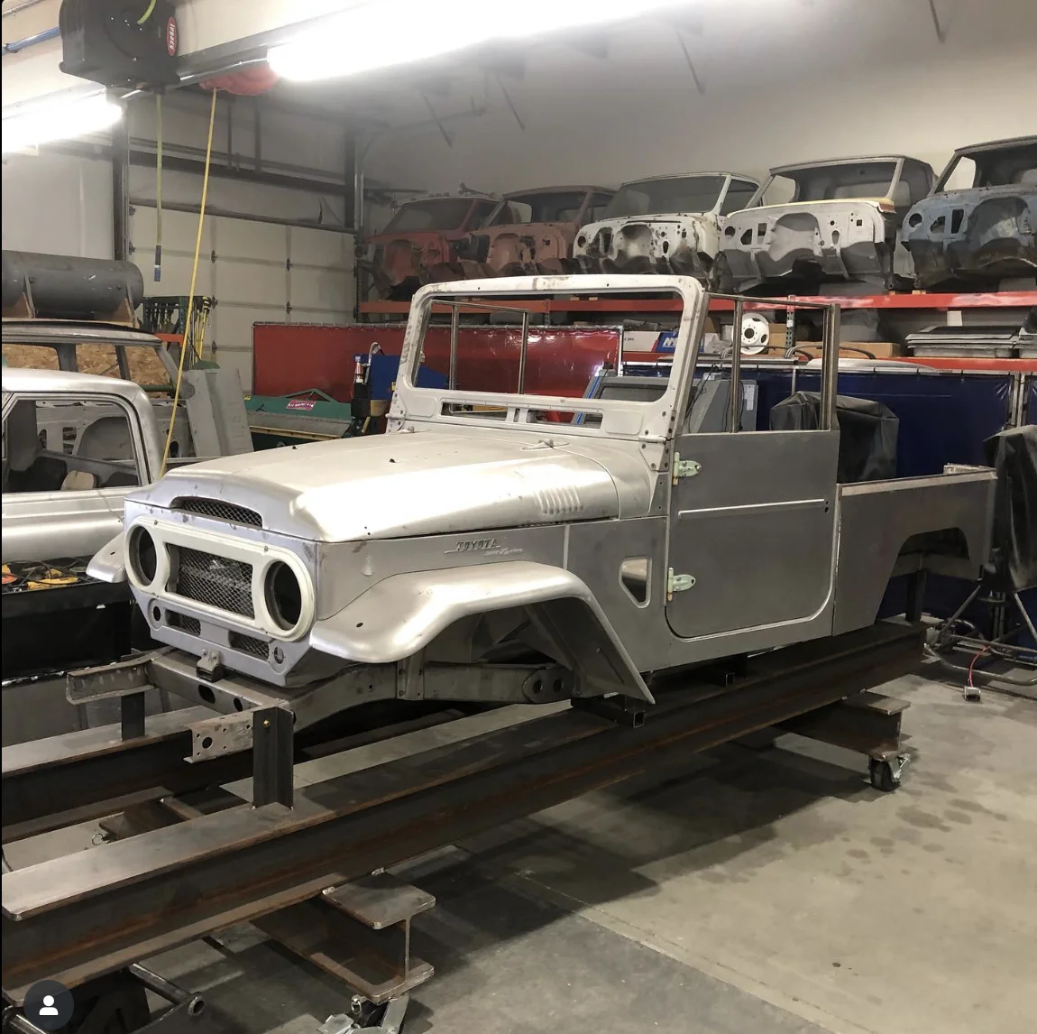

Mark has a frame jib built out of I-beams and another that is built from large section rectangular tube. These are more about "index" (as you're describing) than pulling things back into shape. He did twist a frame horn back straight on the front of batpig early on.
He didn't seem to view it as necessary for what he was doing to the pig.
Mark has a frame jib built out of I-beams and another that is built from large section rectangular tube. He didn't seem to view it as necessary for what he was doing to the pig.
I have so many questions why a guy with his talent, budget, timeline and resources would do that but I know now is not the time.. Maybe we’ll be at the same camp site sitting around the same camp fire some day and we can talk about it while you drink your three beers…

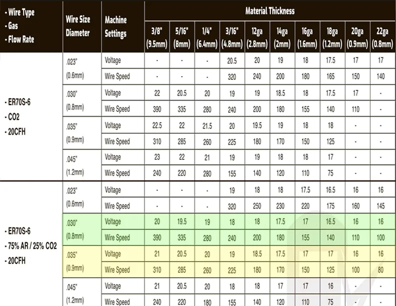

So let’s talk about weld settings…
I’m only adding this part so you don’t think I’m an expert… “Do your own research I’m an idiot that hits $hit with hammers”…
Yes I passed a weld certification but no I’m not a certified welder. I worked for a ISO company and we took on a new client “Toyota” and they required a higher ISO rating than we had, My entire crew needed to get weld certified as part of that, long story short I thought if my guys need to do I’ll do it with them and that’s what we did.. When you get weld certified there are several different layers, United Association UA-Cert that usually means you work for a union welding pipe line and actually know a thing or two all the way down to a company certifying you to pass an ISO rating, my certification was nothing more than a gold star next to my name on the company white board and they erased all of it when I left..
We’ve recently seen some pictures on some build threads and as I just learned recently build threads are strictly show and tell not Q & A so let’s not talk about offensive stuffs in un-approved areas and do it here.
OK let’s dig in, we’ve all seen the new rage of “Stack O Dimes” MIG welding on frames and frame components and thought dang I need to step-up my Stack O Dime welding technique…. I posted a video of a crew of guys that are very good at the “Stack O Dimes “technique and I posted that video because they talk about settings to achieve the desired result..
.030”wire, 18 Volts, Speed about 200 IPM (Inches Per Minute) for ¼” plate according to the first guy and..
.030” wire 16 to 16.5 Volts, Speed 150-170 IPM for ¼” plate according to the second guy
For context I’ll post a picture of one of the many “cheat sheets” floating around my shop and it has some good start setting for my welder, my welder has way too many features (computer controlled) and it’s easy for me with all the other stuff going on to forget some of the basics and this sheet reminds me quickly were to get started.. If you don’t have IPM and volt settings on your machine a quick way to get ballpark is pull the trigger on your machine and count to 6, measure the wire stick out and add a zero that’s you IPM. Get something close to my chart and start adding voltage, if you have spatter the size of the welding wire you need more voltage, If the arc burns back up inside the tip you have too much voltage and adjust from there..
My start sheet is always plus/ minus very little of my final settings for 90% for what I do here so I’m comfortable to call these my settings. If I’m welding on a frame (like Toyota fj55) and I want it to stick I’ll start in the ¼” range on my sheet and could get into the 5/16” range depending on how I feel. I only weld with .035” wire if I’m doing frame work so my start setting would be..
.035” wire, 20 volts and a speed of about 260 IPM, this is significantly hotter then what these guys are talking about. If we use my sheet they are welding 1/4“plate with between 18Ga and 12Ga settings and are literally setting some pretty weld globs on top of the base material (and if you’ve read the 276 Pages of the third edition) you would know weld penetration is a thing and you should do it.
It would be hard to make the argument if we are welding on ¼” plate with 18Ga settings regardless how pretty the weld that it’s going to be a “good” weld but for whatever reason this is the new accepted norm, am I just completely out of touch??
Am, I missing some important detail and one of you can set me straight? I was hoping to ask one of the guys that post these weld pictures as the gold standard but I don’t believe we can have that conversation publicly. I have to believe I’m the only one out here thinking smooth welds are still gooder. If I set my machine with .035” wire, 20V and 260ish IPM on ¼” plate I can do the whoop-dee-doo, over under, every lower case vowel, some of the upper case vowels, side ways U’s, ziz-zags and hula hoops and nothing nets the lumpy welds (stack of dimes) unless I turn my machine way down below recommended start settings something I have a hard time doing on a frame that I want things to stick to.
What say you guys??

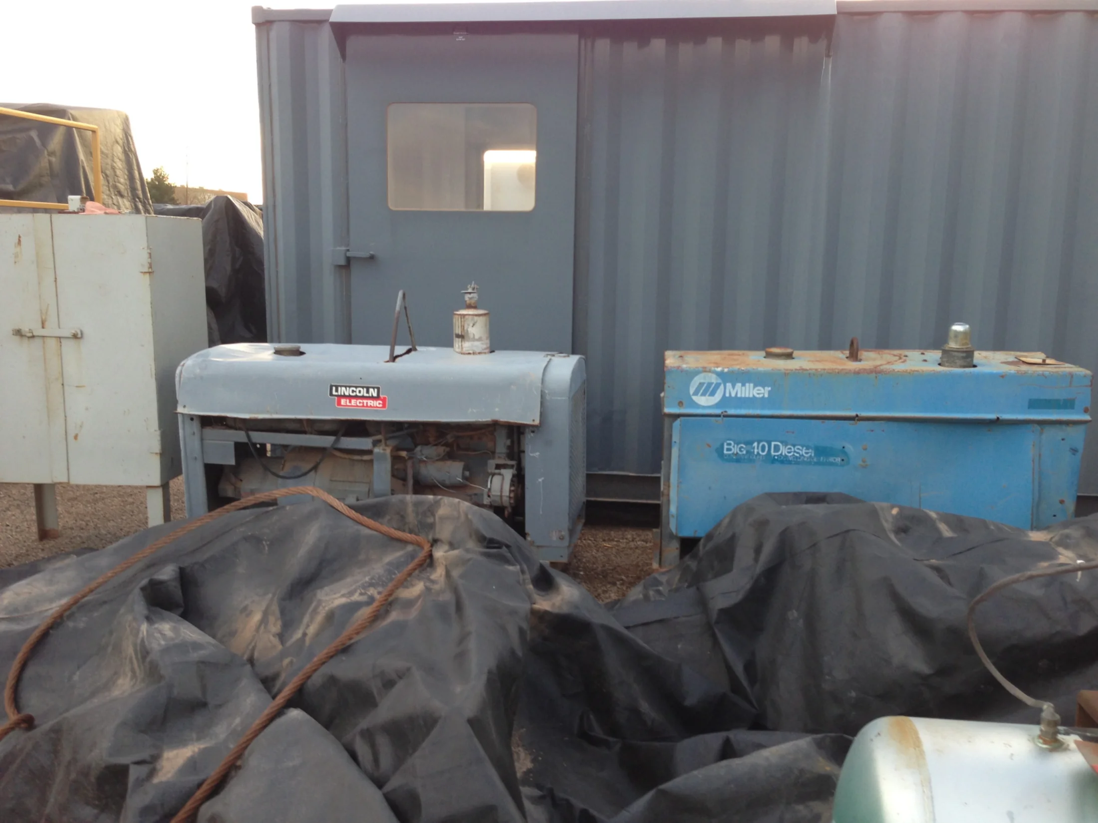

Then again, it’s not all tiny wire. Years after I left the drilling industry, dad moved away from the ole standby Lincoln 200s, and to a pair of Miller Big 10D wirefeed machines, running 1/4” wire.
Two machines so two welders could start at either side of large diameter casing and lay bead toward the other. No stopping to change the rod, which requires lifting the hood and thus getting a little cool air. The smokers always seemed to light one every time they lifted the hood, too. I can only imagine how much it sucked. Did save time though, and time is money, right?

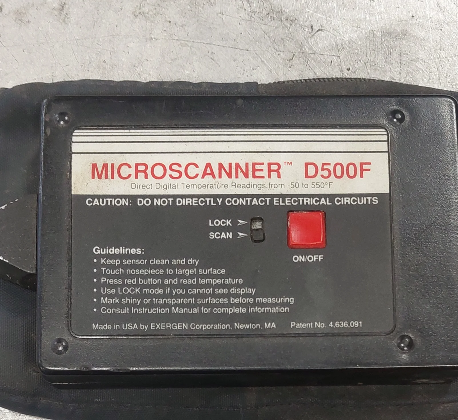

- I’ve been thinking about your preference for an IR thermometer for a bit, (and discussing it with the kid, who has an actual physics degree)... so I “did my own research”, if you will…
I think the problem with IR thermometry is that it depends a lot on the surface emissivity of the material. I’ll omit what all the kid said about black body emissions, but stainless steel will read differently than aluminum at the same temperature, and the surface finish can affect the result as well (polished will read lower than rough).
IR temp measurement has to assume some emissivity in order to give a temperature, and if that assumption is wrong (and there are lots of ways to get it wrong), then the number you read on the screen is wrong.
And that’s before we get into the stability of a battery-powered device with a tiny ų processor (typically a PIC), with a low-resolution ADC, low sampling rates and a look up table to display the results.
****ing Chinesium circuit design, but “digital” so it must be right. Right?!? Don’t get me started on “digital” calipers from China, I’ll keep my Starrett, thanks.
The crayons, though low-tech, don't suffer from this.
Yes you are correct but there are a few work arounds..
I have this old dinosaur that I believe I've had for 35 plus years, they were quite expensive when they first came out but I felt it was worth the money for what I was doing at the time.
From the instruction manual..
1. The ability of the object’s surface to emit heat. r In general, infrared thermometers can easily measure non-metallic surfaces because they emit most of their potential heat. Metallic surfaces, on the other hand, are poor emitters and require special treatment before infrared thermometers can accurately measure their temperature. Fortunately, that special treatment is simple and can be easily accomplished by marking the metallic surface you wish to measure with a non-metallic substance such as paint,grease, oil or even transparent tape. We recommend marking metallic surfaces with a solid paint marker.* To make things easy, Exergen provides a marker with each unit.
