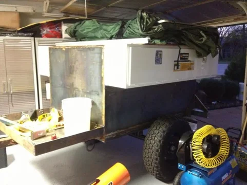

Here is a picture of the area in question... It is the rear cross member. I will pull it out of the garage this weekend and fully inspect the entire frame.
proper PC should not chip like that.
can you pick any loose stuff with your finger nail?
if you hit it with a hammer does it come off?
i wish i knew how to post vids and i would show you the test i do.
cheers
that should never have chipped.......my local powder preheats all projects. for the chip, hit it with a can of paint and let it be a lesson learned. for the OP, what have you decided?
might be best to find out why there was no bond. if a contaminate is there then the paint won't stick for long either.
at least sand the exposed area and wipe with cleaner before applying the paint.

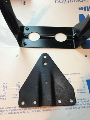

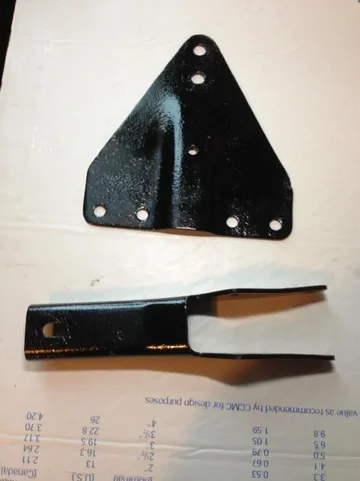

My paint guy at Car Quest talked me into a can of chassis black from DuPont, I guess this is what all the local body shops are using now. He recommended a good self etching primer for a base. A gallon of paint runs a total of $49.00 as compared to the POR 15 at 150 ish.
I know that everyone raves of the POR I thought I'd do a test. Seeing how both paints don't use a activator I had him put some in rattle cans. He cringed at putting POR in a spray can saying that It wouldn't work because its too thick. Guess what, works fine. I sprayed several parts to see the difference without any problems with either of them. All parts are blasted.
Chassis black
Chassis black primed and 2 coats of paint
POR 15 from a rattle can.
I'm assuming you're taking the parts down to clean,bare metal? If so, POR is of no use to you. Use an epoxy paint/primer combo and never look back.
Also, you need to find a new paint guy if yours recommended topcoating directly over self etch primer.
