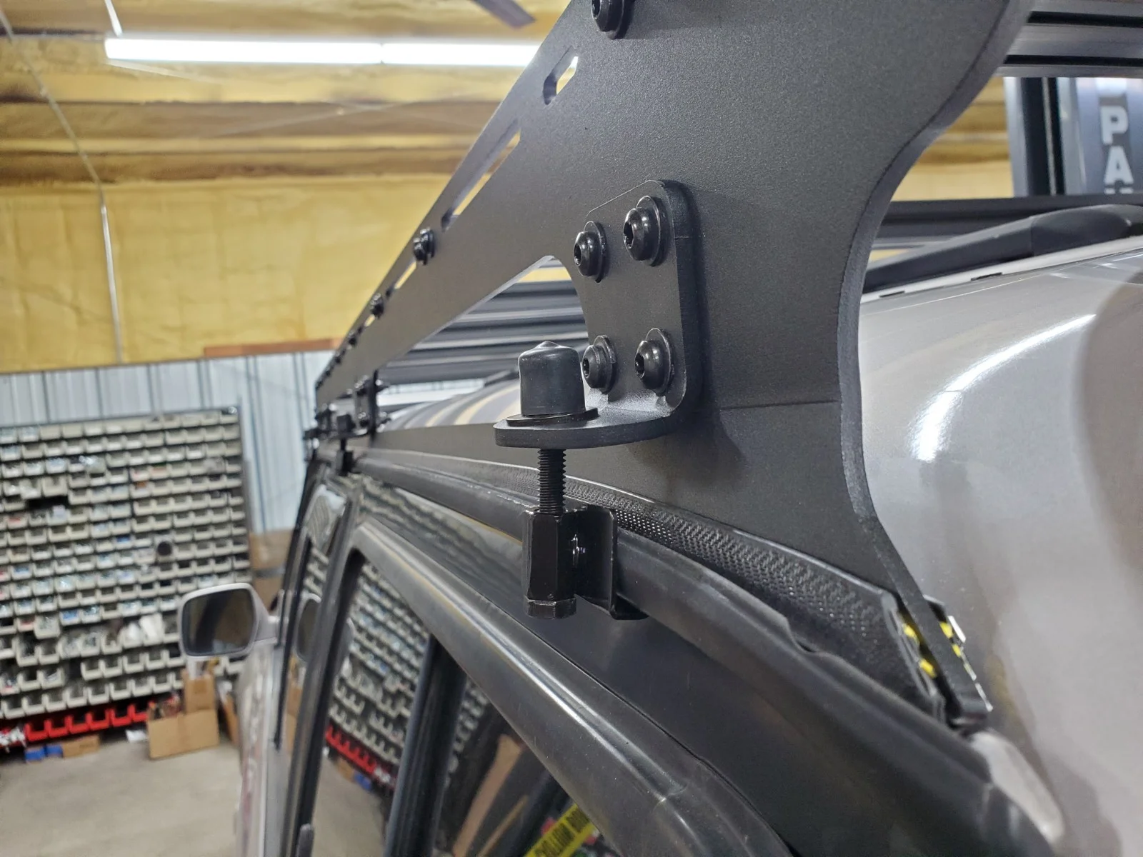

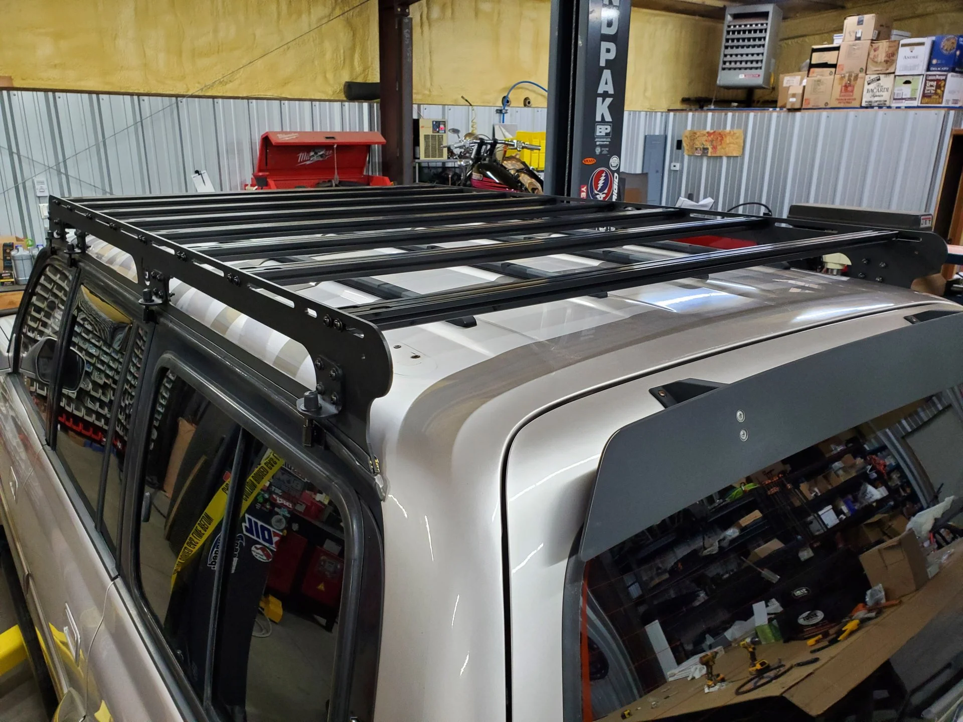

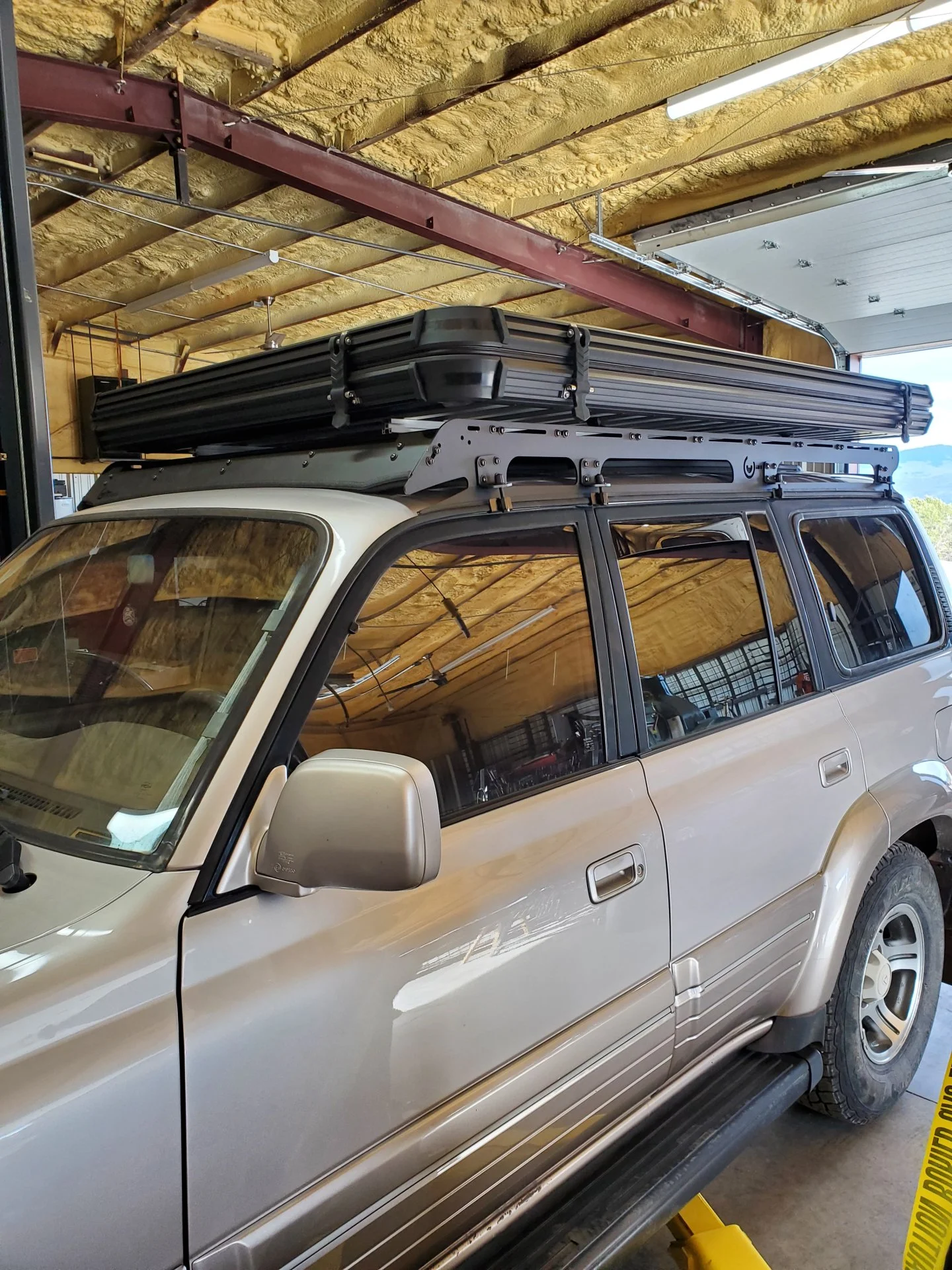

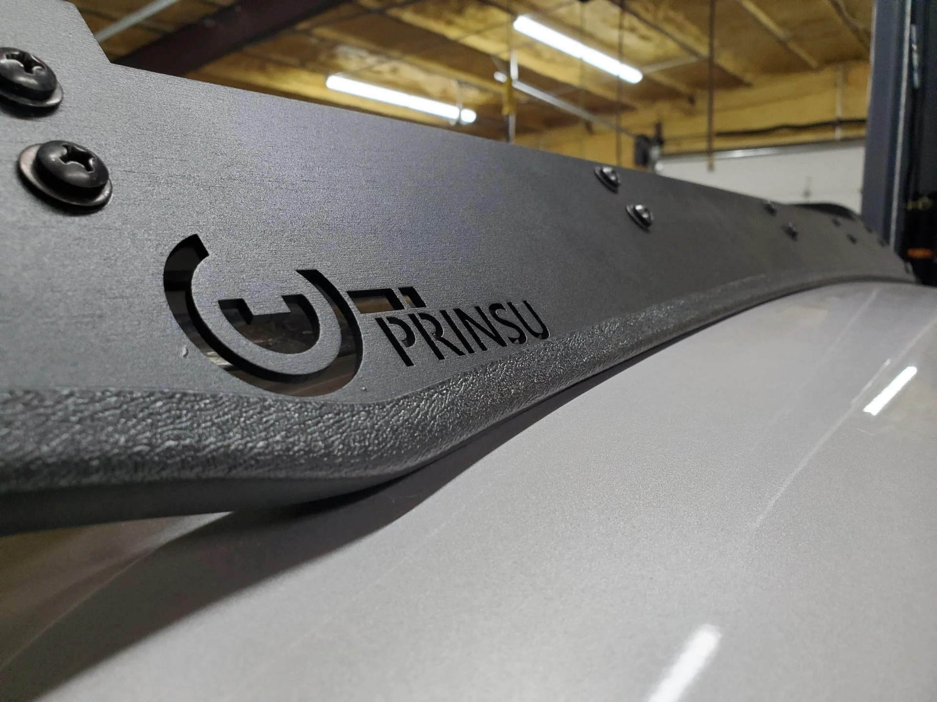

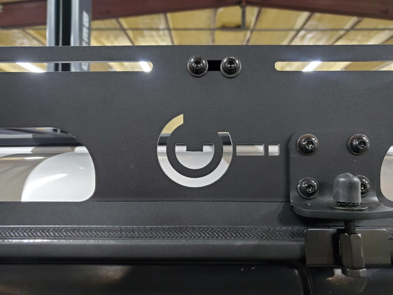

So first up is a Prinsu Roof Rack, simple and clean. 3/4" space between the factory roof ribs. Very nice powder coating and a good tight fit. The gutter hardware is a bit light duty for my taste, but I havent seen a rtt on the side of the highway ...yet.
I went ahead and bought a roll of gasket material for the base of the rail to protect the gutters and reduce any shift or noise associated with metal on metal.
The oem roof rack holes will be filled with bonded washers, silicone and stainless bolts.
Slinky springs and associated suspension hardware still in transit from Australia. The hardest part is anxiously waiting, but i knew getting into this that it wont be till the snow thaws until this rolls outside again.........so off to a mock fit of the FSR 55" Odyssey RTT. Very nice 3 season rtt, seems to be nice and sturdy in both the open and closed position. Was originally interested in the 49" wide model, mostly trying to maintain a narrow footprint, but being this will not be a "rockcrawler" we thought the 55" width may make for a better 2 person sleep. My only hurdle is making an easy method to "unbolt/remove and install/bolt down" without jerking around with small fasteners and big hands in a too tight space. I saw the Frontrunner quick release set up but didnt want to raise the tent any higher than it sits now. I may get three more 1x2 80/20 lengths and mount them permanently to the tent and unbolt the tent from the bolts on the side, which should take 2 minutes to remove, we shall see.
Looks great. I have the same roof rack. Would you mind providing which roll of gasket material you bought?
Sure White Sheep....the fit was spot on. Here are the dimensions, but like alot of items on Amazon, it has since dissapeared, but here are the dimensions.
Edge Trim Black Large U Height 0.656" U Height x 0.039"-0.178" Grip Range (16 Feet) Amazon product ASIN B00XSX03XA

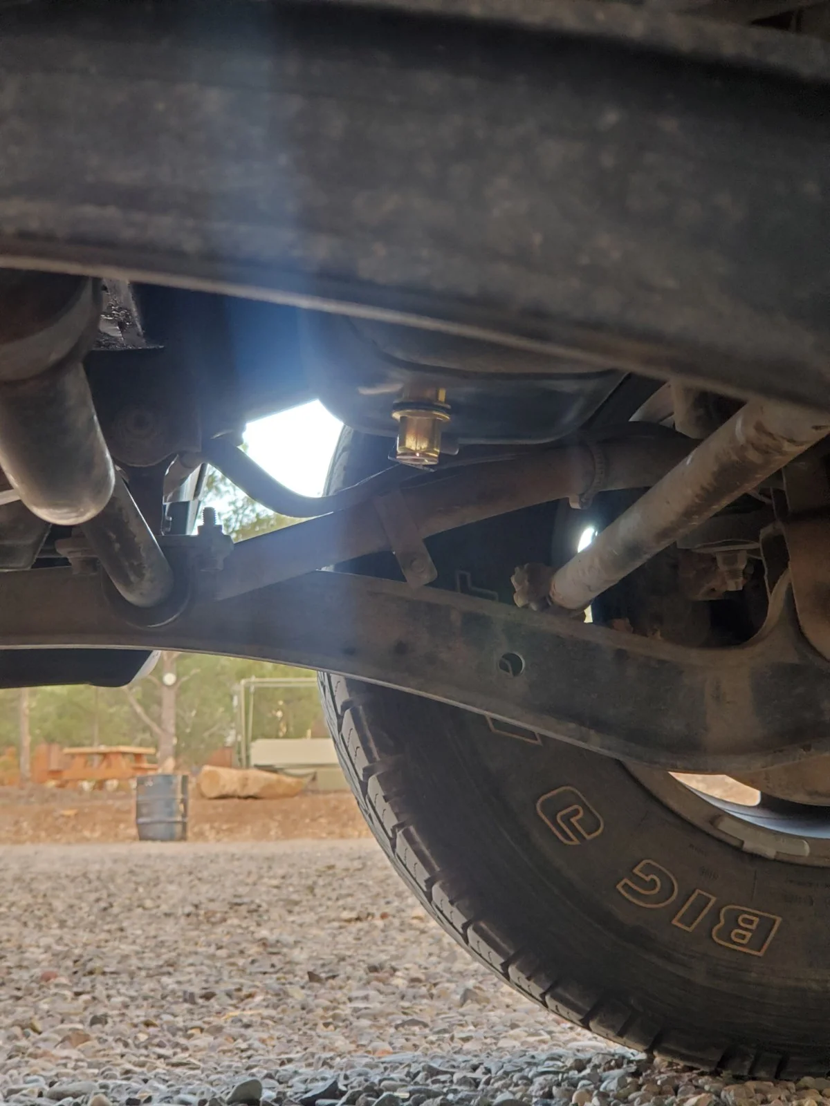

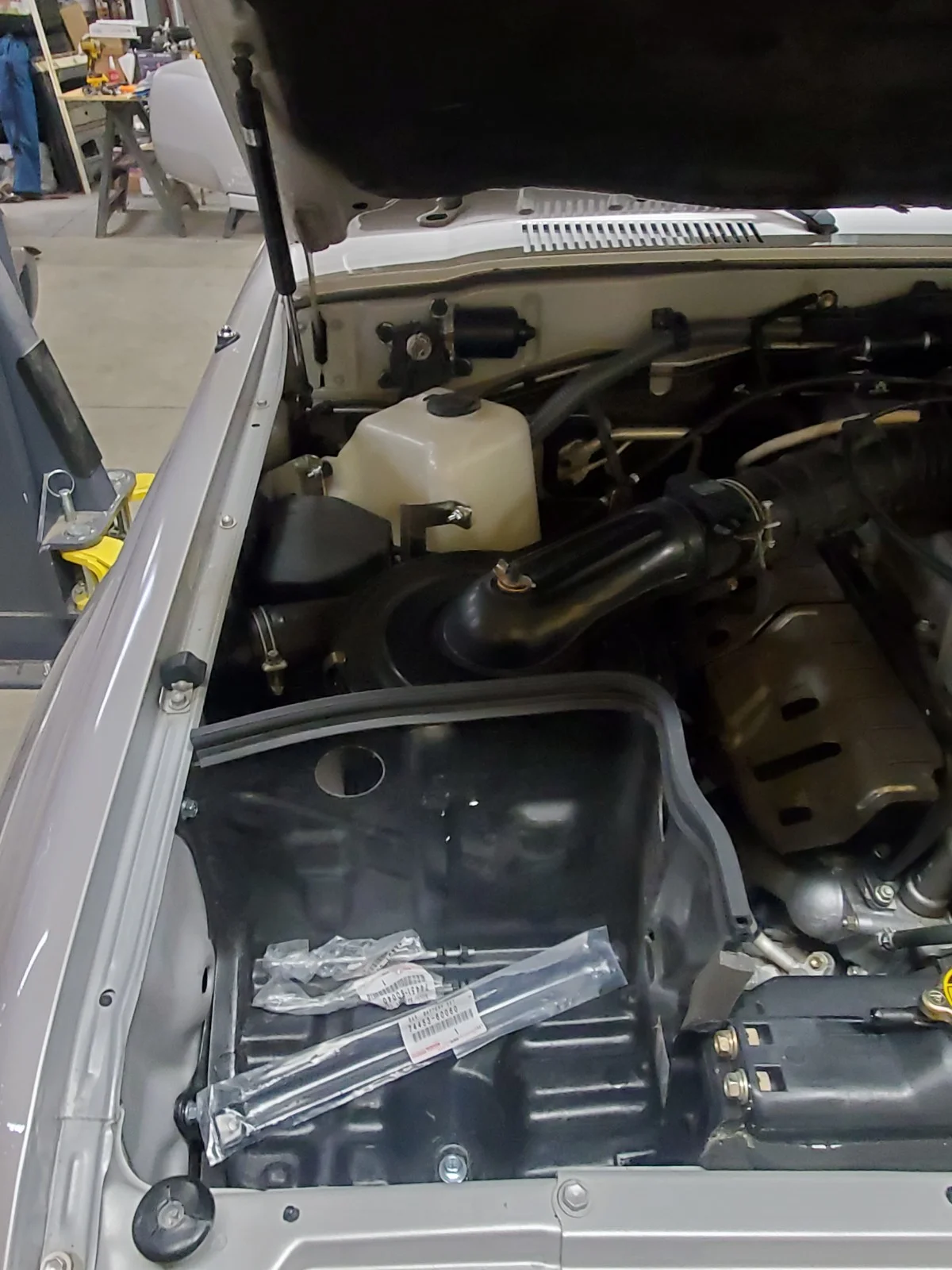

well, Covid took its course the last 2 weeks. So upon feeling better had some time to do a few more of the menial tasks such as second battery tray/washer bottle relocation kit...............

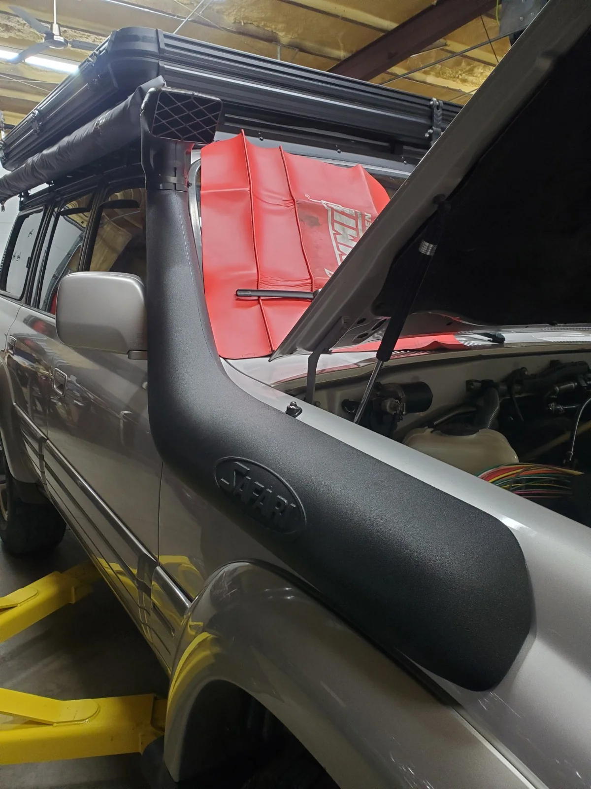

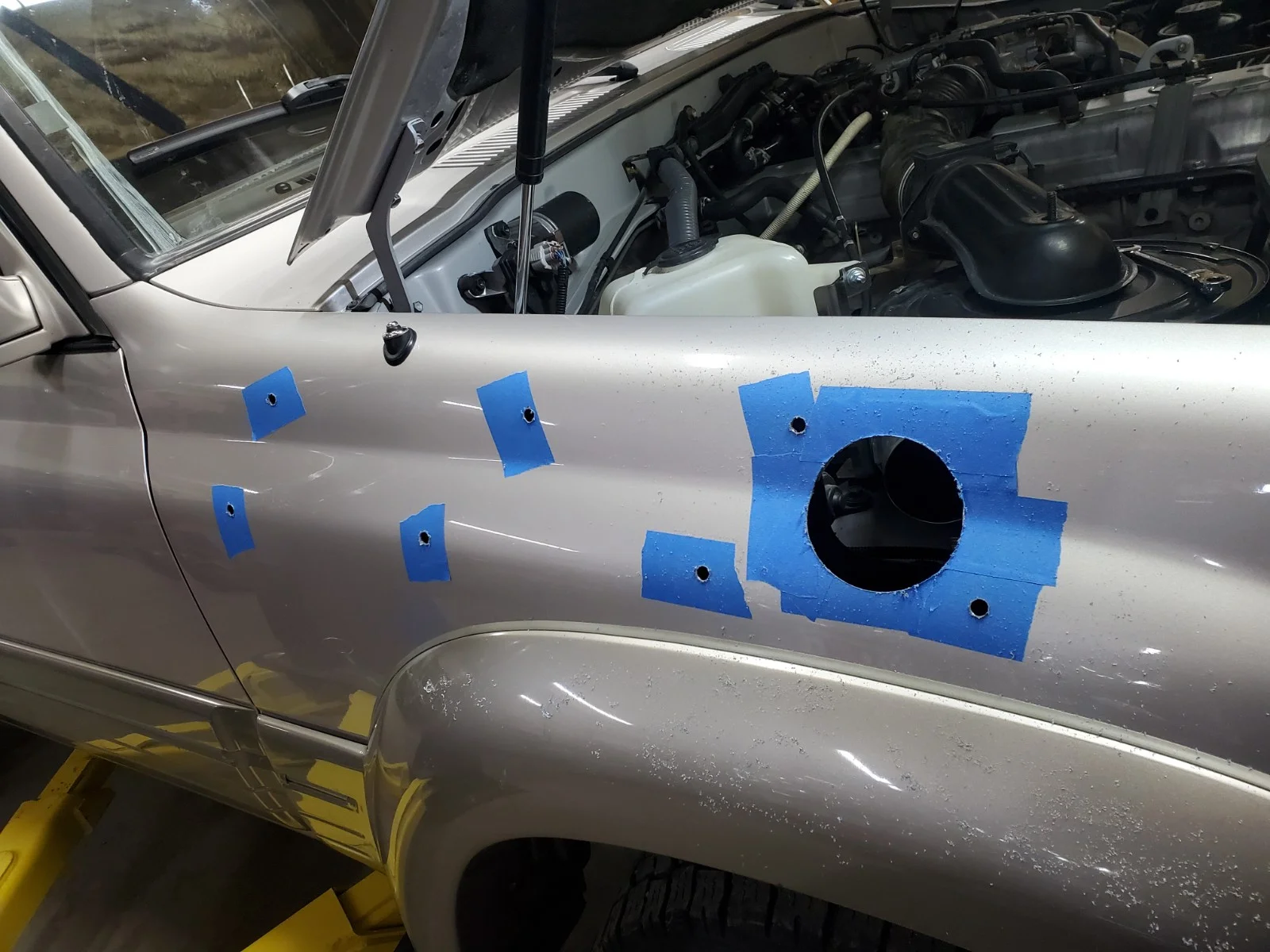

.......and the Safari Snorkle kit. Not much room in there, although a good liberable amount of Lexall silicone was added to each hole, to keep this 100% rust free.
Not too thrilled about drilling holes in mint tin but the dust free air is a biggie for me. Caught a bit of flack about using a K&N air filter, but properly maintained, I have had no issues in the last couple of 40's I built. I have ALWAYS used a thorough amount of oil on the filter, combined with waterproof Outerwear pre filters. Properly maintained serves as a great combinatin (until AFE comes out with an 80 style filter)

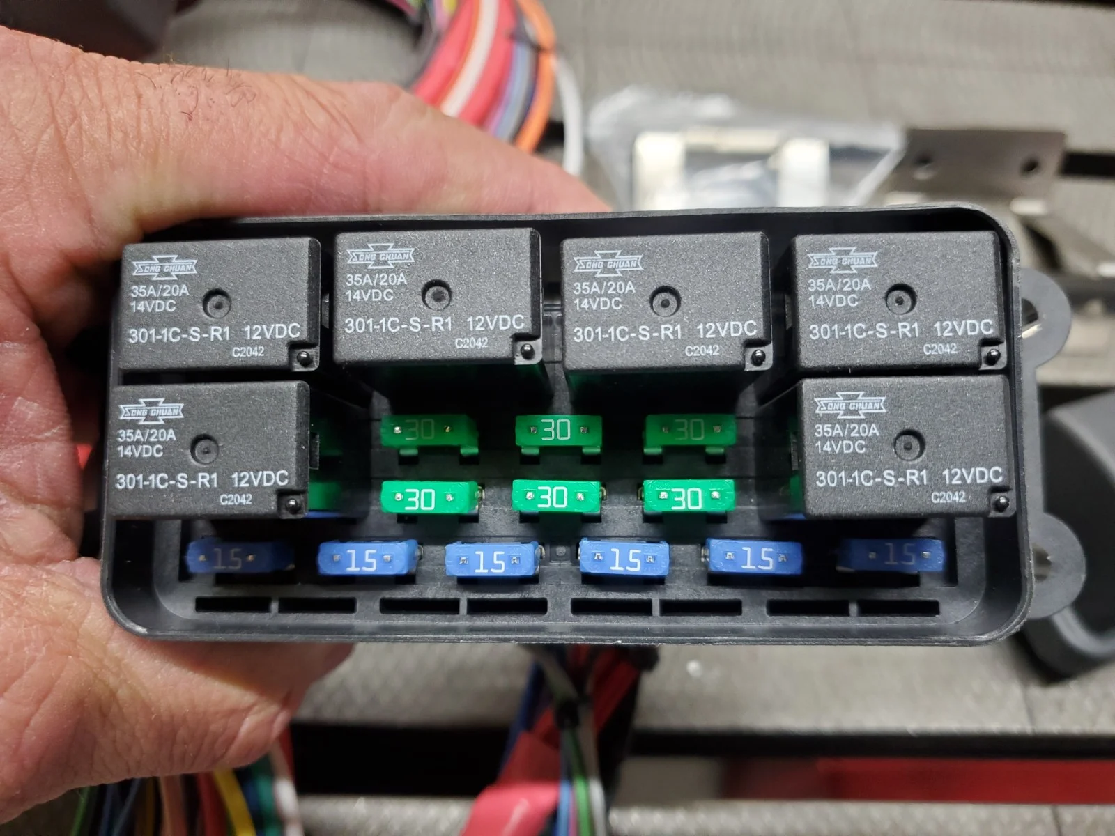

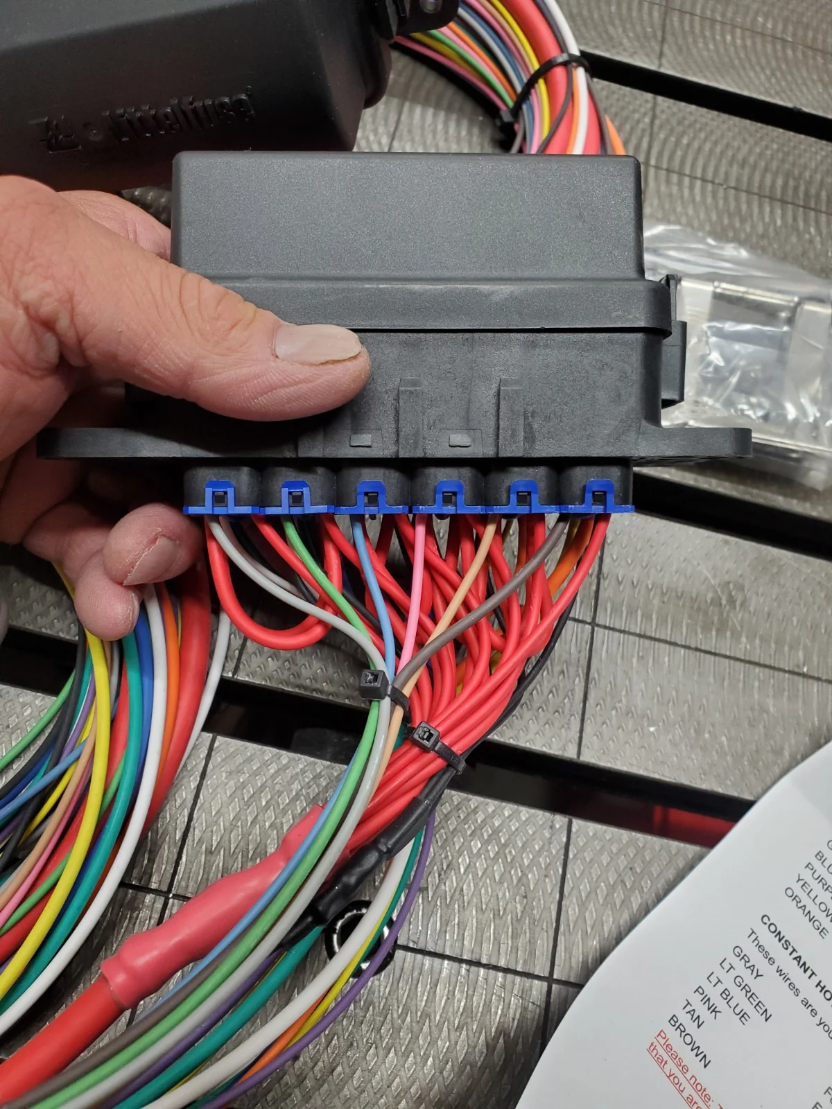

I went ahead and bought two of these Relay/Fuse boxes, prewired to save aggravation. They are made by Concourse Specialties and have used them on two other vehicles. Excellent quality and VERY reliable and clean install. For a few bux, you can have a custom length harness upon ordering. I went with 96" lengths. Unfortunately the Lexus does not lend much real estate for any motor cab additions, so today I will figure a nice neat and tidy spot to house unit. The second will be in the passenger rear quarter, bad part is cant wire until Slee gets the ARB drawer system in.
