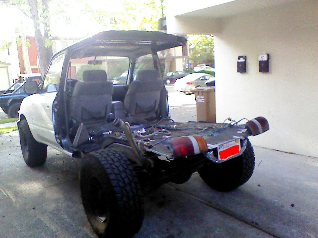

Its NOT about increasing power......its about increasing power to weight ratio!!! 200 is a pig and needs to get on the treadmill and lose some weight.!! My goal for a 200 is 4800lbs on 35s. -900lbs. effective 15% hp and torque boost.....and lighter weight on stock beefy parts should be great for durability , braking performanc- acceleration and mpgs. 15.5 -16mpgs around town should be doable.
Stop the silly bolt-on power reducers and start thinking outside the box people.......and get out yer sawzalls. I cant wait to get my hands on a 200 and trim some fat. Will be deleting all rows of seats and putting 80 cloth front seats in for 400lbs loss. Will delete the sunroof and mech. - another 40-50lbs. for starters 500lbs loss = 10% more hp/tq.
