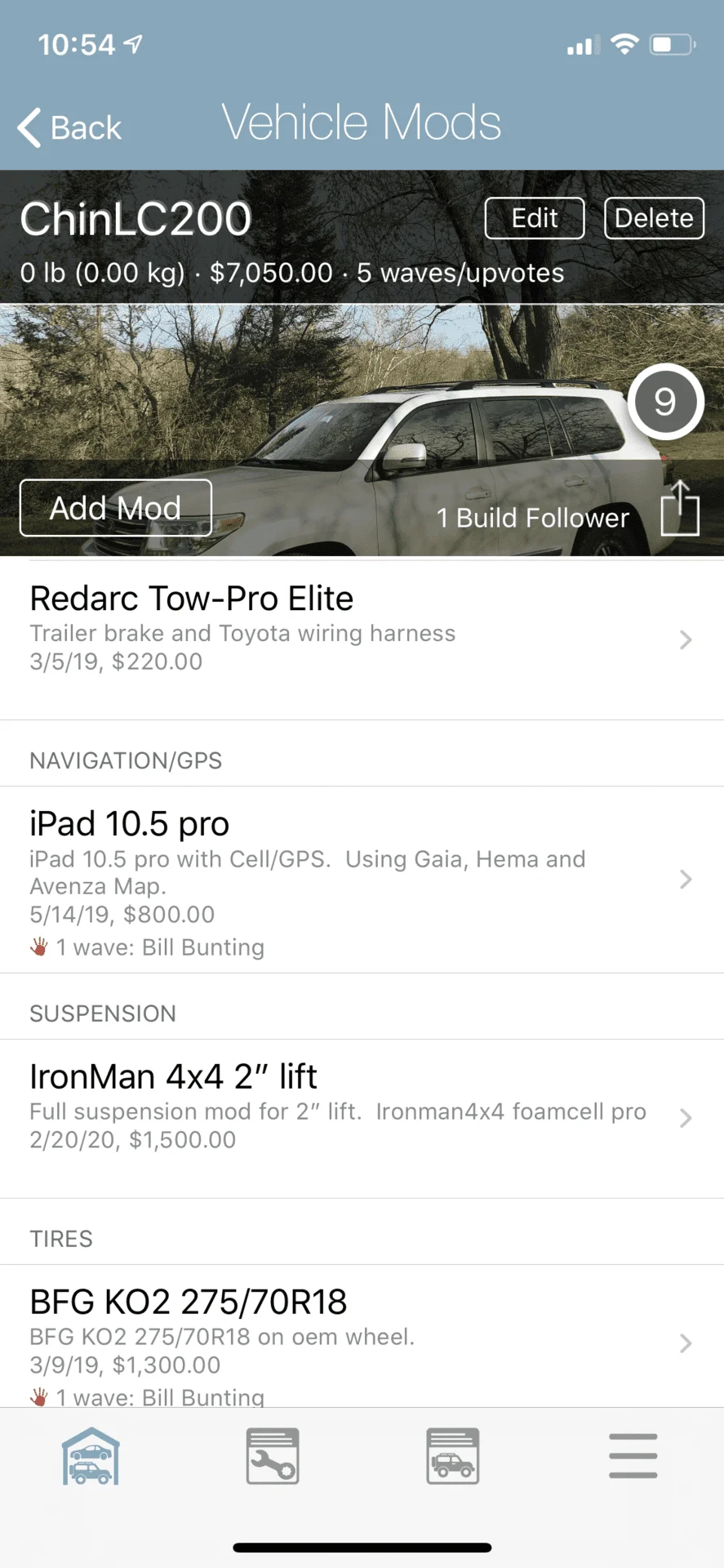

I’ve been using a mobile app to keep track of my mod list. It’s call Auto Modlist (not my app, but I do know the app owner).

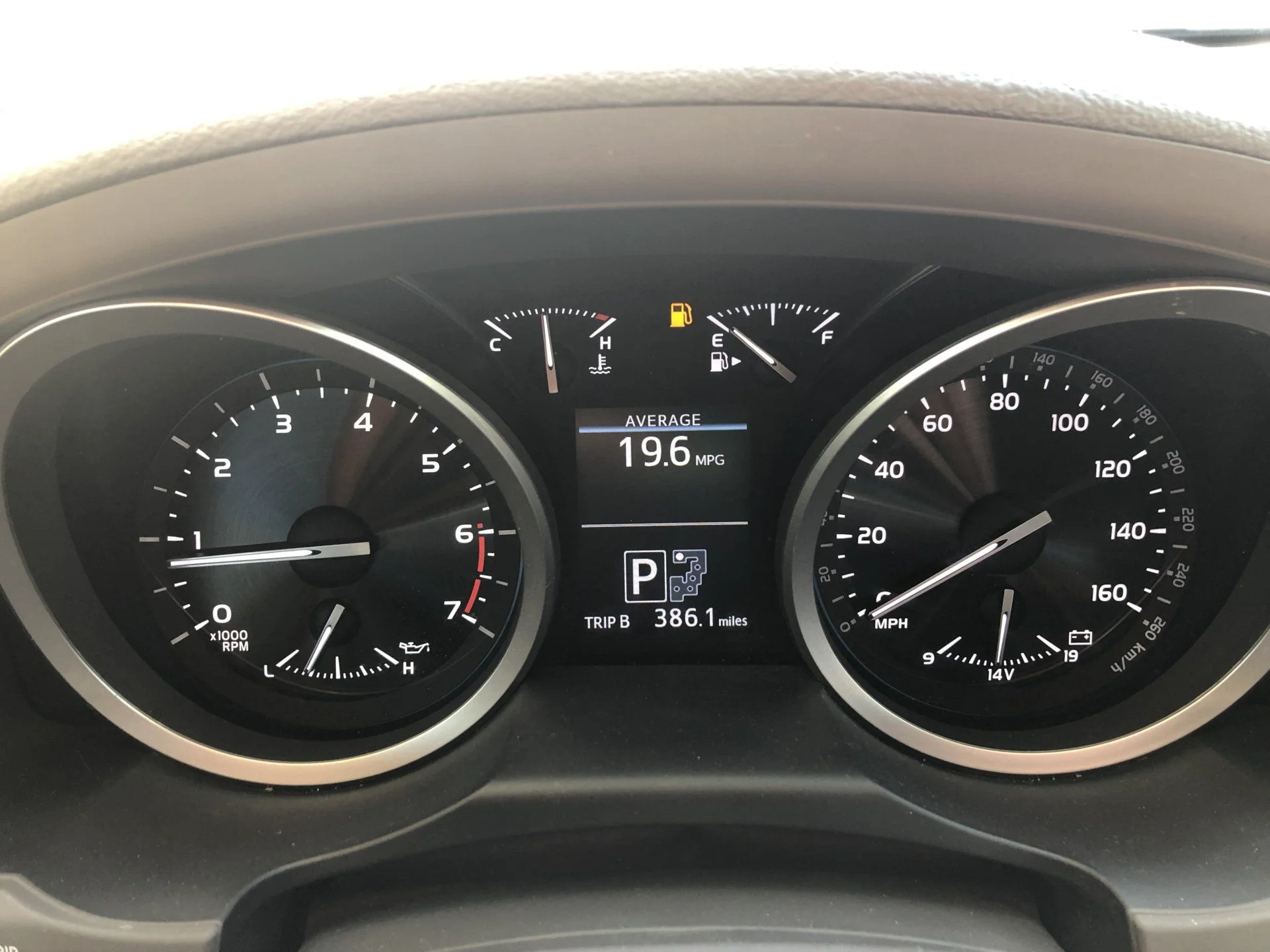

Average 19.6 mpg on the way back from FL with full load. 5 passengers + luggages.

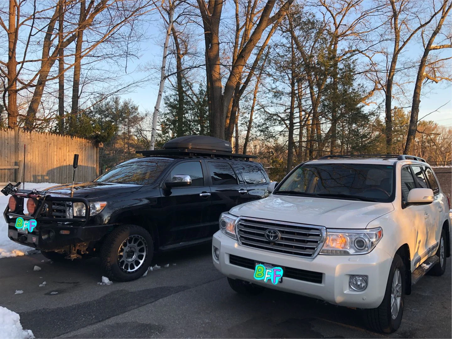

LC200 with older brother, 2010 Sequoia. Both have 3URFE.

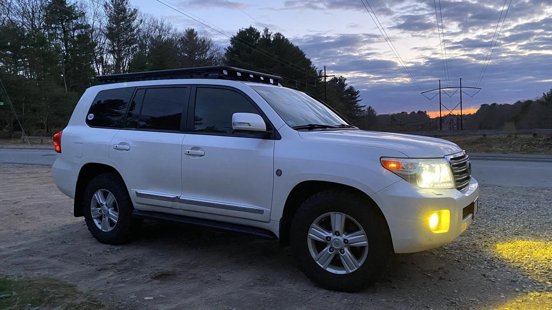

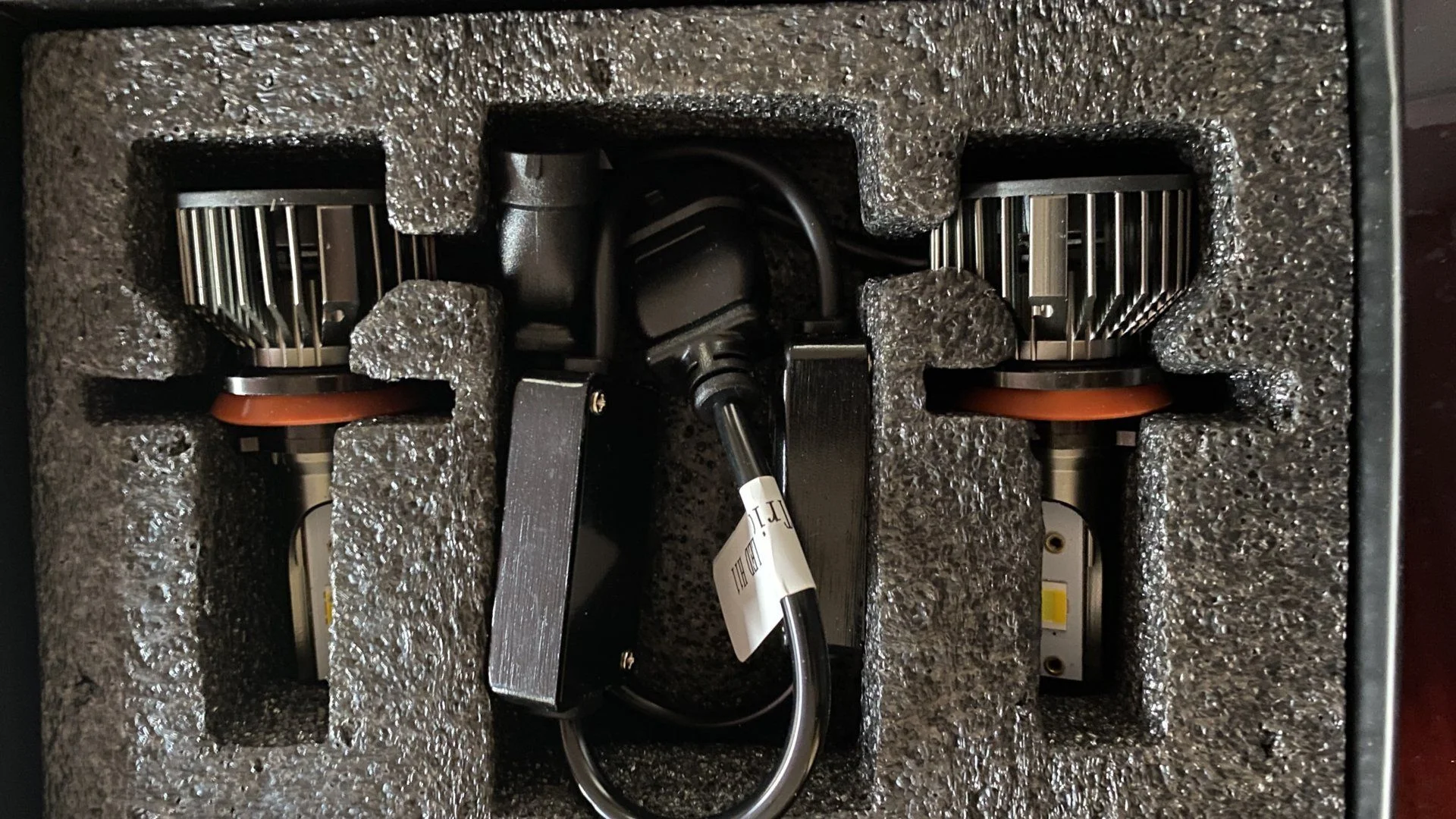

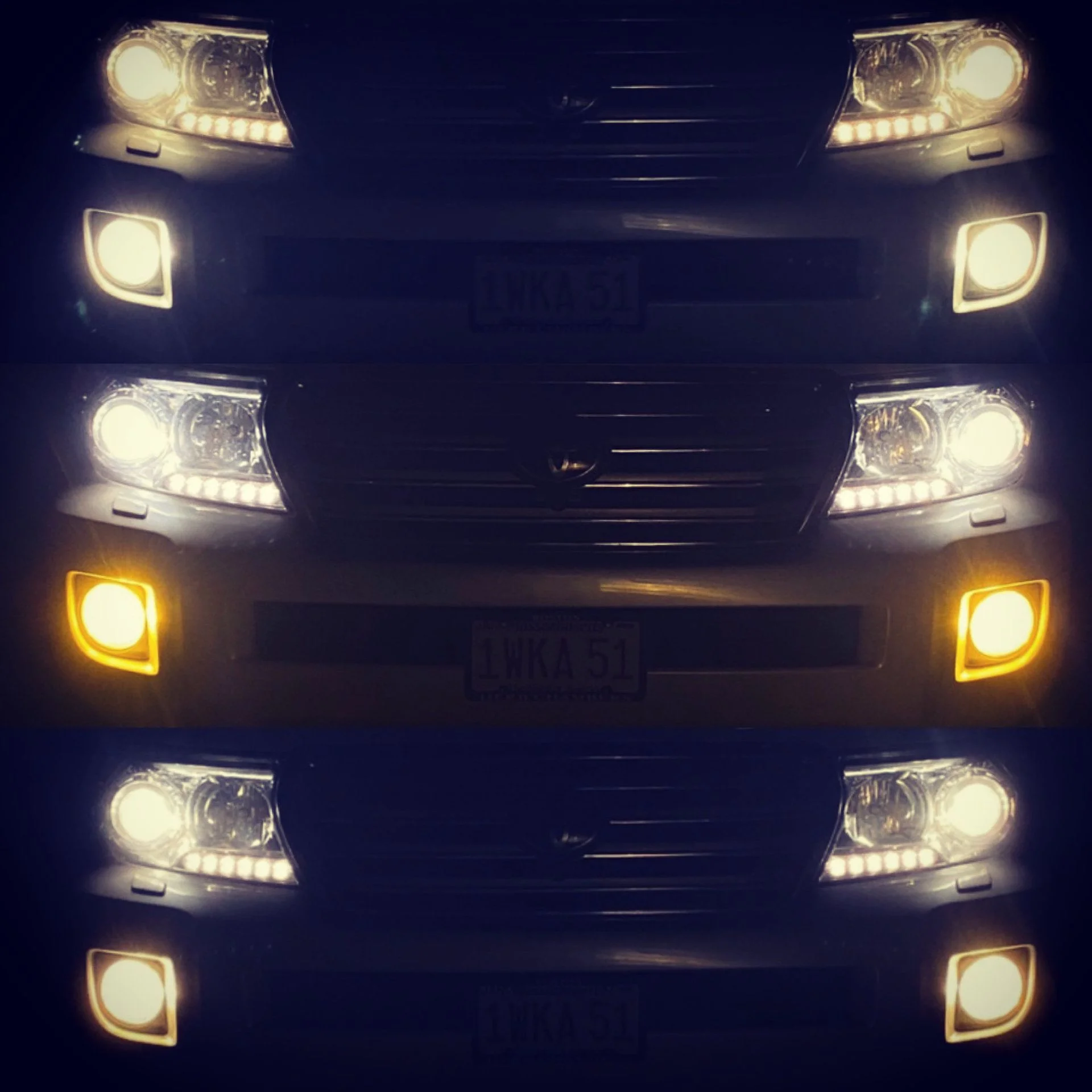

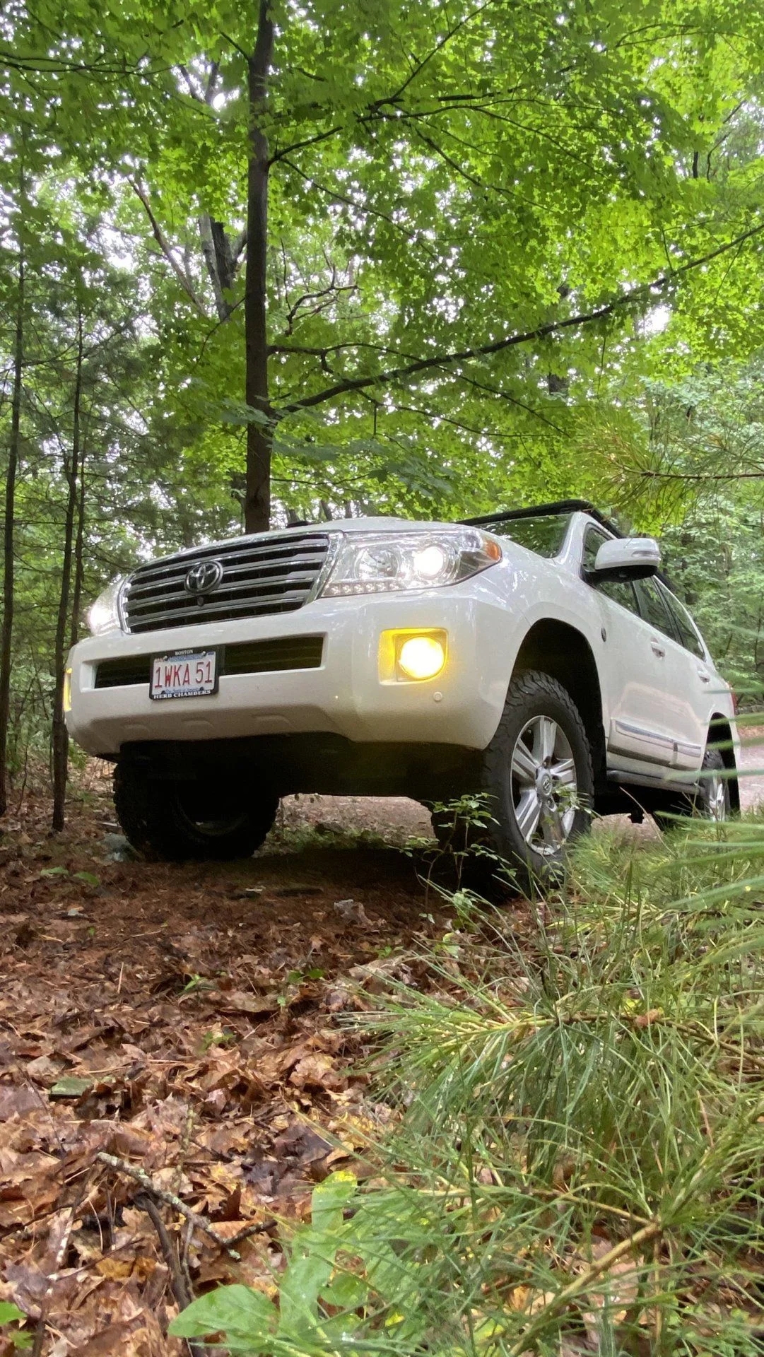

I followed @cboyd fog light modification. Swap out the h16 halogen bulb with caliraised Tri-color LED h11 foglight bulb. The 10000 lumen do shine the road. I can switch the foglight color from white, amber & white/amber combo.

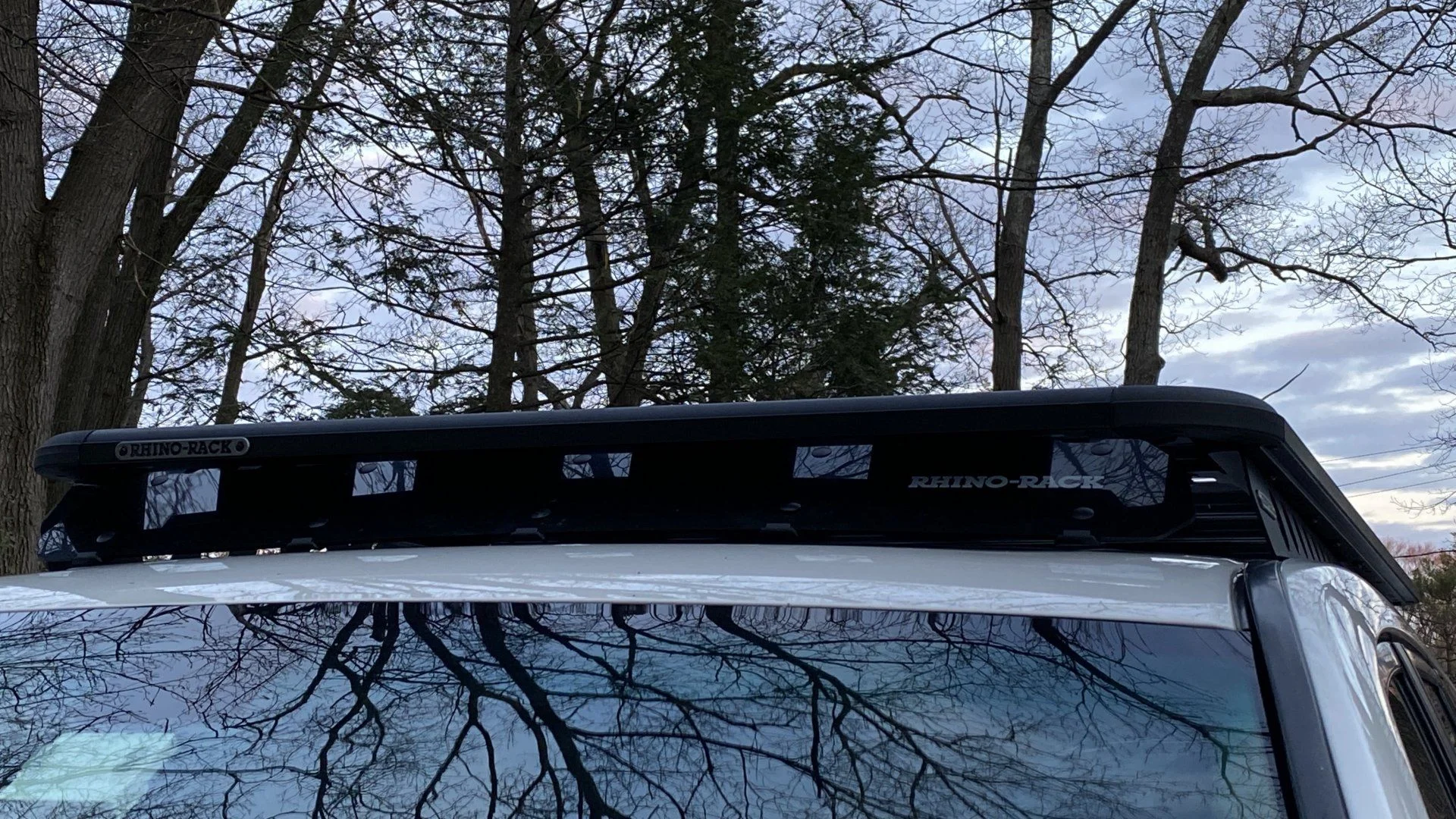

Since coronacation give me more wrench time, I got the roof rack installed. I’m using Rhino Rack Pioneer platform. Got the optional wind fairing too. It does cut down wind noise on high speed.
Coming along nicely!

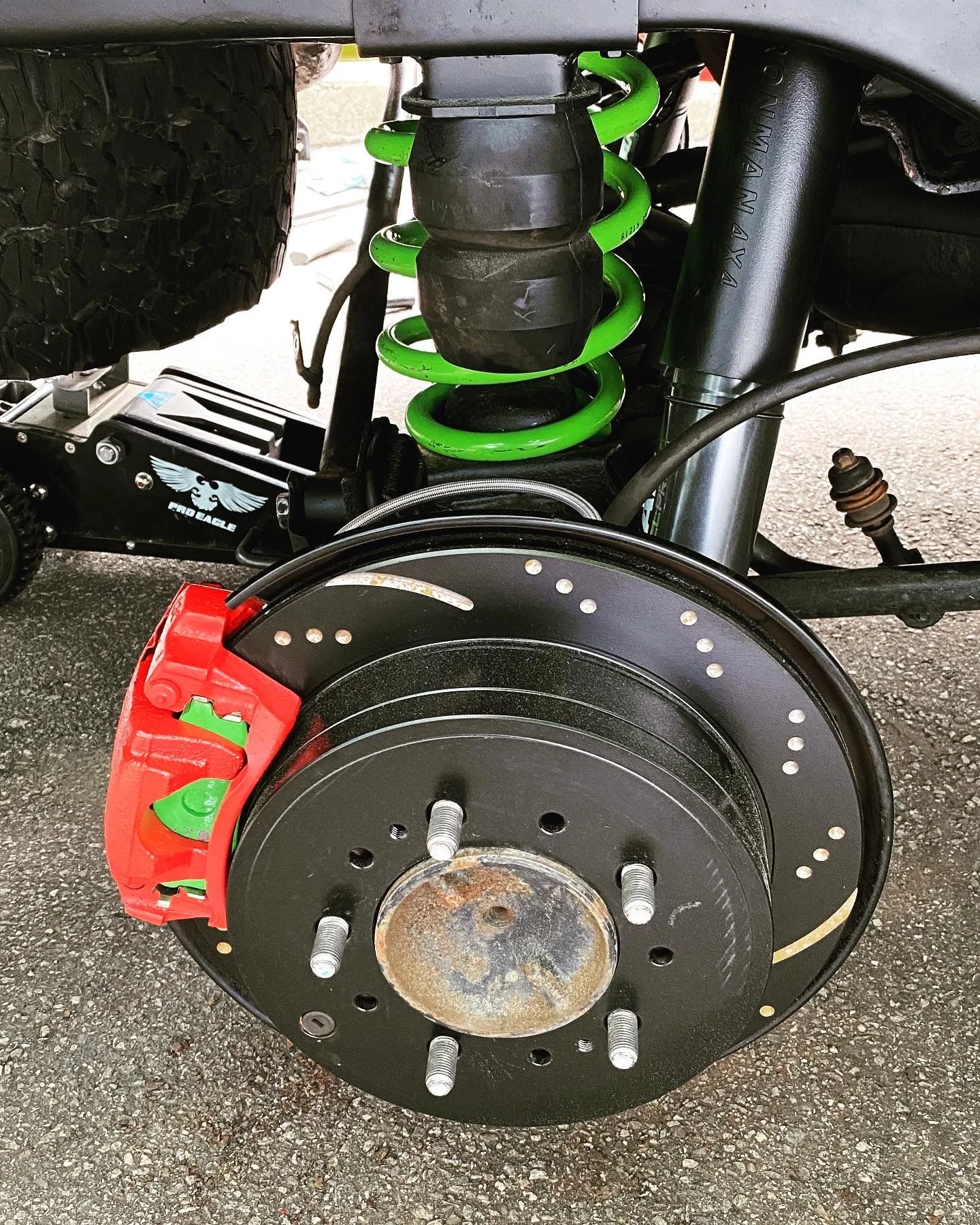

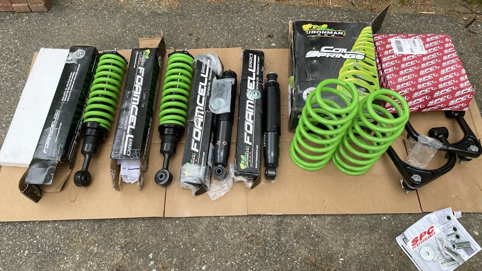

More upgrade in progress. I’m installing a set of Ironman 4x4 foam cell pro 2” suspension kit with SPC UCA.

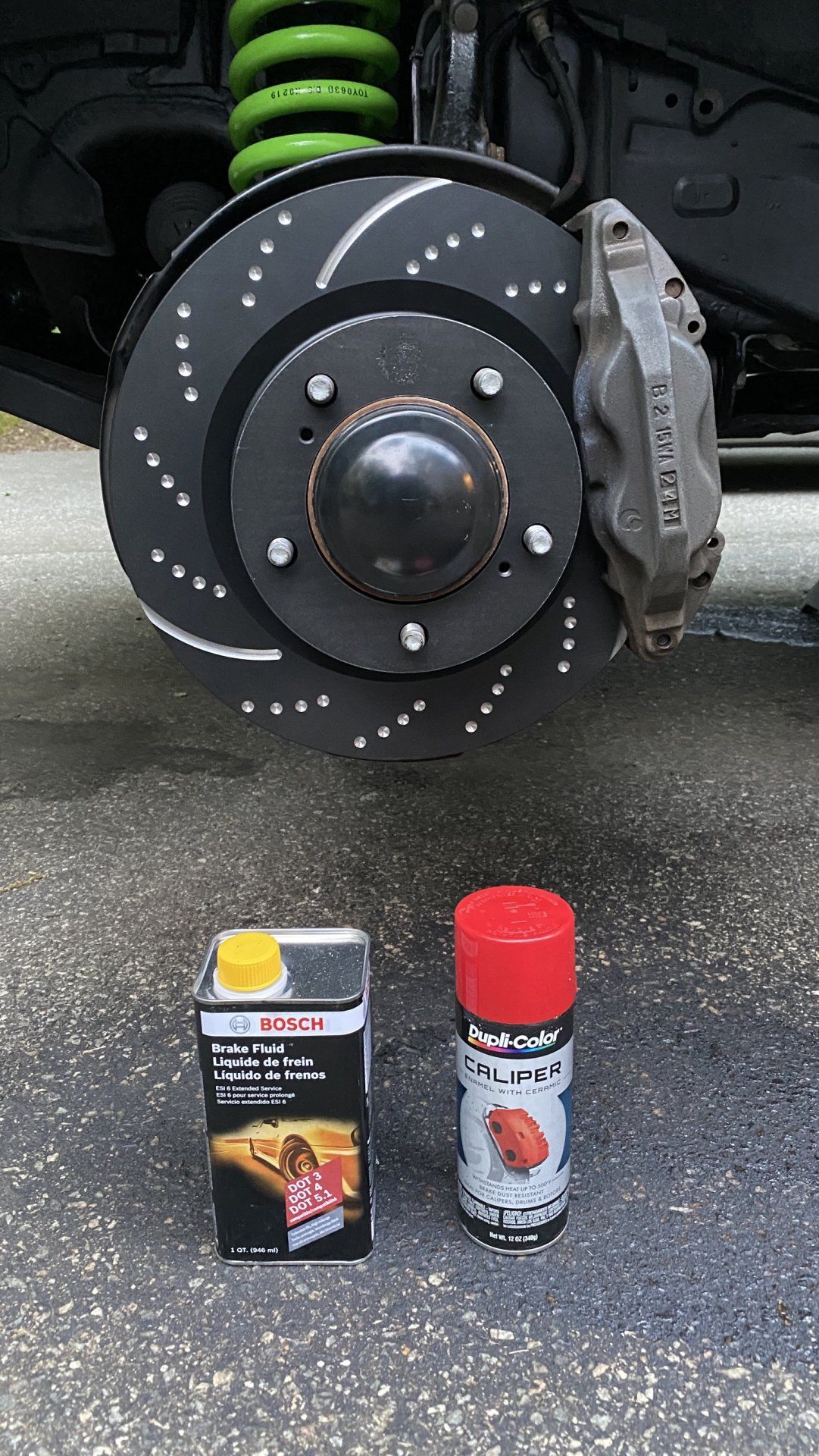

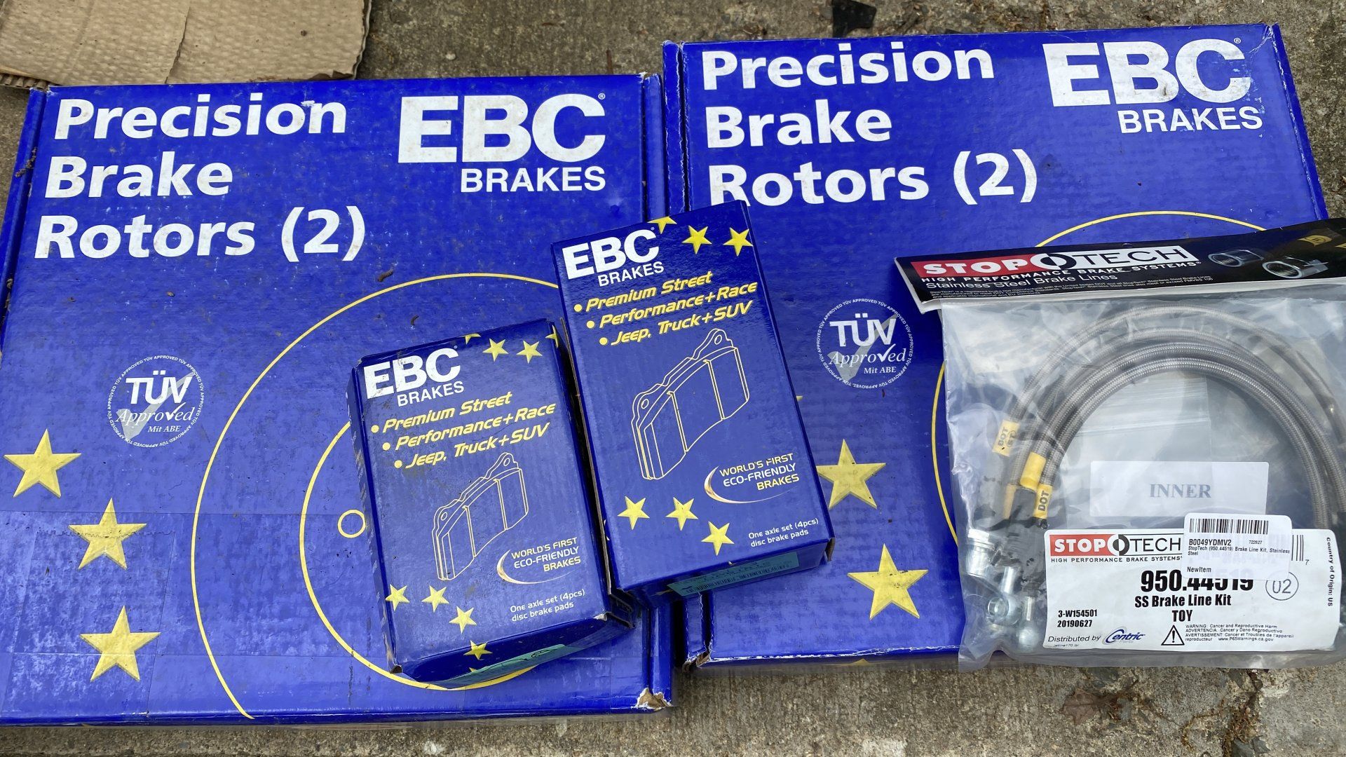

in additional, I will be replacing the brakes with a set of EBC rotors and brake pad. Switching to SS brake line and Brake fluid will be flush/refreshed.

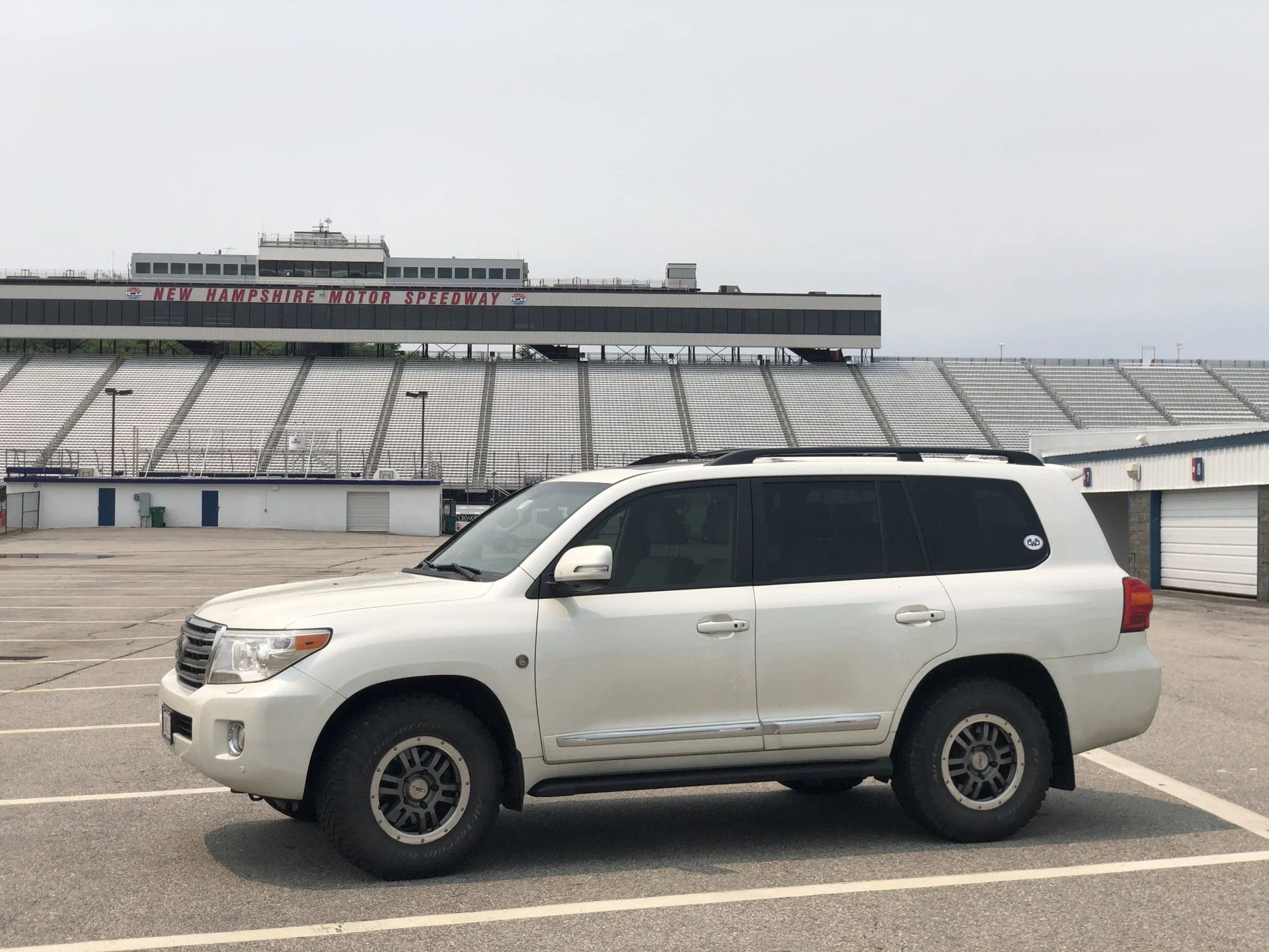

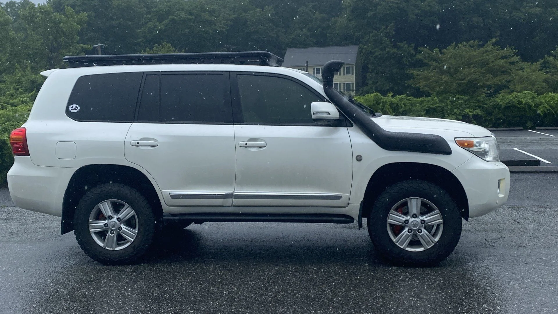

It’s been more than a month since my white beast undergoes some transformation. It’s back on the road with 2” lift & no KDSS lean. Braking is a huge improvement with EBC brakes upgrade, fresh fluid & SS brake hose.
A few more install & before 200LCDC event. Can’t wait till end of July.

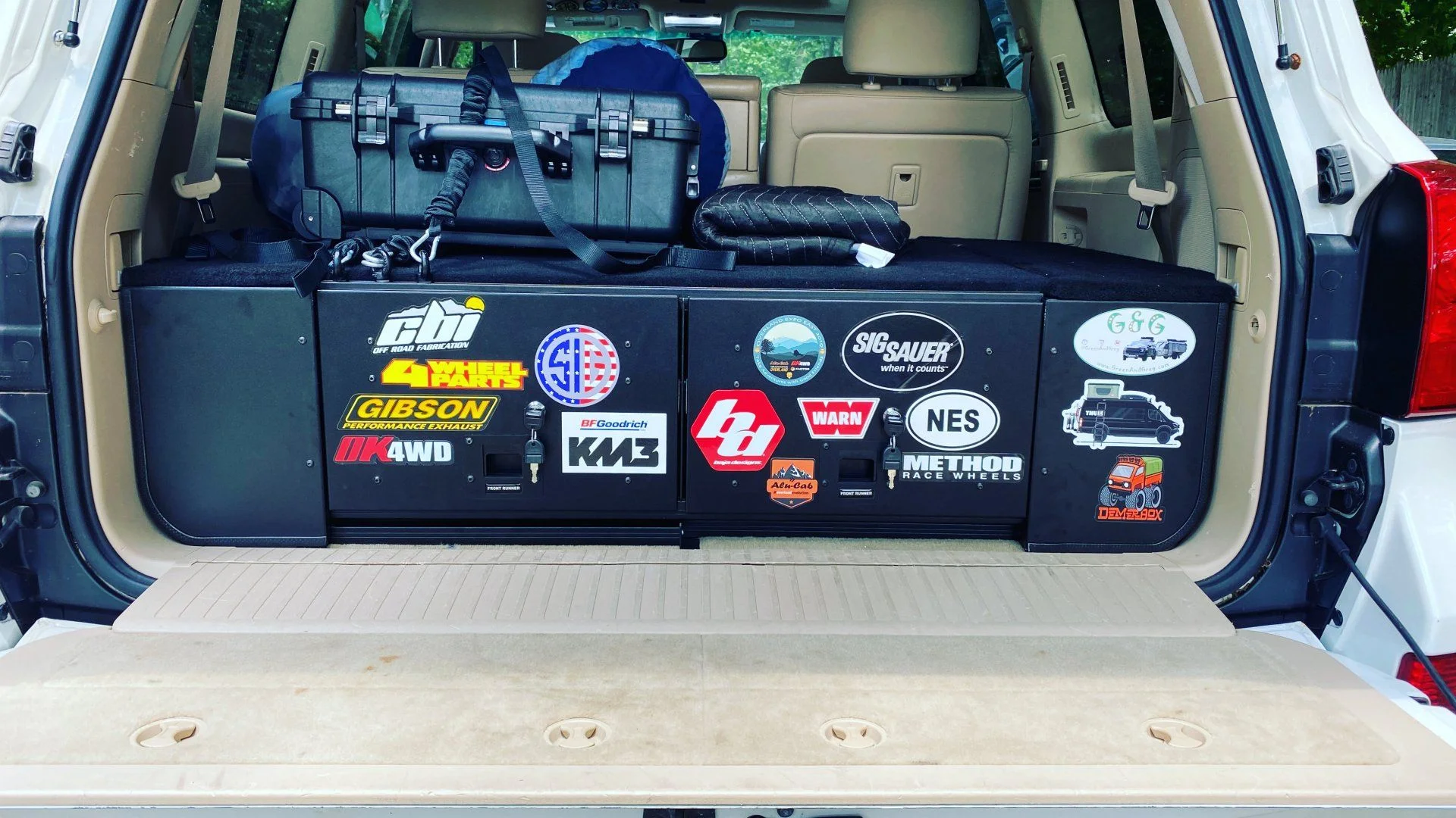

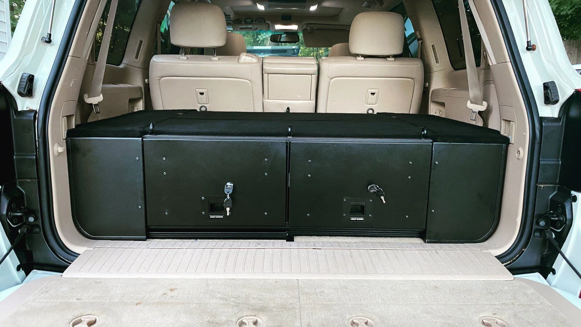

Would you be willing to share more information about the drawers you used, and share a review of them?
@CharlieS this is the drawer system from Frontrunner outfitters.
Initial observation, it is very well made. I see some potential to use the side wing area. I always love front runner solution, but they don’t have much choice like ARB. I would love a roller top with drawer (use as fridge slide), but it’s not a show stopper.

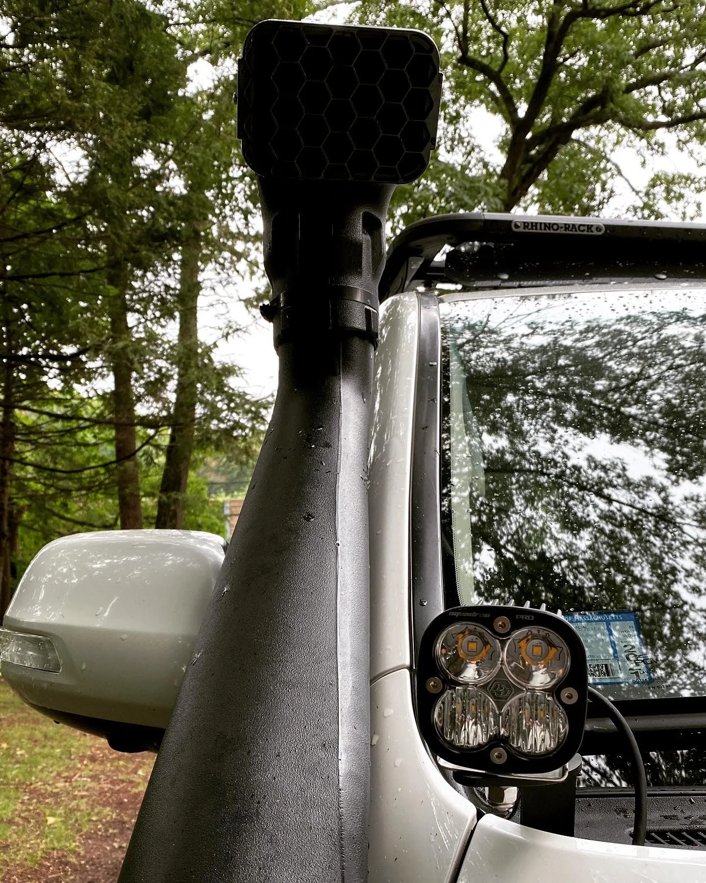

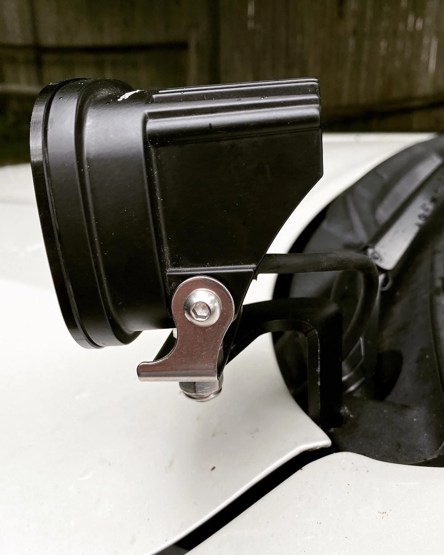

The need for more lumen to bright/shine on the road/trail. I opt to install ditch light. Ditch bracket from CBI offroad and LED by Baja Designs.
Did you have to do any trimming on the windshield wiper valence?
@grinchy I have to dremel the plastic and use black RTV silicon to seal. Else, the bracket will press on the plastic.
