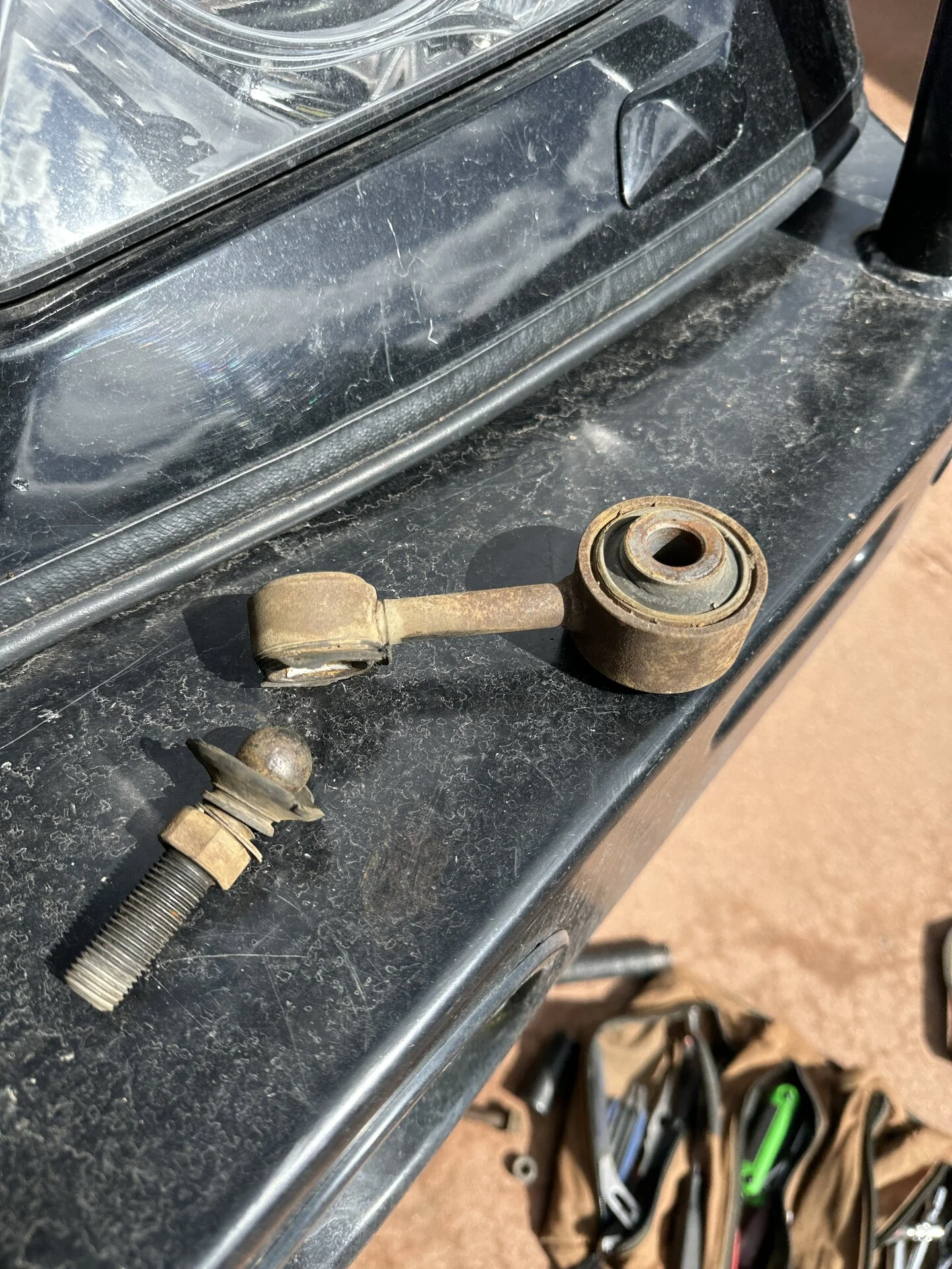

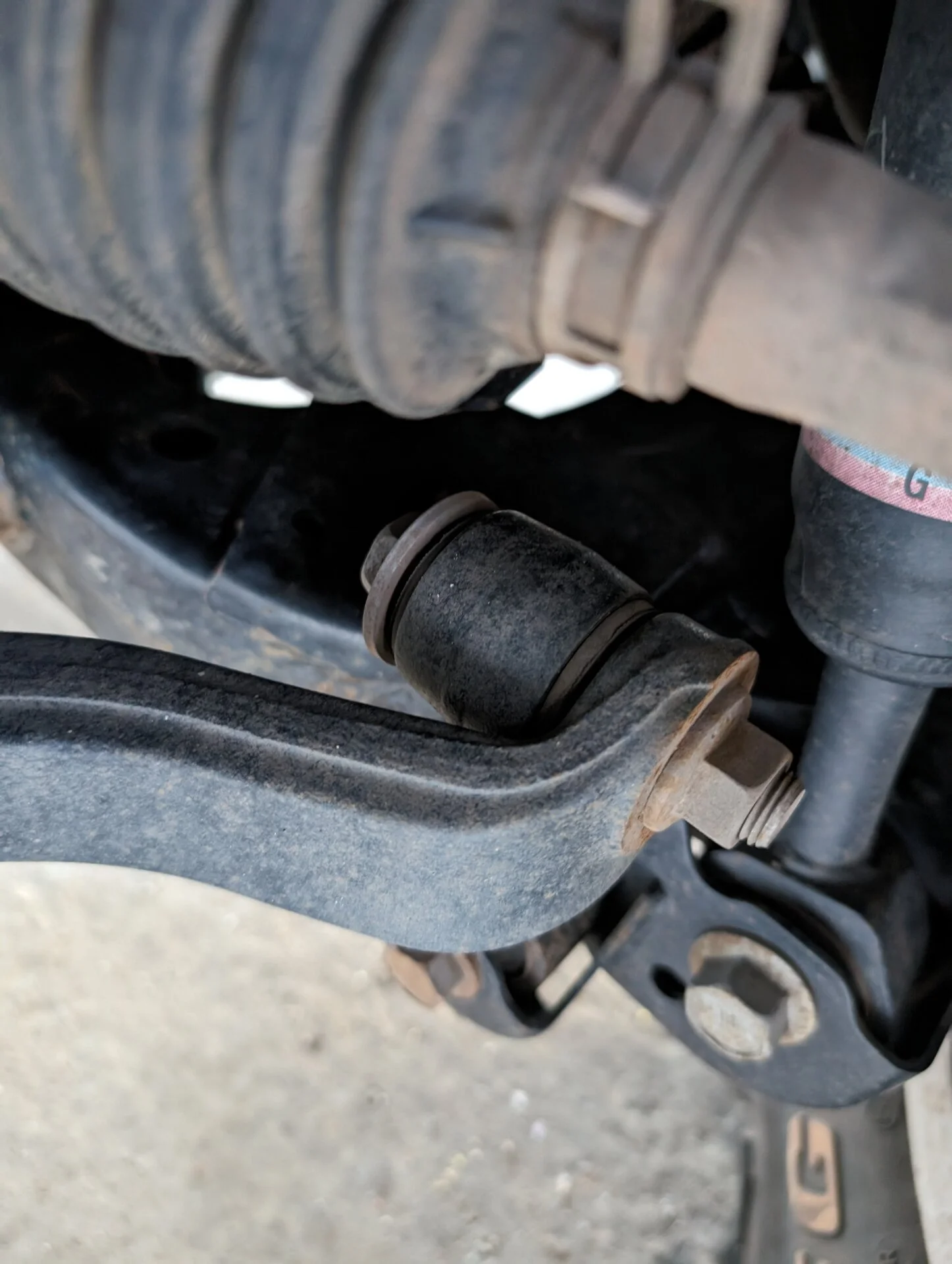

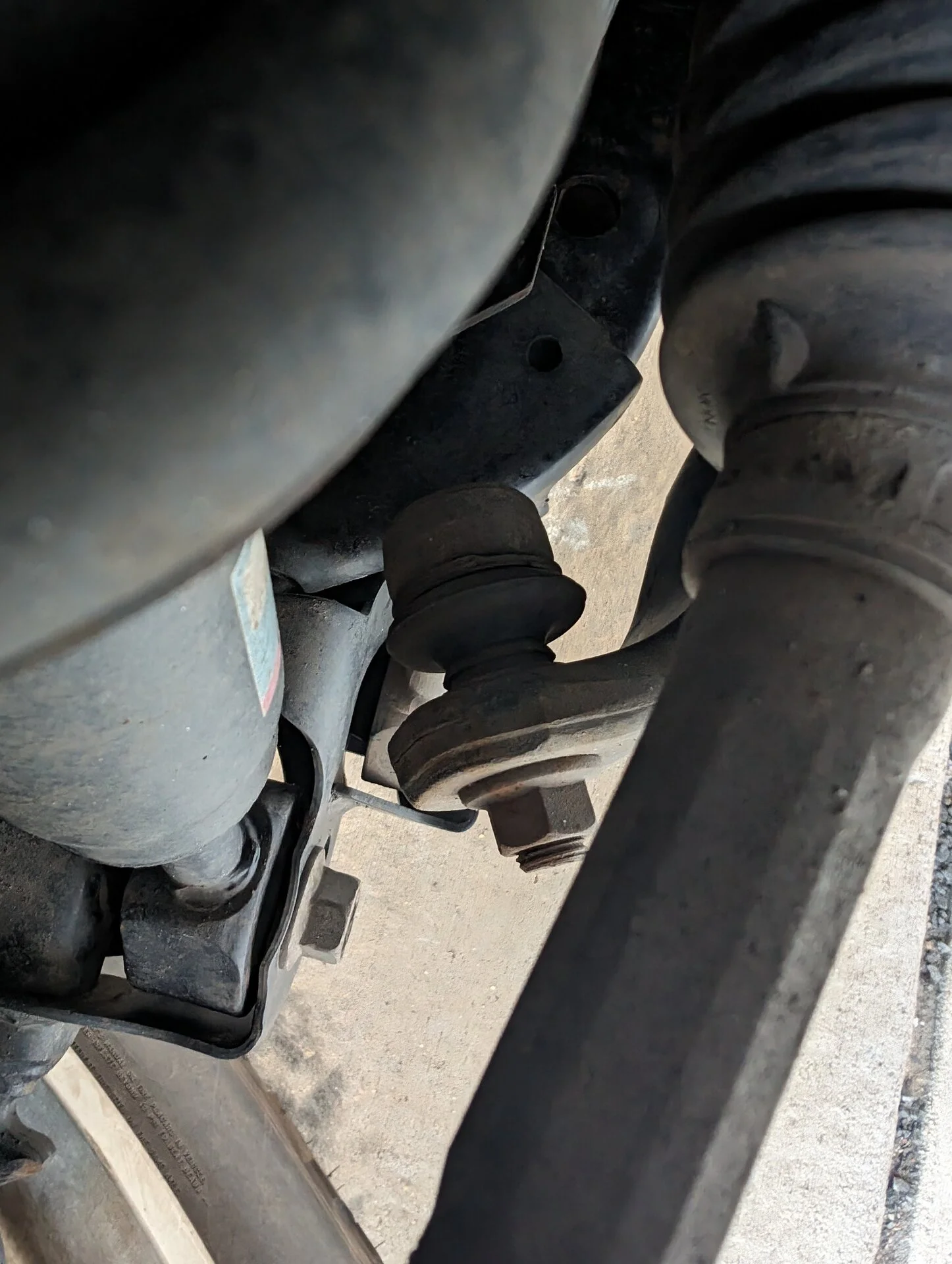

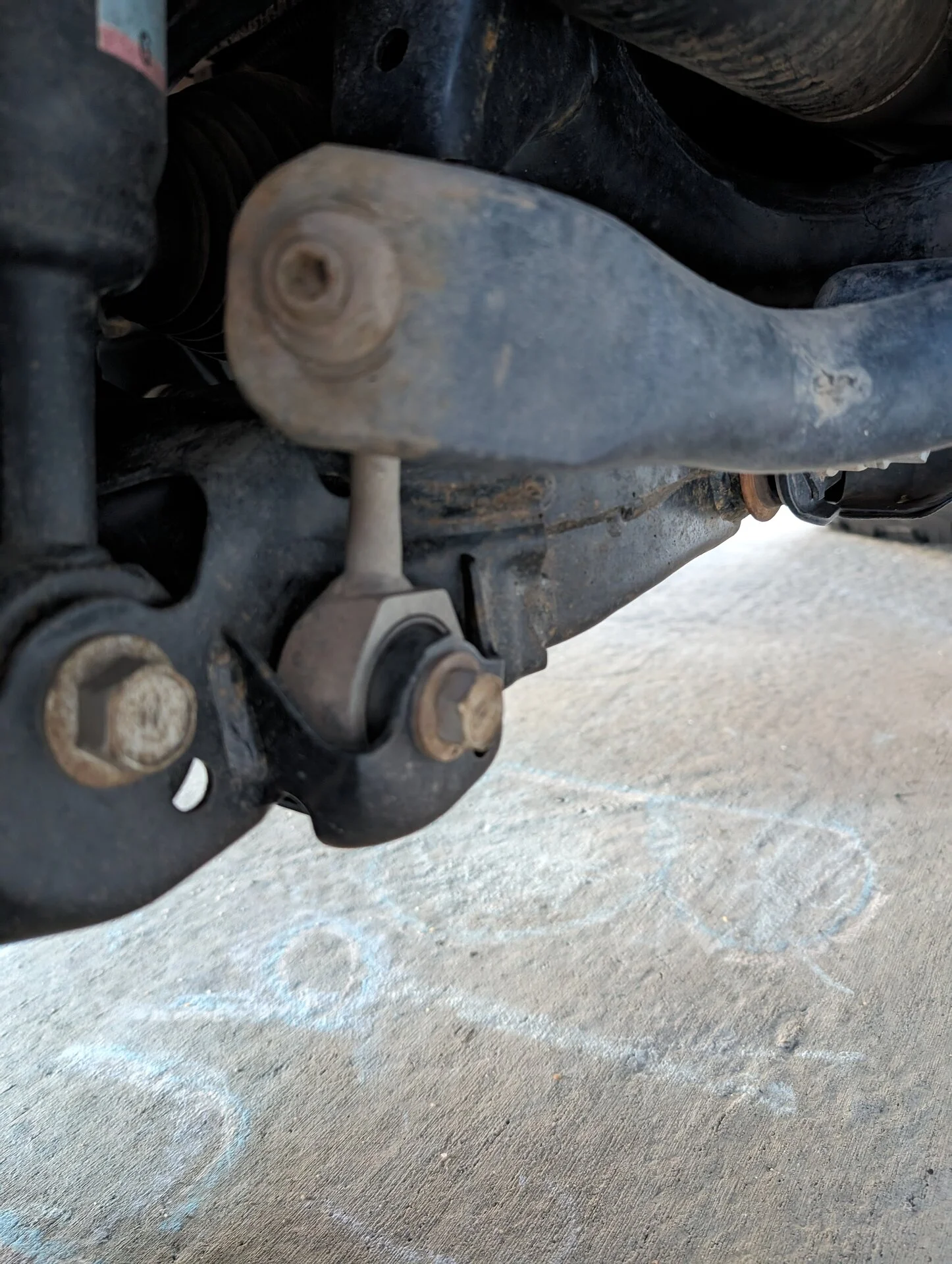

Well this is interesting. I appear to have a new one on the passenger side (non squeaking) and OEM on the driver side (squeaking). I didn't know this had been done. Bought car at 70k miles and driven the last 25k.
The bushing on the passenger side looks smaller than the driver's side.
