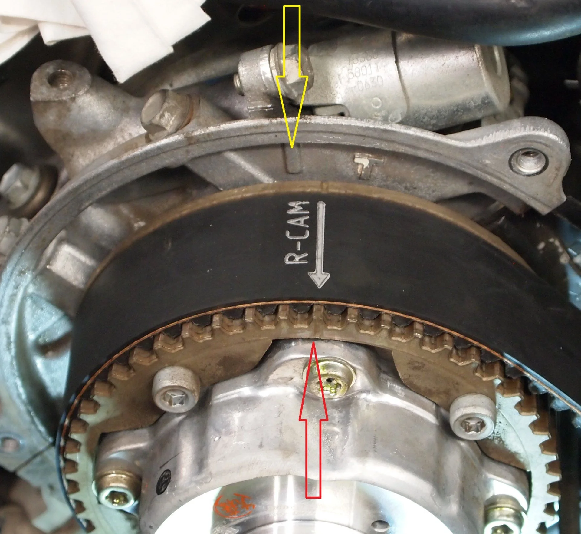

There are "tool" marks on all the associated hardware / bolts that are removed to change the WP/TB so at some point it has been done at least once.
I pulled the timing covers, rotated the motor and inspected the belt and all the teeth look great and the belt even still has all the paint marks on it for lining up cams, etc. It looks near new ( no paint worn off the indicator marks even)
"paint marks" if your referring to belt manufacture marks like these arrows and dots, they don't last long.

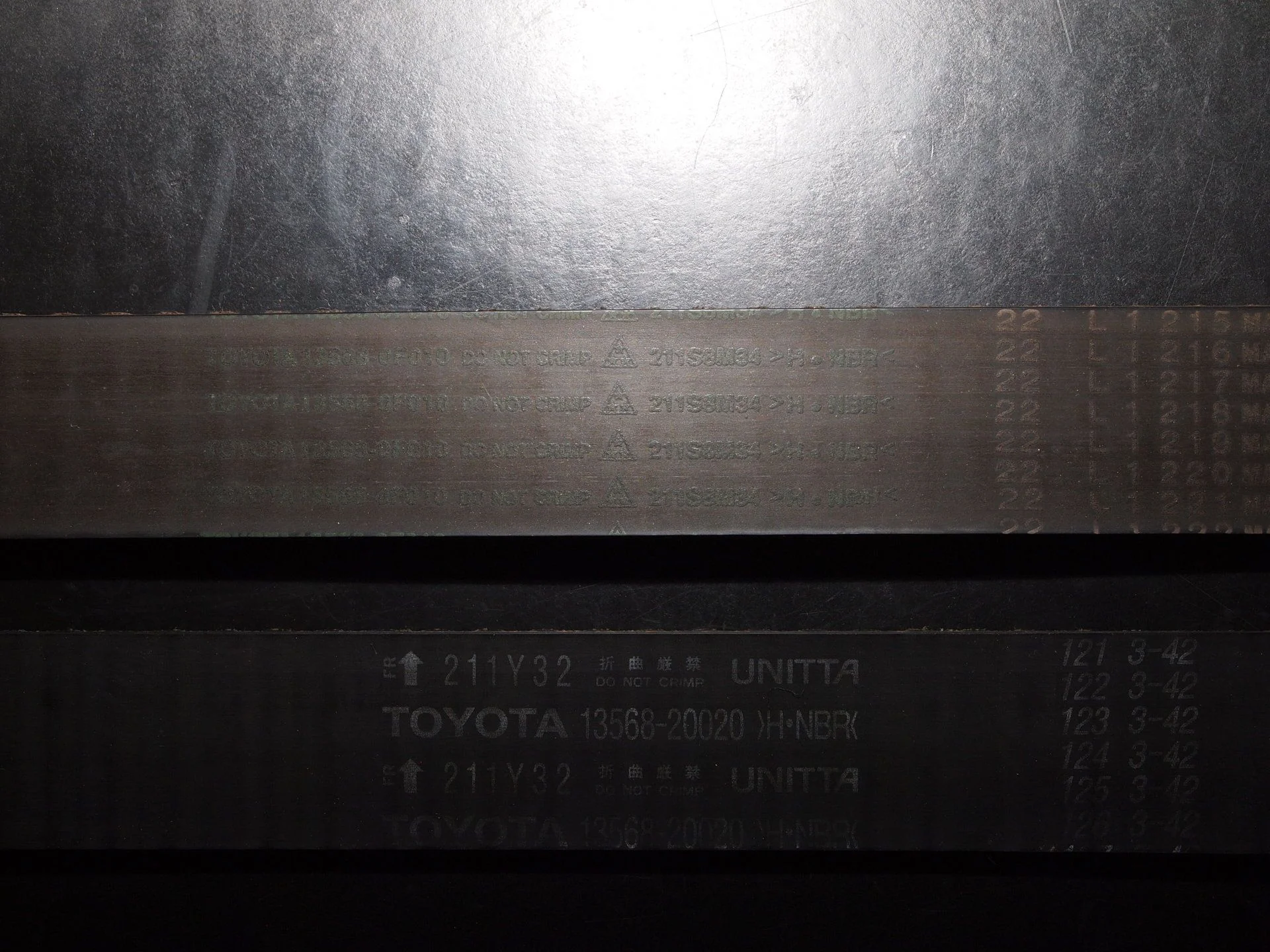

Also OEM or aftermarket replacement belts have different markings then factory belts.

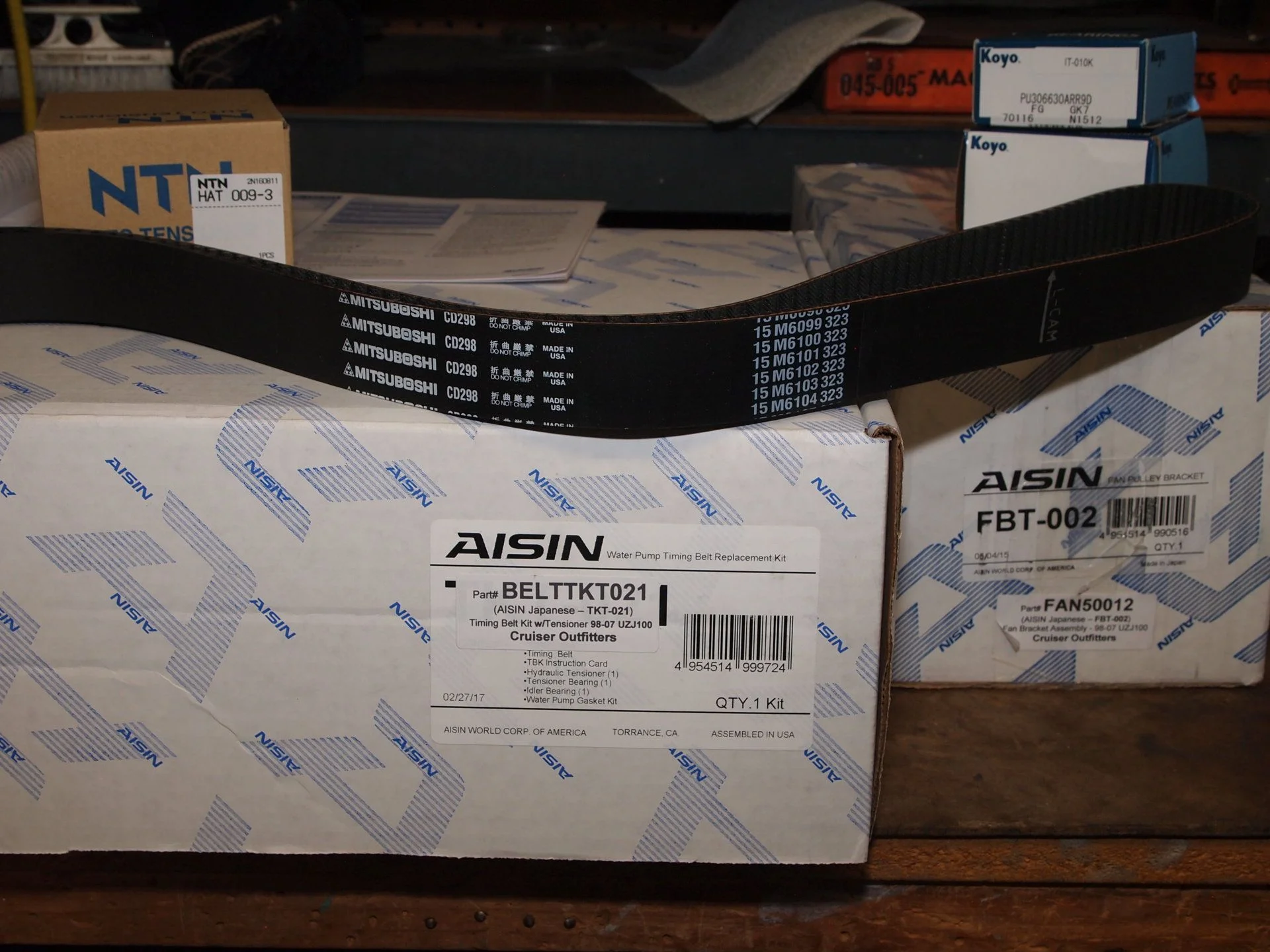

Also some replacement belts are made in USA.

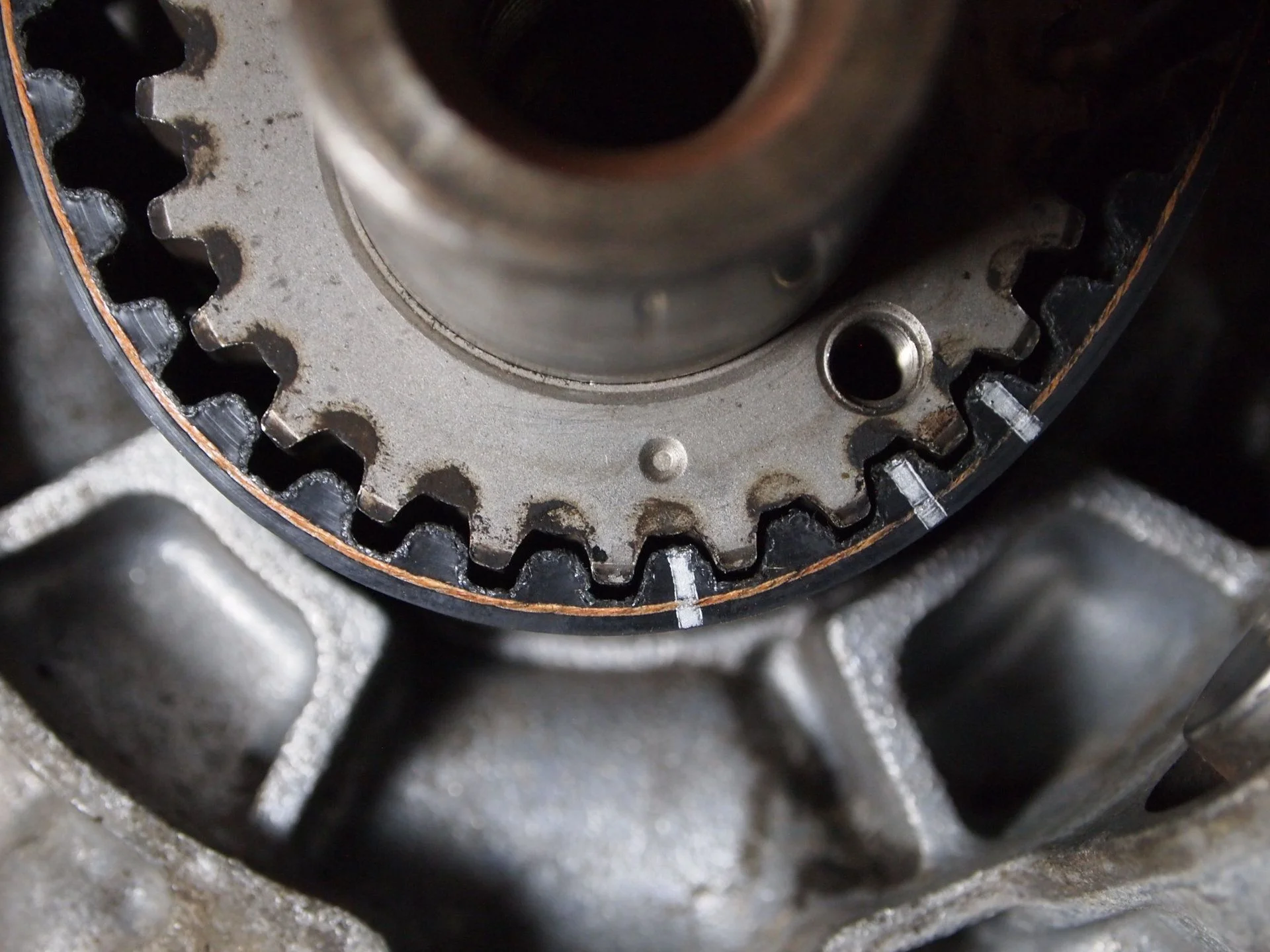

Many clues! If you look in my thread "Merlot" thread (07 LC w/64K no AHC). You'll see in page #6 post #107 clips I always find missing or busted.
Additionally in Something timing belt-ish failed post #138. You'll see marks that are often made on harmonic balancer doing the job.
