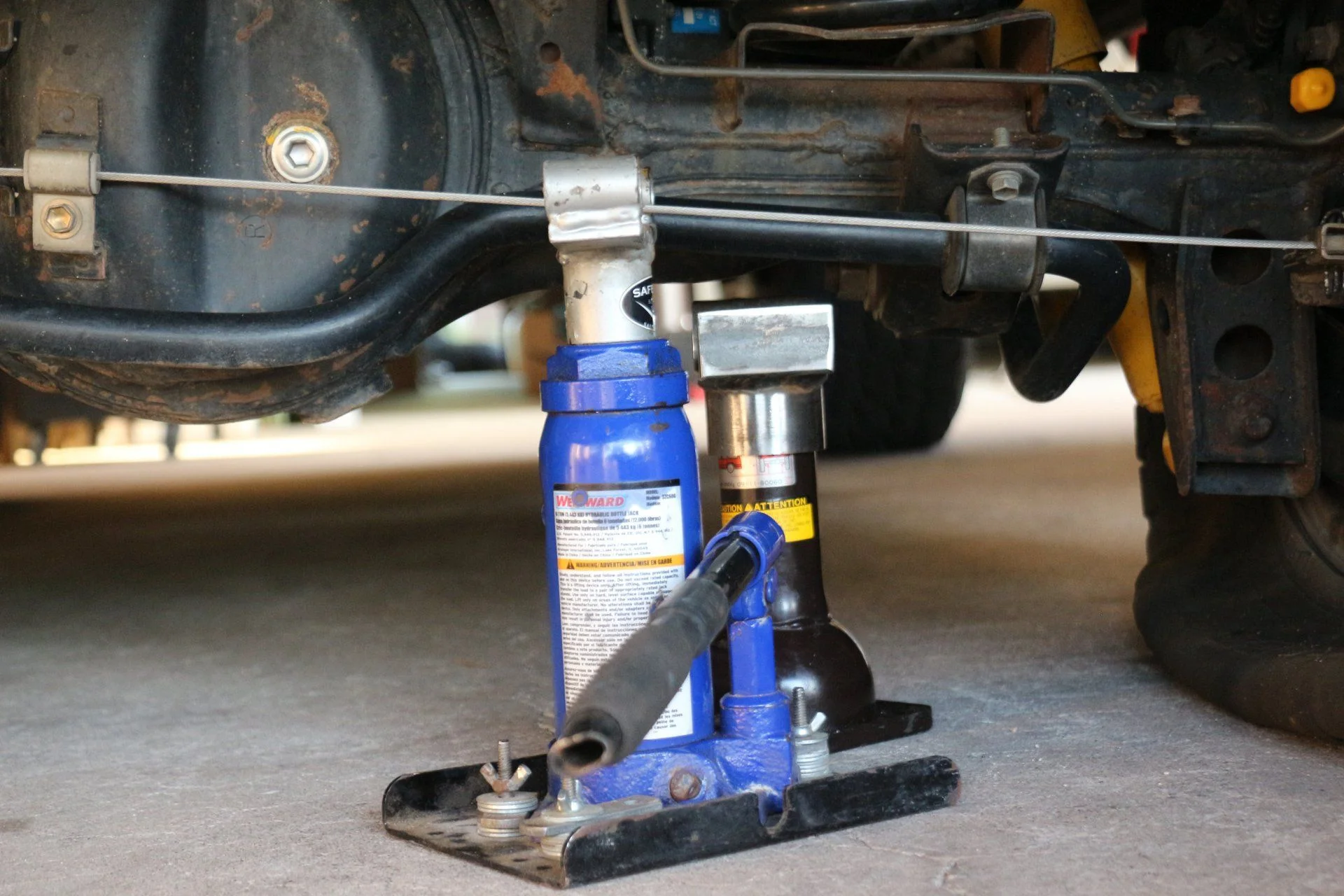

Safejack does not fit under the axle with a flat tire. :meh:
