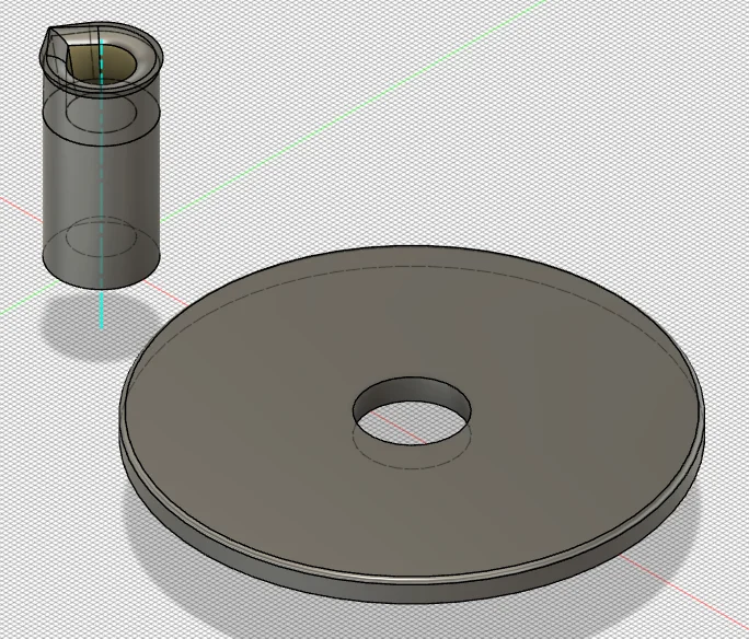

This time it's a cutting fluid brush stand for the lathe and drill press. (Now I get to buy a mill too to justify that brush stand fully... Yea! )
The idea is to have a small vial that the brush tightly fits in upright and where I can pour just enough cutting fluid to wet the brush for that part, so less waste or potential spillage.
I made the vial removable from the bigger base so I can empty it or store it all easily when needed, but still fitting tightly enough to stand upright securely when containing a liquid. I'll print more such vials as needed.
Gave the vial a little funnel lip so less mess when emptying, and a chamfered top for the brush to slip in more easily and to scrape off excess fluid.

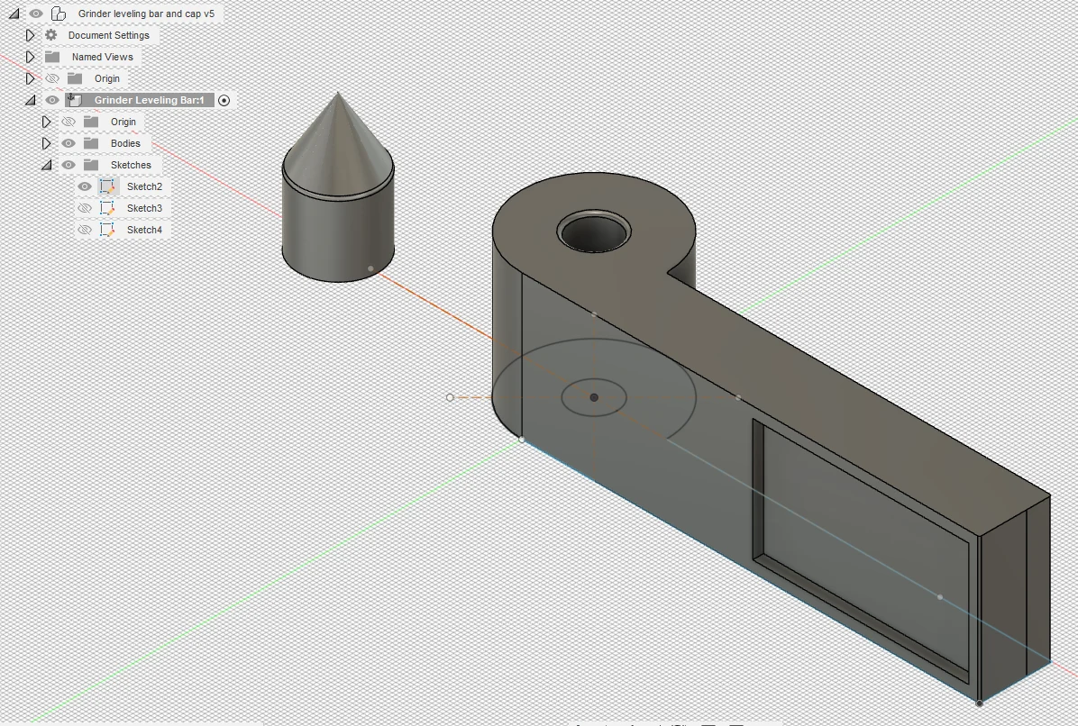

Starting to think about printing some jigs for lathe tooling-sharpening on my grinders.
But in the meantime, just a little tool to help orient the existing tables on the grinders in line with the shaft axis - IOW perpendicular to the wheel surface. The recess is for my electronic angle finder. This way, I can easily set up a known angle on a tool face when sharpening it. Will also be helpful when I set up my drill bit sharpening jigs. The pointy cap is to figure out more precisely the height of the centerline of the shaft when needed, and also useful on the lathe to align tools :
