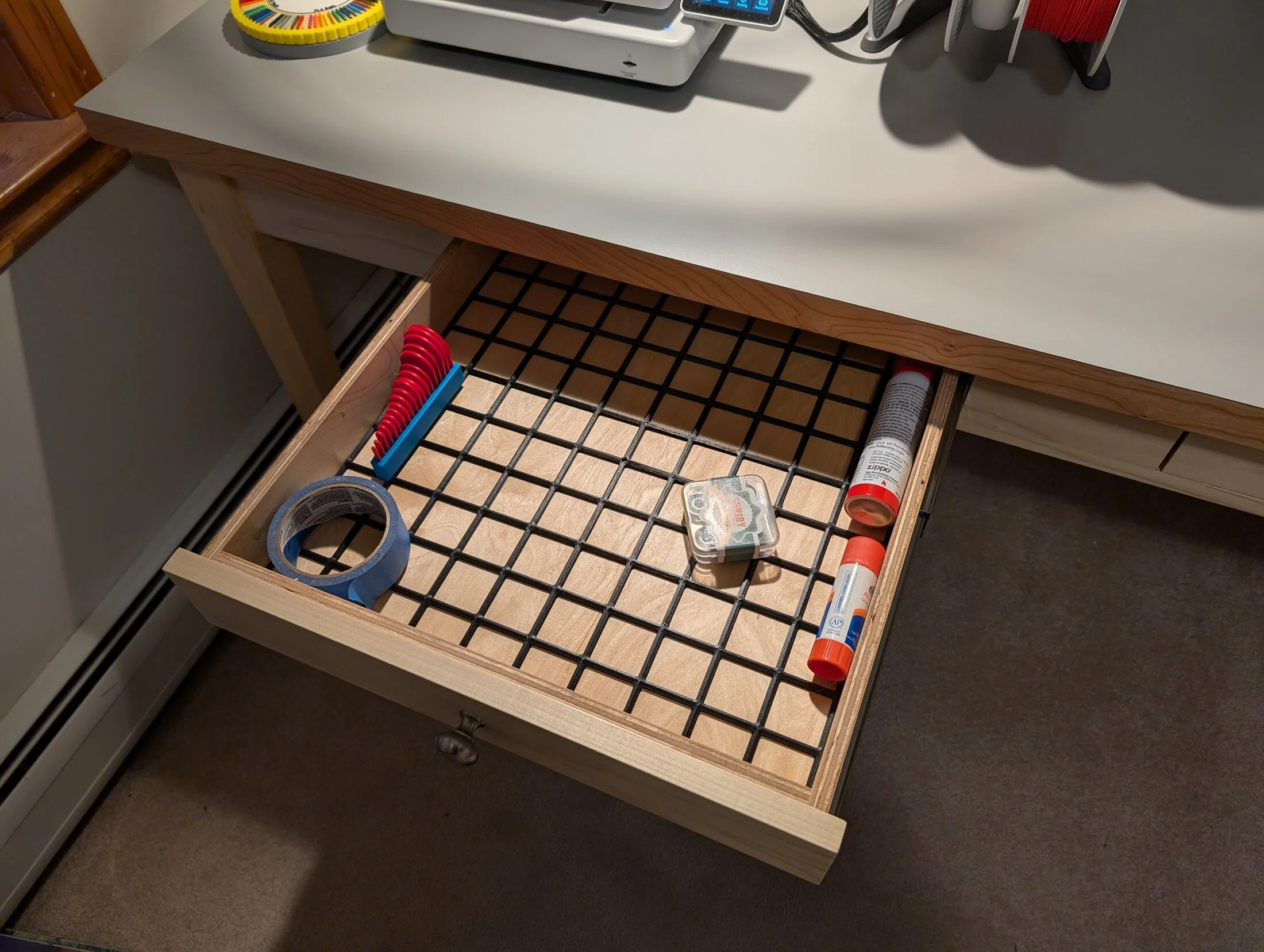

Just finished building this new table for the printer station, and filament storage
The top is actually a hollow core door I found at the local Habitat Restore for $10. I cut it down, hacked out the cardboard spacers at the edge and reinforced it with some 2x4 scraps, then applied a hard edge of cherry. It was kinda beat up so I applied a layer of gray Formica laminate. Aprons are poplar, legs are pine.
Gonna try some Gridfinity modules in one of the drawers
that is some good-looking fine woodworking there, Sir!

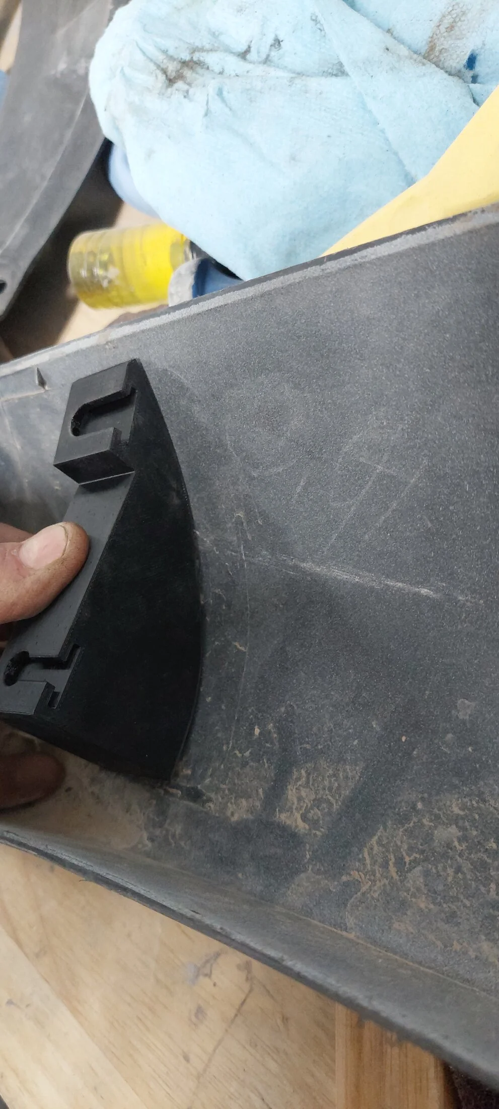

The body bois broke an 80 fender flare mount, so I made a replacement they panel bonded in.

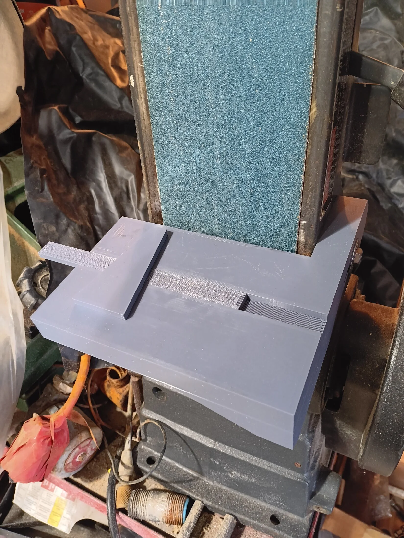

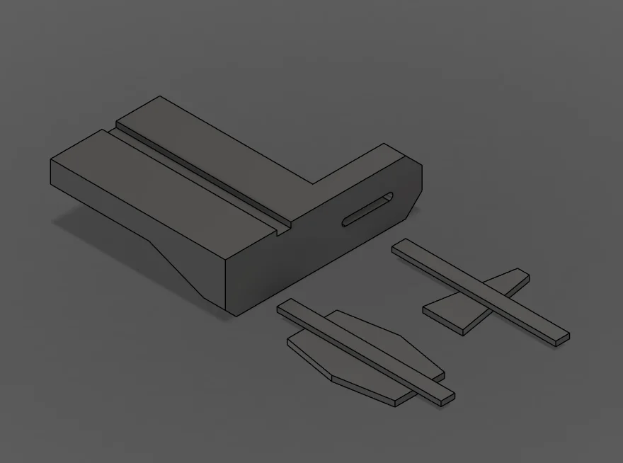

let's see if this works out...
oooh yea! Works a treat! (Finally... Can't believe I used an awful tiny quasi-rest for so many years....)
Primarily intended for my lathe cutting tools. Bonus: so easy to print jigs for different angles.
And if you're wondering, yes, it is plenty rigid.
added: Dang! The ground surfaces I am getting on my HSS cutters are perfectly flat and beautiful, well at least compared to the potatoes I'm usually grinding freehand...

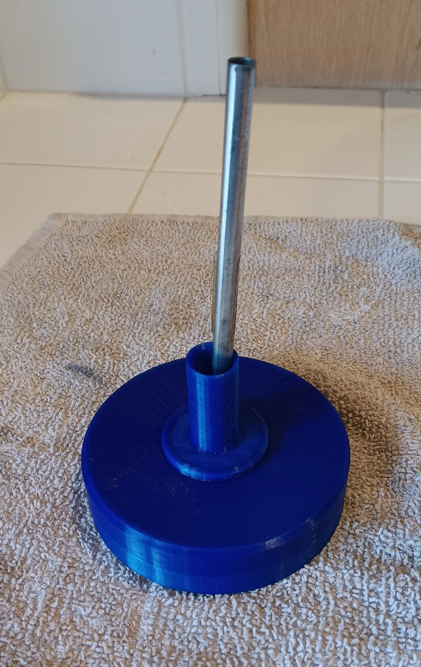

another (does a DIYer ever have too many?) cutting fluid container, but this one is a (almost) no-spill design:
(and -yes yes- I know, a tuna can is easier and would have the fluid taste better.... :) )
I may fill the base partly with lead shot so there is less fluid in there and it is more stable (but already very stable as is actually).
obligatory 3D printing tech content : since I didn't want to waste a ton of filament on supports, I printed the upper funnel separately, and then glued it on. (I am also curious to see if the fluid will affect the glue (IPS16) adversely.)

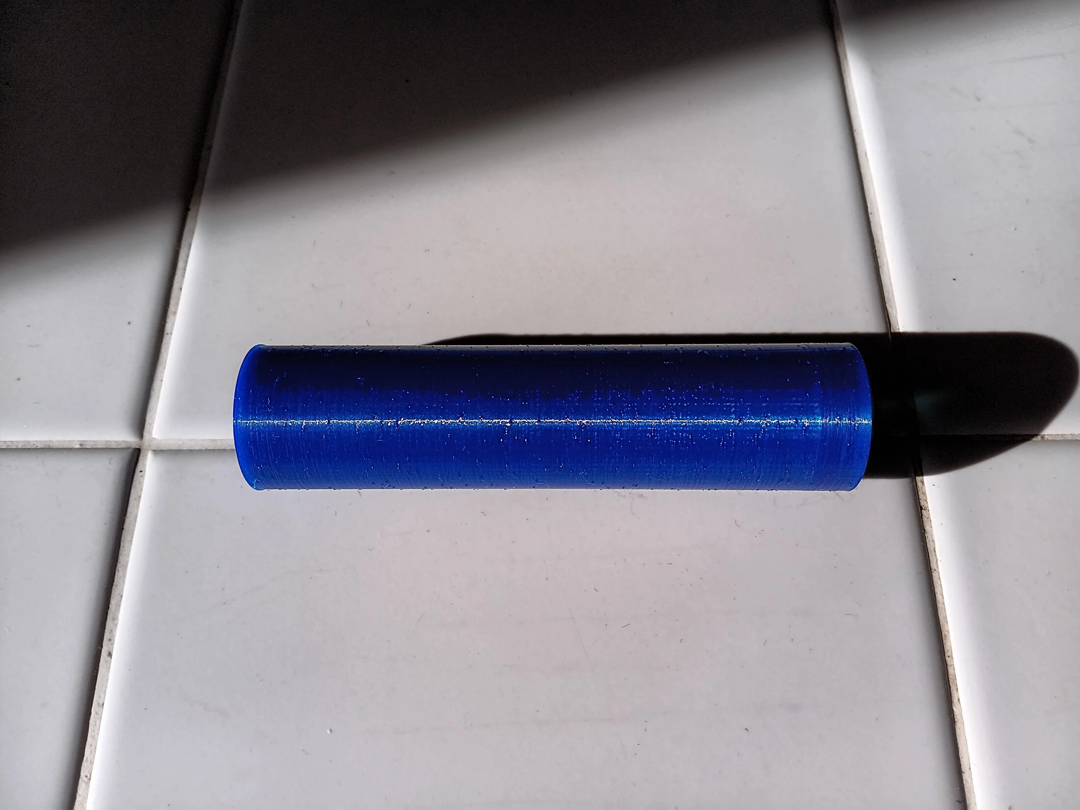

Played some more with threads. This is a hollow container with a screw-on cap. As printed, no sanding or smoothing of the threads (or of the body - you can tell the rough surface from the random seam feature). Check out how close to invisible the contact interface is. You can sort of see the cap but mostly because of a slight coloration difference -probably due to a different wall thickness- and a different surface finish. But seeing the contact interface as in there being a gap? Nope! Pretty impressive technology, really.

I've done a few Gridfinity things to go inside the drawer on my printer table, not much though.
But I see no value in all these organizers for toolboxes that holds everything nearly in cells, it's just a waste of time and filament. If I need a pair of pliers, I can easily find and grab what I need from the pliers drawer.
