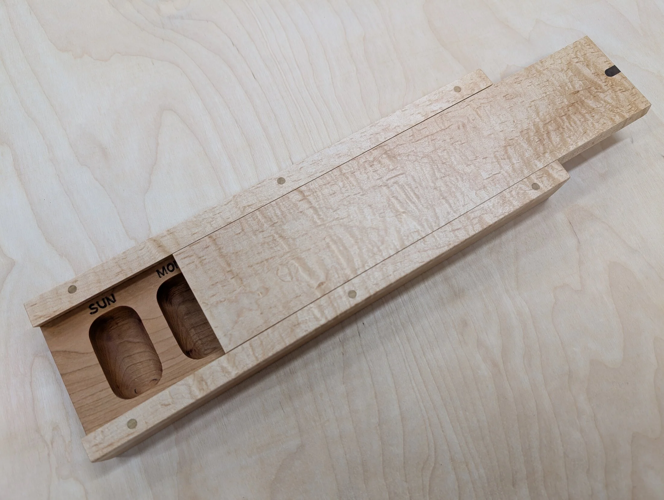

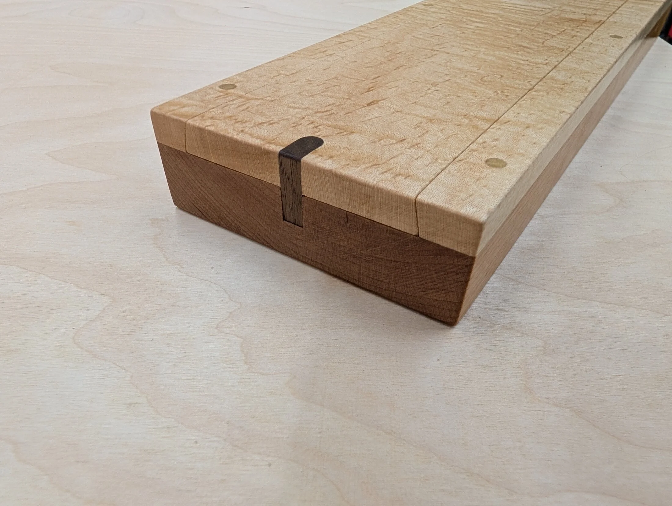

I got my printer primarily for woodworking. Just finished and delivered a project yesterday, where I used the printer to help in the build.
My daughter is on several meds, and asked for a weekly pill sorter for Christmas. I took a look at them on Etsy for ideas, most have round-bottomed "wells" to make getting the pills out easier. I knew I could use my router to form them, but needed a template to guide the cutting. Bambu printer to the rescue! I haven't learned a proper 3D modeling tool yet, but I remembered that AutoCAD can export to .sdl, so I knocked this out, imported into the slicer, and out it came an hour later. The round holes are just to save filament.
Bottom is 5/4 Cherry. Top is a piece of scrap curly hard maple. Dovetailed slide with hidden rare earth magnets to keep it closed. Pretty happy with how it turned out.
wow, that looks good! Unfortunately, whenever I try woodworking I end up with something with huge gaps and that looks like it was made by a posse of deranged beavers... None of that here! And turned out way prettier than if you had made it all on the printer, too, which would have been my first instinct.
Perfect use for 3D printing. So easy to add bosses etc to jigs and guides for alignment.
I imagine you used a very low infill and thin walls as well to save filament too, since this has no structural strength need?
Having decent tools really helps. Being able to pop out jigs and fixtures like this in a few minutes is a HUGE benefit of having this printer. I'm still getting the hang of it, need to really dive into a decent 3D design tool. I have several dust/vacuum fittings I want to make now.
Yes, this was a one-off thing so I doubt I'll ever use it again, so I went stingy with the filament. I used white so I could easily make alignment marks on it with a sharp pencil.

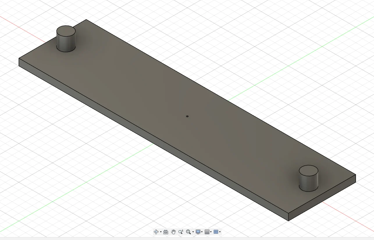

Talking about woodworking, I made this little tool to mark the midline of a board without having to measure anything. I made the center hole very small on this side but also bigger and conical on the other side for better centering of the marker / scribe and so I can also drill it to size easily if I use a bigger marker.
Should take somebody familiar with Fusion 360 all of 2 minutes to draw. Took me longer cuz I struggled with finding the best way to do the conical hole, ending up using a draft feature after trying countersunk holes and other ways. Cone angle is small so hopefully I won't need supports.
The nice thing about this design is that I am pretty much assured that the center hole is, well, perfectly centered between the 2 bosses, even if the material shrinks a bit and the final bosses spacing is slightly off, won't matter one bit.
Good idea on making it white, I'll do that too so I can write dimensions etc on it when working. I usually like my tools battlegrey but white is better for jotting down notes.
Now i gotta figure out how I can make the area surrounding the centerhole at 100% infill so I can drill it fine while keeping the rest at much lower infill to save filament. No idea how to do that yet. Suggestions? (I'm usually using Prusaslicer but will look into Fusion 360 FFF features soon.)
added: figured out the local infill bit. Very easy in Prusaslicer, I just added a "Modifier", an area around the hole where I could set the infill at 100% while keeping the rest at 20%. This will also come in handy when I have internal threads in bodies that I want to reinforce.
added 2: I'm an idiot, it is better to use the extrude at angle function to do the conical hole rather than Draft, saves a step. But here is the beauty of 3D printing: I could make the conical hole the correct angle to fit perfectly my machine-sharpened (!) pencils for best centering. Try that with shop tools! Sadly, probably won't help much my huge woodworking fitting errors, though... And, yes, the irony is not lost on me that I used a $200 machinist tool to measure the pencil point angle to make my 50c printed tool arguably a tiny bit better... sigh...

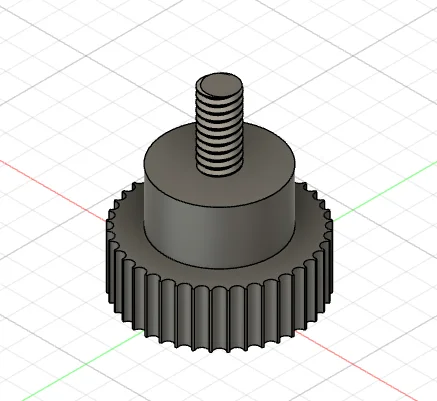

lotsa places to use one of these in the shop -and maybe around the truck too:

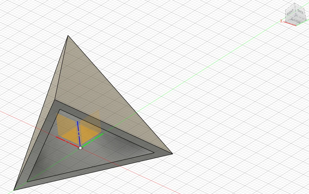

OTOH, this one will be used for a specific task -painting-:

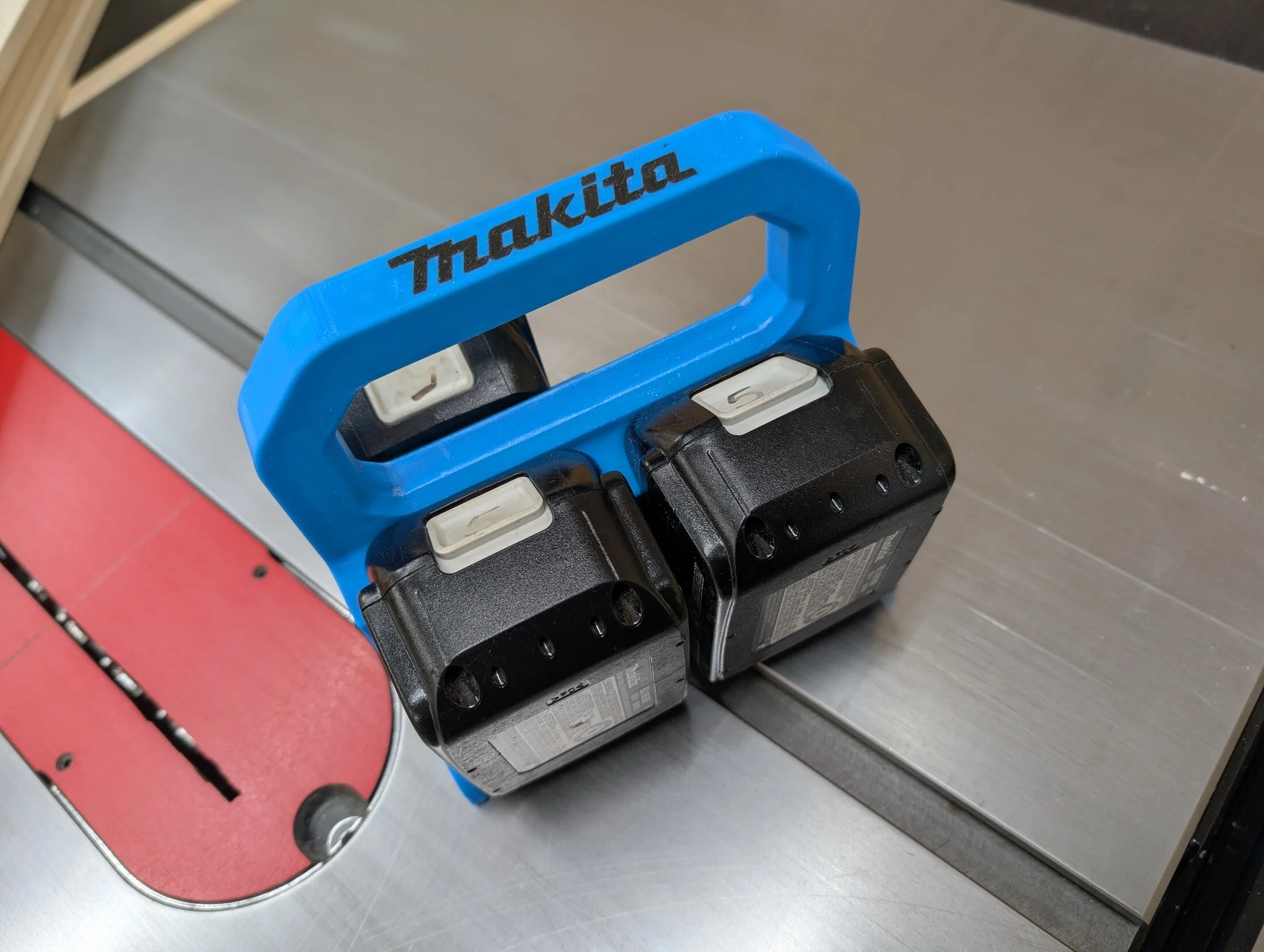

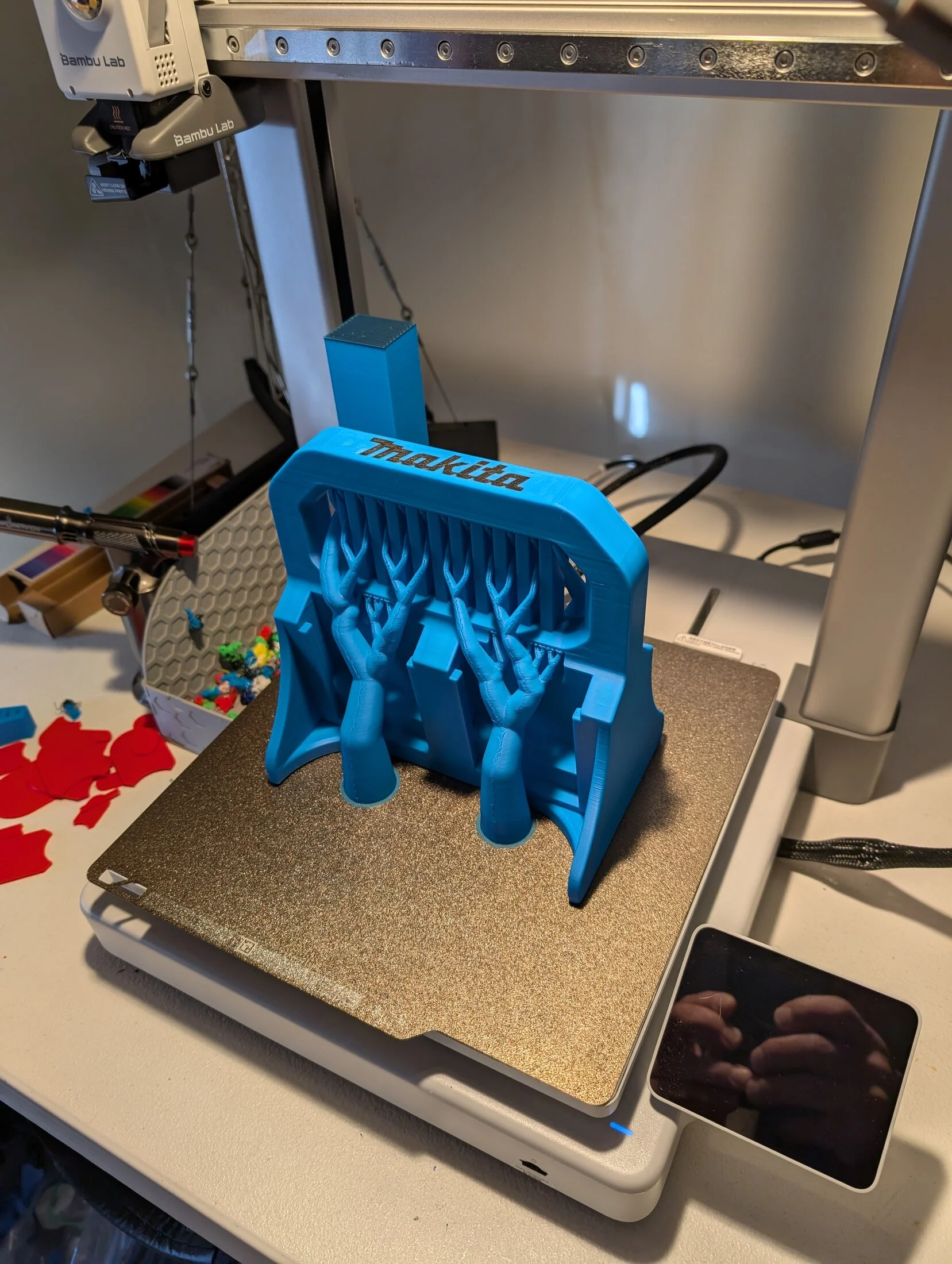

very nice! You guys are getting all fancy with multicolored pieces, looks good.
I can see that you would need the tree supports for the latches overhang but why did you need them for the upper part?
Next version: battery contacts and wiring with an Anderson outlet for a power station! You could get your engine started with one of those!

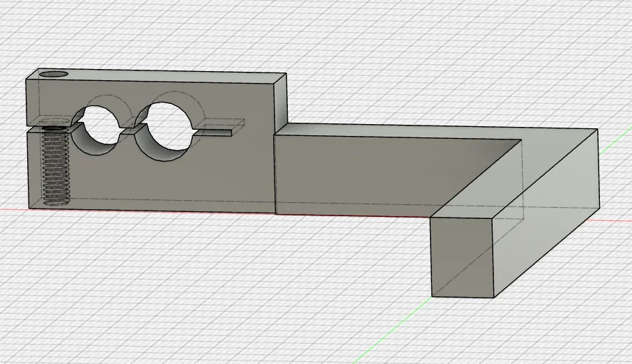

dammit, could not resist:
an aggravation-reducer... that should count as a 2025 resolution, no?

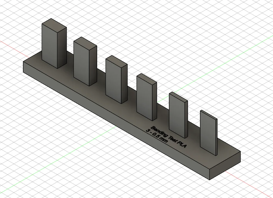

I will be exploring the use of locking tabs for parts assemblies, like in the bezel above. So I made a little jig to find out how thick these tabs should be for the PLA I am using. Something like:
we'll see what works best.

added: well, looks like for a workable tab it's gotta be either 1 or 1.5mm thick if the tab is 10mm long. Probably more the 1mm. That's not much. This stuff is much harder than what I'm used to seeing with tabs on various plastic parts. A similar thickness with this PLA is not flexing at all. Interesting test!

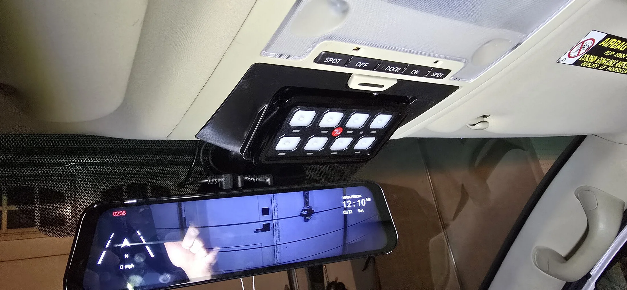

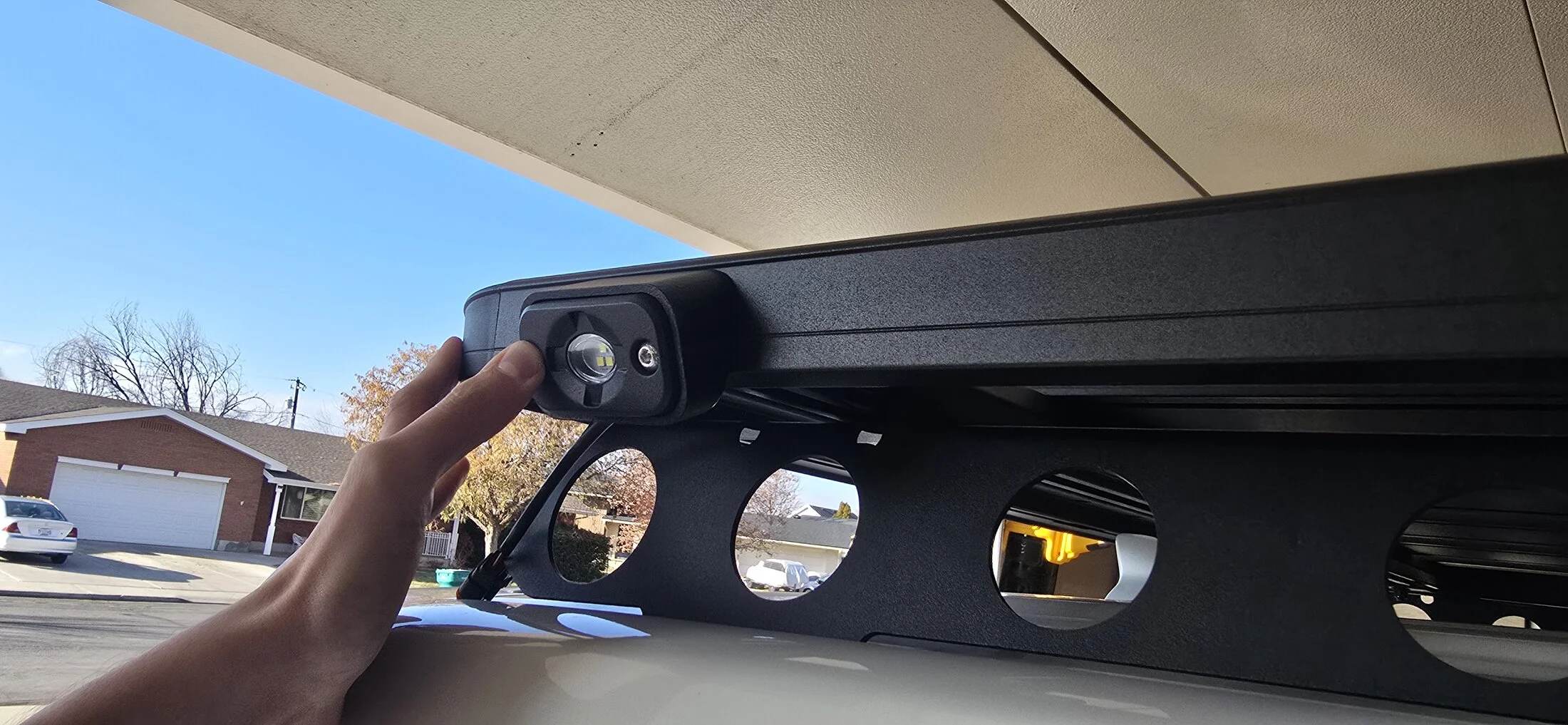

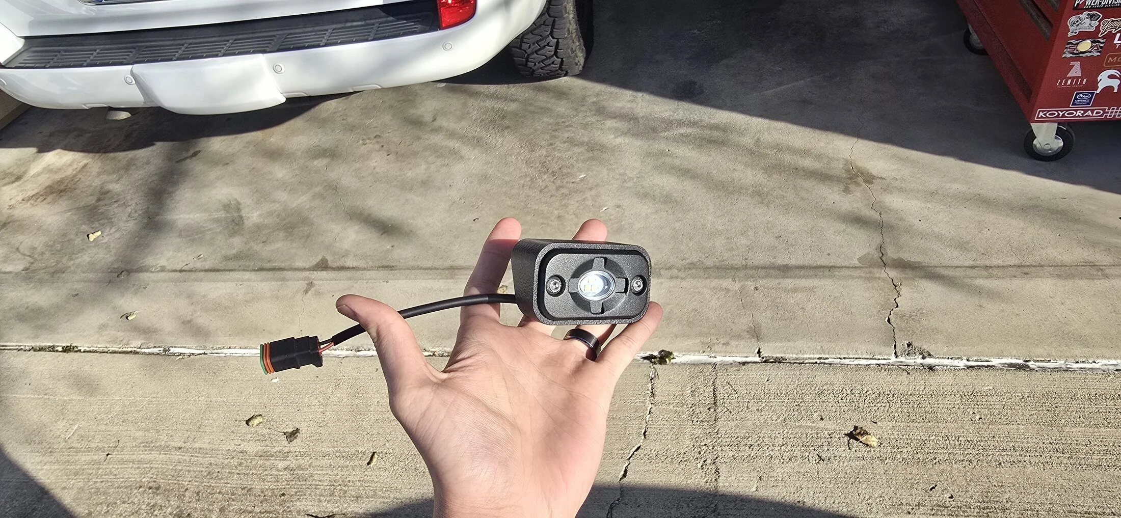

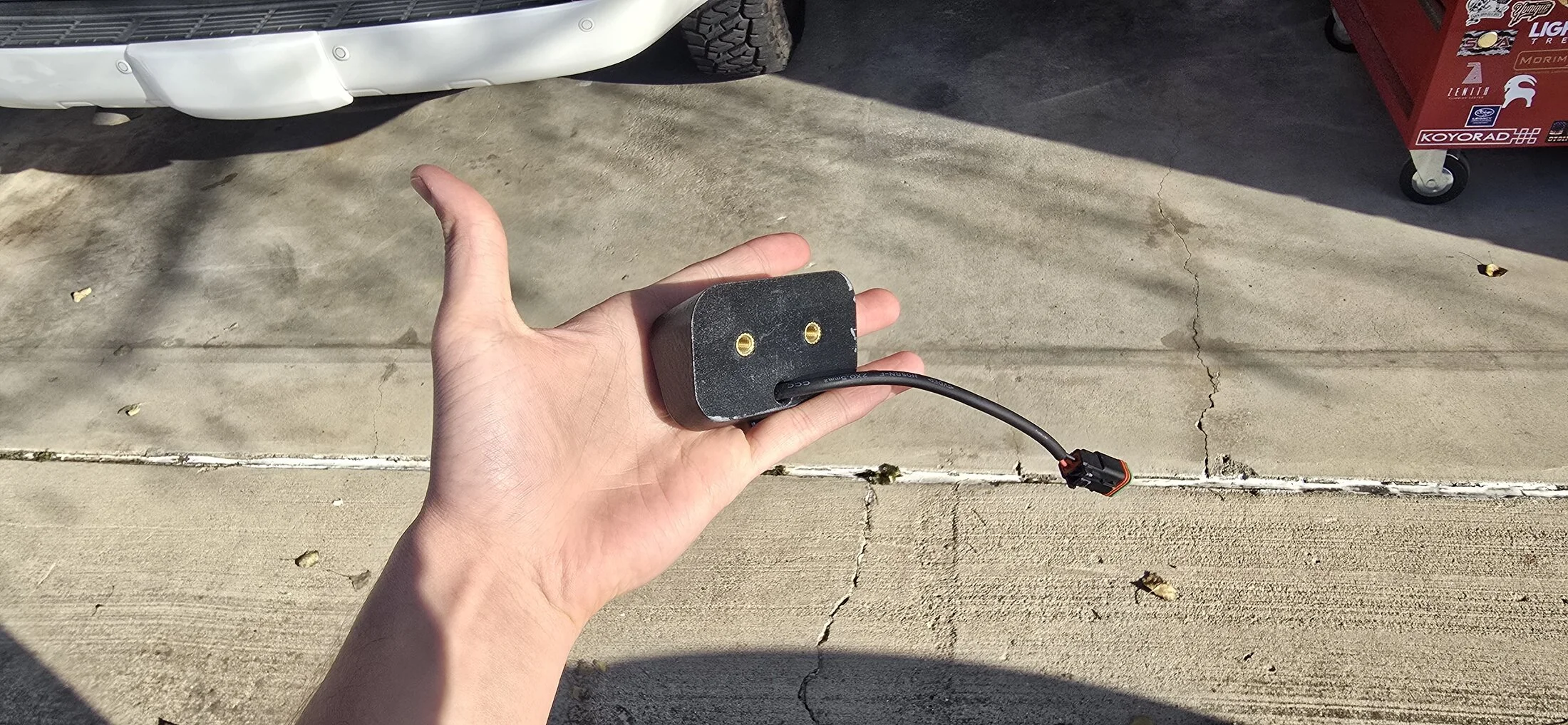

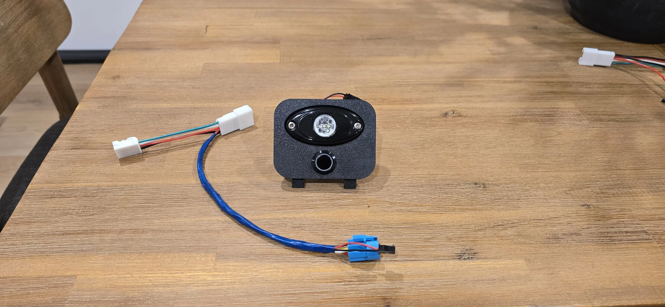

Love seeing more people jumping into printing. I've only been doing it for a little over a year, got into it for my business and automotive hobby needs. Started with a ender 3 and then recently made the jump to a bambu lab p1s. Most of my printing is pla for test prints and then petg-cf, will be getting into ASA shortly. I do all my design in fusion 360, tried blender and hated it.
All my automotive stuff is for my lx570 but so far ive done some utility light mounts for my roof rack, a switch mount in place of sunglass holder, lift gate cargo light. A fun hobby when it works out!

Very nice. What lamps are you using on the roof rack? I have a Sherpa rack sitting in the garage waiting for warmer weather to get installed, then I want to add lights.
I designed the angled mounts around the new-ish harbor freight roadshock utility lights. They're actually quite solid performers for something basic like this. I added Deutsche connectors onto mine for a solid connection
Thanks, was in HF just the other day, will check them out next time. They look like just the ticket.
How much fun was it working with the inserts? I haven't tried/needed them yet, but have a project in mind that I might use them.
