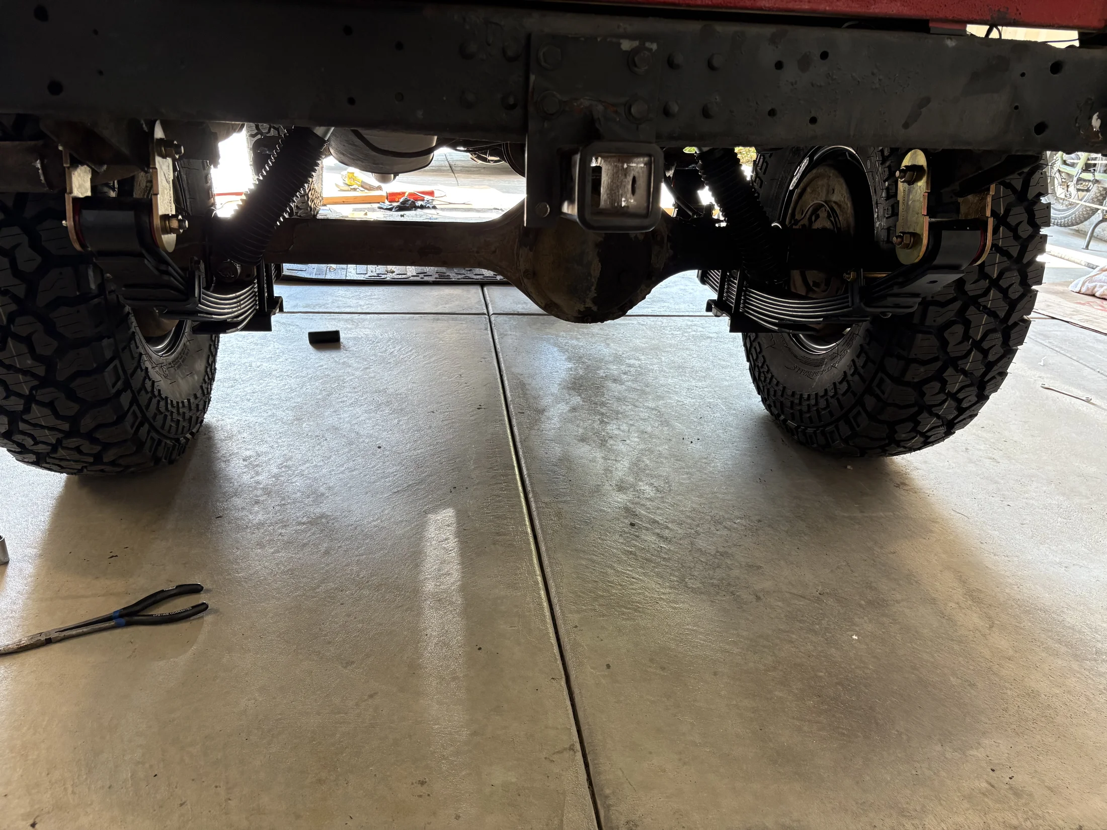

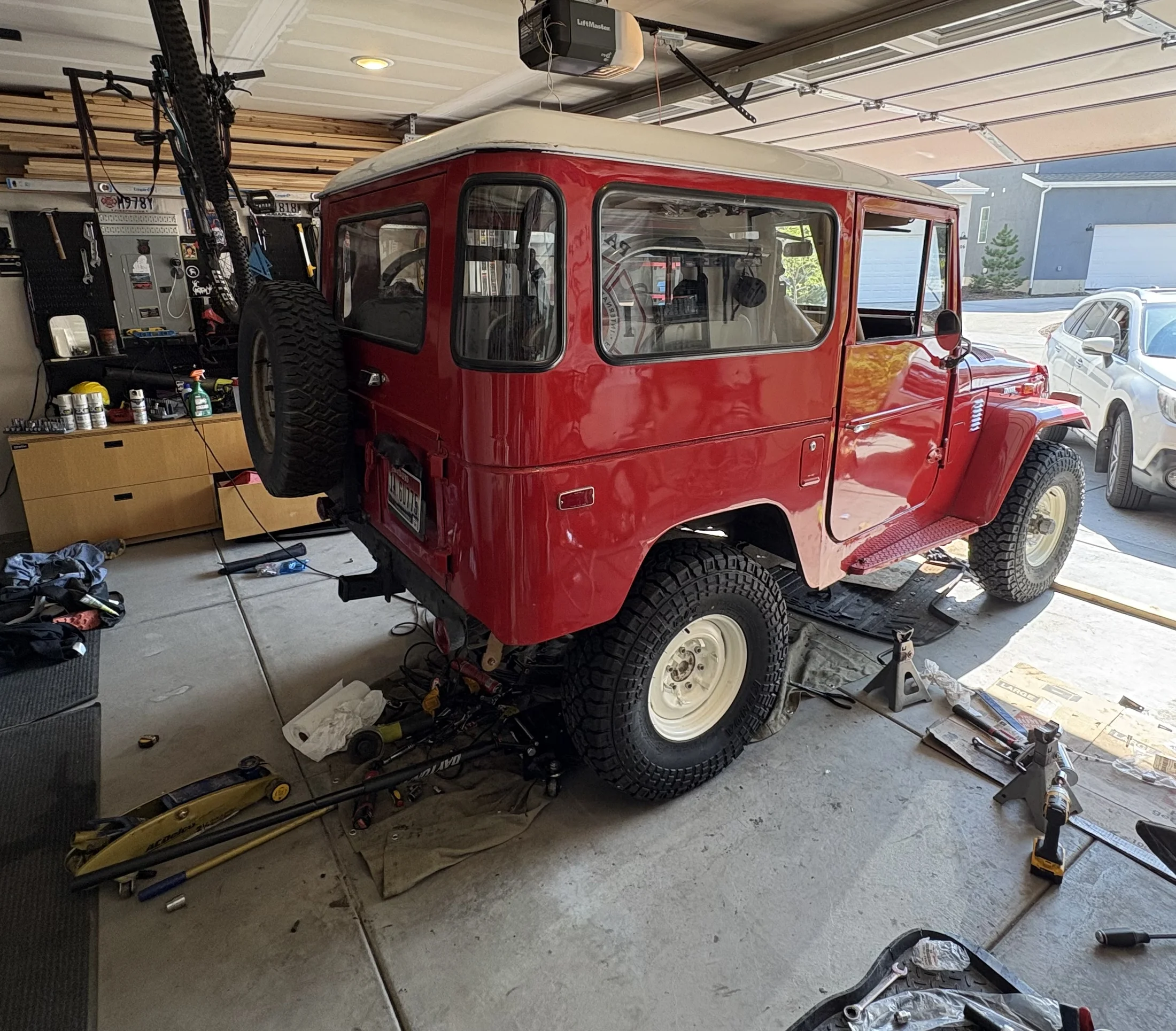

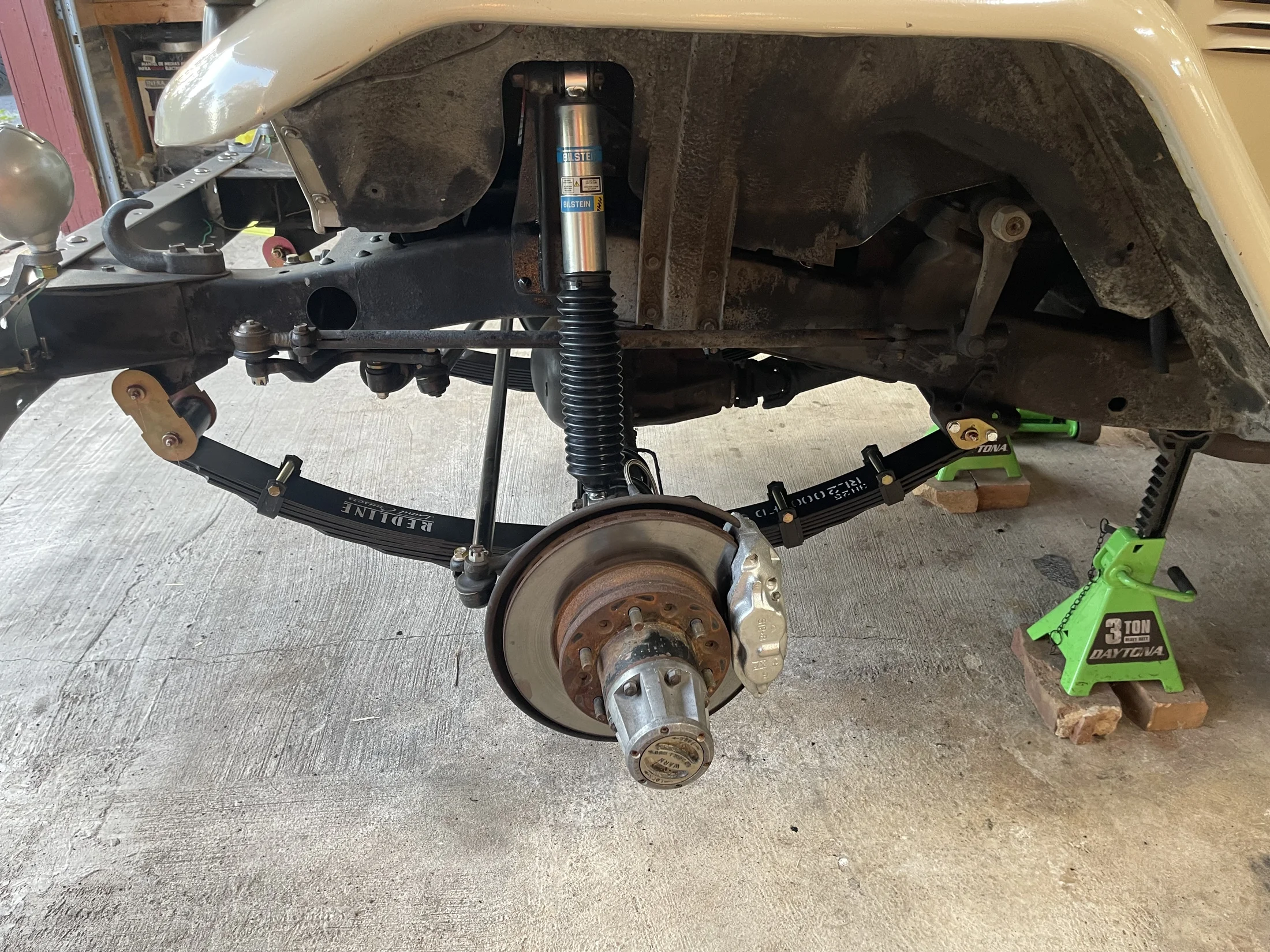

Finishing up the install. More pics to come. Happy with the Redline Kit, talked with them on the phone a couple times during to clarify a couple things.

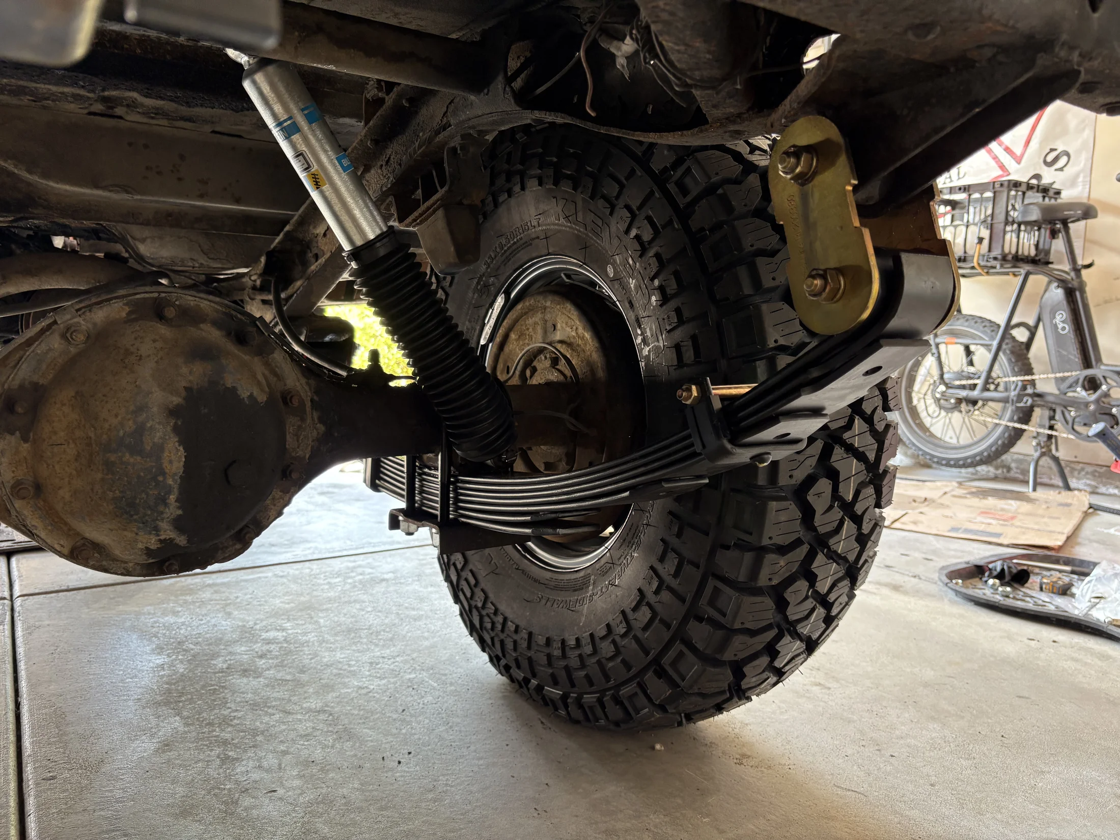

The leafs wrap partially around the main leaf, so that is supporting the main leaf completely. The spring eyes are much larger than stock which will help the bushings last longer than the far too small stock bushings and make for a more stable ride. Im guessing with the larger leaf eyes a military wrap wouldn't fit in the stock fj40 mounts. I've not seen many modern leaf springs crack unless they have like 500k miles on them except composite leaf springs. But if you have a very specific leaf design in mind it is probably best to have them custom made rather than use a off the shelf lift spring.

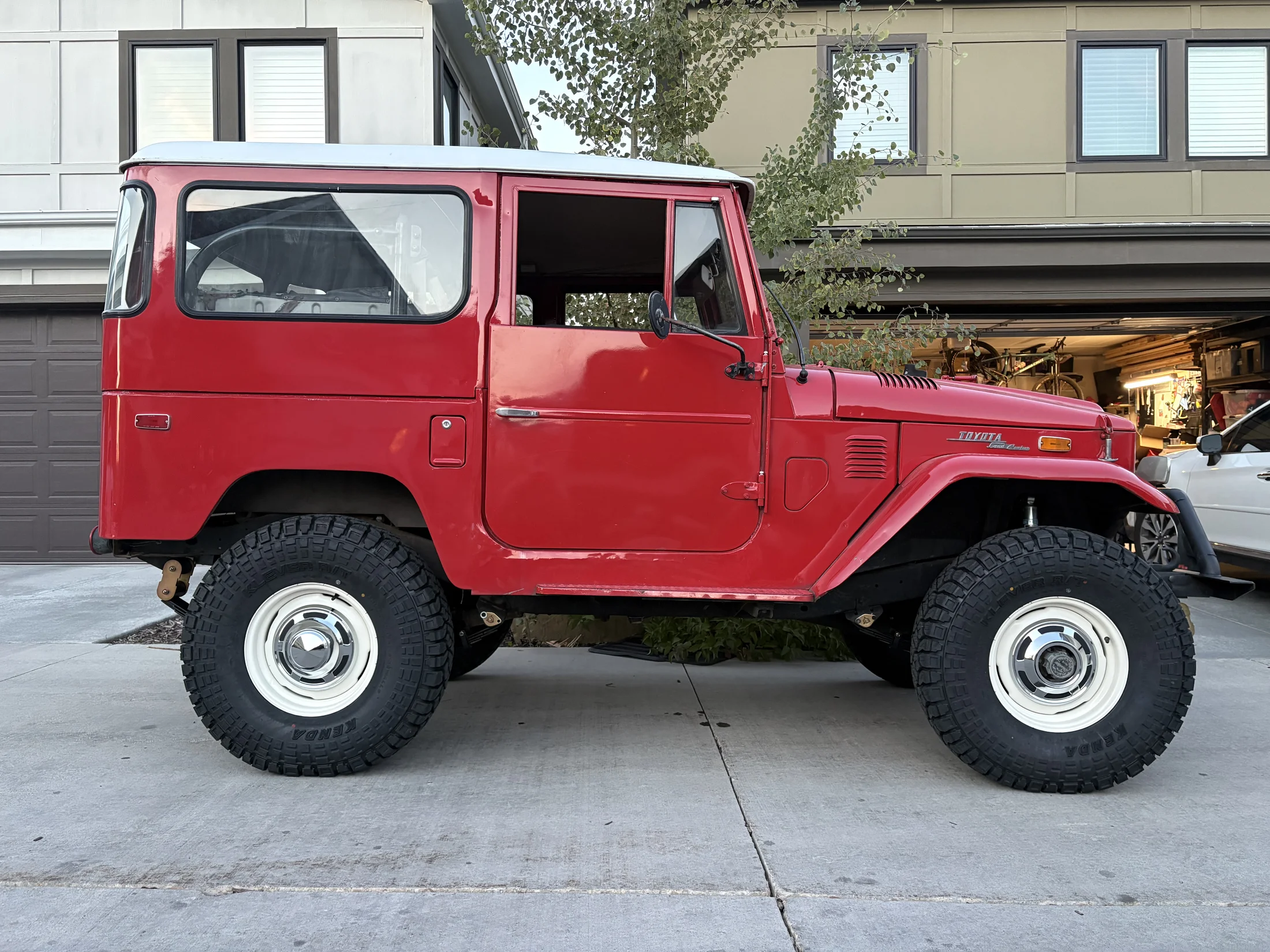

Love the stance of it. Rides so so much better. One of the reasons that drew me to the redline kit is the rear wheel spacing is proportionate. The Procomp springs they used to use and the new springs they had manufactured keep it perfectly center unlike other kits. Always bugged me seeing a new OME kit placed and the tire and wheel not being center.

Looks great and love the white wheels too!

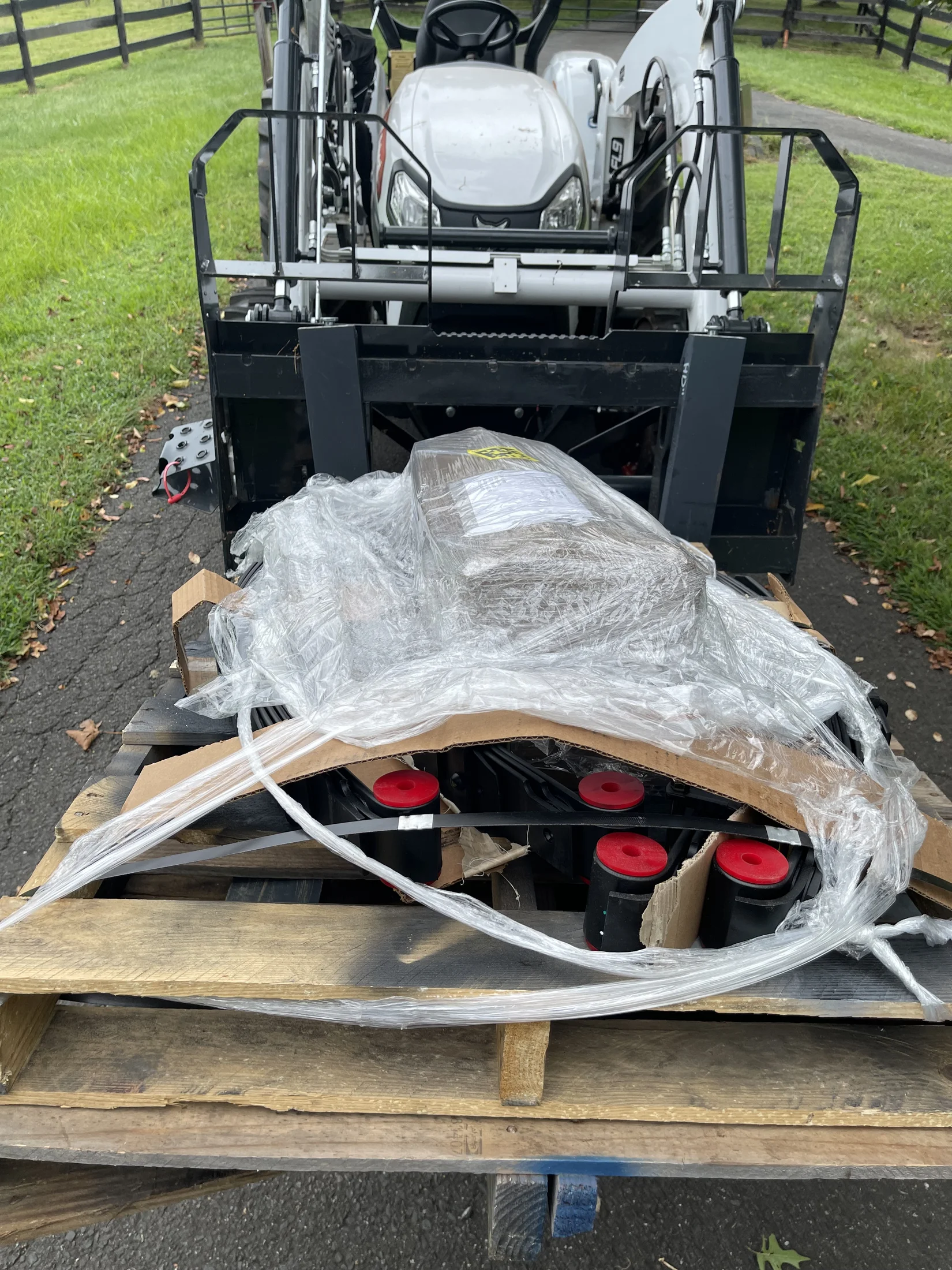

My kit arrived about 3 days after shipping, strapped nicely to a pallet. Definitely a forklift job to unload from the freight truck. Packaging was solid — nothing damaged.
First Impressions
  • Everything looked well-made and heavy duty.
  • Most parts had the Red Line branding and part numbers stamped in, which I liked.
  • Instructions are online, and all the springs were clearly labeled (driver/passenger, front/rear).

  • I started with the front. Pulled the old springs, supported the axle with jacks, and swapped in the supplied bushings.

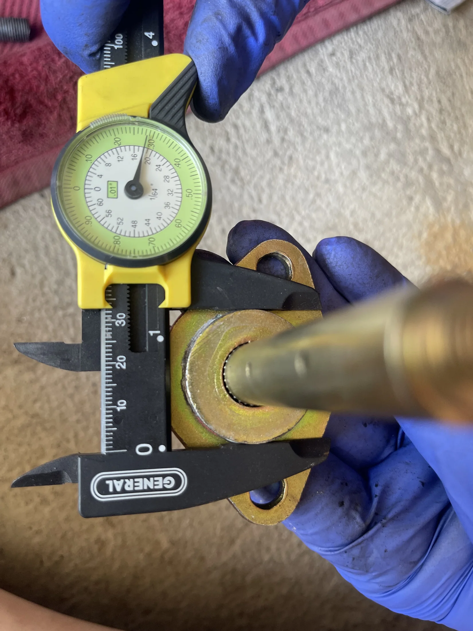

  • Spring pins: these were the only real issue. They aren’t Red Line branded, and the nut on the pin was about .03” too large to fit cleanly. I had to shave the hole slightly with a Dremel — quick job, but make sure to treat the area with rust prevention afterward.
  • Spring pin bolts: the two OEM bolts that hold the pins in place are too long and will contact the spring head. I replaced them with M8 × 12mm bolts with washers from a local hardware store, and they fit perfectly.
  • The Bilstein shocks looked great and went in without trouble. Just a note: the kit doesn’t come with the castle nuts and shock caps — you’ll need to reuse your originals or order them separately.
  • Once I figured out the spring pin fit and swapped the bolts, the rest of the install went smoothly.

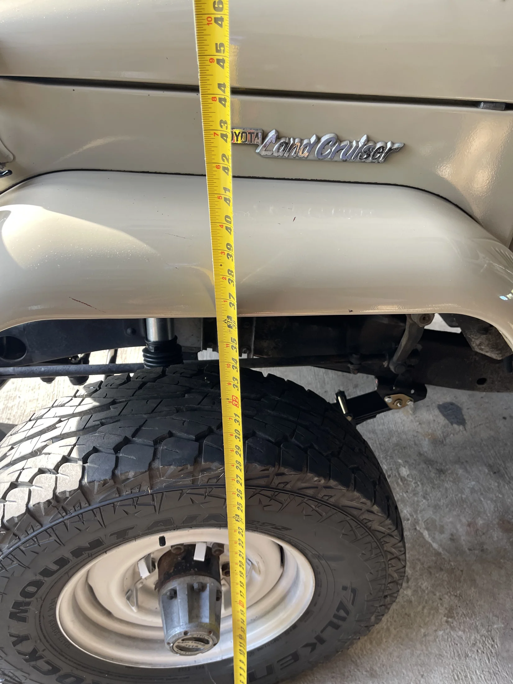

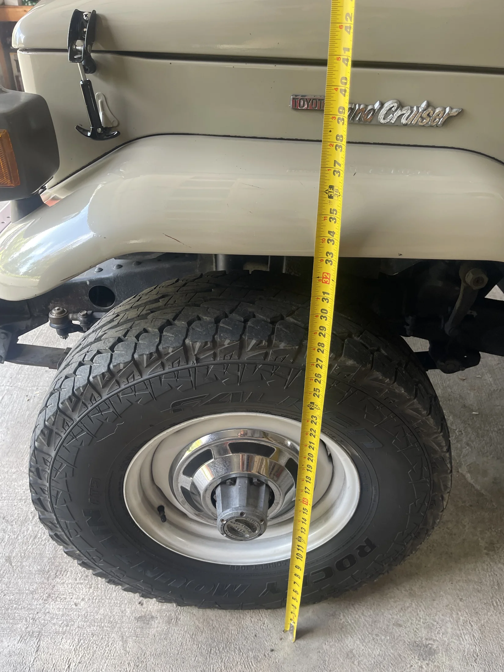

I snapped pictures before and after. The stance looks much better, but I did notice the driver side sits a 1/2 inch higher. I have contacted them about this haven’t got anything back yet.
Front Driver
Front Driver after

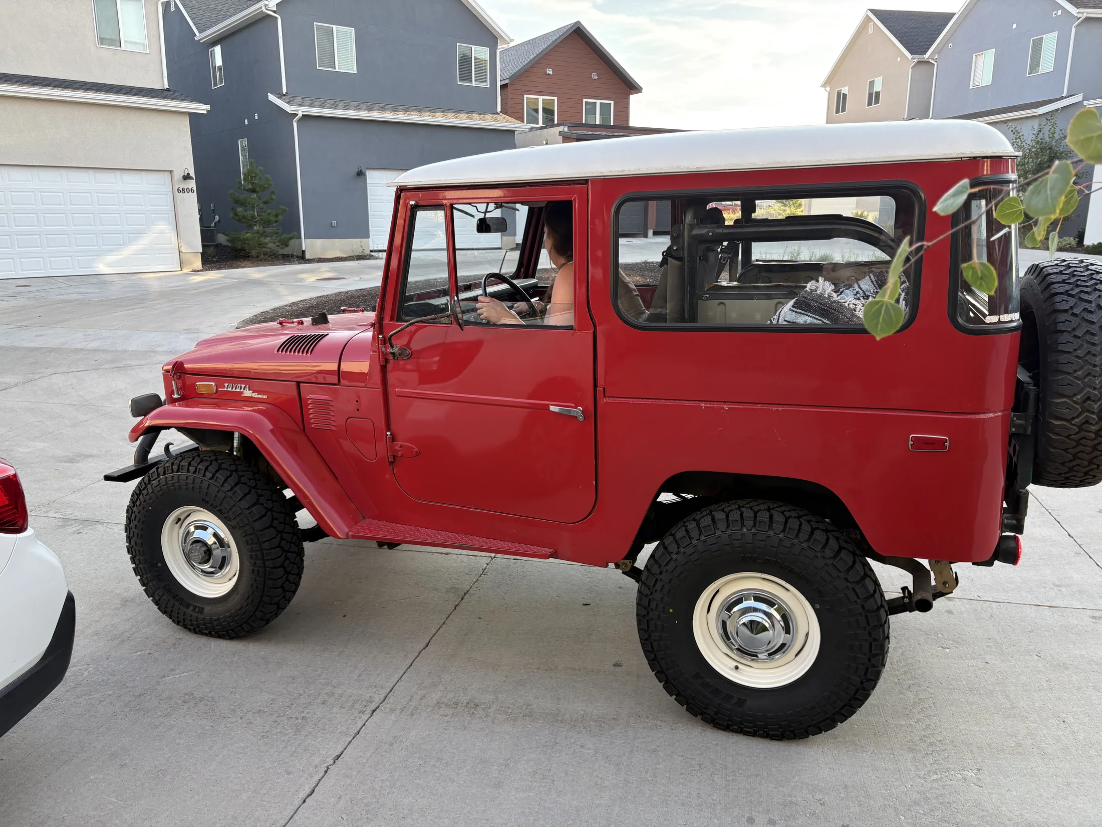

View attachment 3984370View attachment 3984374
That does look really good. What size tires do you have?
