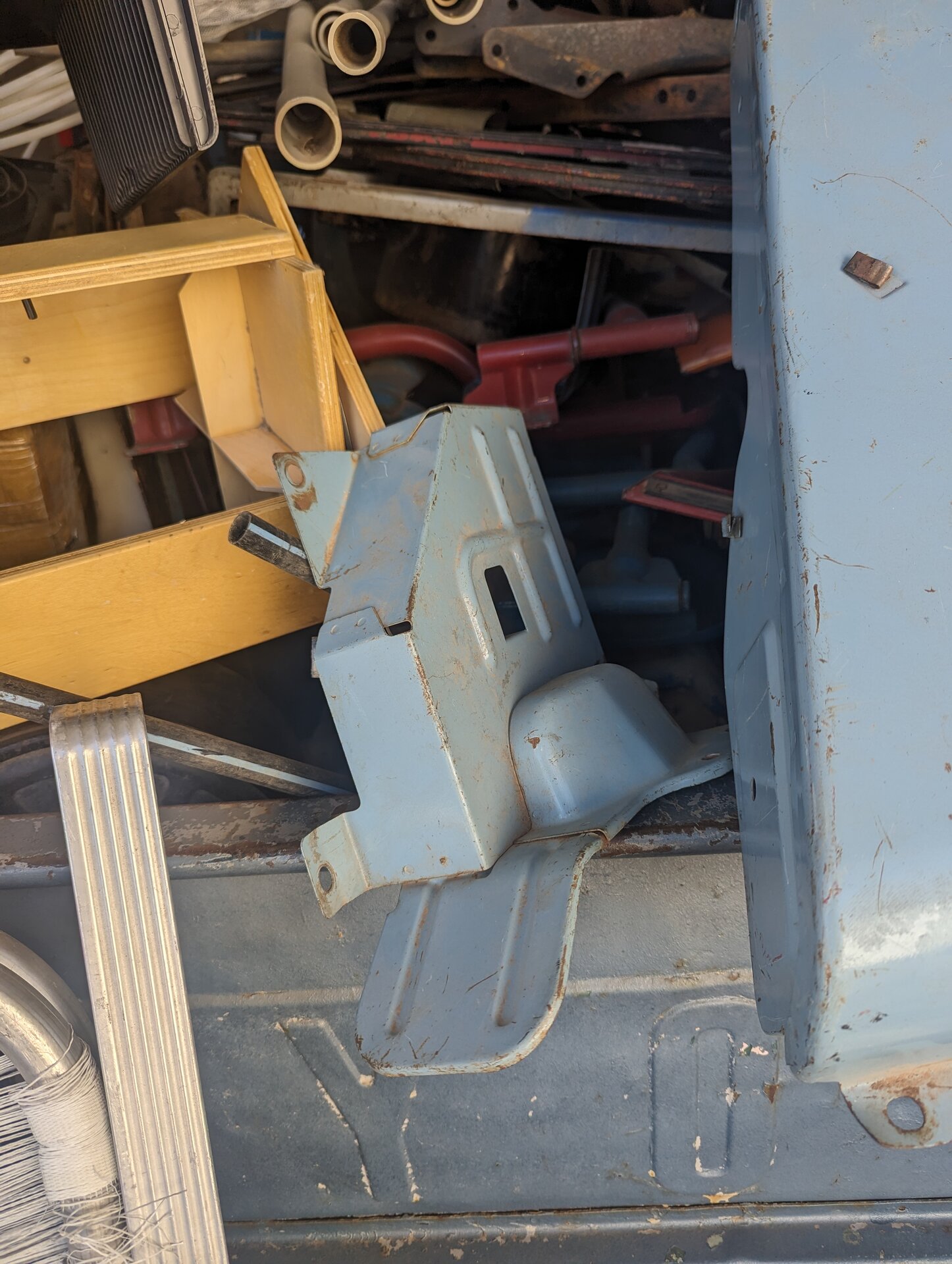

Here is the 74 tank cover and the larger piece of the emissions cover. Have the other piece somewhere in the bed of my FJ45. Bed is loaded with parts to the top of the head rack.
It's my opinion the emissions covered changed by the time my 2/73 was made and switched from pewter to body color. Do we have any 2/73 and later 73 owners to report what they have.

Definitely an upgrade on the cover. More protection for sure.

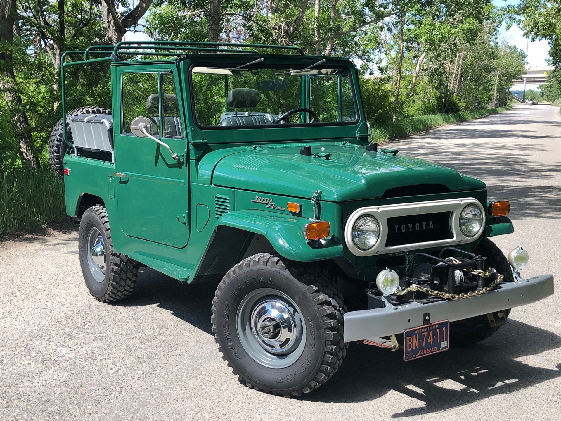

Only front bumper I have known 100% sure was made from 10/73 to 1/79 is one I off bought of a friend. He bought one of the first 75 FJ40s sold in LA California. He installed a Warn winch and channel iron bumper. During that time period Toyota offered a license plate bracket that bolted to the bottom of bumper on the right when both a factory winch and factory lights. License was in front of the bumper not hanging below. Have a few options of license plate brackets to use. One was made aftermarket and the other early bracket the base was cut off. I have a few Winches and few sets of fog lights. Personally would look into something similar on such a nice vehicle.

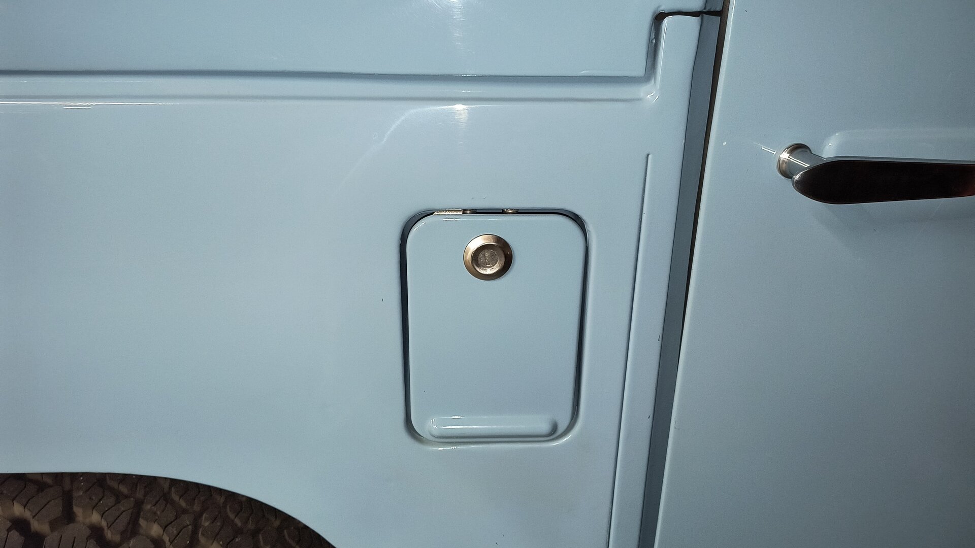

Locking door for gas cap:

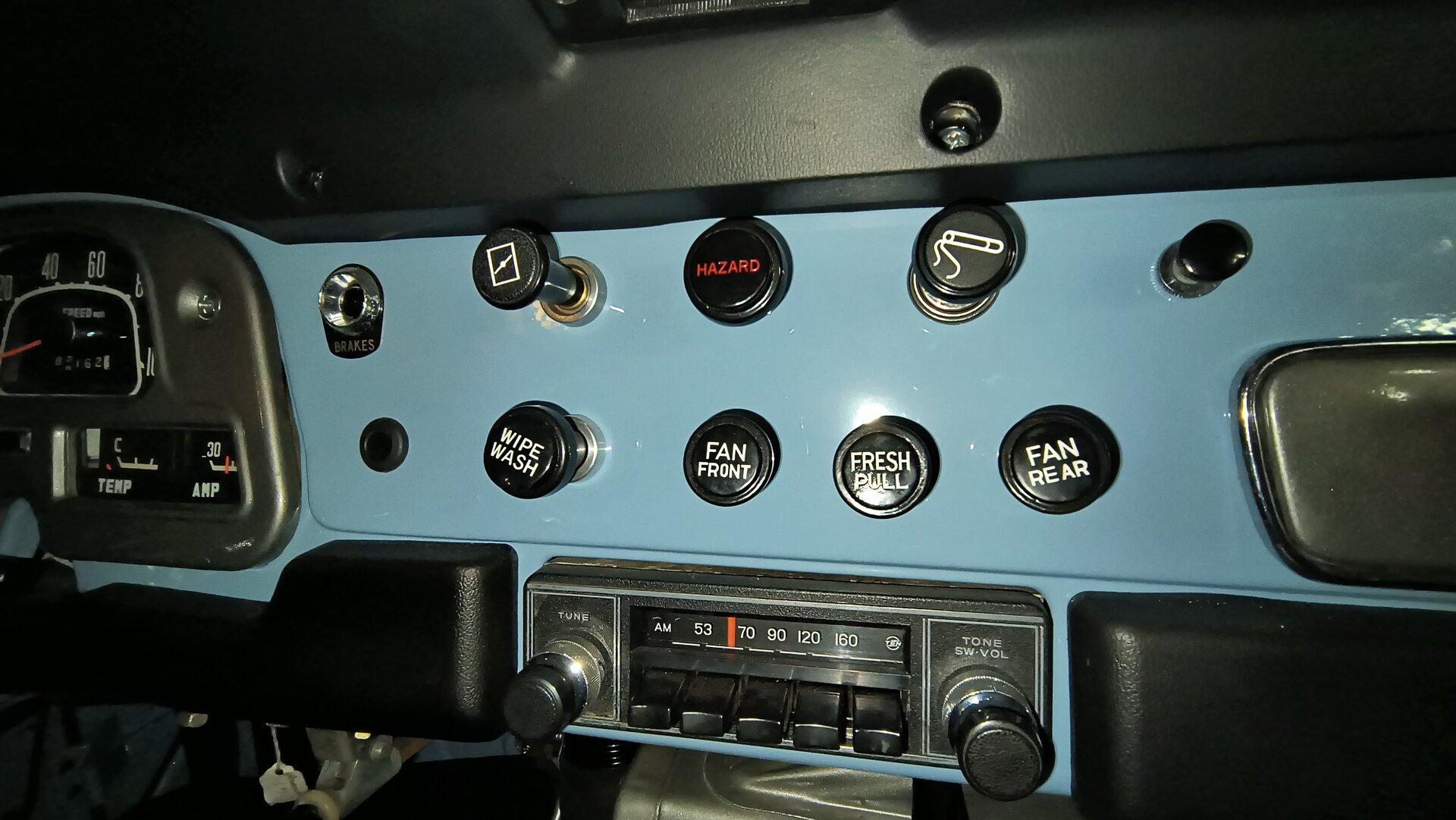

Dash with front and rear fan controls, both two-speed. Also, hardtop dome light switch just above ash tray.

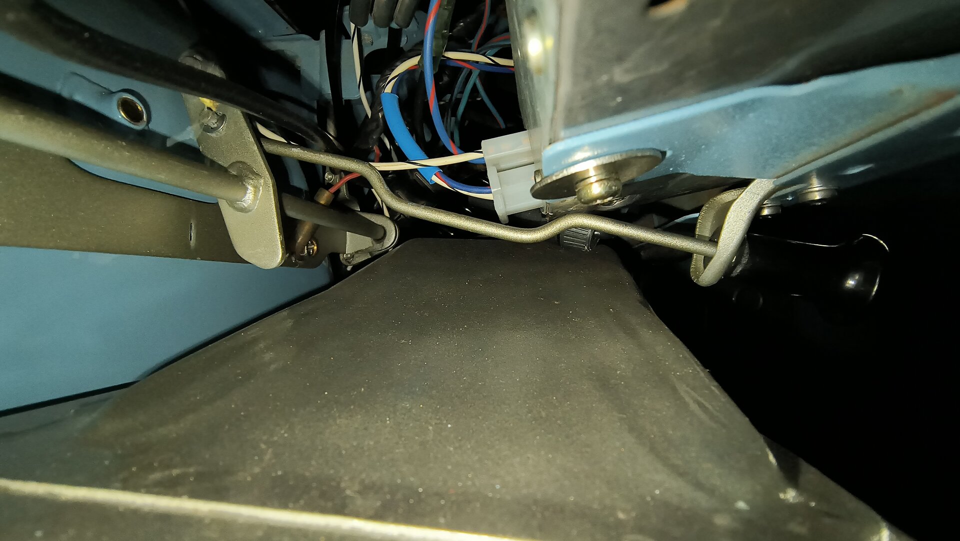

Offset link rod for cowl vent to avoid "short" AM radio.

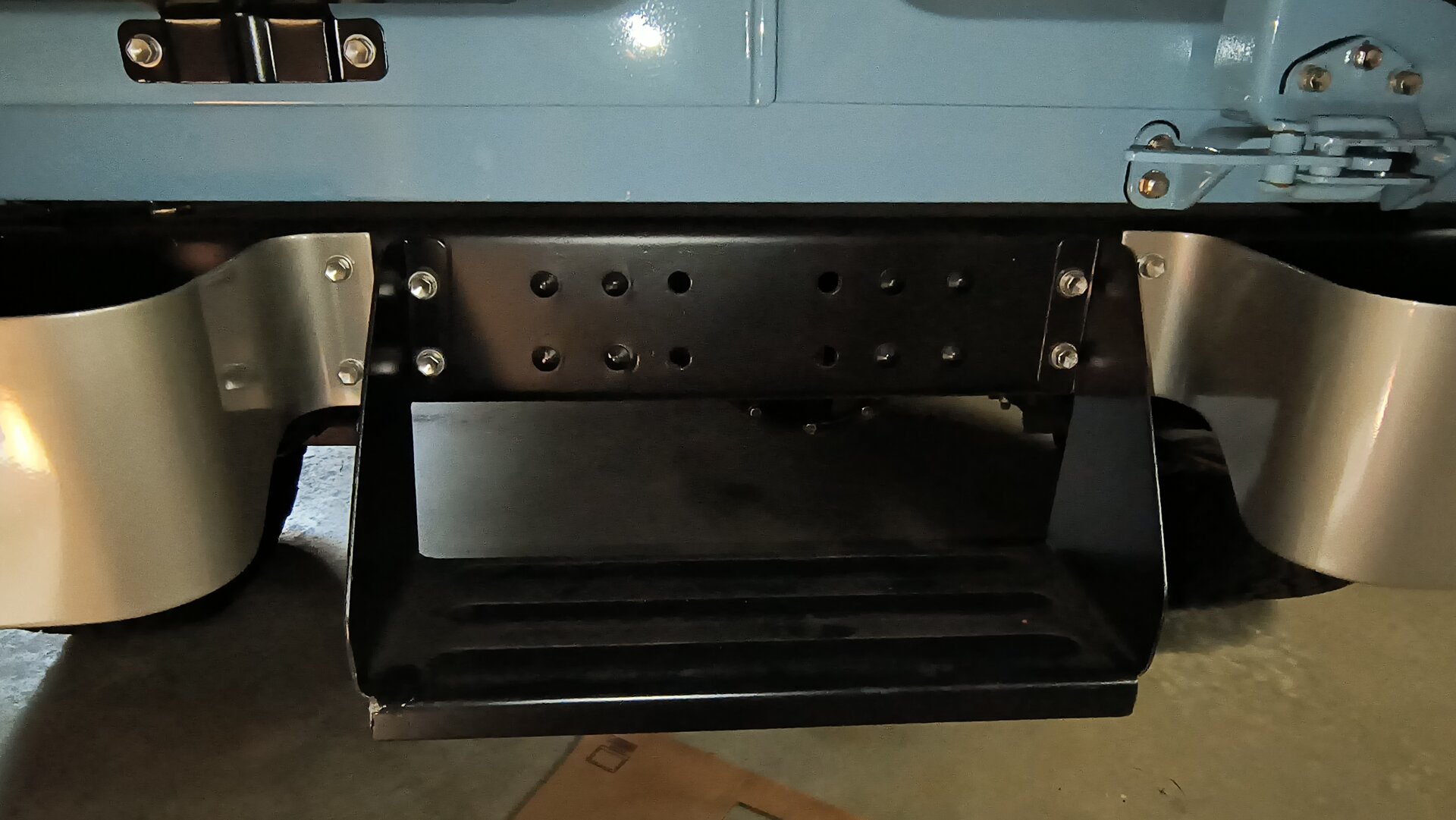

Last year for rear step with inboard attachment screws. 1974 moved to triple combination lamps cut into the rear frame, requiring bumperettes to move closer to center. The 74 and later steps overlapped the bumperettes, using the same screws.

These are older pictures. The PO built this license plate holder however I now made a new one based on this parts catalogue image.
Dash with front and rear fan controls, both two-speed. Also, dome light switch just above ash tray.
Curious. The dome switch light is for the soft top or the vader light?
I had holes on the right side of the glove box for the vader light.
