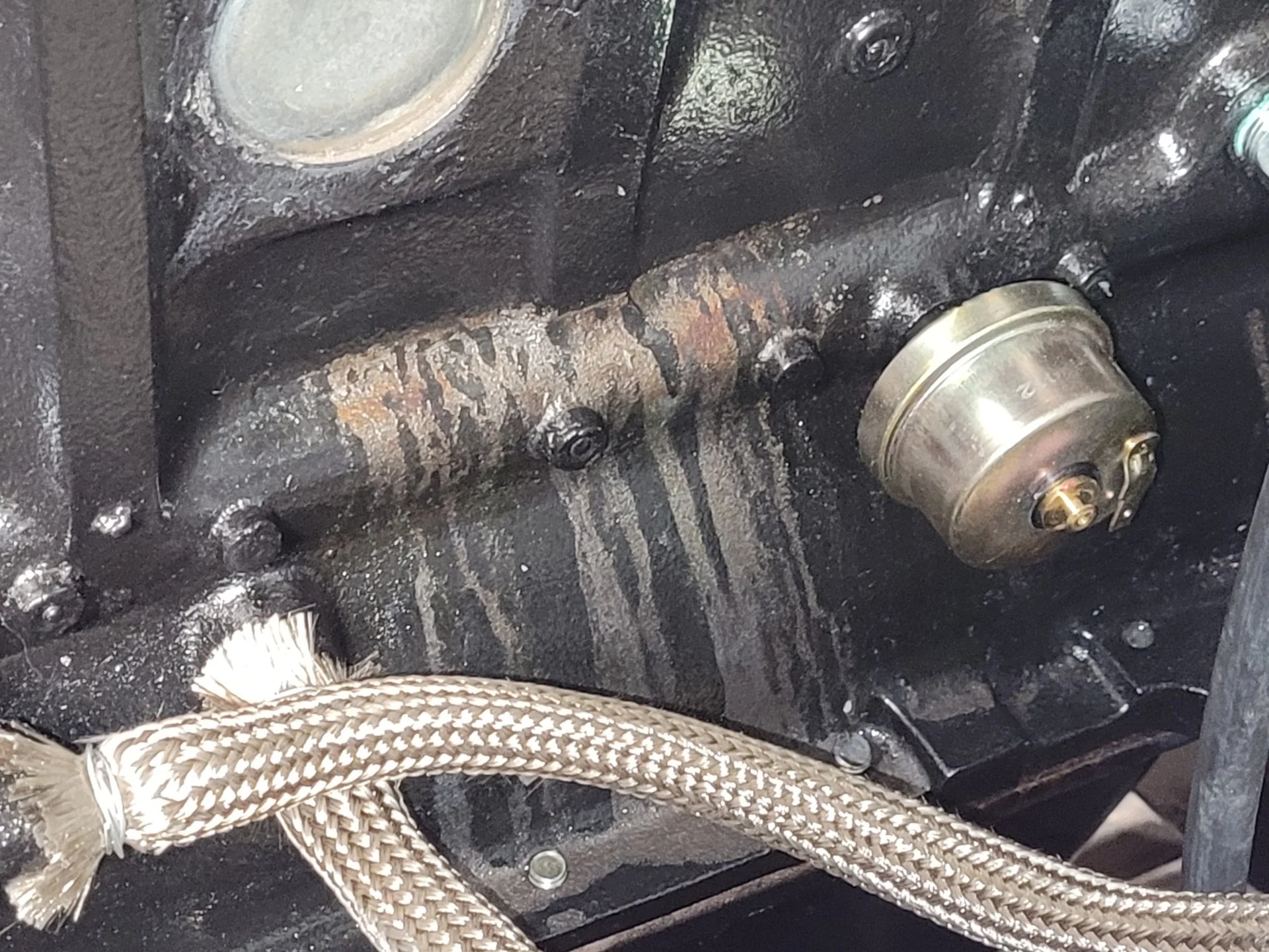

A friend took a look at the crack last night. He suggested getting a professional welder to do the fix. It would be a permanent fix, so I may try that. I did some digging and it seems like a good option.
I’m not welder, but I’ve seen guys that could put a nice bead right down that crack, guessing it would have to burn pretty hot.
Would it cook anything in the immediate area?
I think if I remove the intake, header, and obviously the oil sender......there would be room to get it done.
Grind, drill holes at the end of the crack, pre heat, Nickel rod arc weld, peen, post heat.....and it should be good. I just need to find the right guy for the job.
I plan to make some calls tomorrow to hopefully find someone.

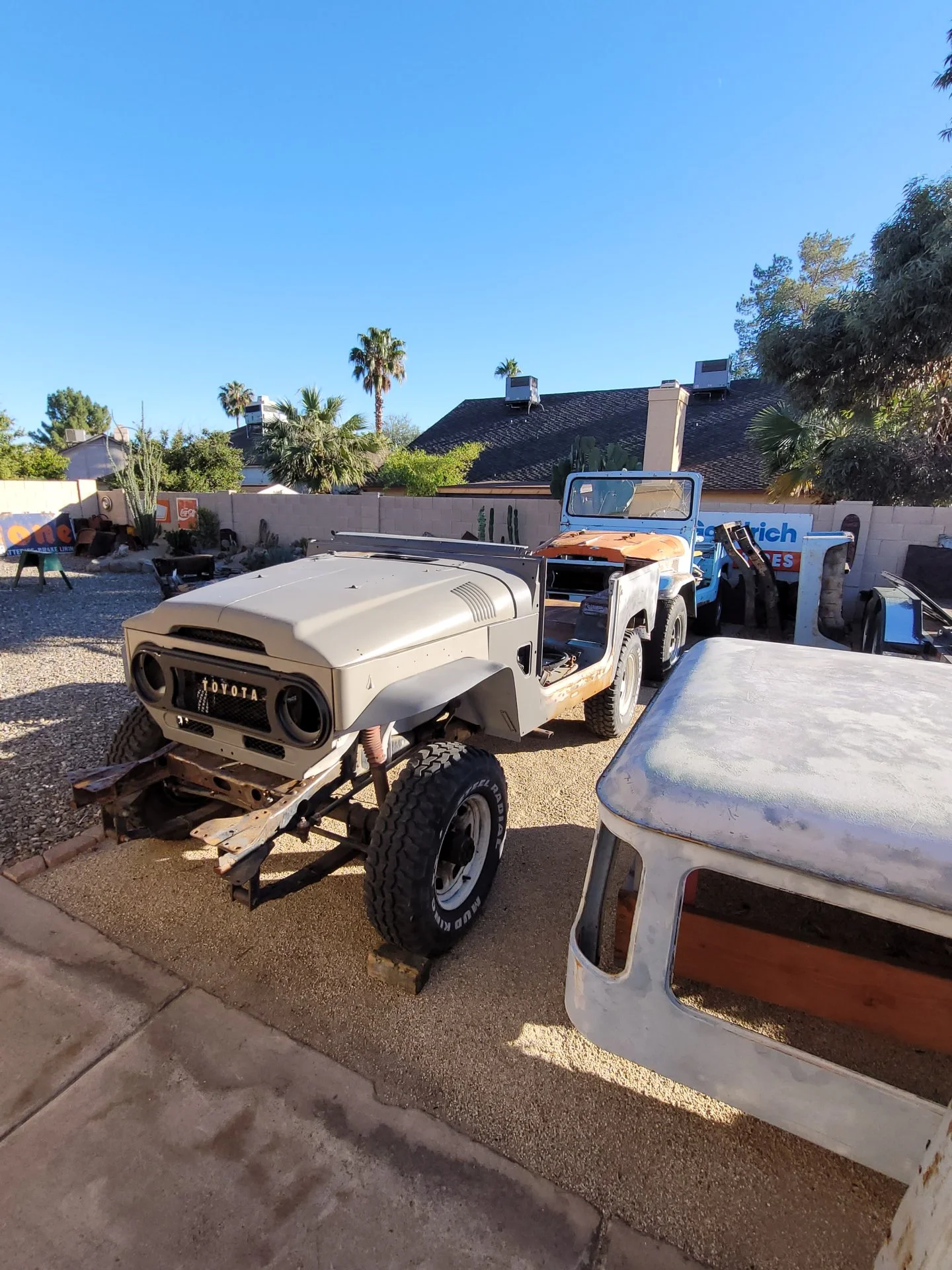

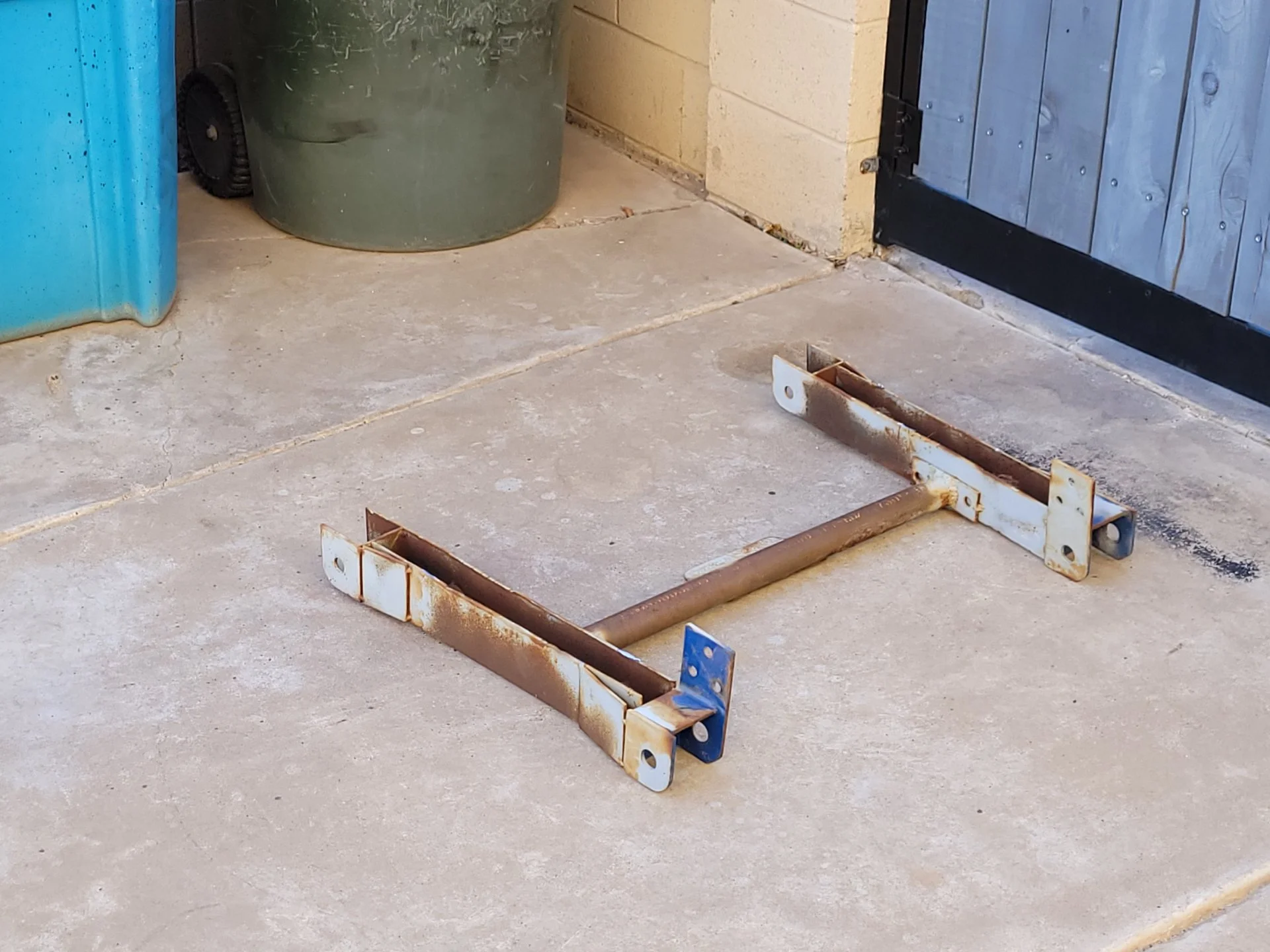

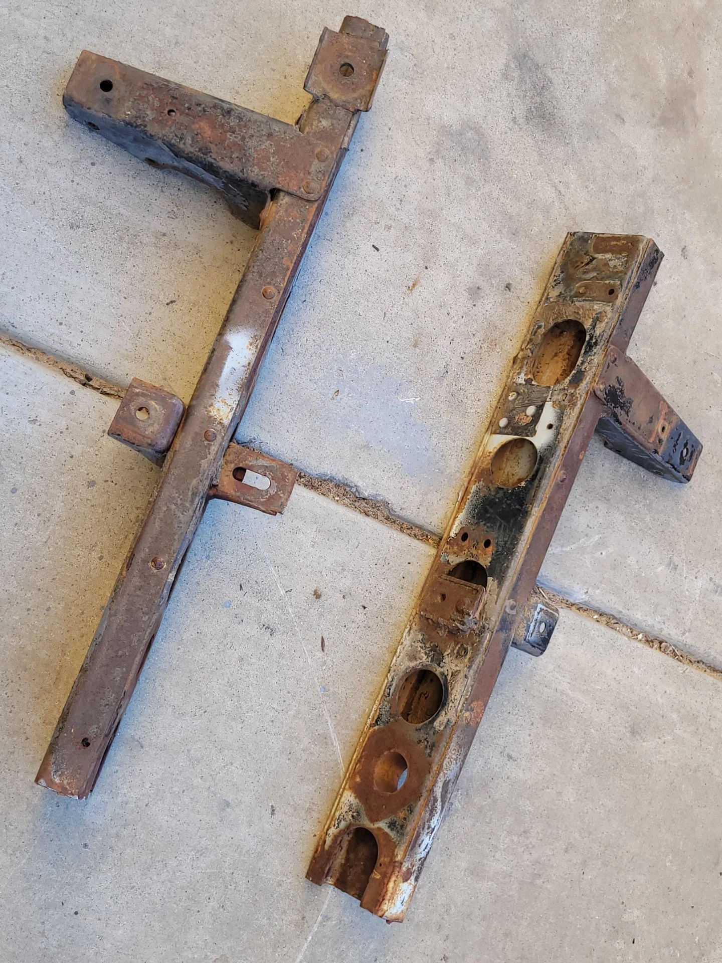

While waiting for the weld repair, I decided to start working on the next build. It will be a 40 to 45 pickup type conversion. The cab will be slightly stretched and the bed will be like a SWB bed but different dimensions.
After removing some PO sub frame dealy.....I cut out my donor frame sections.
