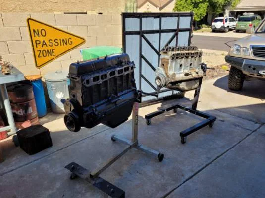

You can start these tractors sitting on the ground,some 4x4’s under the engine mounts. No engine stand needed!
He’s done that before. That’s why I follow his builds. I like his technique 😂.

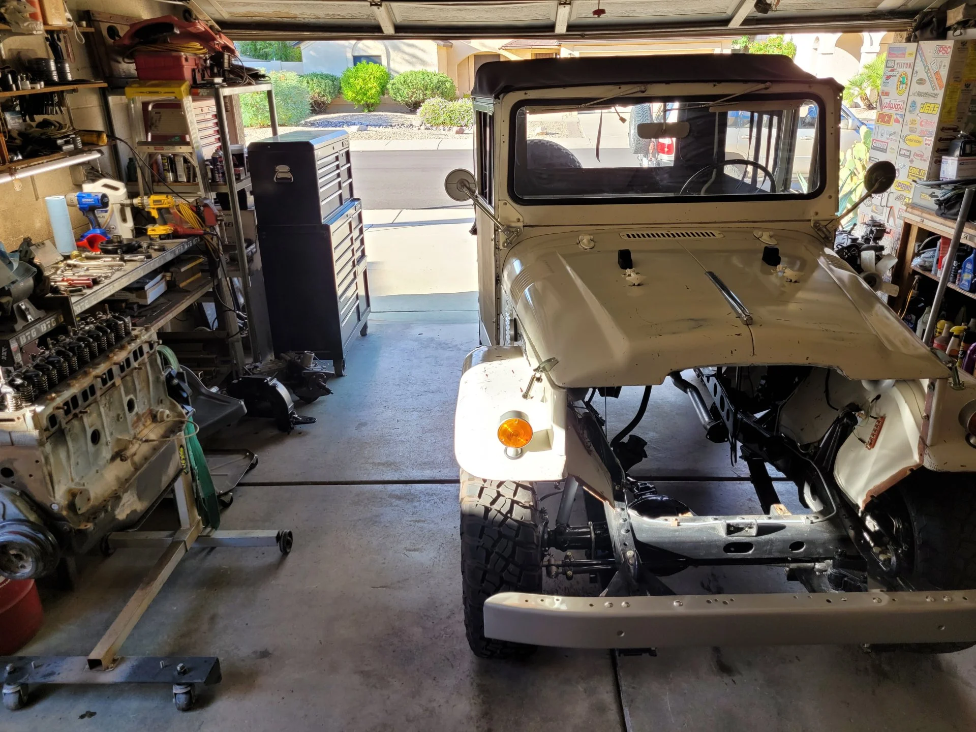

Went for a cruise last night. Didn't get too far as the truck suddenly locked the back tires, I pushed in the clutch and rolled to a stop. Motor seized. Had to call a friend to tow me home.
Guess my mystery motor is junk.

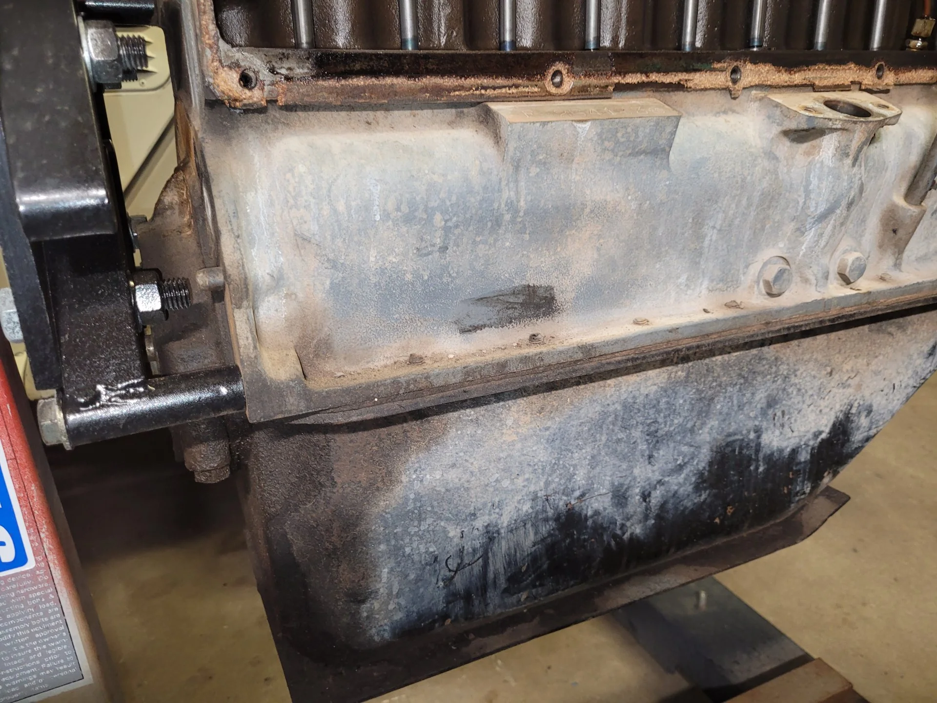

Well I ran it some after the valve adjustment. There's still a bad noise. Kind of a slapping, lite knocking sound.
Since my oil pan reseal didn't seal.....I have no reason not to check out the bottom end. I gotta dig thru my stash cause I might even have some new rod bearings.

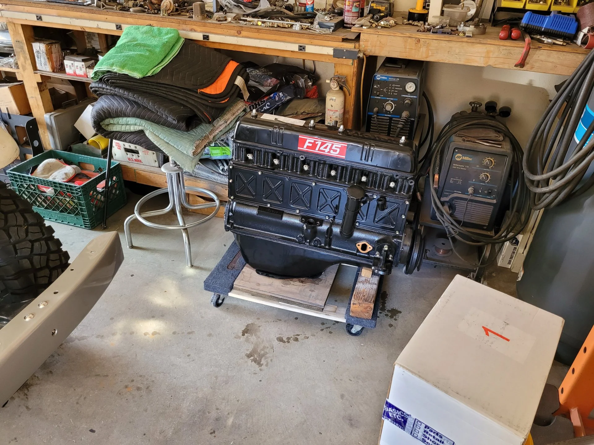

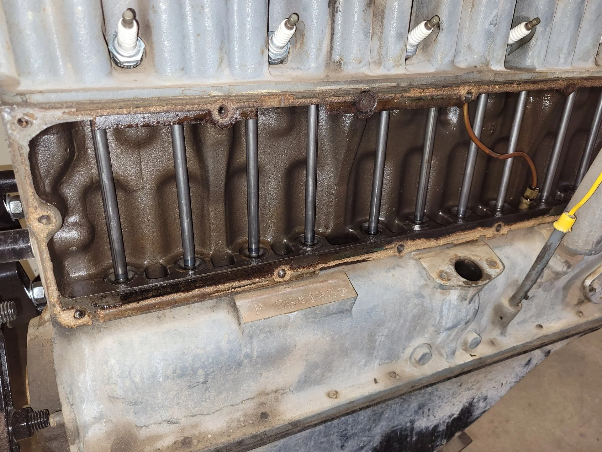

Gave the possible replacement motor a compression check today. I bolted the flywheel, bell housing and starter on. Place the motor on a wood block and had the hoist holding it from above. I jumped the starter with the LX, while spinning the oil pump with the drill, and reading the compression gauge. I had injected some oil in the cylinders last week or 2, so it wasn't dry but not really too wet either.
I got the following numbers:
1-140 psi
2-120
3-120
4-120
5-110
6-140

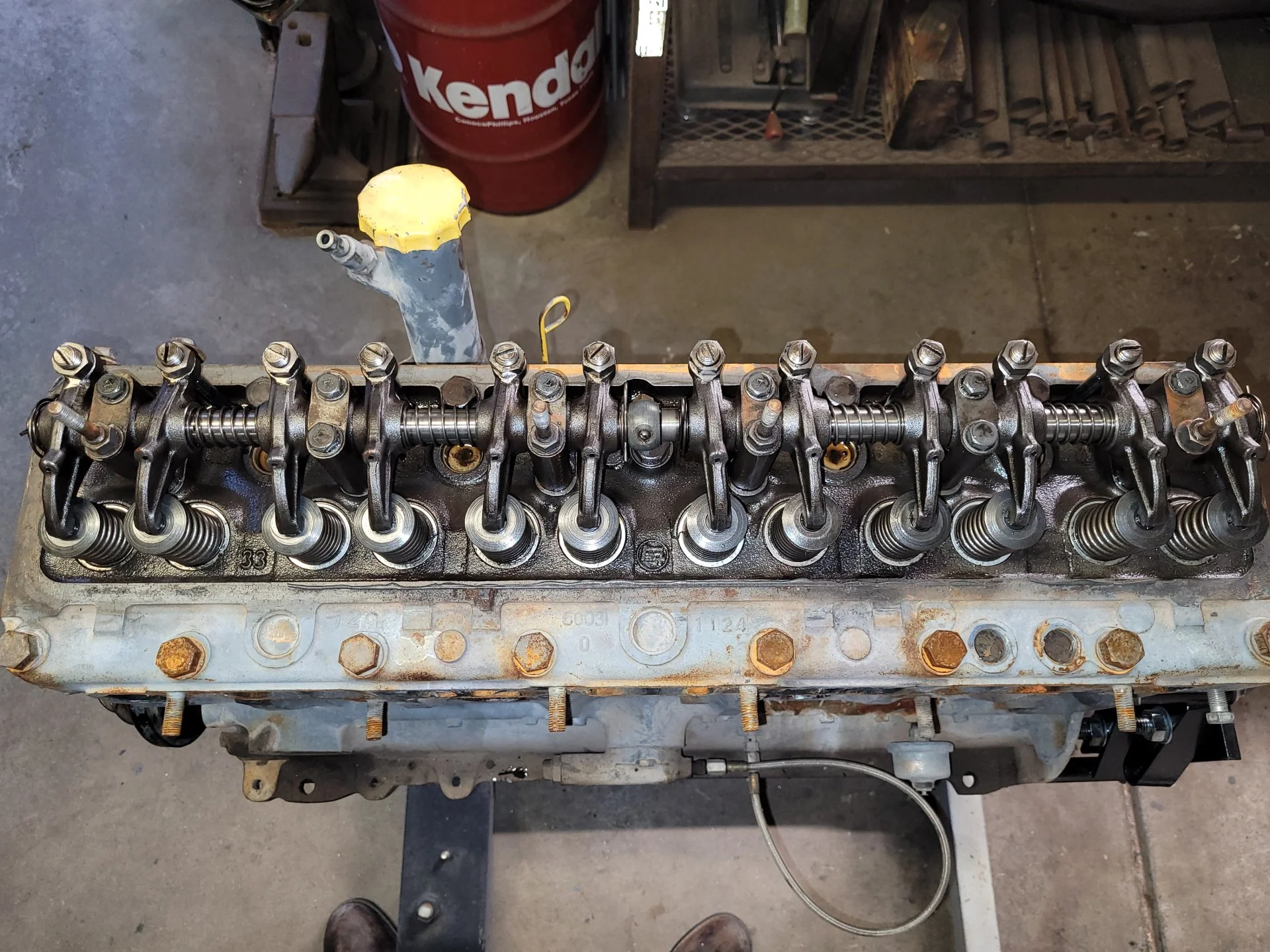

Does not seem too bad. Only thing is I don't really see any oil getting to the top end. Maybe a little oozing of the rocker on top of the push rod. How long does it take to get up there?
I have the side cover off so no worries on loosing the copper feed line nut. I did undo one end and ran the drill, but never got any oil. Possibly did not run it long enough.
Can also remove the copper tube from the rocker assembly and see how much oil is flowing. Just be sure to secure the nut from slipping down the hole in the head. It can continue down into the block. The nut is made of brass and magnetic wouldn't help retrieve it.
Add a stopper for the nut while it is outside and convenient
Turn the motor some to line up the oil ports flowing upwards. It's a hit or miss affair and takes a fair bit of turning before you get dribbles and finally only good flow. Oil generously while it's open or if you are taking apart the rockers, I give them a good coating of engine assembly lube to help out.
I would just pull the plugs and stab the distributor so long, then you can use the starter to spin it and also verify that you have positive engagement.

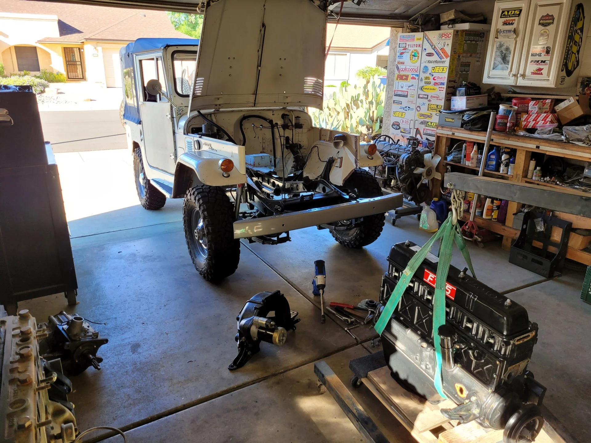

I ordered, hopefully, everything I need to prep and install the replacement mystery motor. In the meantime, I am cleaning up the trans and tcase. It seems the seal between the 2 maybe shot as the trans was over full when I drained it. I ordered the bypass hose. There also seemed to be fluid leaking out the top plate which I forgot to gasket or even rtv.....
If all goes well, this thing should be back together this weekend.
