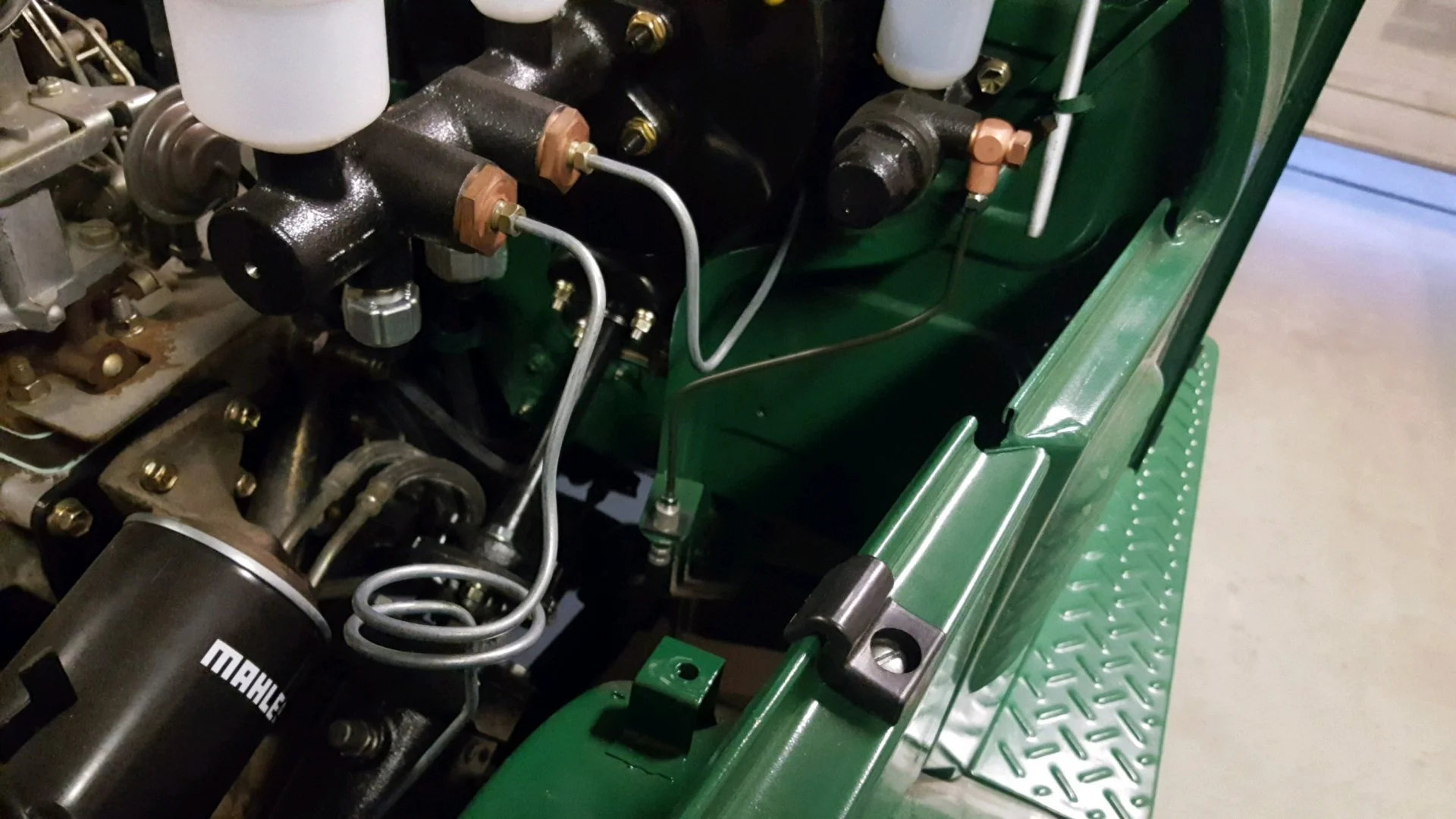

The fuel lines are 5/16ths and the brake lines I bought in a kit. They are 3/16ths.

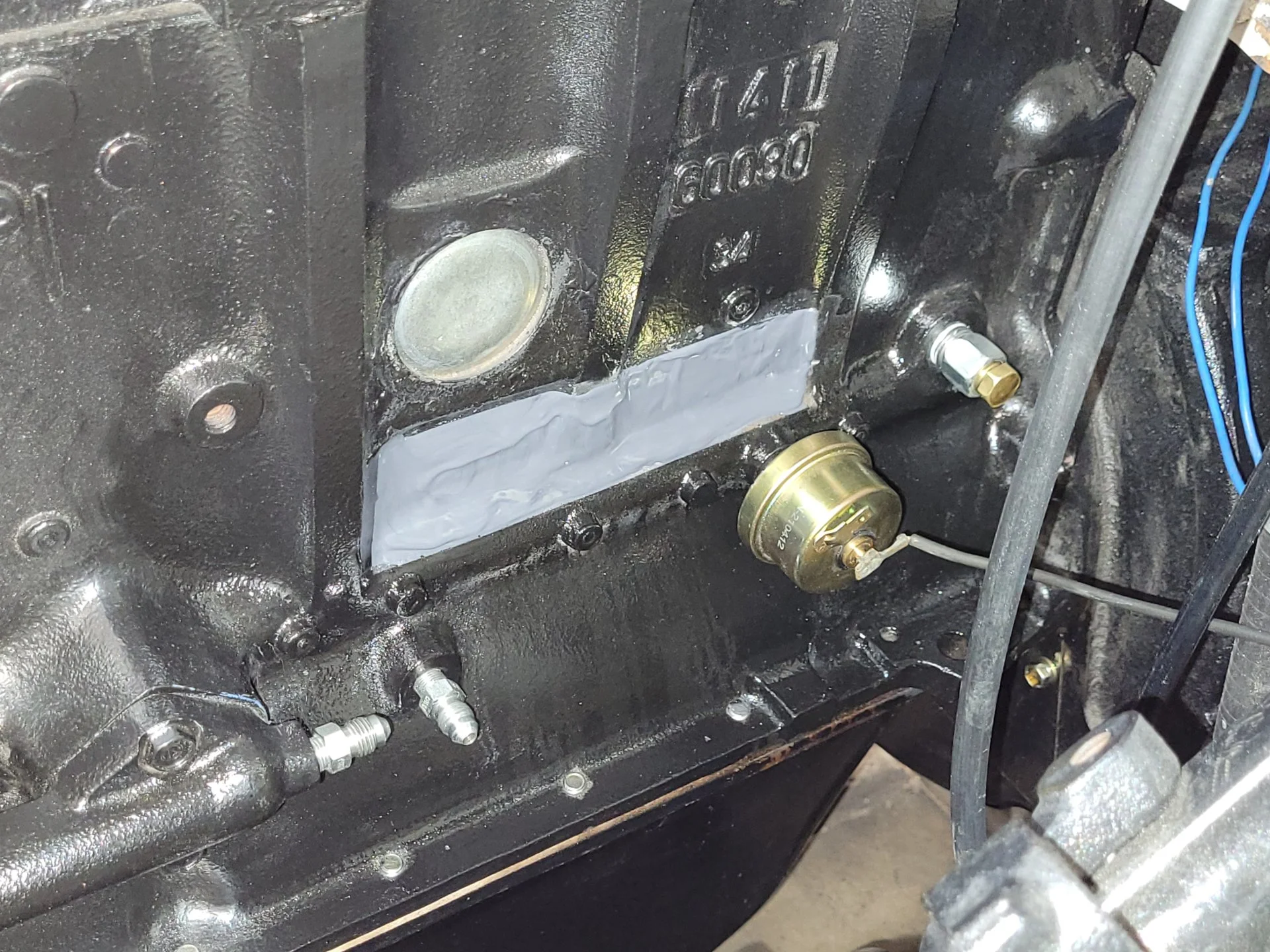

How did the weld repair turn out?

Here's the JB weld patch. Got the rest of the stuff back together. I will fill it with water and drive it on Sunday. Tomorrow I am going wheeling in the luxury boat.....I mean LX.

Added water to the 40......still leaks alittle. I will add some kind of stop leak and take it for a drive tomorrow.

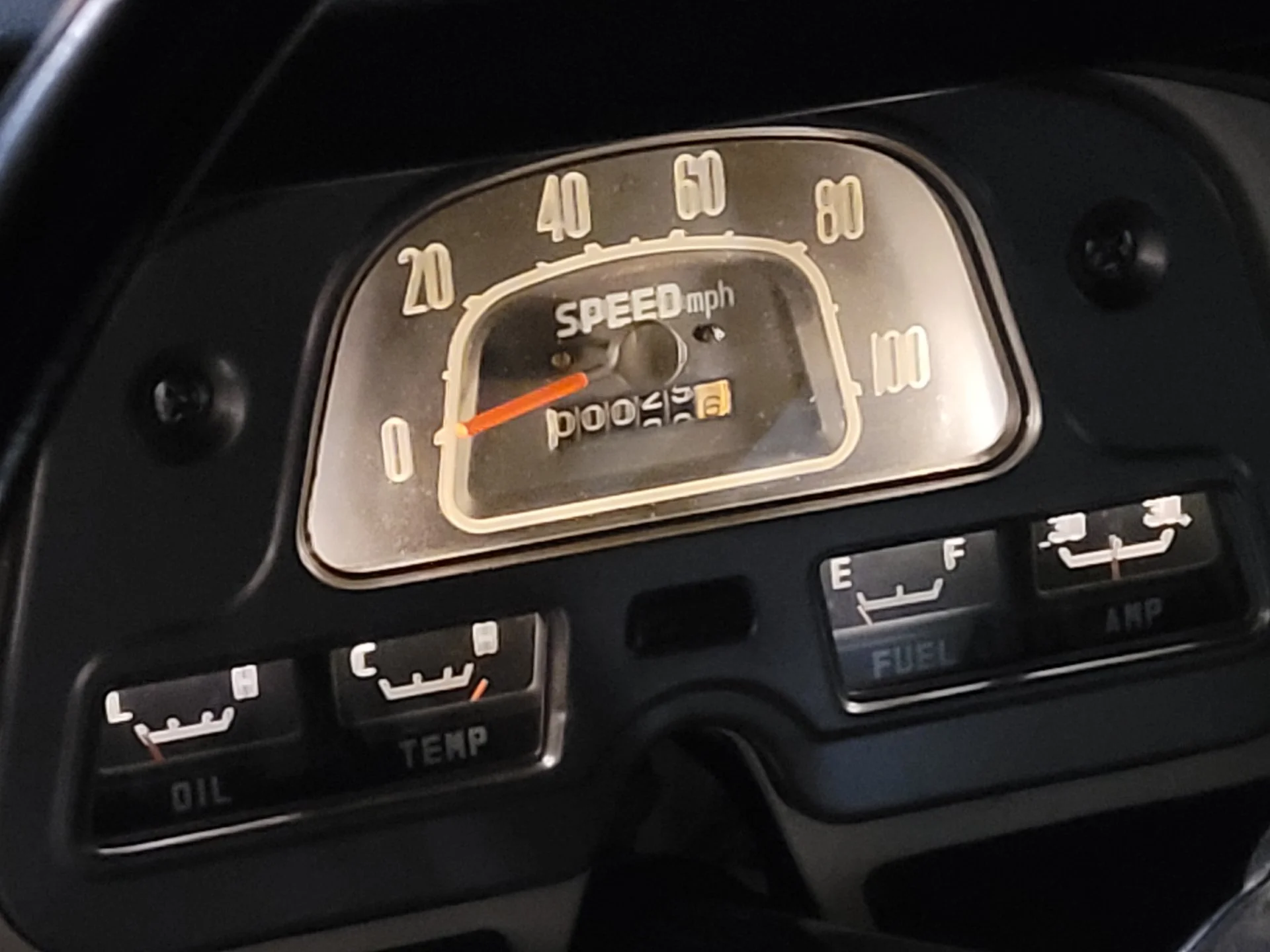

Installed some leds in the gauge cluster. So much nicer.
Dang that looks nice.

Been driving the 40 as the weather is perfect. Leak is almost non existent.

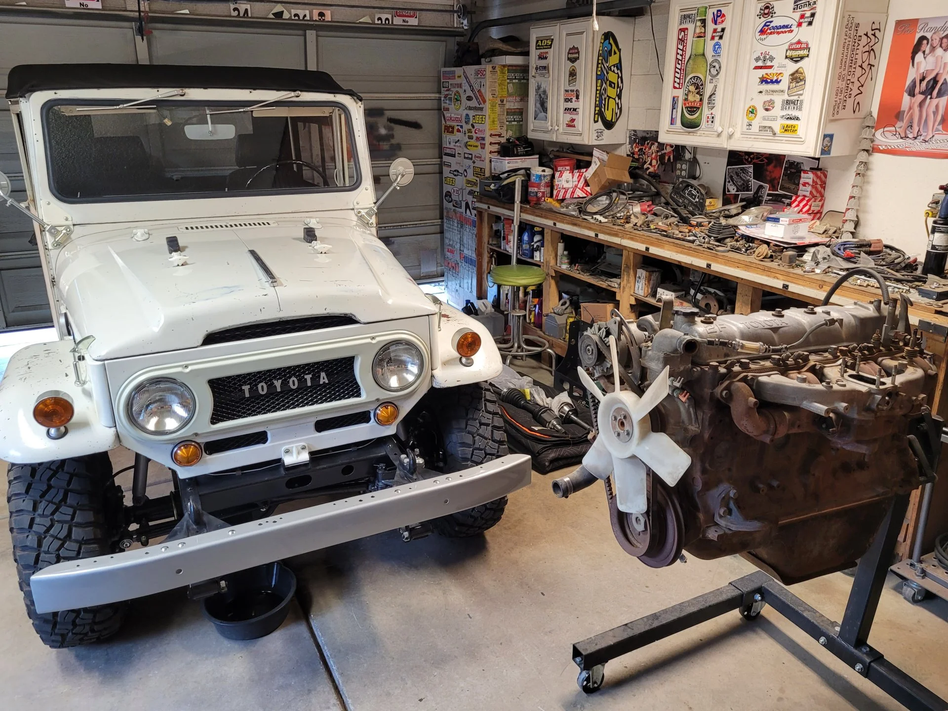

Rearranged some motors today. Here's my trio of defunct F engines. I have the heads and other parts stashed inside.

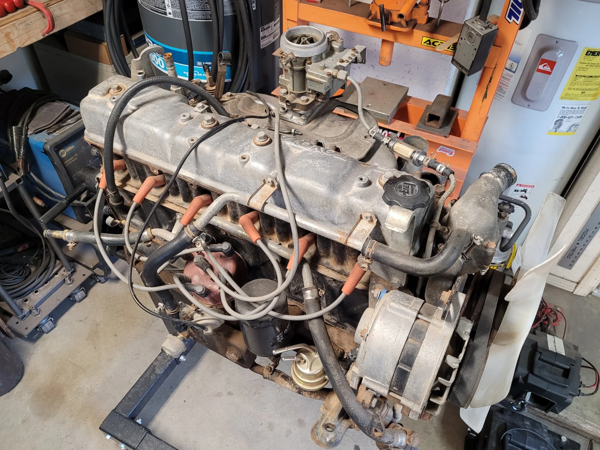

Got the 2F on the stand and started to tinker with it. First off was the Rochester 2 barrel held on with a Man a Free adapter.
Couple more survivors

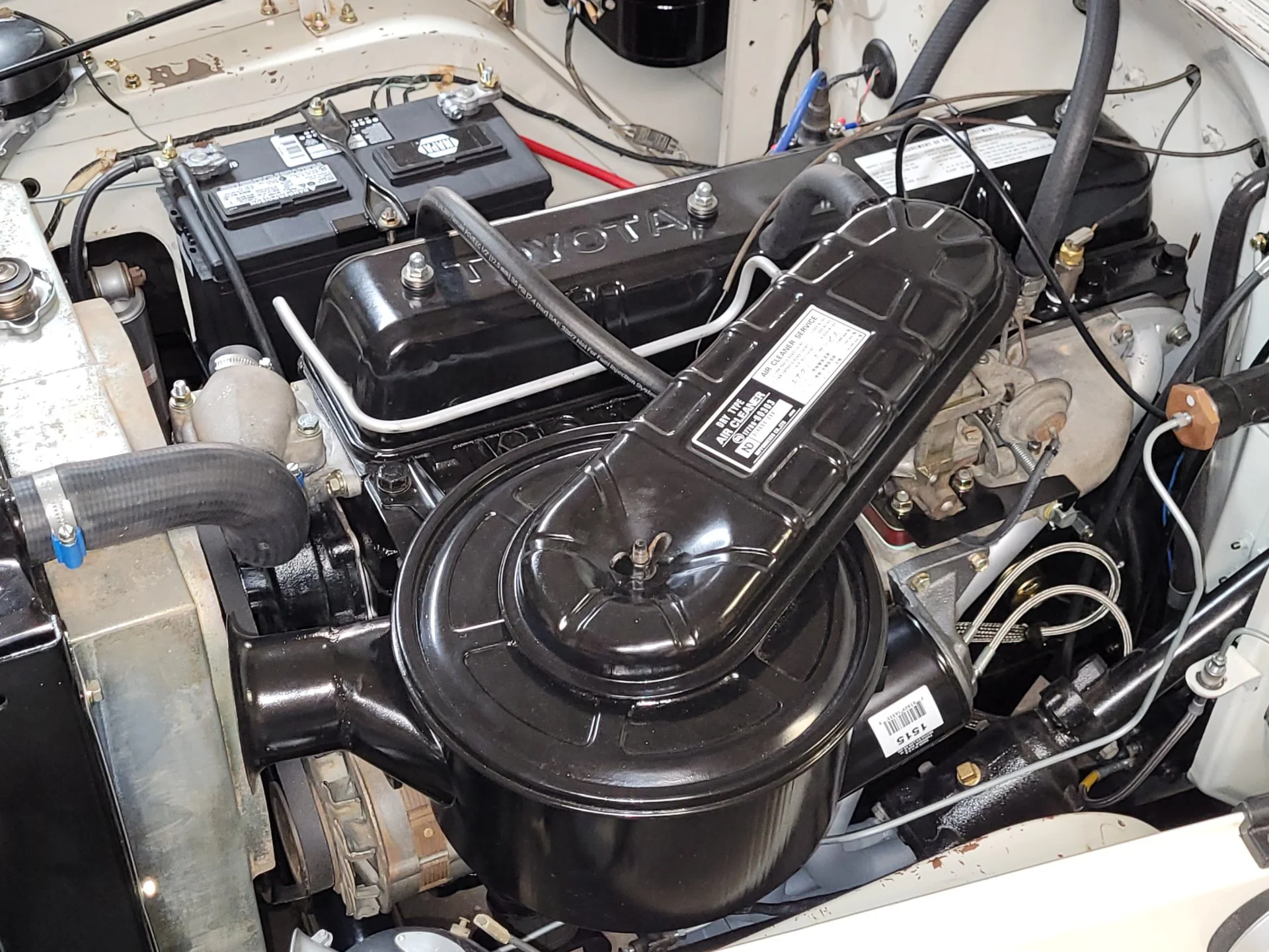

Unfortunately on the way home the 68 decided to spit out a freeze plug. That resulted in a James Bond smoke screen and confirmed one of my worries. The oil is leaking into the coolant. So the crack is a definite engine killer.
I installed an expansion plug the next day and added some water. Truck does not want to run now. More on this later.
