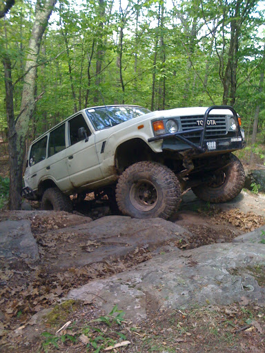

Lots of action with Moonshine over the past two weeks. Went offroading with GCLC for our annual Memorial Day outing and had a BLAST, but broke a lot in in doing so. Got there on Friday and went out for a short run Friday evening while waiting for people to show up. Saturday morning, went out on a run and while going up the first difficult obstacle, Rock On, I blew my first birfield *tear* on the passenger side after being heavy on the skinny pedal. As I was coming down the hill, the passenger wheel locked up and I lost the ability to turn left. Ripped into the axle on the side of the trail and started replacing what was broken.
I like this photo.

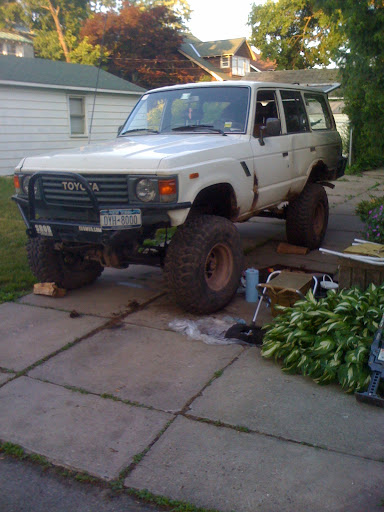

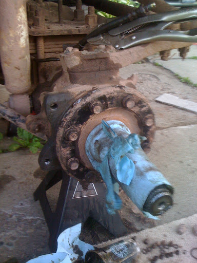

Turns out that the birf detonated and mushed the splines on the end of the inner axle shaft, preventing the star from coming off easily. Took a 3lb sledge and a lot of hits to get the star off the inner axle. The splines were still so messed up after taking the star off that a solid hour with a file was needed to make the threads able to accept a new inner clip and birf.
Long story short, got everything back together and snapped the brake hard line that goes from the caliper to the union on the backing plate. Ended up fabricating a new one using some harvested parts from an old 40 sitting in Dave's yard ( thanks again Dave! ).

Last trail of the day was Rock On, once again. I wanted to run it and conqueror the trail that ate my first birf. It didn't turn out so well :lol: Went about 15 feet farther up the first obstacle than I did the first time and was a bit liberal with the throttle, again. This time, we heard 2 distinct bangs and stopped to analyze the situation. Nothing was falling off, so we assumed it was another birf and disengaged the front axle to recover the truck. Turns out the rear driveshaft was spinning with no other movement. Since I've got an open rear, it could have either been the pinion or one of the axleshafts. The hub studs were not sheared so it could have been any of those three and we would not be able to determine until the truck was off the trail and on flat ground so I could take it apart.
Since I was up on this obstacle without forward or rearward movement, we needed two winches to recover me, one truck snatched to my front bumper to ease me down the hill and one on my rear bumper to pull me up over boulders. What a sight. I don't have any pictures of the recovery ( because I was being recovered ) but Nick Pearl and Jon Held were gracious enough to help out with their trucks and get me down the hill safely. Once off the obstacle, Nick helped get me turned around and I coasted down the hill to camp.

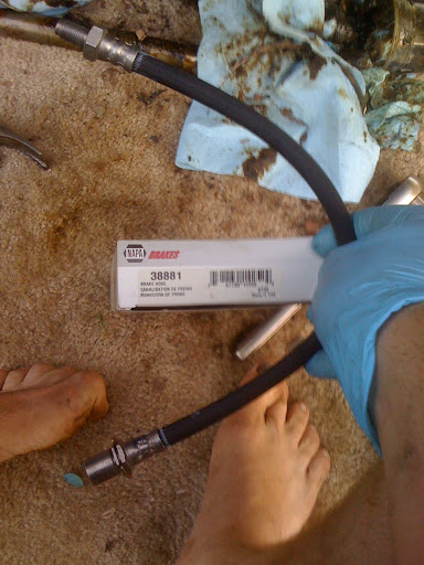

At the same time I decided that I was done with the backing plates and associated brake lines, so I searched around and found the part number for the NAPA brake line that can run straight from the axle to caliper. The part number is 38881 and costs about $18 per line. My NAPA had them in stock and I got them in a couple of hours.
