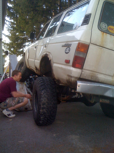

Gotta fxxxing deal with my rear axle again. The stupid bearings loosened up so I've gotta coax kevin into showing me how to properly set the preload. I'm thinking I'm gonna pull a freds40 and put a narrowed + shaved 14b under the rear, with the LCWizard sleeves for the front axle. 63" WMS w/ tons sounds better than 58 or whatever it is now.
Also, one of my fraternity brothers has a set of 37x12.50 swampers that I may try to pick up:hhmm:
to set your preload go tight as s*** while spinning the wheel and just keep going tighter and tighter till you cant anymore then back off about 1/8th of a turn and you should be golden. Its always worked for me and all of my customer vehicles which is a couple of hundred or so at this point. i had the same issue with my 60 on 1 side a few years ago and untill i did just that it kept coming back, now i have no problems.
