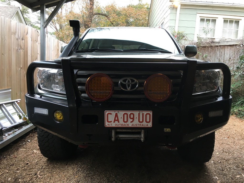

New license plate.
Still winchless.....

Body lift is done on the passenger's side
TJM Bumper is installed (note: upper trim pieces are not shown in the pic, but fit just fine)
The ARB will not be able to be modified. I will have to find some trim to fill the new gap, which shouldn't be too hard.
