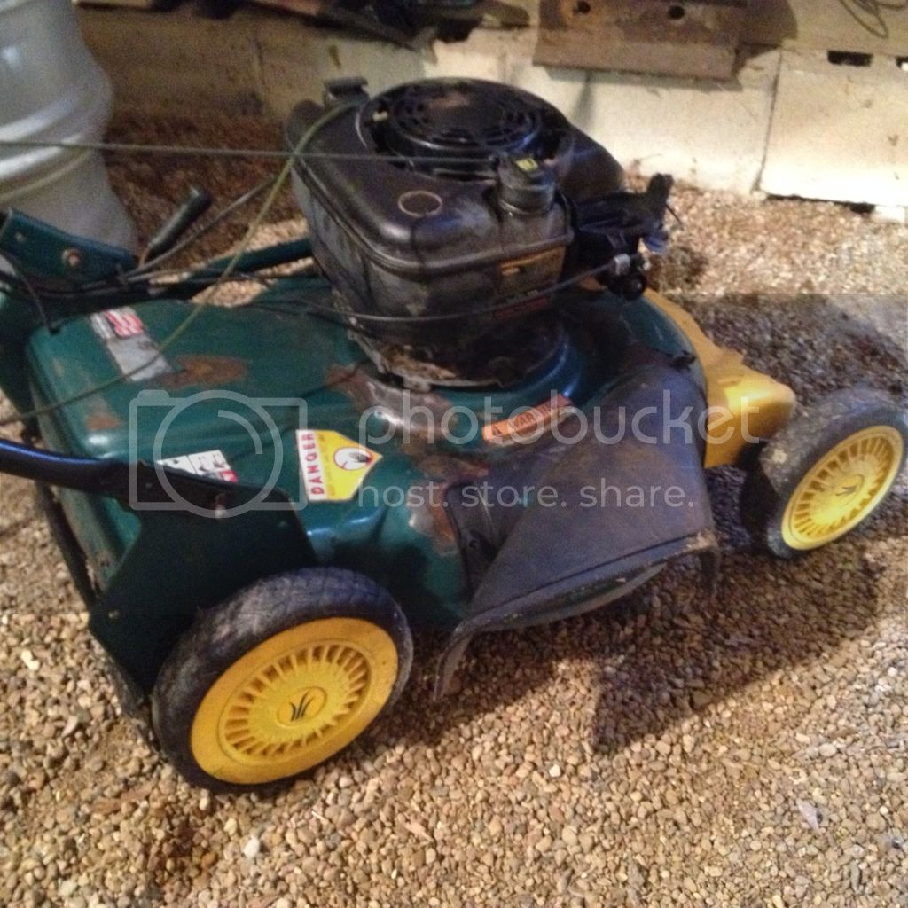

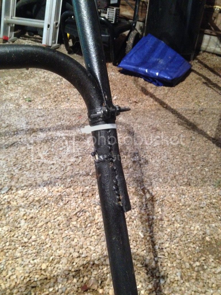

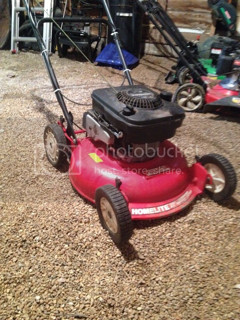

This is a self-propelled Homelite Bagless Mower with a 5hp Briggs engine and 20" deck and mulching blade. This thing was a real pace of work! Blade was bent and trashed. The arm assembly was cracked and broken in 4 places. Carb was completely fouled. Fuel lines were rotted. Filter looked like it hadn't been replaced in ages. Spark plug was bad. Wheel bushings were shot, and a number of other nuts and bolts were loose. The wheels are also bald from so much use! I went ahead and rebuilt the carb, cleaned the jets. Booger welded the handle back together. Replaced the fuel line. Rebuilt the recoil start assembly and replaced the rope with 550 paracord. Replaced the spark plug. Cleaned and tightened the wheel bushings. Checked off the oil. Cleaned the paper filter. Resharpened the blades. Hit it really good with the pressure washer too! It starts up and goes great now!

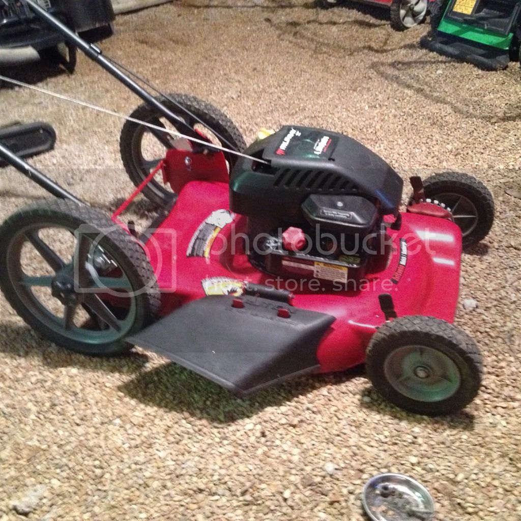

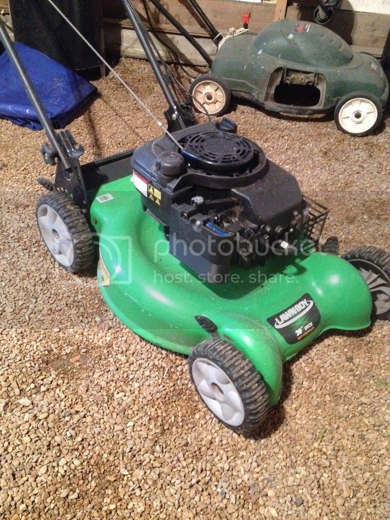

Here's a Yard Machines mower with 22" deck and 123cc OHV Briggs engine.
I went ahead and rebuilt the carb, and also cleaned the jets. The recoil start springs was cracked and broken, so I cut the spring, bent it into the correct orientation, and then rebuilt the recoil start assembly. Checked off the oil. Cleaned the paper filter. Resharpened the blades. Cleaned it off with the pressure washer. Starts right up now. This one is a simple mower and easy to pull-start. I think I am going to keep this one for myself.

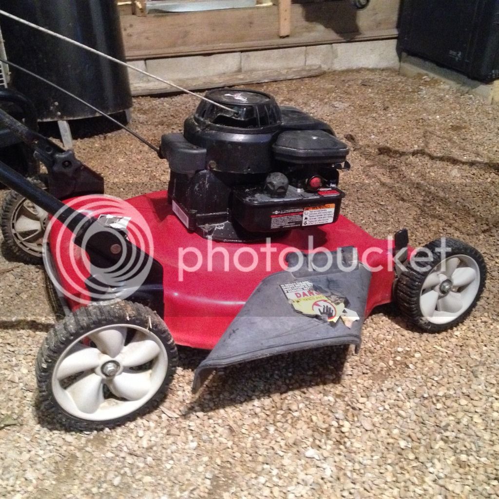

Here's a pretty decent mower I found over in Belhaven. It's a Yard Machines bagless self-propelled.
Again, I rebuild the carb, removed and cleaned out the jets (always need to clean out the jets!). Rebuilt and rewound the recoil spring. Sharpened the blades. Pressure washed. New air filter element. Fresh 30wt oil. This thing cleaned up really nice. Underneath all the grime, it looks almost brand new. I think I am going to get a pretty decent amount of cash for this one.

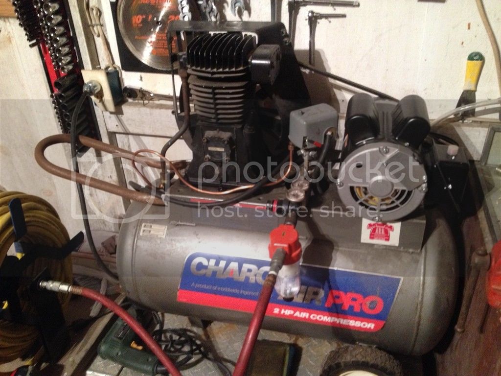

On a slightly related note, I refurbushed this old 115V Ingersoll compressor I got from my wifes grandfather. New oil. New motor. New copper lines. It will get up safely to around 160 psi, but I bet I could push it a bit more if I wanted to. I love this thing!

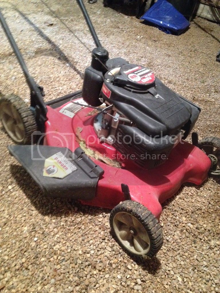

Also got this MTD Bagless with the same 4hp Briggs engine. Carb rebuild, new oil, new spark plug, new air filter, and she finally got started. Took a little work to get the carb tuned right, but I think I got it pretty close.

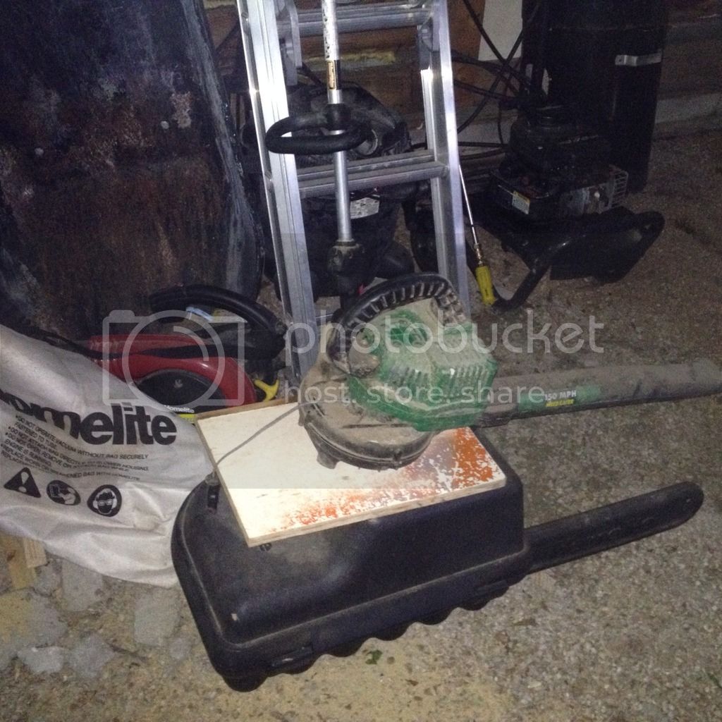

I also scored 2 blowers, a chainsaw, and a weedeater too. I have not even begun to look at those yet, but here is a picture of my loot.
All in all, it was a good small-engine weekend.; 3 mowers, 2 blowers, 1 weedeater, and 1 chainsaw.

On the weedeater, I rebuilt the carb, replaced the bulb, and replaced the fuel lines with 1/8" lines. Fresh gas/oil, and she started right up.
On the blower, I rebuilt the carb, and replaced the fuel lines with 1/8" lines. Fresh gas/oil, and she started right up too.
On the chainsaw, wait for it.....still waiting??? I replaced the fuel with some new fuel/oil, and it started on the 2nd pull!!!
