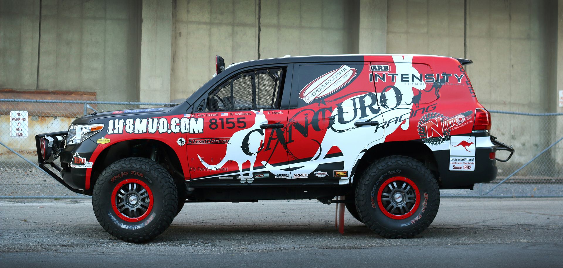

I dunno man, I think 37s would look pretty sweet:
I don't think is looks too posery either, though I know what you are saying.
@jasonbraswell , I think for now, I am going to look into doing a body lift, and see what kind of clearance I can get. I have a set of extra wheels at my house, so if I can find a beater set of 37s, just to play around with (cough cough @wct49 ) (or score some old BFGs on Craigslist), I can do some experimenting with offsets, etc., and see if regearing may be needed. I have no qualms about cutting the front fenders a bit; hell, I have already drilled a hole for a snorkel! Just look at that picture; it's gorgeous.
