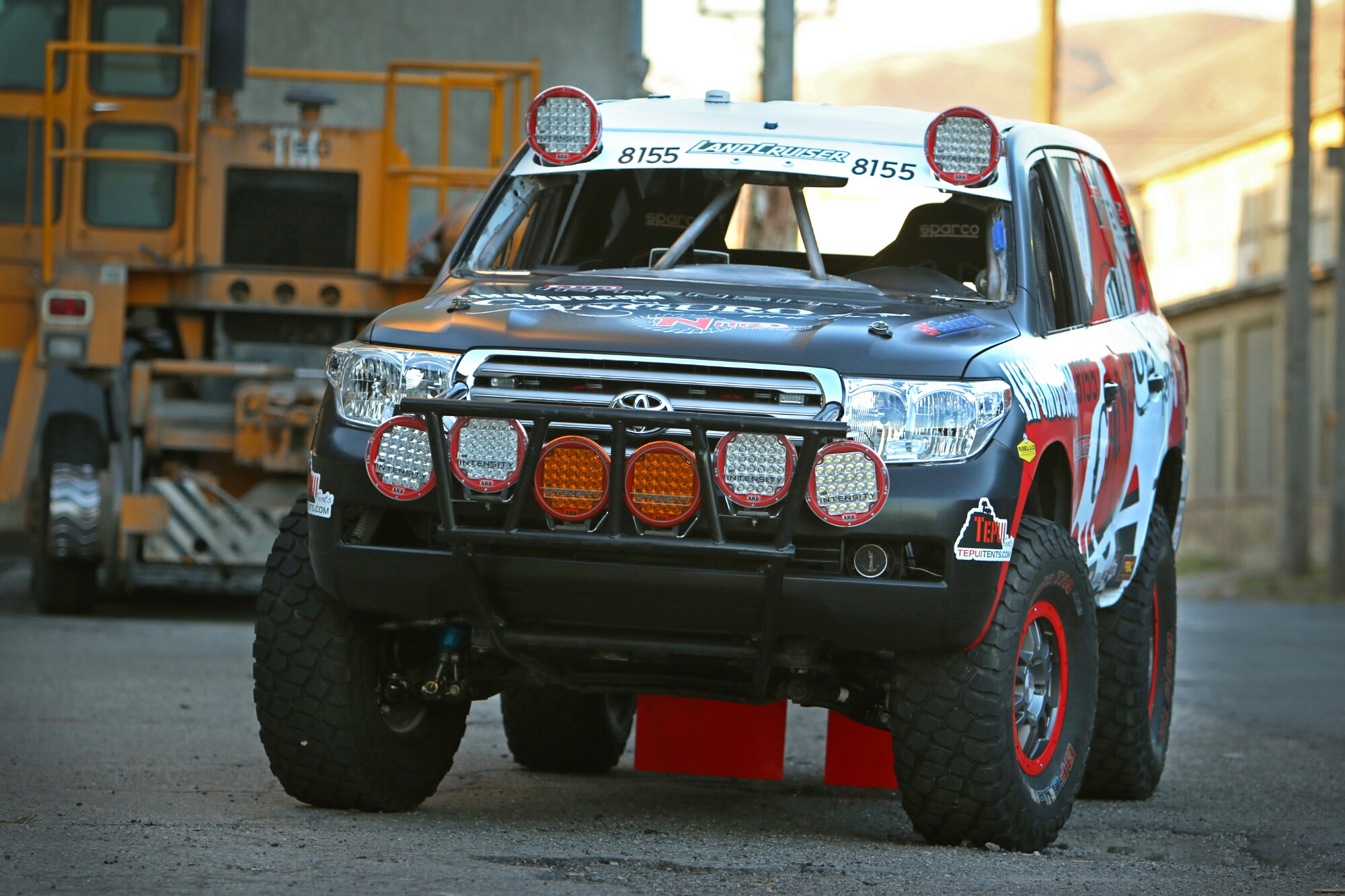

Meet "Fat Amy" my Amazon Green 200 Series
New 225W spotlights.
They bright.
I love em. These are 9"; is that what you went with too?
They are big but like other things. They're never as big as the first time you see'em
Don't pay too much attention to the 200 stuff since I'll never have one. Big lights... Ok whatever.
Living in the city, this was the darkest place I could find within about a mile from my house. The woodline is about 150-175 yards away.
Without any lights:
With my LED driving lights:
With my LED high beams:
With the new LED Spotlights:
They are very bright. Now, that being said, they are still LED and will not have as much throw as some high-power halogens.
And just for fun, this is what it looks like from about 25 yards away. My neighbor texted me and asked me if a UFO had landed in my garage. Haha.
awesome! these look so much better than the light bars on every chevy/ford going down the road these days
Thanks, I think so too. I got a friend that has the real deal ARBs to take me some close up shots of his, and I s*** you not, they look like they used the exact same moulds. Gotta love the Chinese. That being said, you know I gotta be different. Based on my belief that these ones are the exact same dimensions as the real mccoy, I went ahead and ordered a set of ARB Intensity Amber Polycarbonate Lens Covers from LowRangeOffroad. Should look cool.
cool, looking forward to pics of those filters on. I am leaning towards those and wanted to see how the lights shine through
