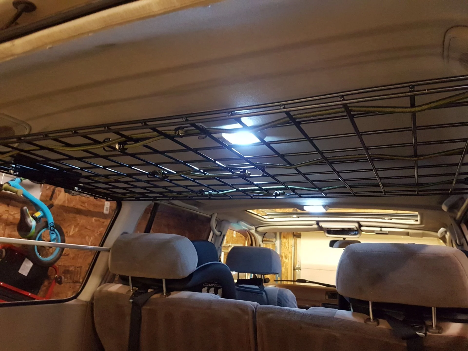

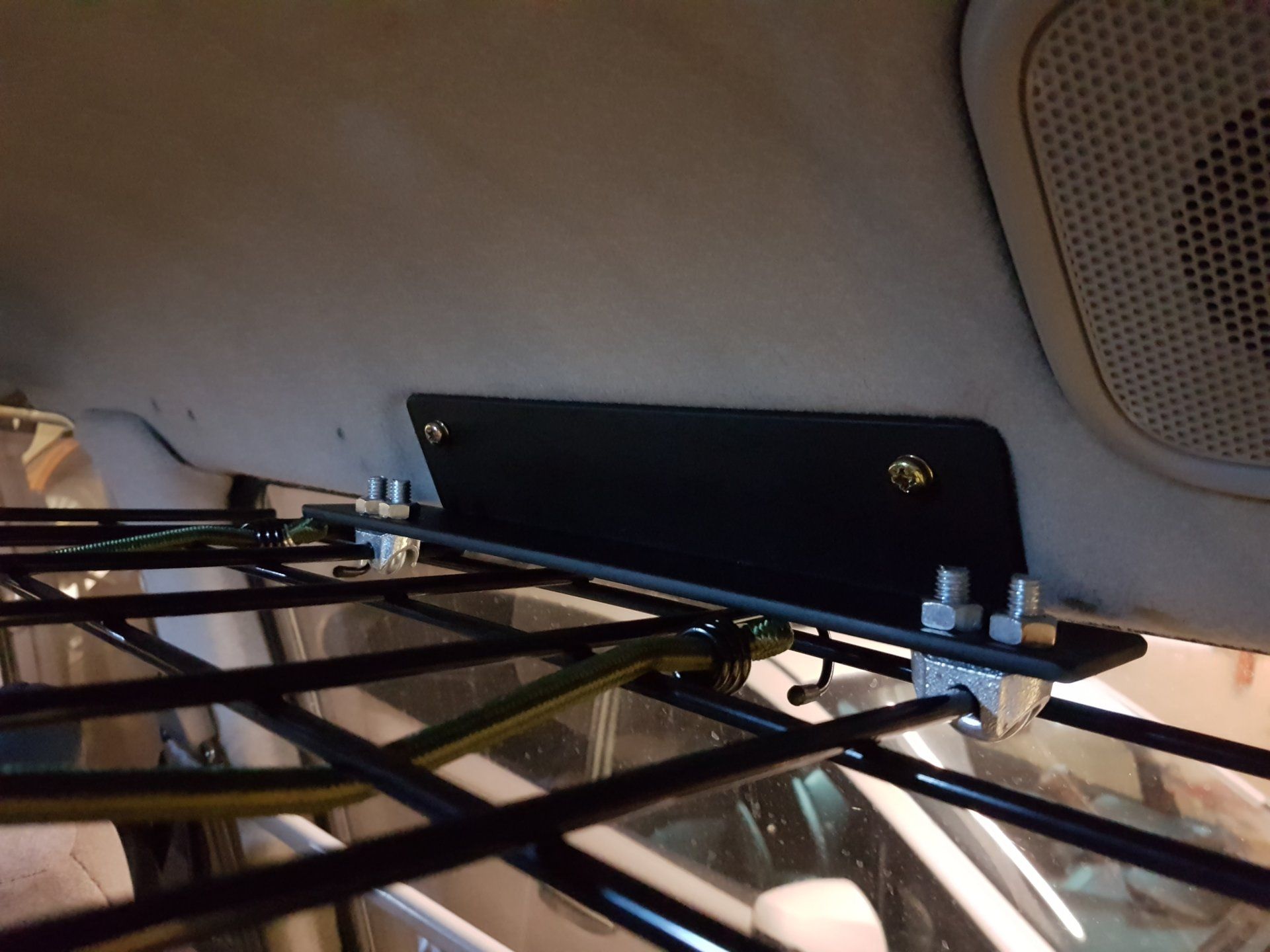

Built an attic rack, for soft goods only of course. I shamelessly stole the bracket idea from @jcardona1 as closely as I could because I thought it looked way more sturdy and clean than the sketchy tye-raps or hose clamps from the low cost attic thread. Weaved in bungees will be used to hold the towels, hoodies, blankets, pillows etc in place.
About $40 in total.

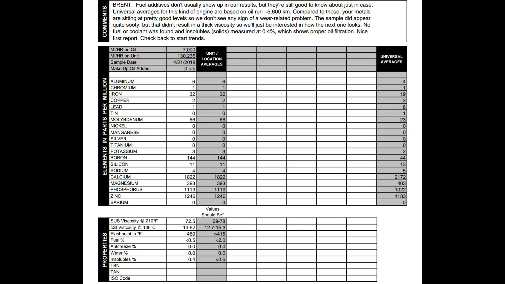

And, I finally got my first Blackstone Labs oil report back today. This was what came out after I completed all the engine work last month. Seems everything looks good and healthy after 7000kms and 12 months on Rotella T5 semi-dino 15w40. That's nice to hear.
5w40 full synth went in this time, so we will see how it looks like next time it gets drained.

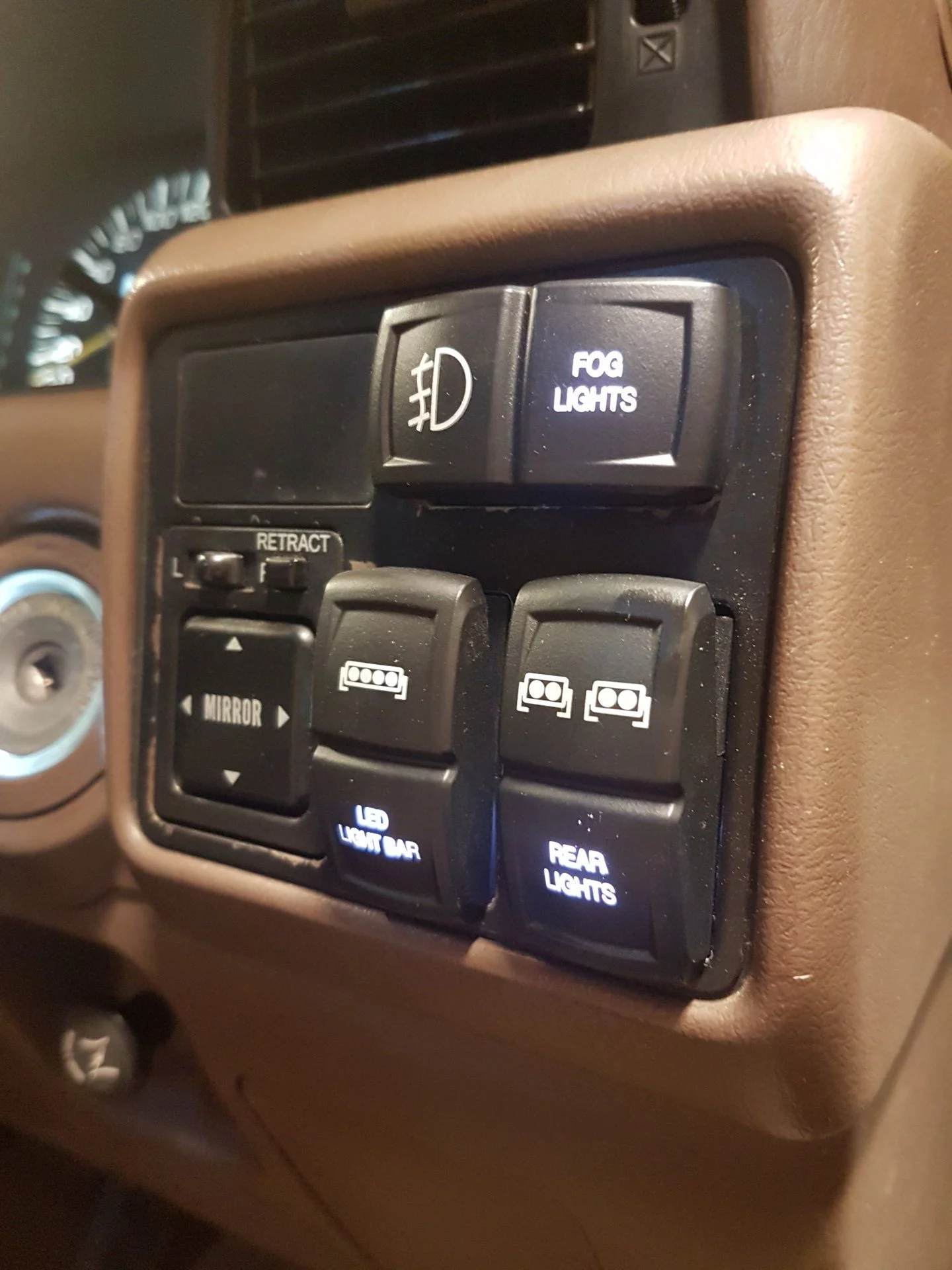

Also did 1/2 of an auxiliary electrical stuff install. Wanted some of it to be running sooner than later, hence the hokey job. Basics are there though, Bussman fuse/relay box, OTRATTW switches, Blue Sea dual USB charging outlet in the center console. Switches are independently lit and wired so that they only work when key is turned on, but circuit is ready for a bypass switch. Mounting plate, more switches, second USB outlet still to do later.
