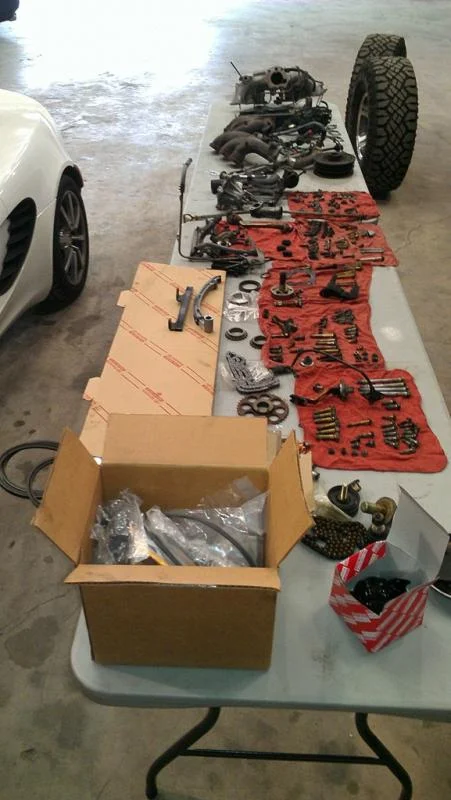

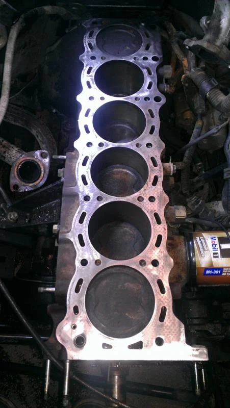

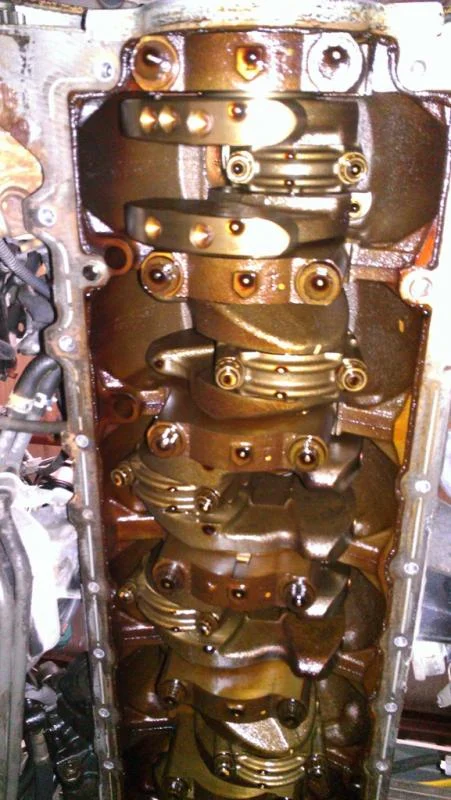

I don't think I am going to do bearings and rings.... The engine is fairly low mileage, 139K, it has been running synthetic for the last 30k miles, and I don't see a lot of oil use. According to Toyota's life cycle plan for the 1FZFE, they should be good for another 160k, lol.
Looks good Scott! Did you go with new bearings and rings? IMHO if you are that far you might as well.
Yeah I think it's just a matter of where do you stop? Remember this was all just "Preventative Maintenance". The truck ran great, I just wanted to do the head gasket so I no longer had to worry about anything on long trips.
concretejungle said:
OK, but it's cheap insurance for an even longer life! Did you plastigauge to check tolerances?
scottryana said:
Concrete,
You could inspect the bearings for signs of wear and scuff marks. If none are found on the cap side you can just reassemble and not worry about it.
I wouldn't bother with plastigauge if there are no signs of scuffing.
Thanks for the sanity check, I will recommend it to the shop. I think they were going to try and work on it the rest of the week and get it back to me soon.

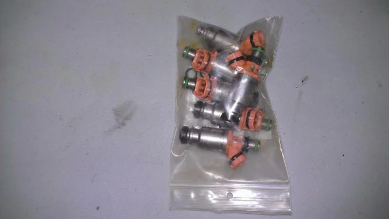

Injectors back from Triplet Diesel Injection for cleaning.
Before @ 43.5psi: Even after running about 4 bottles of Chevron Techron over the last 10,000 miles
Inj1: 292 cc/min
Inj2: 294 cc/min
Inj3: 302 cc/min
Inj4: 293 cc/min
Inj5: 299 cc/min
Inj6: 293 cc/min
Notes: Leak test, Injector1 and Injector 6 dripping before cleaning, not closing completely. Spray patter on all injectors marked as “Good” before cleaning.
After @ 43.5psi:
Inj1: 306 cc/min
Inj2: 307 cc/min
Inj3: 307 cc/min
Inj4: 306 cc/min
Inj5: 306 cc/min
Inj6: 306 cc/min
Notes: Leak test, all injectors good. Spray pattern on all injectors marked as “very good” after cleaning.
