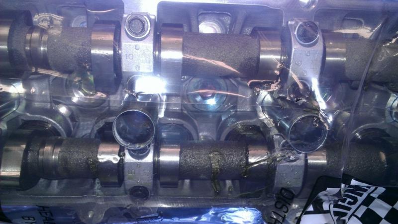

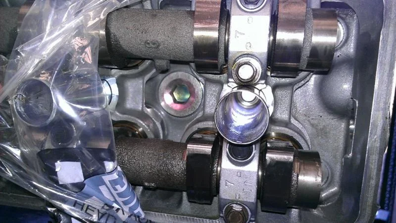

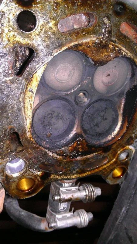

Looks about the same as mine did (also had next to no maintenance before me). My cooling system was not as bad as that but the PO did mix and it took me 3 flushes to get it clean (er).
I have heard a good way to flush a system is to use vinegar and run it for an hour or so then flush twice with water and bit of baking soda. I have not tried it myself and i would research it before trying it.
The cam area of your head looks good, mine was black with burnt oil.
It is funny I think the PO did a good job with synthetic oil changes and actually had a little book in the glove box for oil changes and tire rotations, but the cooling system was totally neglected. I am hoping to talk EMS into flushing the motor through the top heater hoses when the head comes back from the machine shop and it is back on, but before we hook up the new radiator, and then I will do a chemical flush and let it really work then flush it through the block.

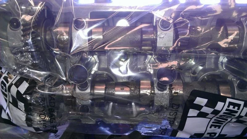

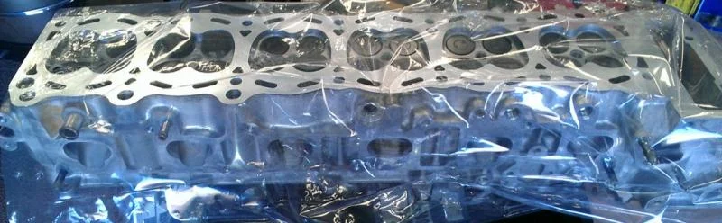

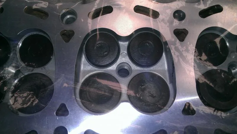

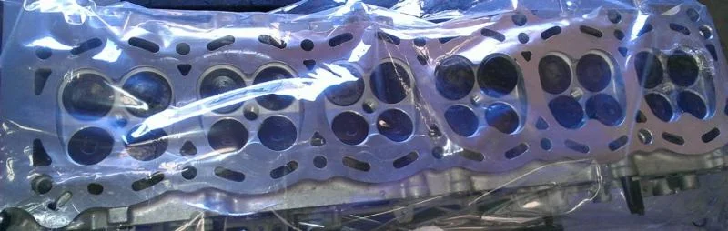

So went up to take a look at things. I think the block is actually in really good shape and will clean up great! The head is also in good shape and we are just going to have it sent to the machine shop as insurance, valve seats, etc.

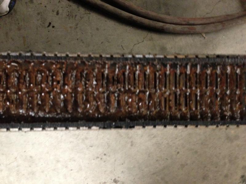

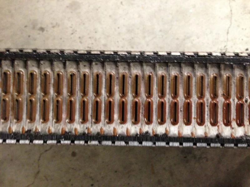

While I was there I was curious how bad my stock radiator was since is looked fine just looking in the cap, or hose necks so we put it up on the bandsaw and started with first cutting the bottom tank off.
Wow looks really good.
Now the upper tank.....
Yeah that is a problem! Probably 20-30% of the upper fins were clogged, not to mention how many were open on top but clogged somewhere inside. Can't always judge a radiator by looking through its cap. :-p
The head work was all done by a local shop that EMS Powered uses, I was going to farm it out, but I trust them to work with shops they are comfortable with. Not to mention if they have a working relationship with the shop it is more likely that they can get them back in a decent amount of time. I am trying not to be a difficult customer, something I might have been called in the past. ha!
Who did all the head work?
Do you know the shop?
