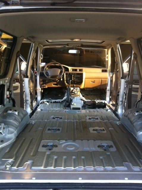

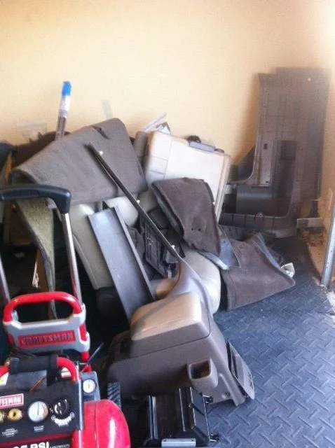

No it won't be loud and obnoxious I am way past that part of my life. I actually pulled the entire interior to lay down sound deadening material. I also wanted to pull the center console and the worthless subwoofer and 6 disc cd changer and replace it with a Tuffy console to lock things up.
The stereo will be pretty tame

Holy hell, where did your interior go ? I can only imagine you are making that vehicle into something loud and obnoxious like the ones that drive down my street late at night.

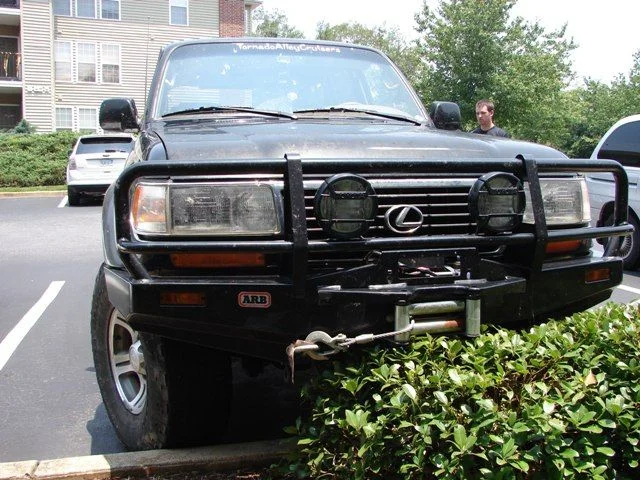

my son is attending school out in western kansas...his mom and i feel safe with him in that vehicle.....he has been educated well by the boys of tornado alley about vehicle maintaince....we are confident he will have this vehicle for many years.....here is a pic of jakes lx...taken while he was playing ball in clemson this summer

Back to the interior pull and install.

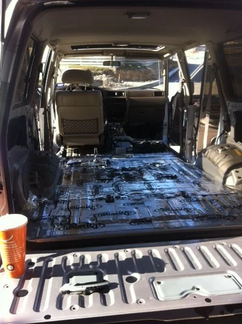

This sound deadener install is not as fun as I had hoped it would be. Ha! Interior pilled in the garage, and about 1/2 way done with the dynamat install.

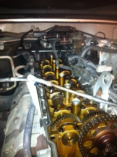

Valve cover pulled, valves checked, vc gasket replaced, spark plug gaskets replaced, PCV replaced, PCV hose replaced, spark plugs replaced, spark plug wires, replaced, distributor cap replaced, rotor replaced, intake hose replaced, water bypass hoses replaced. I am going to have a new engine bay at this rate.
Haha Tapage, I know what you mean. This isn't anything new that hasn't already been done by most of the guys here I am just documenting it encase I have to sell it or something happens.

Sound deadening is in, covered from tailgate to firewall with Dynamat Extreme, then from the raised floor of the second seats back to the tailgate I used Second Skin Audio's Mass Loaded Vinyl Barrier (Luxury Liner Pro), its a vinyl pad with a dense foam attached to it. I can tell you that the dog certainly approves! He thinks it is like a dog tempurpedic.
