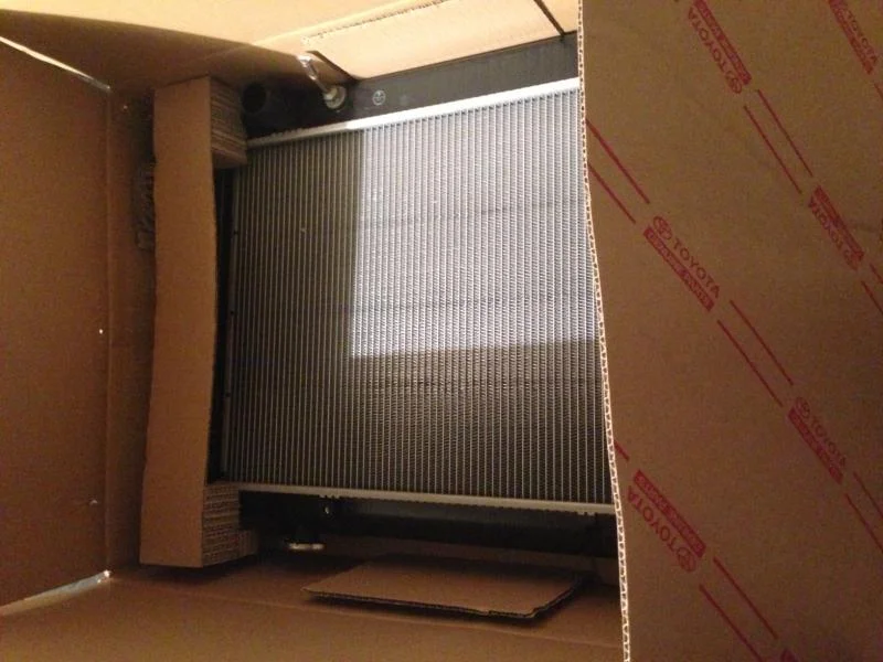

Aluminum Radiator

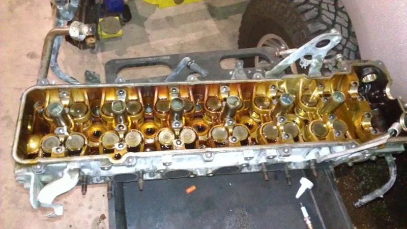

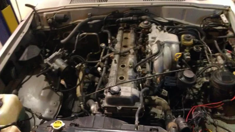

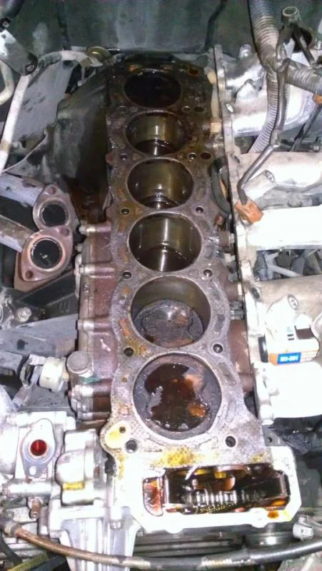

Dropped the truck off at EMS powered in Austin, going to have the head removed and gone through, rear heater delete, stainless headers, and full stainless exhaust done by them.
Good Job doing it right, I did the same when I did my head gasket. Feels good knowing its all new in there and mine ran a hell of a lot quieter after too.
I would send your injectors out for a cleaning as well. I do that on all my cars now when they are down for repairs such as that.
EMS Powered putting in work

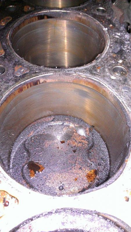

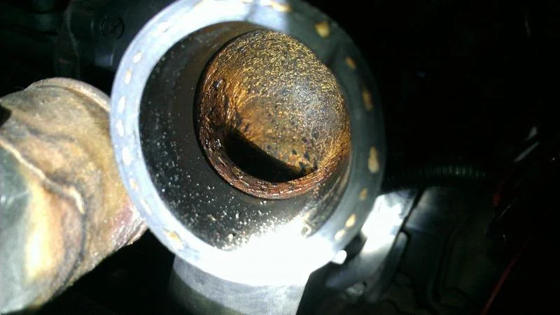

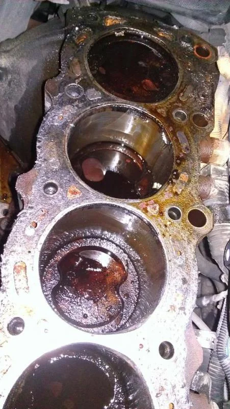

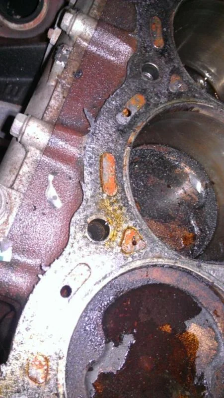

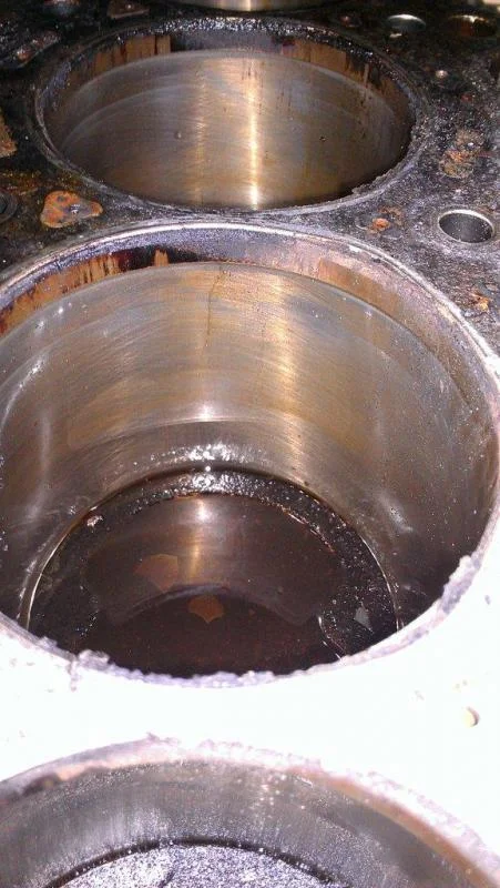

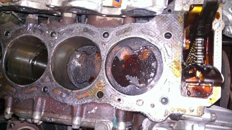

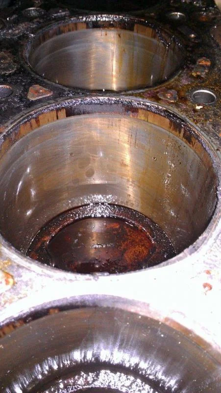

So the guys at EMS got around to pulling the head off and sent me a few photos, I will be going up Saturday to take a look at things in person, kind of hard to really tell anything without a little clean up.
One big concern I do have is the buildup in the cooling system. Like I mentioned before I don't think the coolant was well maintained before I got it. There was the tell tale sign that the previous owner had mixed red and green coolant and it was a mess, before my 4 or 5 flushes. There is still a lot of "build-up" on the upper rad hose neck, any ideas on how to get rid of this? I am not pulling the entire engine down and dipping the block. Chemical flush maybe? Thanks!
