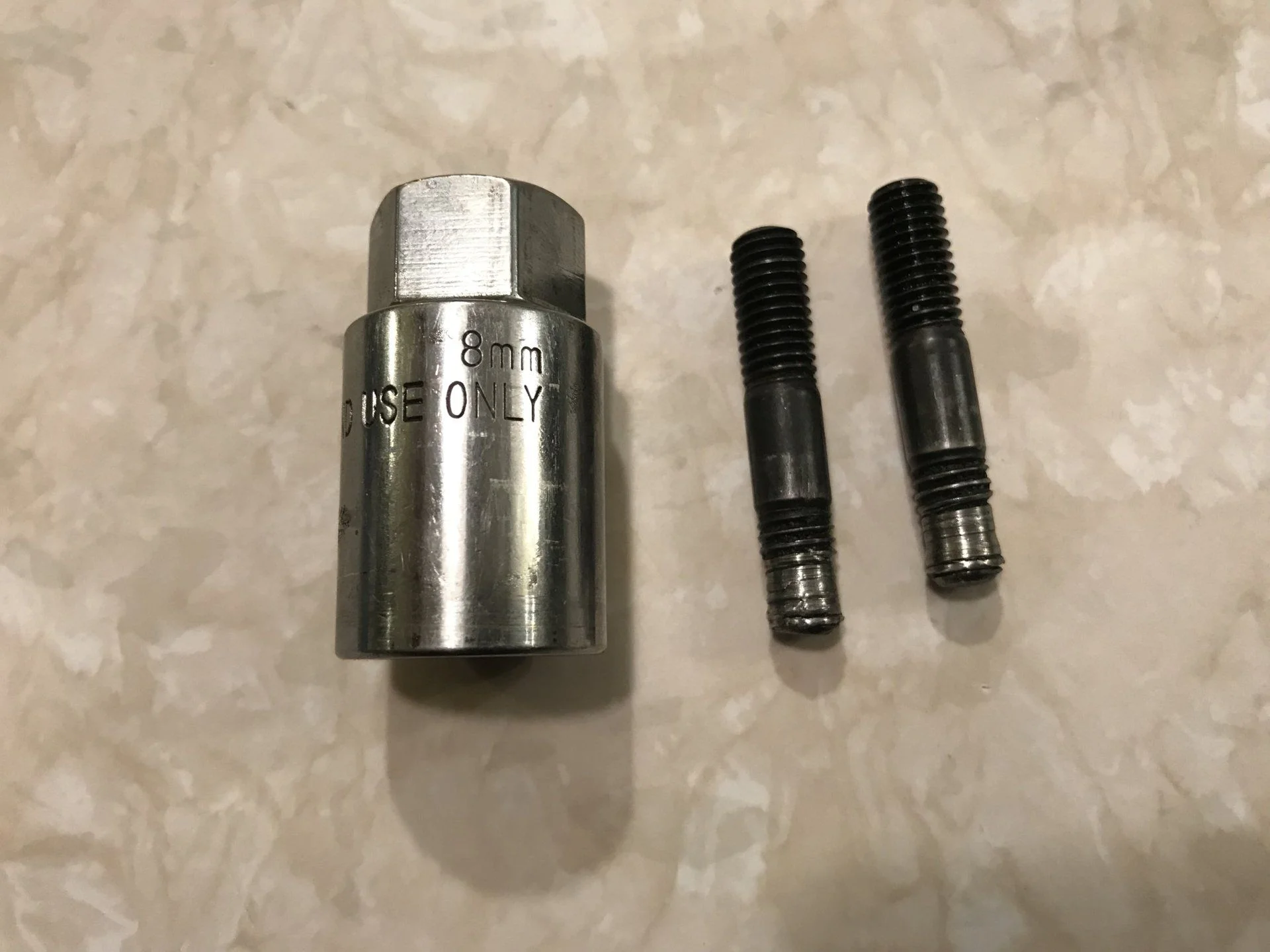

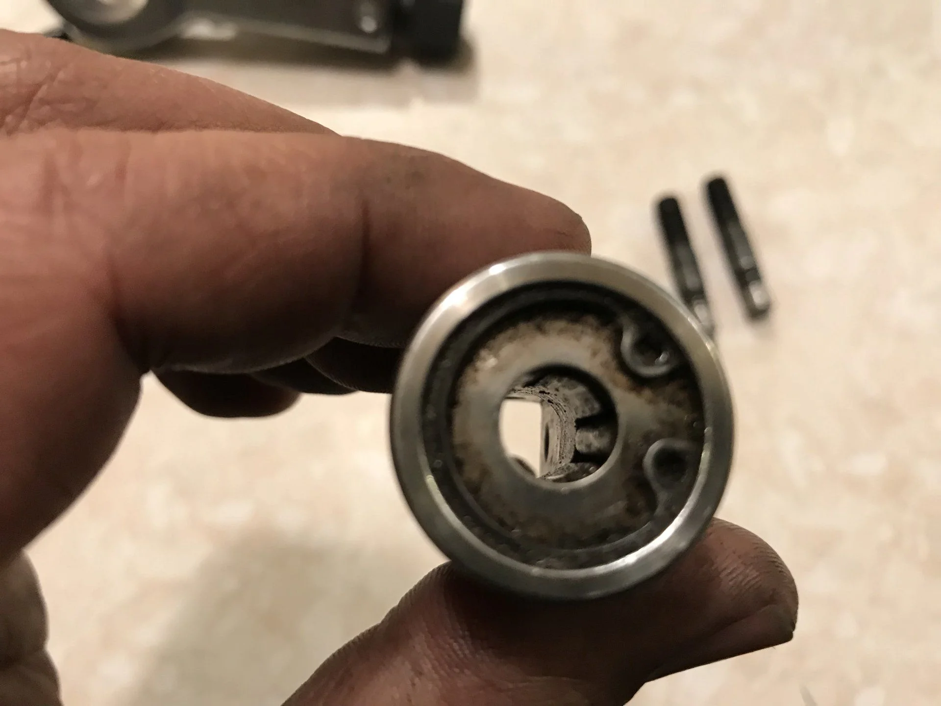

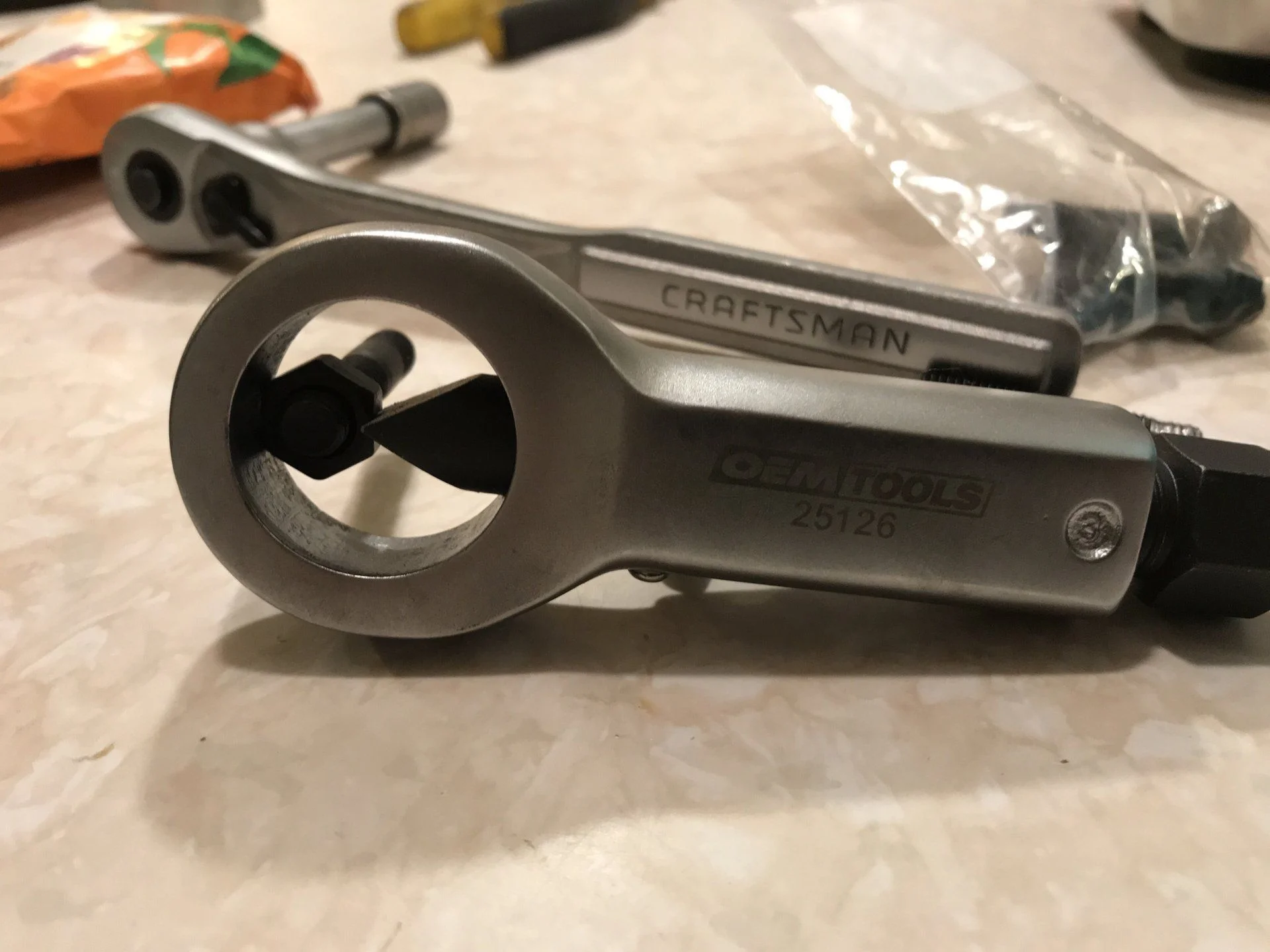

Hello brothers! I got the problem solved. I used a nut breaker tool and stud puller tool. These two tools "must have tool" for DIY jobs. The stud puller tool is from heaven, it don't have threads inside that really amazed me, it has some kind of bearing locking mechanism that locks on to the stud without destroying the threads on it.

I was going to mention a nut breaker but was not sure if you had the clearance to get in on the stud with the flange in place. That stud remover/installer looks just like mine.
One of my favorite things to do (with eye protection) is to run an impact wrench on a nut breaker. My inner Tim-the-Toolman grunts every time.
