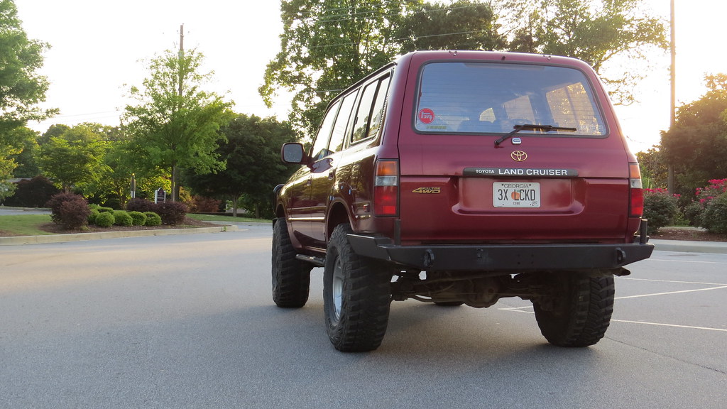

Its a factory 3x locked, 1997 non-collectors edition with 218,XXX miles that came with a 4" OME lift, ARB front bumper, iron pig offroad rear, trail gear sliders, 315 BFG ATs, flat rack, and best of all, heated seats :princess:
We haven't done much to it since then because were always working on my brother's FJ62 (https://forum.ih8mud.com/threads/my-first-toyota.581380/). But I have wired in the CB to be ready for GSMTR, deflared, removed the roof rack (until i have time to clean it up a bit), and slapped on some 315 Goodyear MTRs.
Distant future plans include: Longs, Bumper swing outs, iron pig skid plate, Slee 4" kit and 37s (trying to stay as low as possible), 9.5" front diff swap (because it looks like a fun project), Marlin Crawler "crawler gears", and anything else that we can come up with.
But don't worry, this thing will be wheeled all throughout this build :)

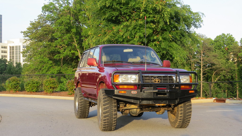

As she sits today…

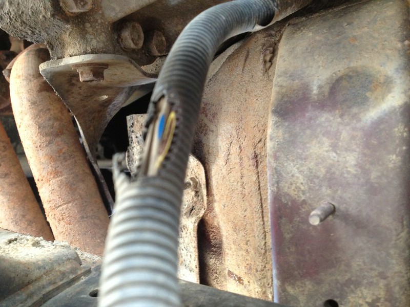

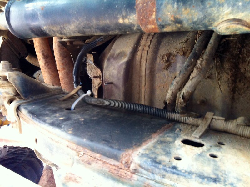

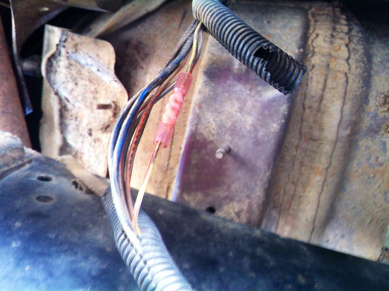

a few days ago i started welding the holes left after deflaring the 80. I should be done with that tomorrow, so i will post pictures of that job then. Today, after the expo ride the GA Cruisers put on, my bother dropped me back off to the home depot so i could pick up the 80 which I left there so I could just ride copilot with him. I tried to turn the key and nothing happened. This occurred a couple months ago and ACC figured out that the EFI fuse had blown, so I had an idea of what the problem was. I changed the fuse, and it ran for maybe 30 seconds and cut back off. I'm glad I carry around so many 15 amp fuses because I must have blown like 4 when I finally decided to check mud. It looked like a bunch of people had problems with the O2 sensors when their EFI fuse blew, so I decided to check out underneath.
the harness leading to the O2 sensors had been hitting the front driveshaft and just melted away and left a bare wire that was shorting out on the driveshaft. it was a good thing we were at home depot because we just needed butt splices to fix it.
after I butt spliced it I heated up the heat shrink and electrical taped it back up and zip tied it to the frame to get it out of the way of the driveshaft.
Im glad we figured out the problem because I was about 60 miles from ACC had to head back to school. the good thing is my check engine light, which always stayed on, went off after this repair.

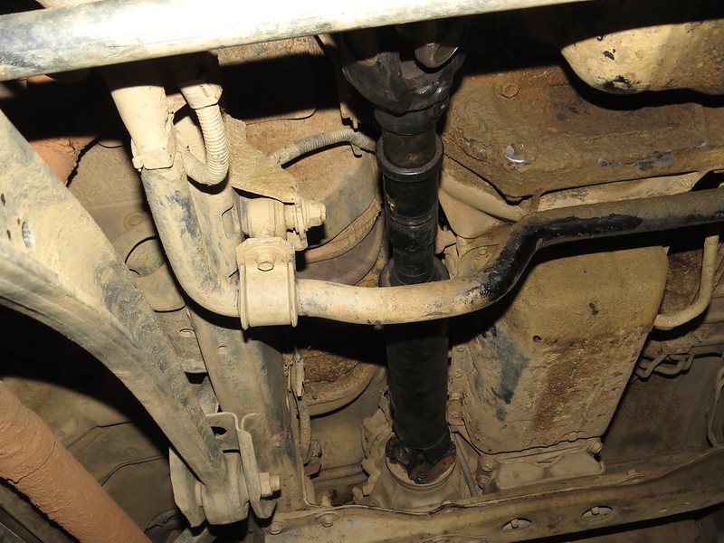

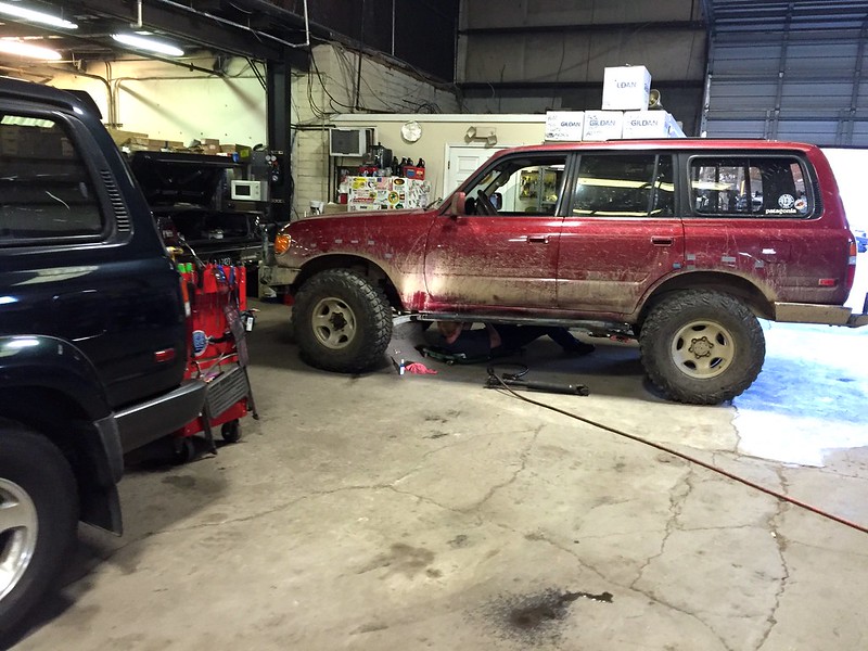

On the way back home, my truck started to make a constant clicking sound that would stop after I got up to about 35 mph. It sounded a whole lot like an aussie locker when going around turns. At first I thought that it was something in the front axle because it was in dire need of rebuild and I had put it off for a few weeks too long. After stripping the whole knuckle down, I found that my upper trunion bearing was a bent and had to be replaced.

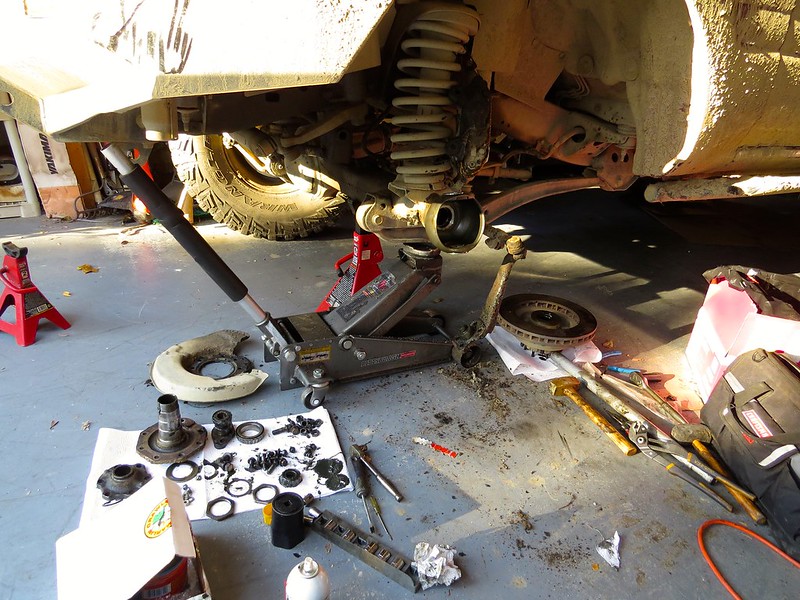

The next morning, me and my brother went to ACC and picked up all new trunions and later that night got to rebuilding. But after I finished and took a test drive the clicking was still there. After I gave up and thought that I screwed up my transmission or transfer case, I got it towed to ACC.

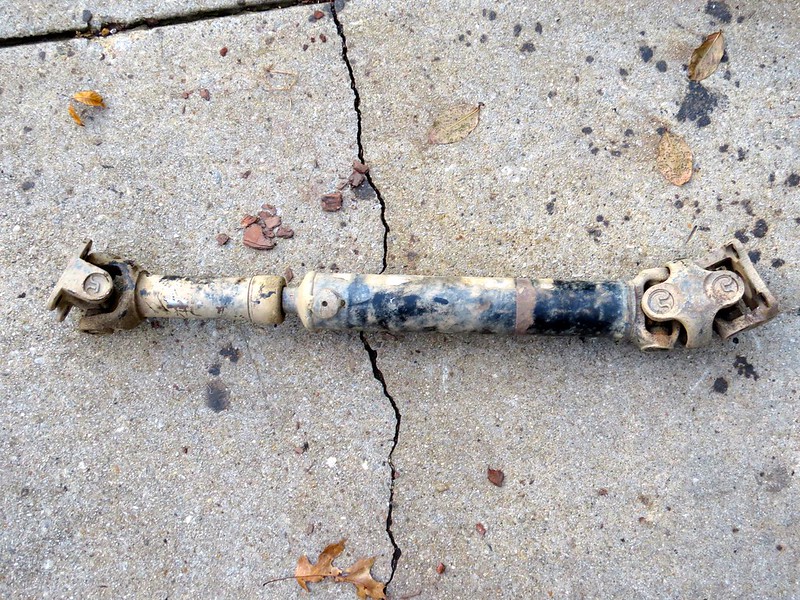

After a few days there, Brian figured out that my double cardan front driveshaft's u-joints were toast. After concluding that a double cardan was not needed for the lift that my 80 has, I bought a standard driveshaft with new u-joints and got to putting it on.
Sure enough, that solved everything and the 80 is happy again.
Old double cardan DS
New, happy driveshaft with no vibration

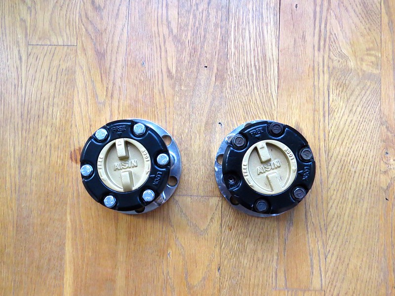

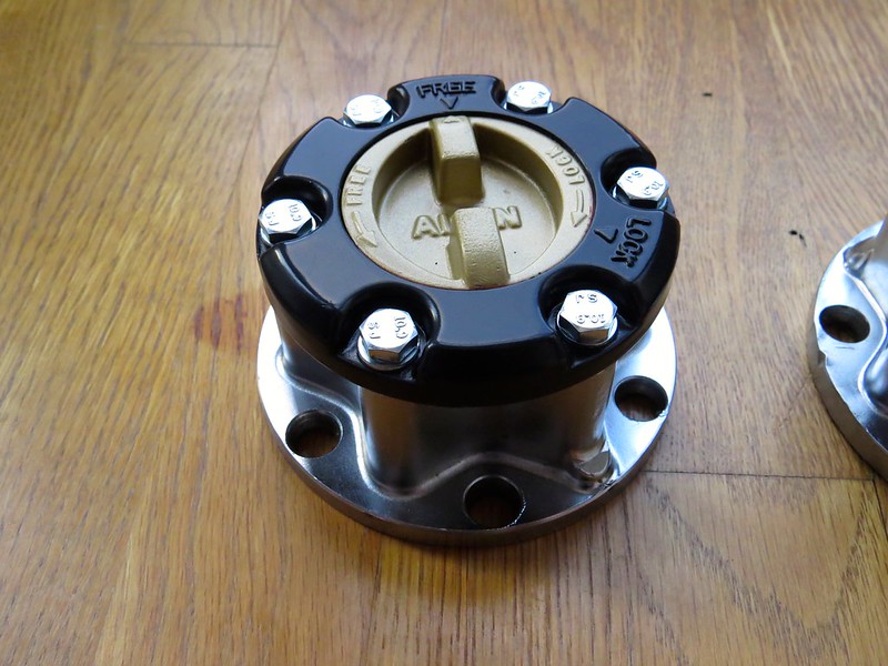

After talking with Brian about the benefits, i think i am going to part-time somewhere down the road. I snagged some Aisin hubs from my brother and got to rebuilding those today. It wasn't very hard but it was a lot of cleaning, greasing, and waiting for paint to dry.
I'm still not 100% done yet, one of the hubs is for a mini truck and the other is for a 62 so i am going to find a new Land cruiser gold dial to replace it with. Also, Home Depot was out of M6-1.0 16mm bolts so i had to reuse the old ones which like to break inside the hub housing. I'll be replacing those soon too.

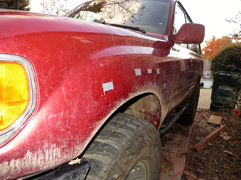

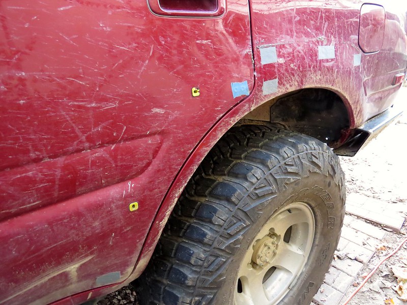

Here are some pictures of the fender flare holes that i welded up and primered. Still have a few holes left on both rear doors that need to be welded up. I keep putting Monstaliner on the back burner, but i need to get on that.

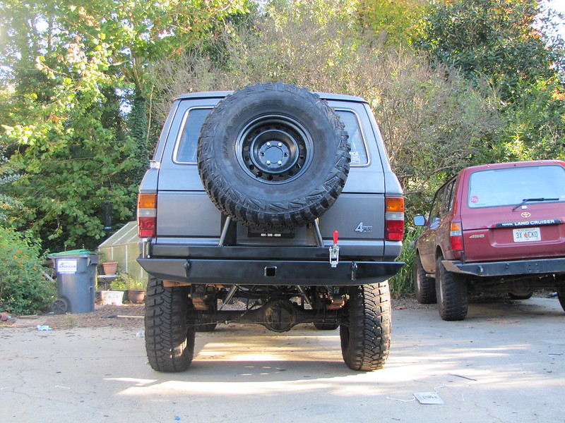

I'm also gonna order a 4x4 labs rear bumper next weekend and hopefully will be done welding that in the next few weeks. Ive decided to do a single swing out with a centered tire carrier kind of like my brothers since that looks fantastic and i think it would look great on the back of an 80 as well.
But there is some good stuff to look forward to in the next coming weeks...
Got a couple boxes from Luke at 4x4Labs today. looking forward to getting this bumper welded up in the next couple days. Don't know how much i'll get done tomorrow because i gotta study for an exam on friday, but i'll see if i can get it done over the weekend.
Nice! I just finished the 4x4 Labs kit...good stuff.
Curious as to what bumper you were running before and why you changed. Maybe I missed that somewhere?
I had an Iron Pig rear before. Absolutely nothing wrong with it. It's one of the only 80 series bumpers that is made fully out of 1/4". It has taken a beating on rocks and doesn't show it at all. I really like the design of the labs bumper and the increased departure angle really was the deciding factor. I figured I was either gonna modify the IPOR to get a better departure angle, or I was gonna buy the 4x4labs.
