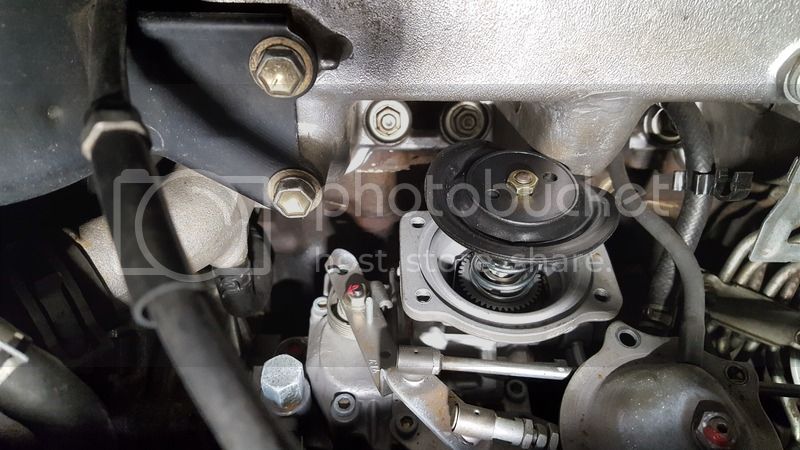

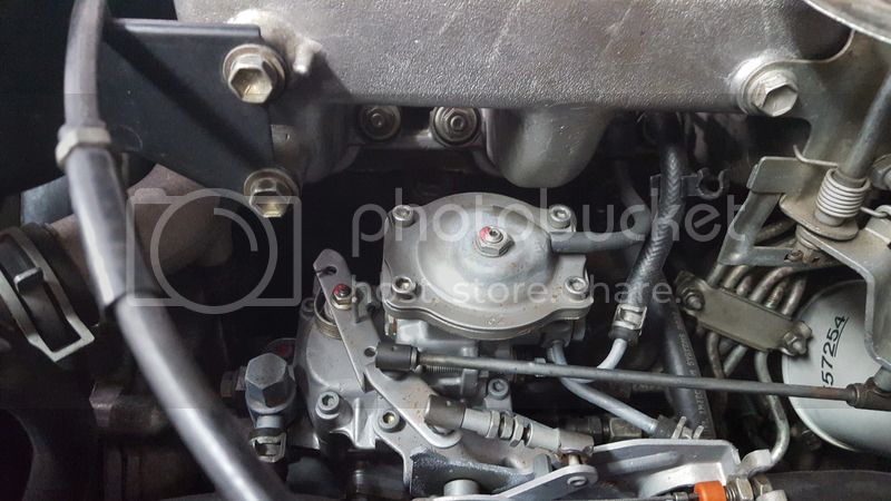

I finally adjusted the boost compensator and modified the aneroid rod. The performance difference is amazing!!
Boost Compensator:
Lid Removed. Pulling out diaphragm and aneroid rod.
Close up of aneroid rod, after pulling it out. (in the first picture, you can see that the side pin had been bottoming out... causing fuel cutoff)
Aneroid rod in the mill for cutting: (all this is just to slope the end of the rod, so it can be replaced without pulling the side pin within the compensator)
Here's the rod, after cutting:
After modding, I adjusted the compensator spring preload (took about 4 tries to get it right). I also rotated the aneroid from the minimum fueling position to the maximum fueling position. (the steeper slope side) After I got everything dialed in, I'm running 23psi boost with AFRs that max out around 1000 degrees. (I hit 1050 on a long hill accelerating) Performance is MUCH better than it has been. I think I'll leave these settings for a while and see how it does. After a bit, I might get on a dyno and use a wideband to tune it more. But for now, I'm happy!
How do you think any tuning affects long-term reliability?
From what I've read, I believe the tuning will actually help reliability just because the EGTs are now controlled much better.
My thought is that, on a stock setup, the turbo was the weakest link because '90s turbo technology wasn't there yet. Now, with the Gturbo, I can consistently run much higher boost pressure without worrying about bearings or heat in the turbo. That lets me push more air to keep the EGTs down. On the fuel side, I turned the aneroid rod, but didn't grind it. So, I went from the least fuel side to the most fuel side. This is getting me much more power, along with the fact that my boost compensator now has the spring preload set to apply the right amount of fuel as my throttle increases. (initially, it would be way rich down low and too lean up high in RPMs... made for terrible performance) So, now I'm using way less throttle to get the rig going and keep speed. I think my mileage might actually improve because of getting this tuned out as well. Overall, it feels like driving a modern SUV rather than a semi truck now!
After I drive it for a while, I want to hook up a wide band and put it on a dyno. That will tell me exactly what my AFRs are as a go from 0 to full throttle and will give me my associated power output. If I can fine tune that, I think I can increase mileage even more, while maintaining consistent performance and controlled EGTs!

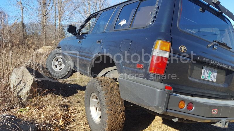

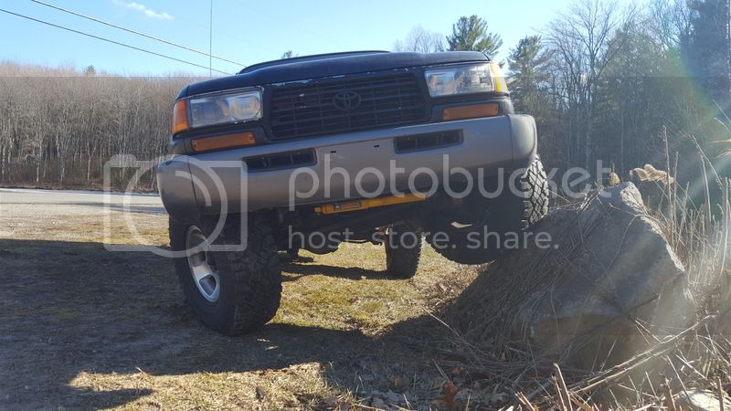

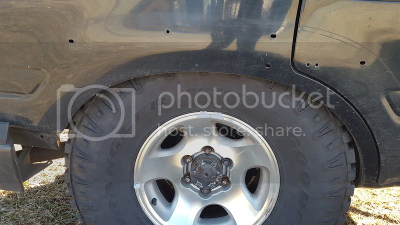

I found a bigger rock down the street and tried a little more flexing. This is about as far as this suspension will go with the sway bar on. From what I've read, L shocks will let these springs articulate more, but I'd need to extend the bump stops a little bit. I think my next test will be to pull the front sway bar end links and see what happens.
I should have measured the height:
Rear extension:
Front compression: (Sway bar still on)
Rear compression:
Another thing I heard is that the FJ80 front sway bar is identical but thinner than my FZJ80 sway bar. That might allow for more flex, without removing it. Either way, I think I need more caster... the cruiser wants to dart around a bit at freeway speeds. And, I need to travel 80-90mph to keep in traffic on my morning commute!

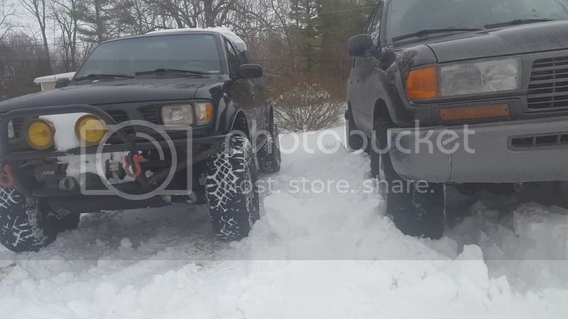

Had to use 4 low to get out of the driveway the last couple of days! Grabbed some pictures of the Tacoma and Landcruiser next to each other while I was out. The Landcruiser needs some aesthetic help... the Taco looks much cooler when they stand next to each other. But, the LC was actually better at getting out of the driveway.
33s and 35s...

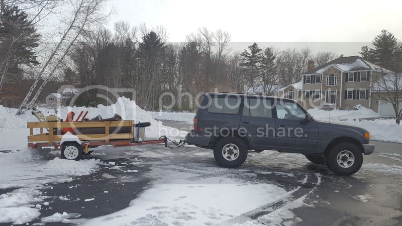

In the process of clearing snow, I broke my snowblower. So, I borrowed my buddy's trailer and snowblower. I didn't even notice the trailer back there, when I was towing it. Good torque out of this diesel...

I adjusted the boost compensator again last night. I think I'm finally adjusted to the point where I'm not hitting fuel cutoff at full throttle. Unfortunately, that increased my fueling across the board. So, I'm running hot again. I turned the aneroid pin from max fuel to 90 degrees out from max fueling. It helped a bit but I'm still running hot. (in cold winter weather) Today, I think I'll rotate the pin to the minimum fueling position and see how it runs. If that doesn't work, I'll adjust the main fueling screw to pull fuel across the board. Adjusting that means I'd have have to readjust my idle. If I can get this rig to run at the right EGTs and fuel roughly correctly across the board, I will strap it to a dyno with a wideband and tune to AFRs.
