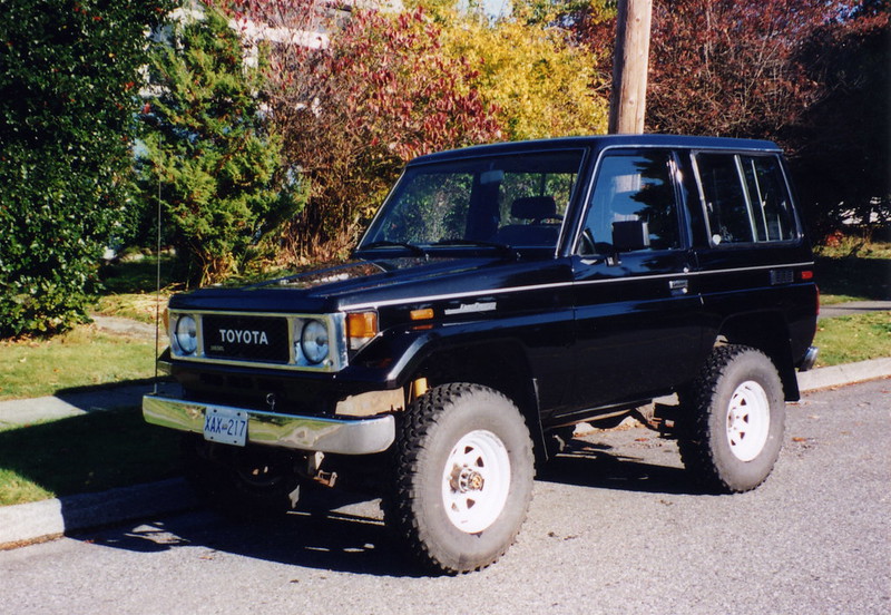

I realized I’m coming up on the 10th anniversary of buying my 1989 BJ74, and figured it was time for a first decade report card and after-the-fact build thread.

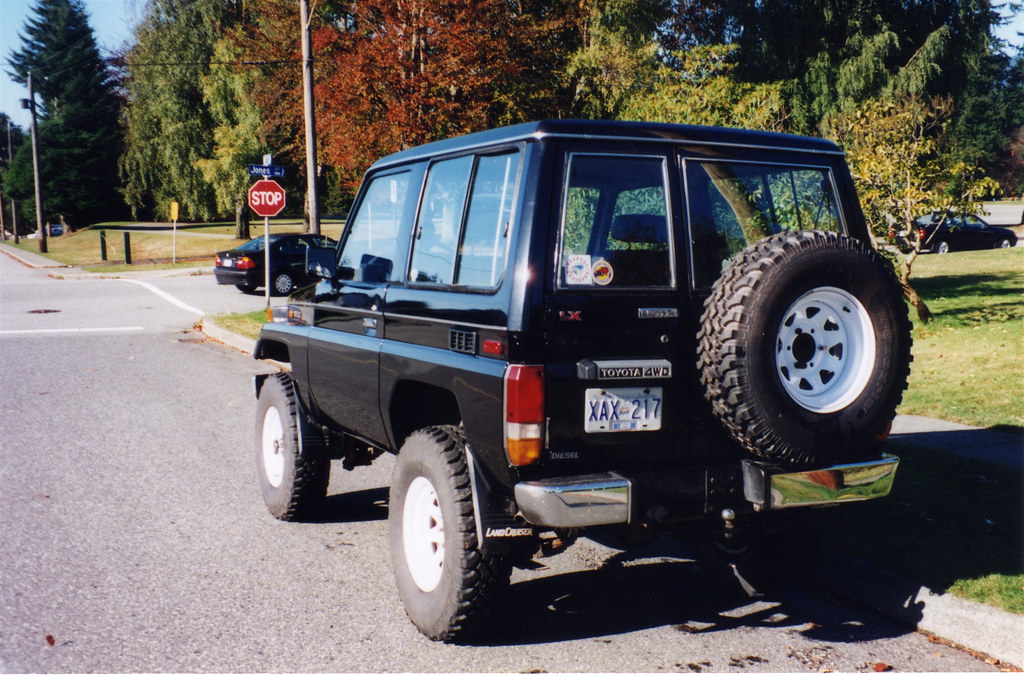

In 2007 I’d been driving my ’85 BJ70 for 15 years. It had been the best vehicle I ever owned, but it was getting rustier and crustier all the time. The drivetrain was solid with 370,000 km on it, but the body was getting bad.
The 70 in happier times:
Scan 3 by bj70_guy, on Flickr
Man it was so pretty!
Scan 4 by bj70_guy, on Flickr
Norm_s_BJ70 by bj70_guy, on Flickr
I ordered a BJ74 from Outback Importers. At that time they were getting the best trucks, and they baselined the living crap out of them before delivery. They were expensive, and worth it.
The wish list was no rust, a 5 speed, FF with cable lockers, A/C, and sub 100,000 km. But even by 2007 locked and loaded up 74s in great shape were getting hard to find in Japan. I settled for an ’89 with no lockers, semi floater, but everything else I wanted. I didn’t care that much as I had a FF and an ARB already laying around waiting to go on the BJ70.

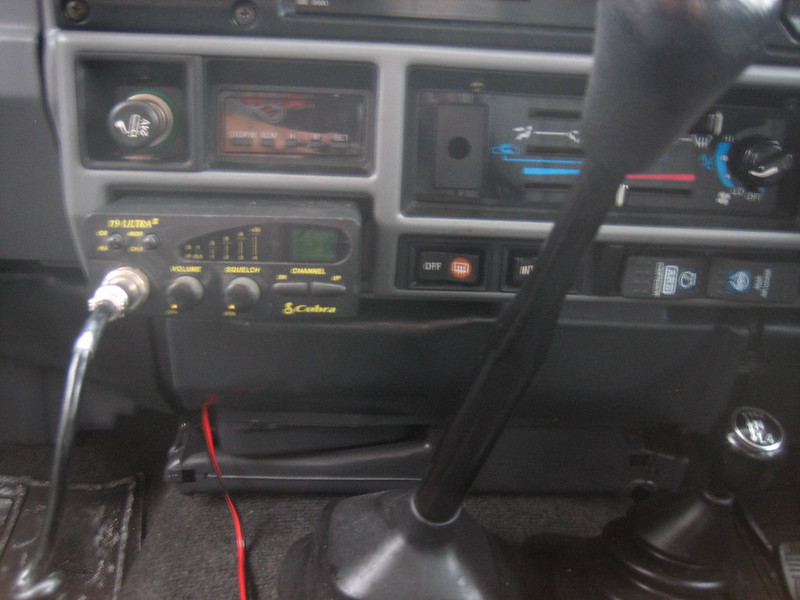

Installed a cheap refurb Cobra cb in the ashtray spot - it turned out to be a POS and was replaced with a Uniden 520xl not long after
IMG_2418 by bj70_guy, on Flickr
and a Craigslist find Yaesu FT7800 bolted to the console:
IMG_2420 by bj70_guy, on Flickr

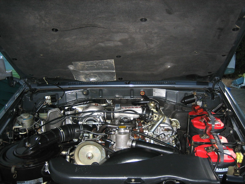

Dedicated 12V gel battery installed in the storage unit:
IMG_0007 by bj70_guy, on Flickr
Charged by a Solar Converter
IMG_2224 by bj70_guy, on Flickr
Which eventually proved to not be up to the task. It got replaced by a proper 24-12V battery charger.. that was.
That's a Euro Manufacturing E940 30A 24V-12V DC-DC battery charger, it has been great.
IMG_0001 5 by bj70_guy, on Flickr
RigRunner for constant 12V (that eventually got swapped out for a Blue Sea fuse block), and a Blue Sea fuse block under the dash for keyed 12V
IMG_0003 2 by bj70_guy, on Flickr

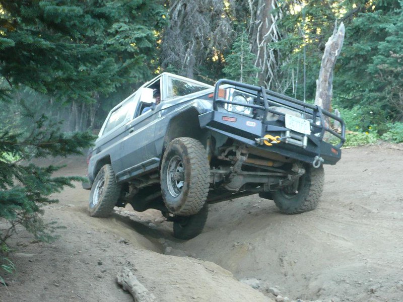

It’s now late 2009, and a small group of us are going to do the Whipsaw trail. I decided to take the 74 instead of the 70. Swapped over the ARB front bumper and went.
This was the exact moment I knew I didn’t need the 70 any more. The 74 was a wheeler :D

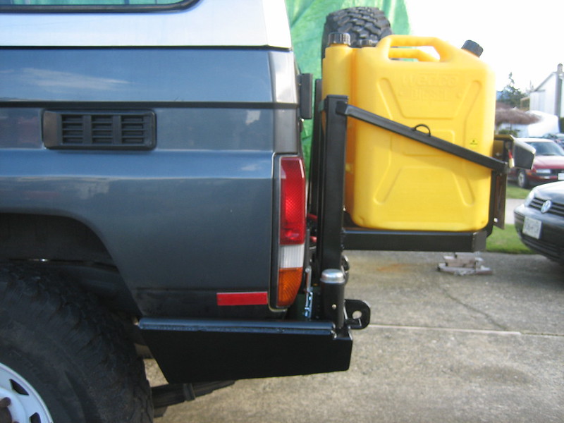

Jason came with us on that Whipsaw trip, and I’m pretty sure I started harassing him to build me a rear bumper on day 1. He eventually relented… to shut me up, no doubt.
Norm's rear bumper 2 by bj70_guy, on Flickr
The man at work
IMG_0001 2 by bj70_guy, on Flickr
Came out awesome! The first Cruisin’ Off Road 74 rear bumper:
IMG_0008 by bj70_guy, on Flickr
IMG_0010 by bj70_guy, on Flickr
IMG_0011 by bj70_guy, on Flickr
At a wedding one time my buddy decided to strength test it. He really wanted me to give him a ride back to his hotel riding in the fuel can carrier. It’s possible he was hammered out of his mind :hillbilly:
No I didn't - his wife put the kibosh on the plan :( :D
IMG_0205 by bj70_guy, on Flickr
It paid for itself the first trip I took it on: Cruise Moab 2010

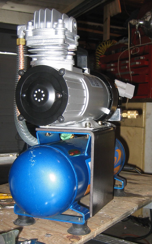

I came home from Cruise Moab wanting more tire, more gearing, and a Puma air compressor. And to go back to Utah ASAP!
Got a Puma off eBay, mounted it by having a guy with a brake bend a piece of 1/4” steel 90 degrees, then sandwiching it between the compressor and tank.
IMG_0003 4 by bj70_guy, on Flickr
Changed the stock wiring to 6 AWG, added Anderson power pole connectors, then bolted it all to the drawer.
IMG_0003 5 by bj70_guy, on Flickr
IMG_0072 (1) by bj70_guy, on Flickr
Thus began a LONG drawn out lesson in appropriate wire and fuse sizing :D
Coles notes - the Puma draws a lot of amps. Size your **** appropriately!

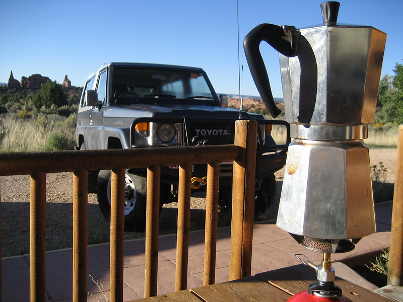

We hit Grand Canyon, Grand Teton, Bryce, Zion, Arches, Canyonlands, Kodachrome Basin, and Crater Lake on that trip. Truck did great... other than the gearing. We love that area and never get tired of it. Been back 4 times since and will go again.
This pic just makes me happy…

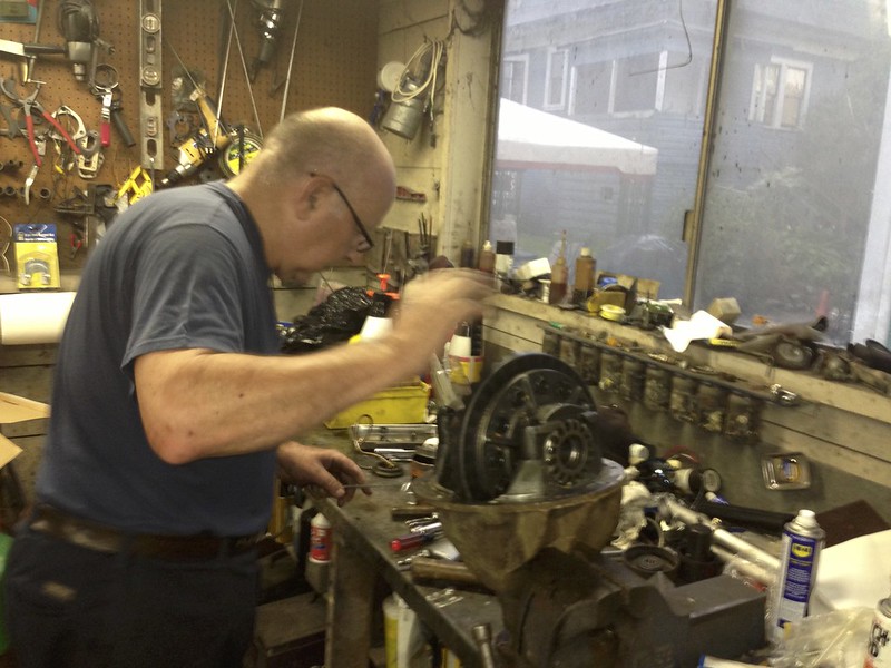

Around this time the rear end crapped out. The local rear end specialist that installed the ARB had done a half assed job.
IMG_1369 by bj70_guy, on Flickr
IMG_1375 by bj70_guy, on Flickr
Ugly. It was 3 days before we were to do our annual Whipsaw run, and I started looking to hitch a ride.
My dad (who was a talented mechanic - apparently those genes don’t always transfer to the next generation…) had had a round of cancer-related surgery and didn’t have a lot of strength at the time, said if I’d get the 3rd member on his workbench he’d fix it.
I love this pic, it looks like he’s bitch slapping it into submission.
IMG_0059 by bj70_guy, on Flickr
Appeared the rear end “specialist” that did the original install never removed the pinion to install the ARB, they put in new axle bearings but reused the pinion bearings, which gave out. Original pinion seal was still on there. And they charged me $500 for the install. Asshats.
IMG_1384 by bj70_guy, on Flickr
The old man had the rear end rebuilt as fast as I could get parts, and I made the Whipsaw run in my own truck. No issues. Thanks Dad.
