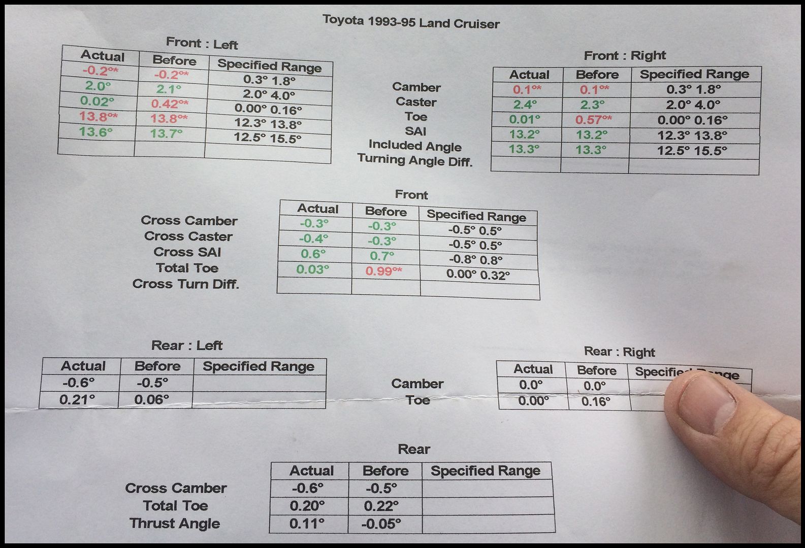

Hey Box Rocket,
Do you know what your caster numbers are, running 3" of lift with the Slee plates? (I wonder if I could use them with a 2" lift)
Sorry it took me so long to post this. Here's my alignment numbers from a few weeks back using Slee caster plates with the 3.5" Slinky lift.
So, at 2" of lift, would those plates put me at roughly 4 degrees caster? (1.5 inches lower x1.2 degrees per inch is 1.8... + 2.2 degrees that you have puts the number at 3.9 degrees) That would be on the end of the acceptable limit but still ok...
What would you think about running them on 2" of lift?
Like you said, kinda at the limit for that size lift but should work. On the upside, your could "ghost ride" the truck forever!

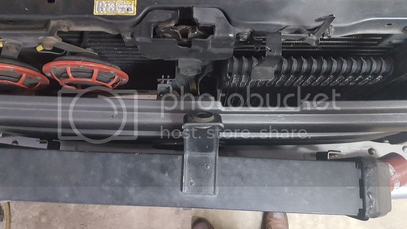

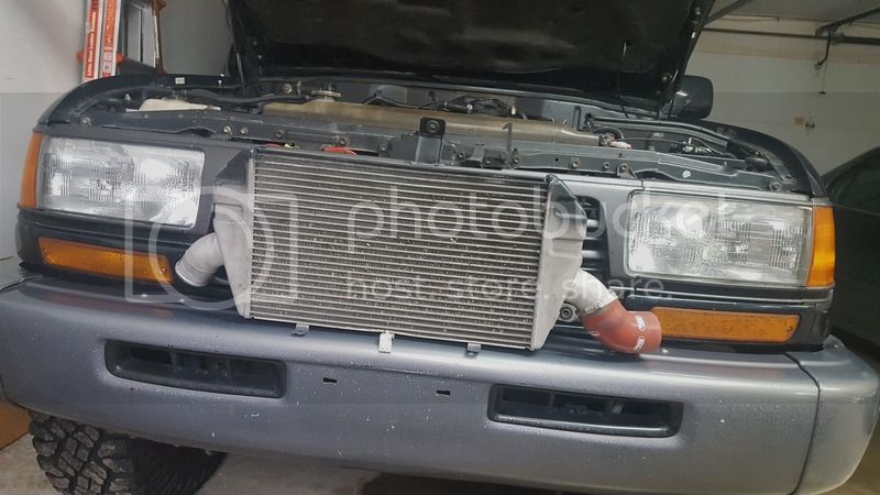

Good to know! The Slee option is sounding better and better! Hey... did you see my intercooler picture above? Have any of you diesel guys ever put an Evo intercooler into a Landcruiser before? It is really close in dimension to the HPD V2 but I have an auto with a transmission cooler to worry about... Ooo, also, I'm starting to wonder about this stock muffler situation. I've got a little one up front and big out out back. Can I just out the front one to help lower EGTs, without making my rig to loud? (for the sake of my wife) I'll post up some pictures to show what I'm talking about.

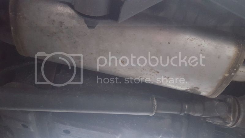

Here are some pictures of my two mufflers.
Here's the little front muffler I was considering removing: (Dark picture... sorry)
Here's the big rear magnaflow:
My hope is to lower EGTs a bit so I can bump up fuel. Any suggestions from the crowd on that?
What is your current exhaust situation, what's original, what's upgraded? Stock dump pipe, is the piping all stock sized still, or what?
