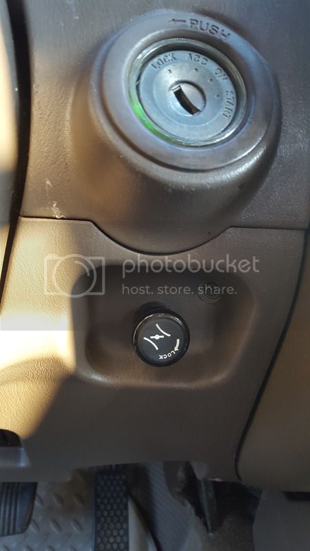

I was reading another thread on here and discovered I had a really cool feature in the Landcruiser yesterday.... hand throttle! I wanted to make something like this for the tacoma so I'm excited to play with it.

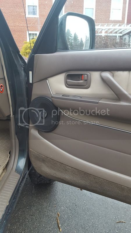

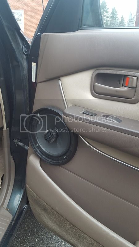

In other news, I found a replacement speaker grill for my passenger side door speaker (Focal IC165) so I installed it yesterday. Sometimes little things make a big difference in the fit and finish of a vehicle. Not having a speaker grill on there was driving me crazy!

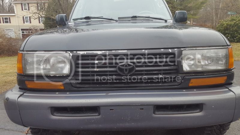

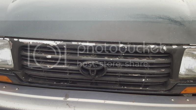

The peeling black paint on my grill finally got the best of me. I only had about an hour of light, after I got home from work. So, I did a very quick and dirty plastidip job on it. When I started spraying, I realized that there was an issue with the nozzle... it was spurting the dip out rather than giving a fine mist. At that point, I just committed and went with it. The end product was a textured surface, like a very mild bedliner. Honestly, the texture doesn't look too bad. But, the overall quality of my job is really poor. Still better than it was, though. Now I have a 5ft plastidip job rather than a 20ft paint job.
Before:
After:
That looks much better!
Yup! Courtesy of Dave Steadman...You're going to want his number. :) Sorry that it needs a little TLC like so many things, but I think a spot of superglue to lock the knob to the pull should do it!
Before:
After:
Thank you for doing both of these things, such an embarrassment but I didn't have time to remedy before I flew back overseas! Next up you should replace the single din cd player and swap in a double din so you can hook up the reverse camera, it's worth it.
