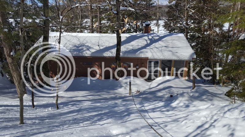

Nothing too exciting but we did get another decent size snow storm out here. So we went up to the cabin to rack the roof. Turns out there was more snow out there and the roads weren't plowed! The Landcruiser did awesome with the snow depths being between 6" and 30" on the road.
