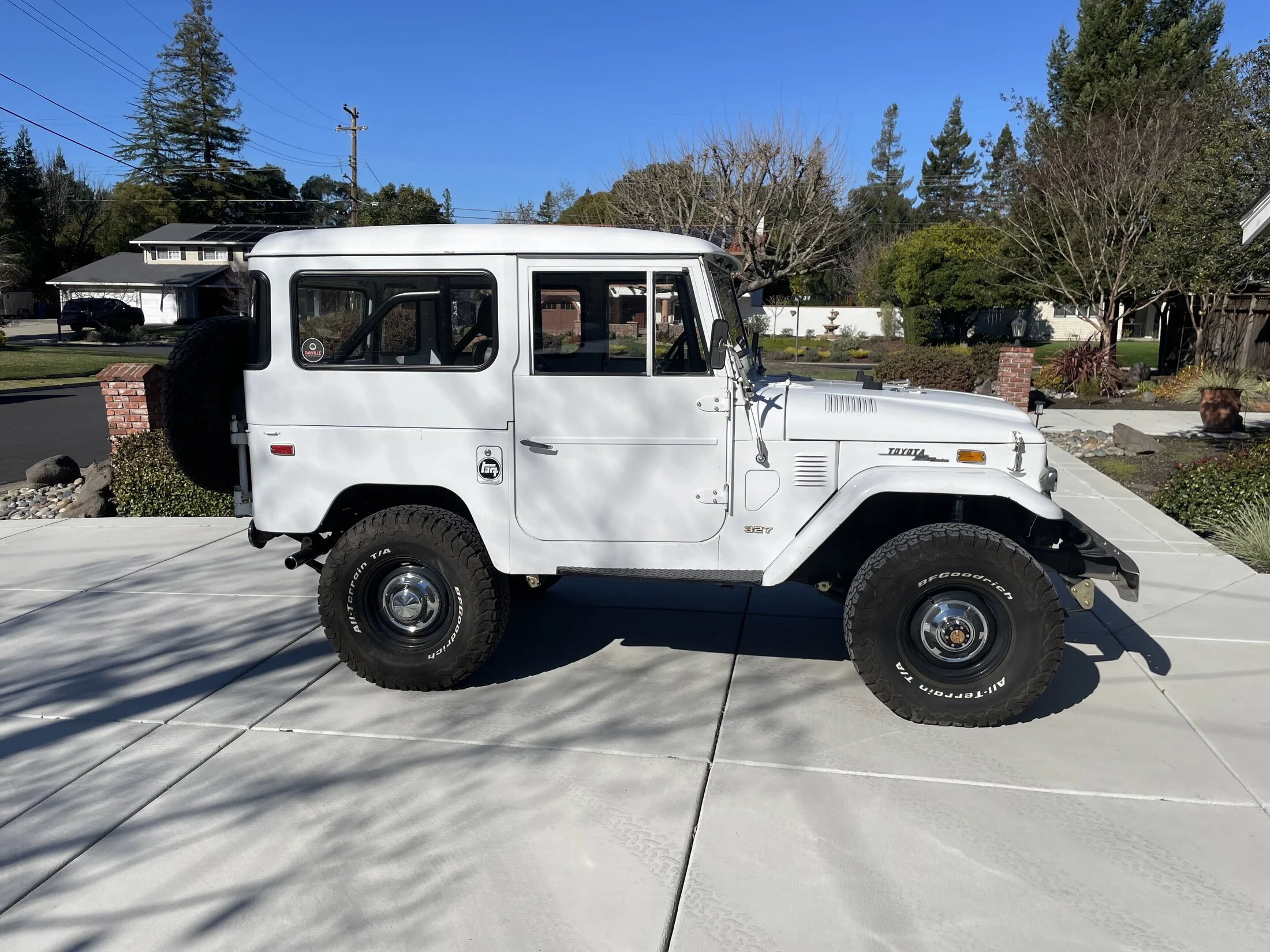

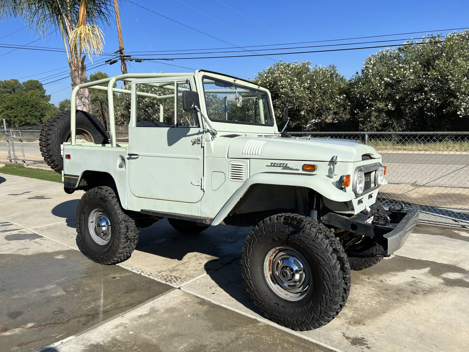

Here’s a picture of my recent suspension re do. OME springs (around 2.5”) and Bilstein shocks with factory steel wheels with 33” BFG tires

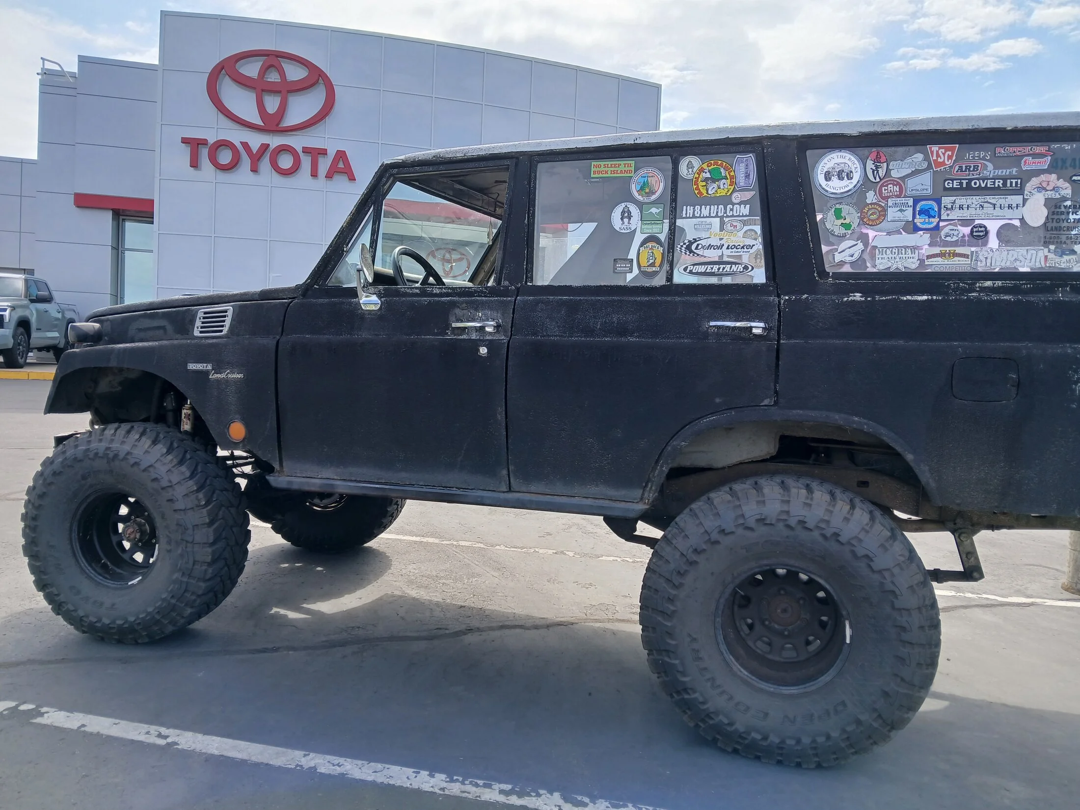

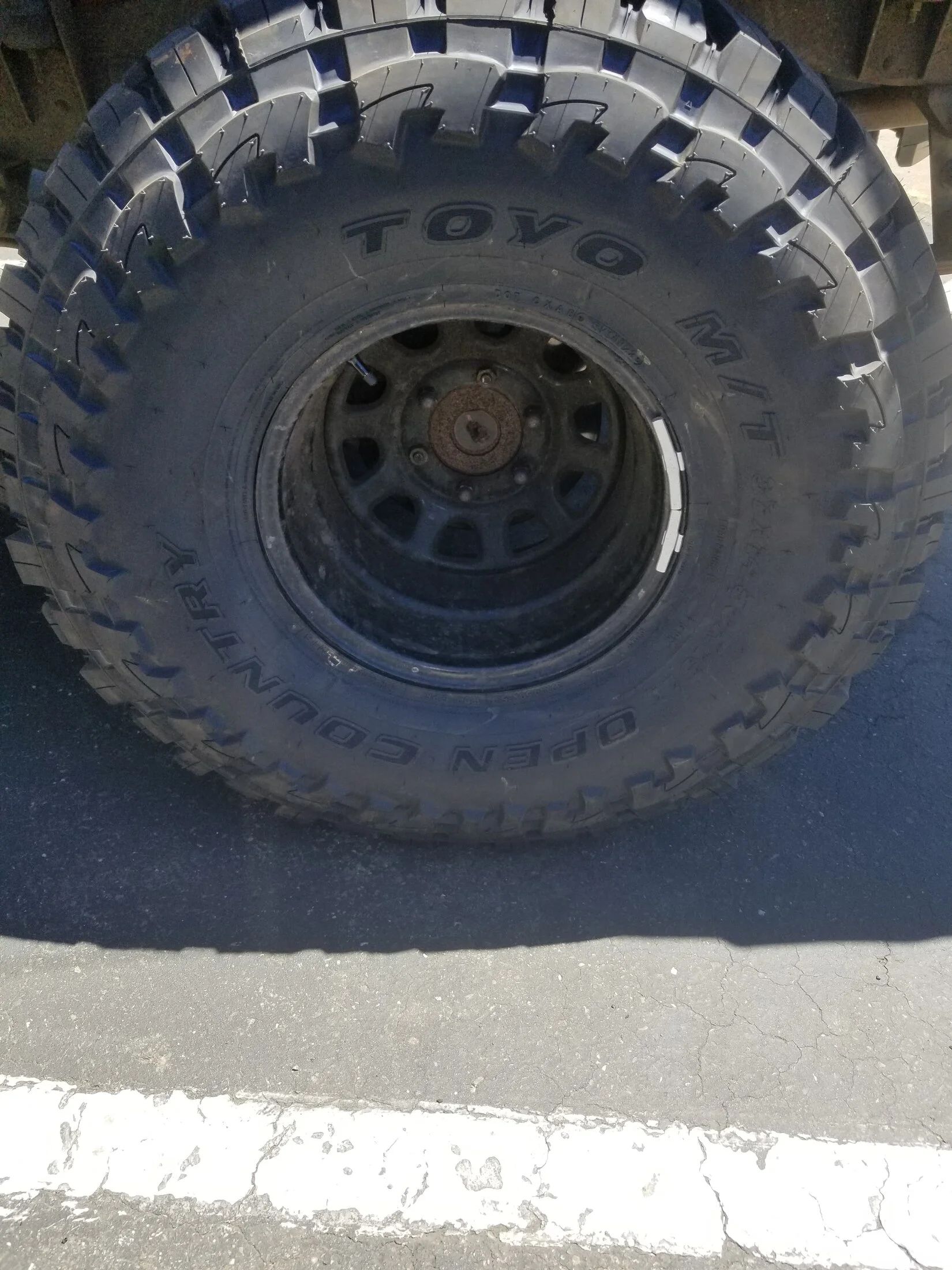

How many options is more than hardly any options and less than many options? I have seen a few God-awful rims on 40s and some meh rims on 40s (white spoke wagon wheels, 60 series rims...). In my mind there's really only two real choices you need, Stock Steelies or black RockCrushers. Bizarre setback doesn't need to be a big problem. I opted for the RockCrushers with a 2" backspace, I like the extra track width

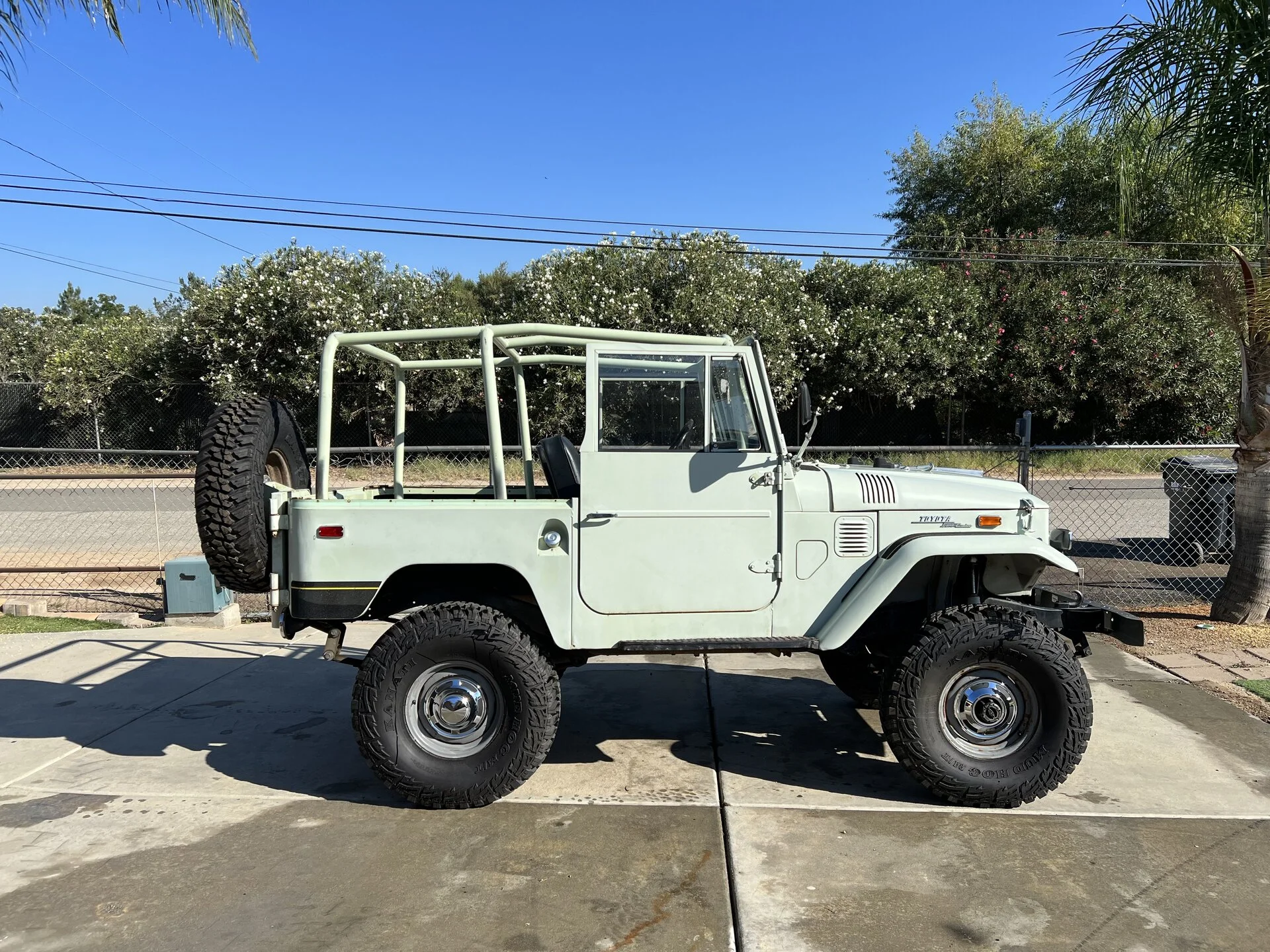

I like these. More tire/size options with 16”

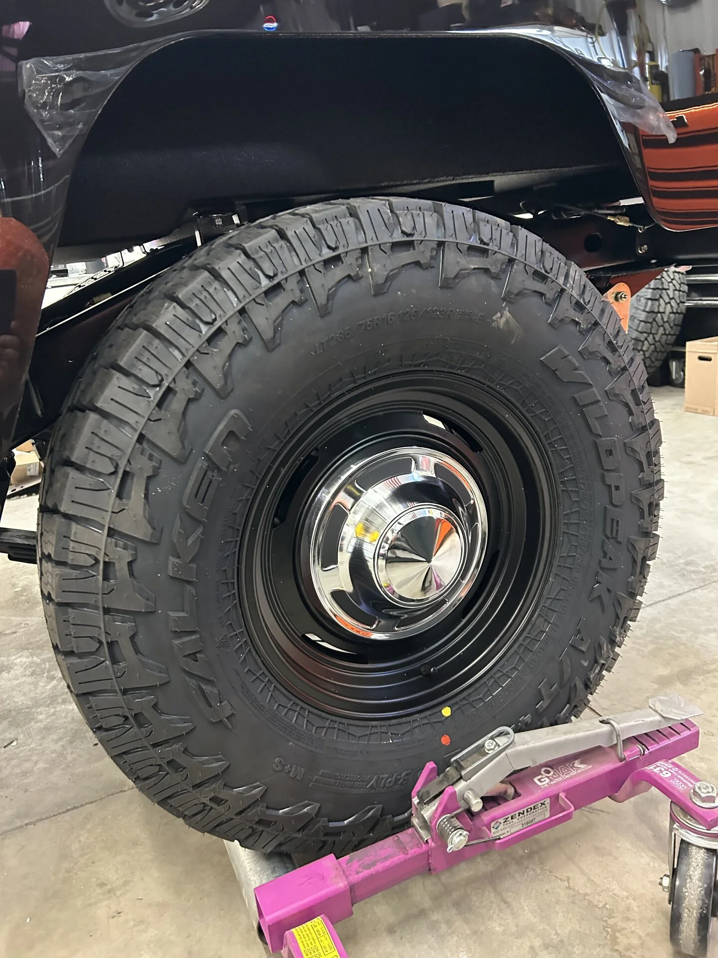

Fifteen52 Analog wheels modded to accept the retaining clips for the factory hubcap. Opens the door to a wider range of tire sizes. 16” and 17” available.

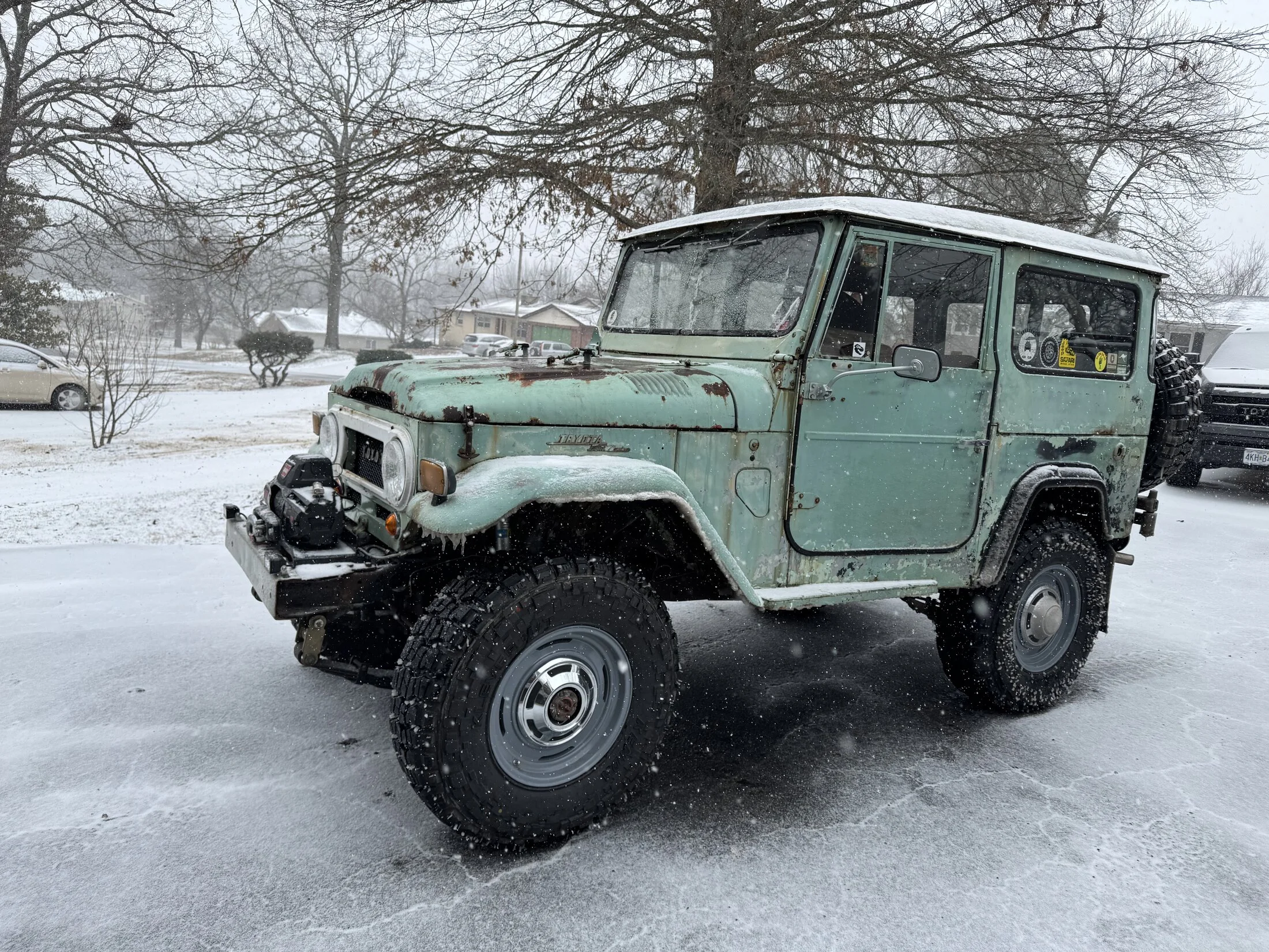

Same here. Fifteen52 analog in a 17” flavor. Machine gray paint, OEM hub caps, 35s, 4” lift.

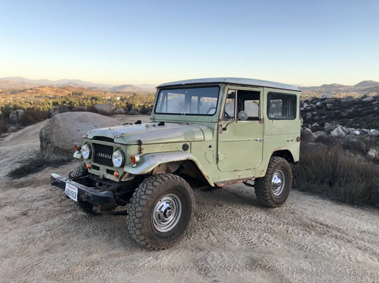

Intended use and desired overall aesthetics will drive this decision. I don't think there is a better look than a spring under lift, with tall skinny tires on factory wheels, 33x10.5's are usually the size of choice for the 2.5" lift crowd. If you want to go more aggressive, 4" spring under, or stay with stock leaves and go spring over, and run 35x10.5's. Tire choice will likely dictate your wheel size choice, and as has been stated previously, there are ways to run OEM hubcaps on 15" stockers, or 16 & 17" aftermarket alloys.
Regurgitating some of my old photos already posted elsewhere on the forum;
2.5" spring under, 33x10.5x15:
2.5" spring under 35x10.5x15:
Spring Over, 35x10.5x15:
