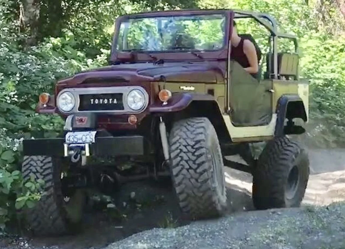

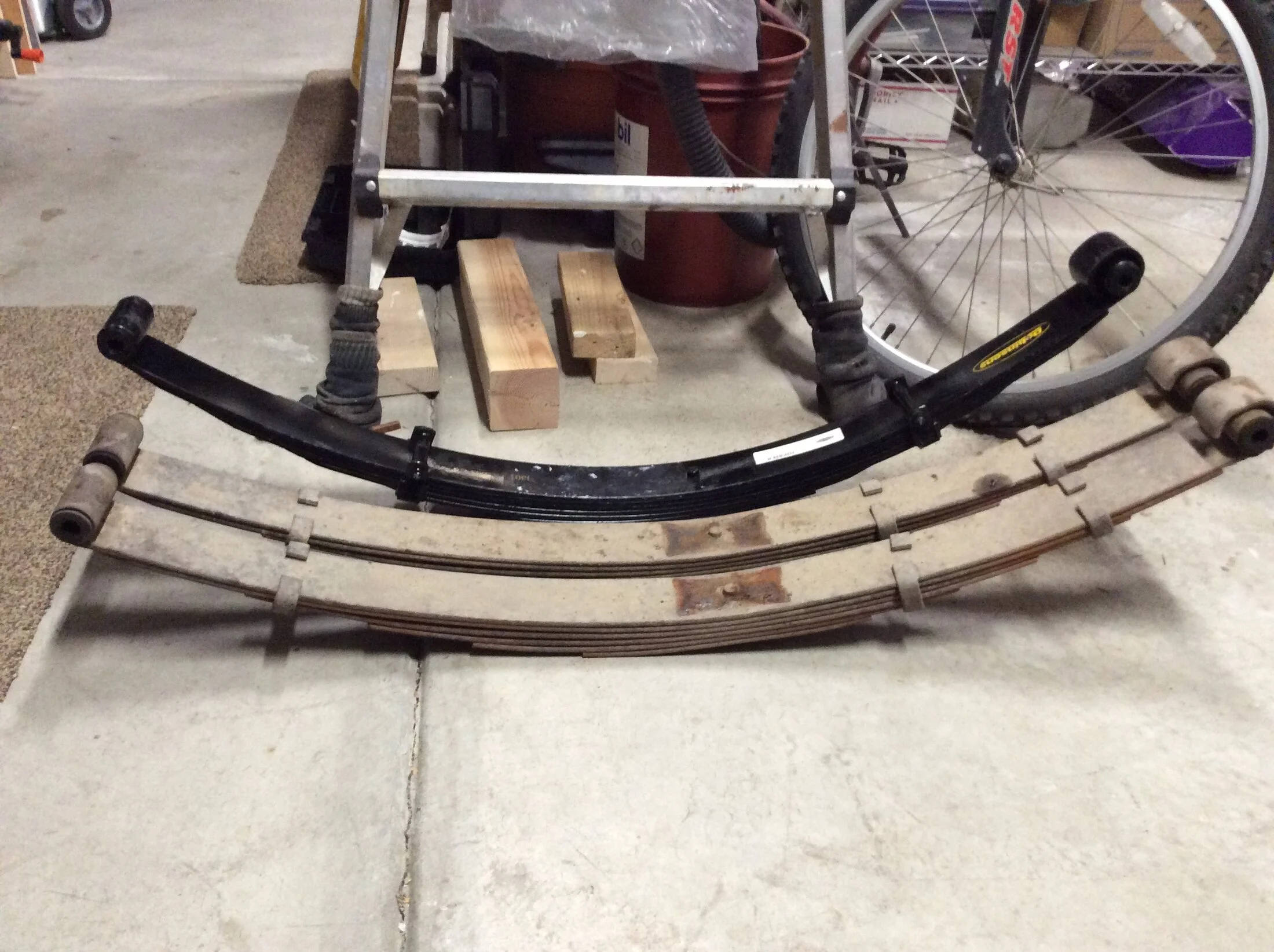

on my second 40 i got custom low arch 60 springs made by alcan so i can go spring over. this keeps a nice low stance. i want 35s on that one though. there are ways to go spring over and keep it low but it is an involved process. still waiting to drive it as the project is far from finished but the height looks good. SOA with 33 doesn’t look quite right to me though. it needs more rubber in my opinion

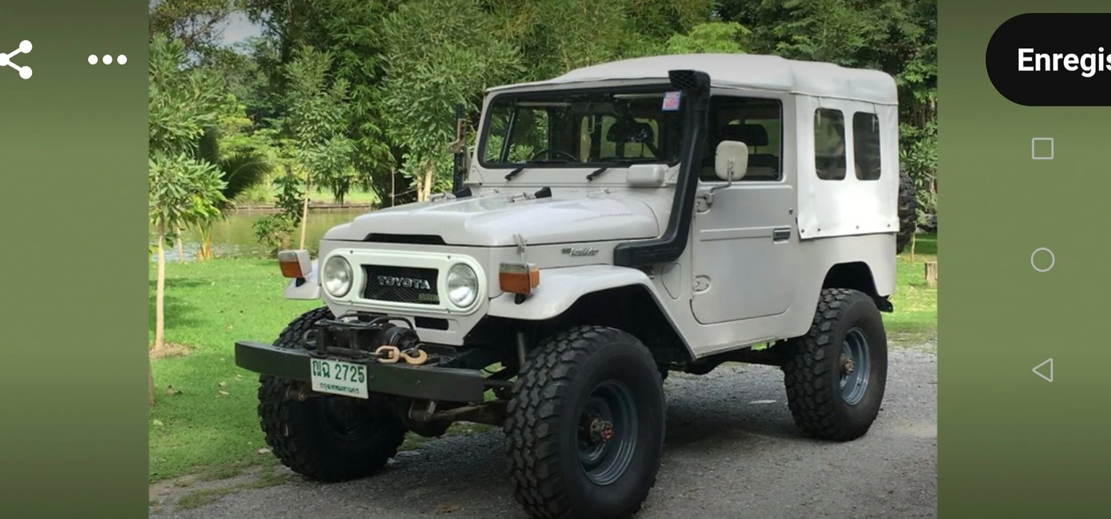

oh yes I tried to get him to go to 35’s. But this cruiser is a budget build. And tires where free. I just posted the pic showing they can be kept low when going SOA. Cheers
Yes 33 look small pic was for reference showing SOA don’t have to be huge.
4x4 Minitrucks and equivalent 4Runners were SOA, up front and rear, from the factory. The suspension makes those vehicles ride different from stock and lifted SUA _J40s, I'd say that it is better? Both for highway use and the trail? I've only known a few people who own one of those gems, all the others had coil springs and tortion bars. Rare but now highly desireable. Again, it is because the more arch on the leaf, the more friction between them, or so goes the theory.
The custom Alcan springs with an almost inverted arch would be neat to see on the trail, fully articulated. I really appreciate SOA builds. Anyone using a custom rear drive shaft, a double-Cardan-type?

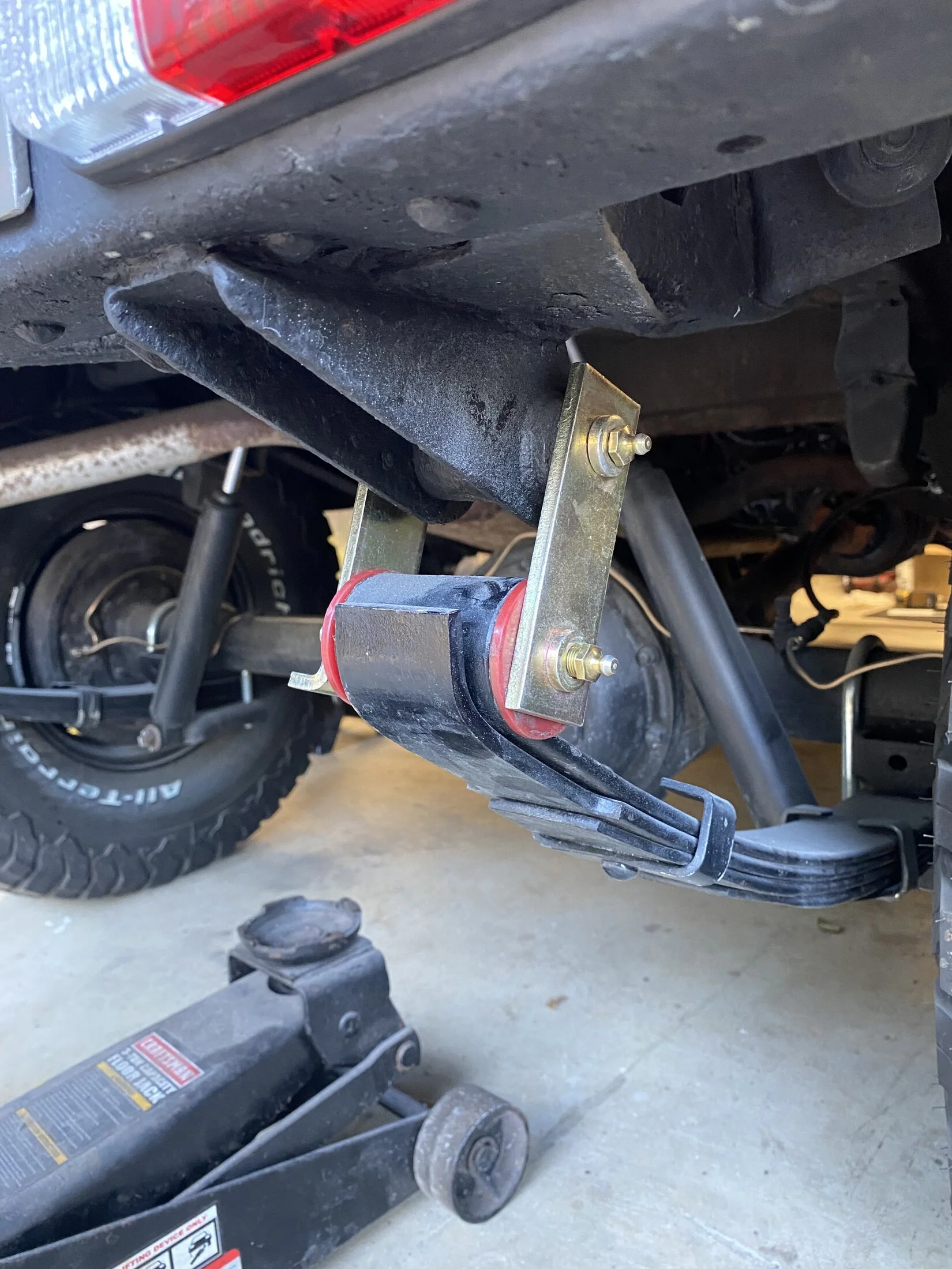

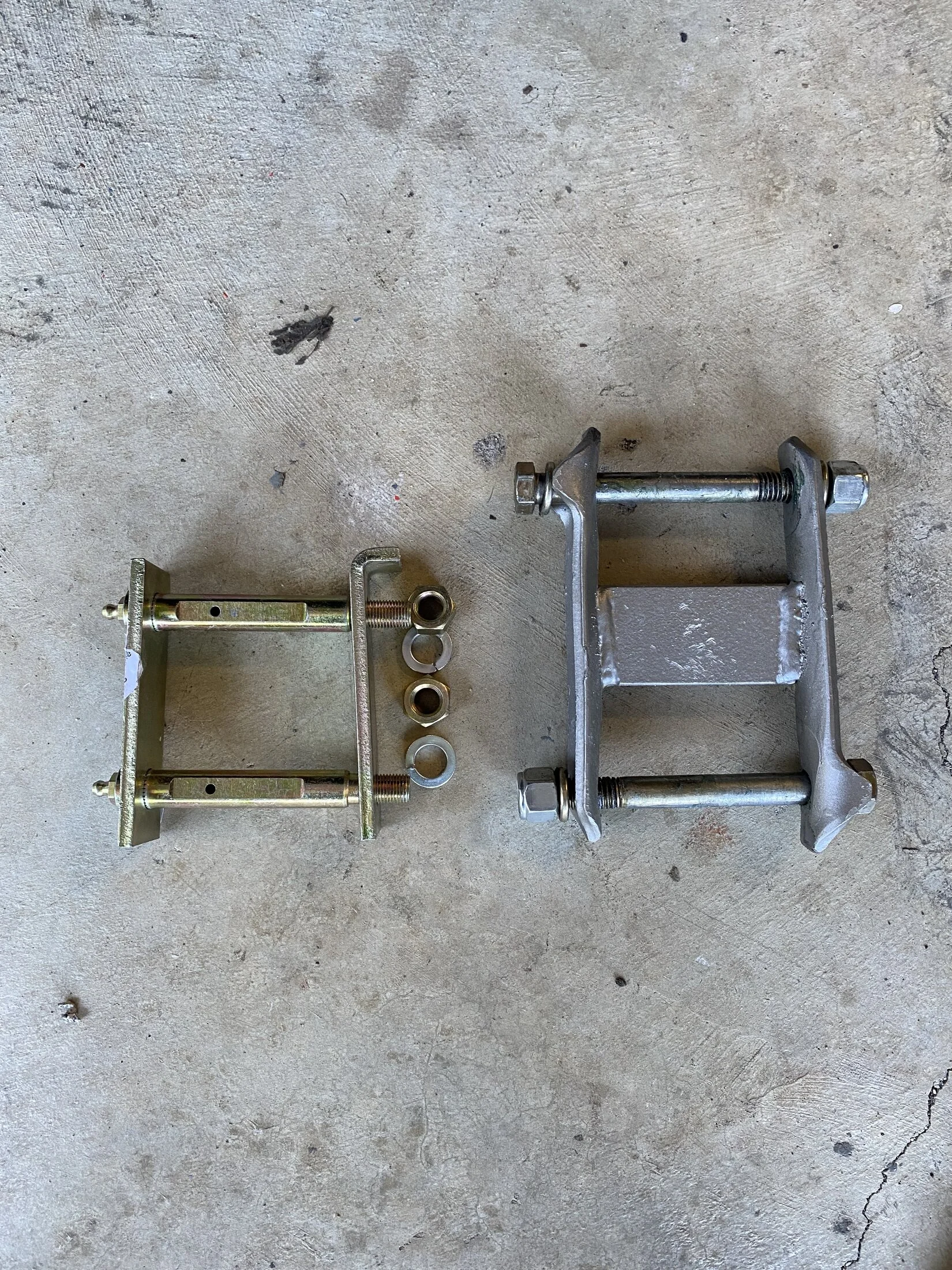

Great looking ride Jen! I like how the rear wheel fits in the wheel well. I have a tan 40 with 33’s so it’s almost like looking in the mirror😆 Minus the surf board and beautiful ocean background🙁 Can you please tell me what type of shackles and bushings you decided to use for your set up? And do you have any estimate as to the total cost for this “kit”? Thanks!
The bushings came with the procomp suspension kit. I bought the kit because I needed new U bolts and hardware. For the shackles, I bought the greaseable shackles from Cruiser outfitters.
