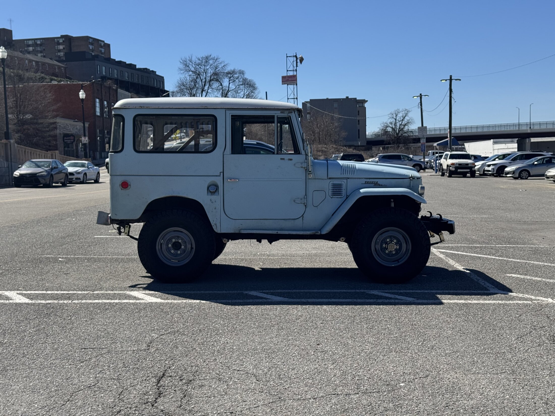

Thank you for the information nabbasi! By going with the Bilsteins, did you piece the “kit” together yourself? Or were you able to find a vendor to sell you the springs and shocks as a kit? Also, would you mind please posting a picture of your truck? Thanks!

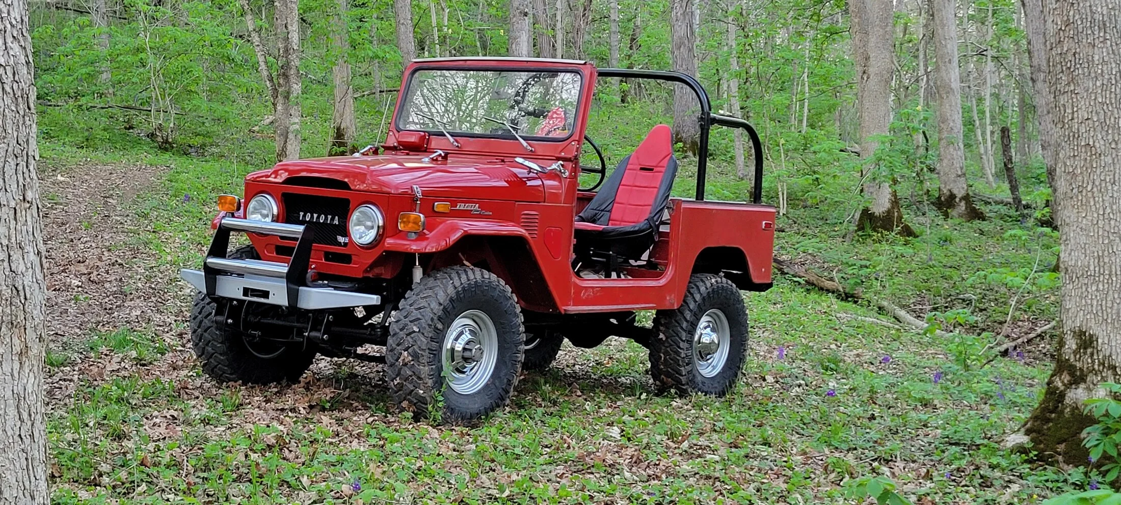

I bought the sj hydro shocks w/the 4" kit. I think they called them something else. Iir, the shocks came with the stickers separately. I think they're just an average shock. I pretty sure they are a private label for sj. I haven't run gas or bilsteins. From what Ive heard the bilstiens will likely offer a better ride. I see you're in Columbus, if it ever warms up, you're welcome to come down to east side of Cincinnati and ride or possibly drive my 40 with 4" skyjackers and 33's.
