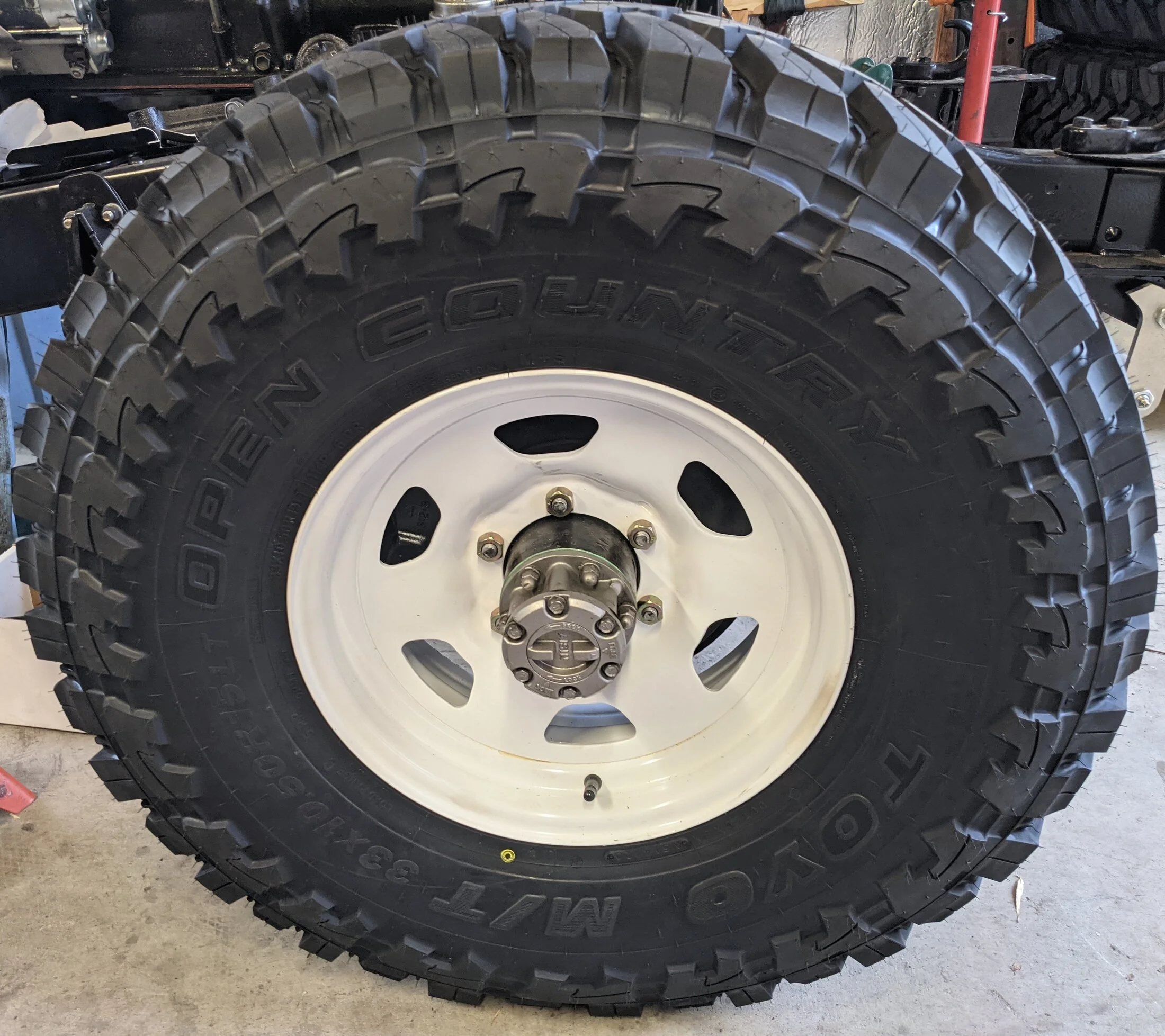

60 series OEM chrome rims blasted and powder coated white, detuned OME 2.5" lift.

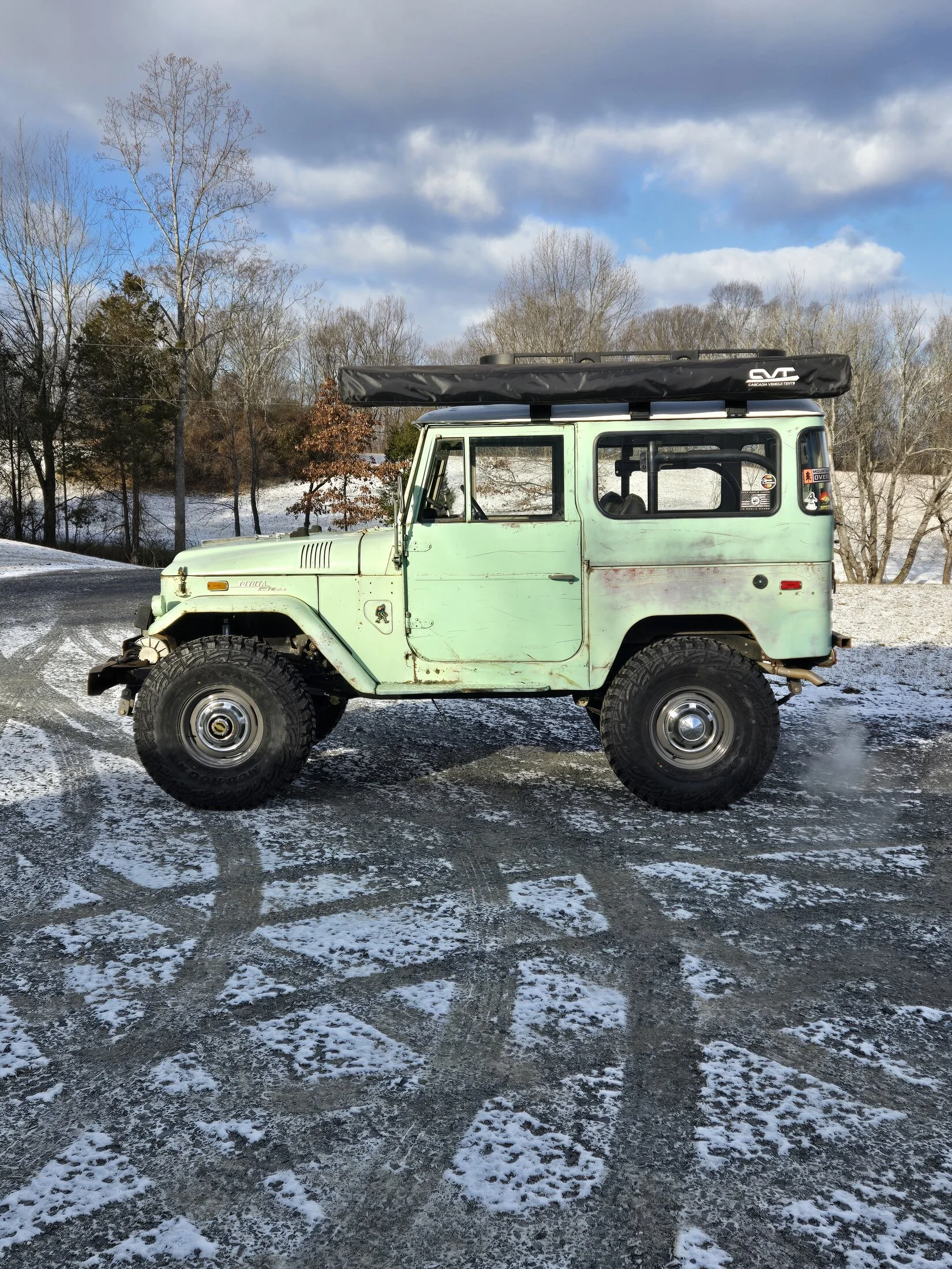

4" Skyjacker lift with Bilstein shocks. 35x10.5x15 and stock steelies.
I figured that maybe this is the right thread to add to. I'm planning on 35 x 10.50 x 15 tires on stock steel wheels from a 1970, also thinking skyjacker 4". I have a later model disc brake front end too. Question I need answered is what size spacers are needed to use these wheels and clear everything with the later front end.
Thanks for the help J
IMO, Skyjackers are a good choice. Typically folks purchase later model stk wheels. Stock drum brake wheels are assembled with rivets and the rivets heads come in contact with the calipers. Later model wheels are welded and don't have this problem. You probably wont have to run spacers or at a minimum maybe 1/4" spacers to clear the drag link on the drivers side.
My 35x10.5 on factory steelies clear everything without spacers in daily driving. On full hard right turn with some compression on the drivers side, ive had the tire rub the center pivot arm of the factory steering setup. Things are definitely tight, but unless youre off-roading, i dont think spacers are necessary.
