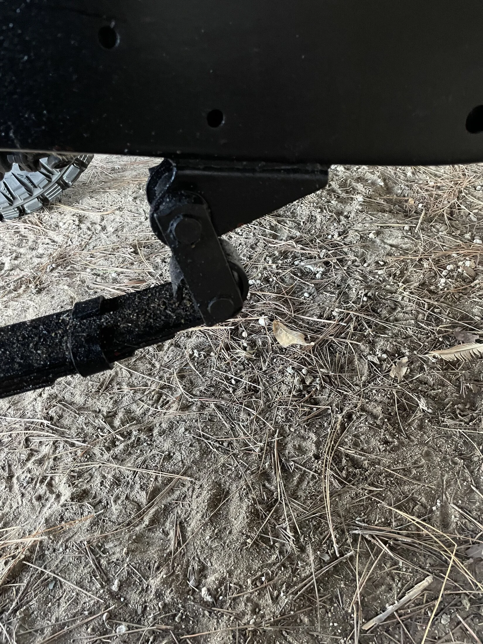

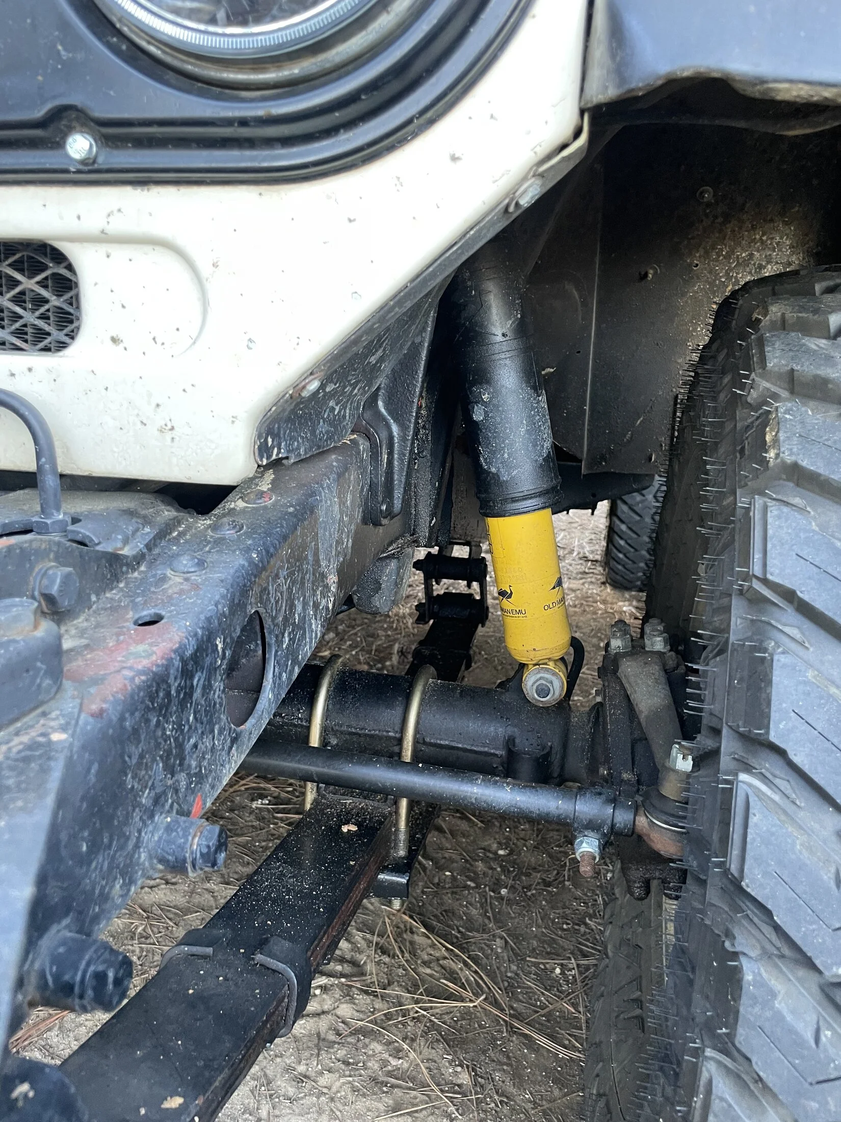

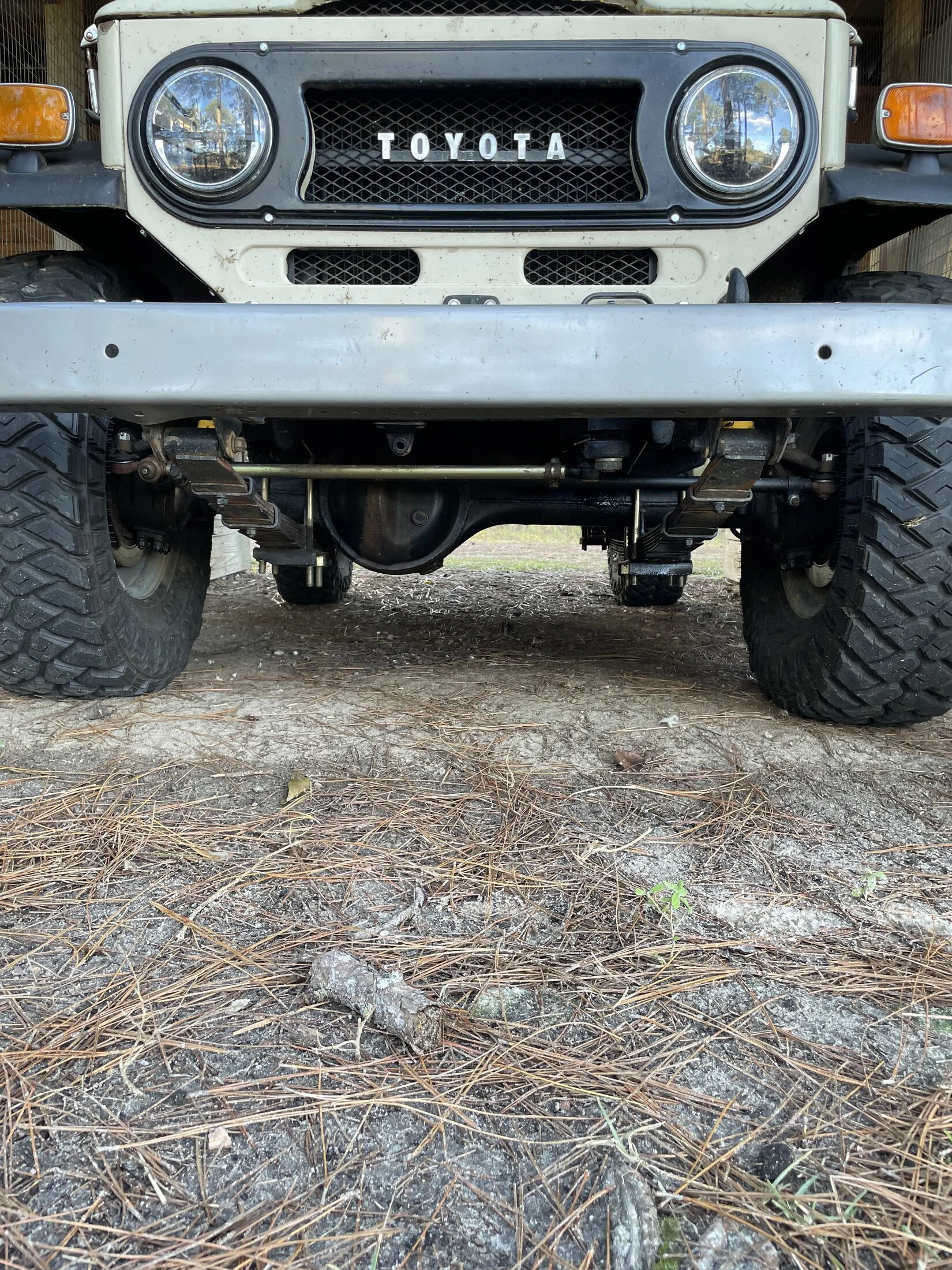

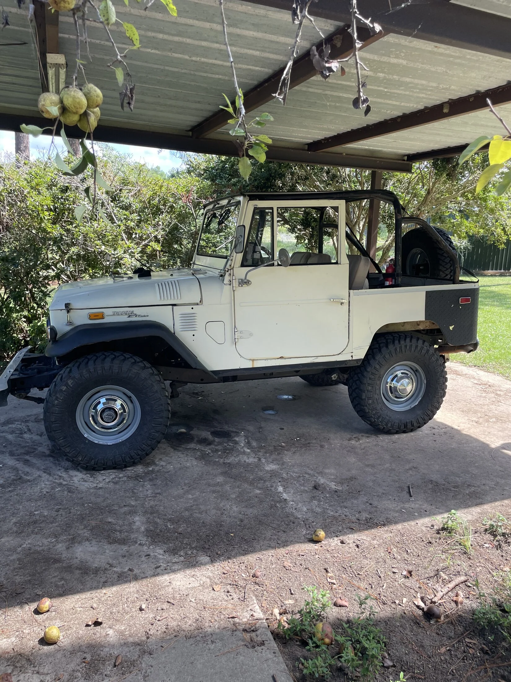

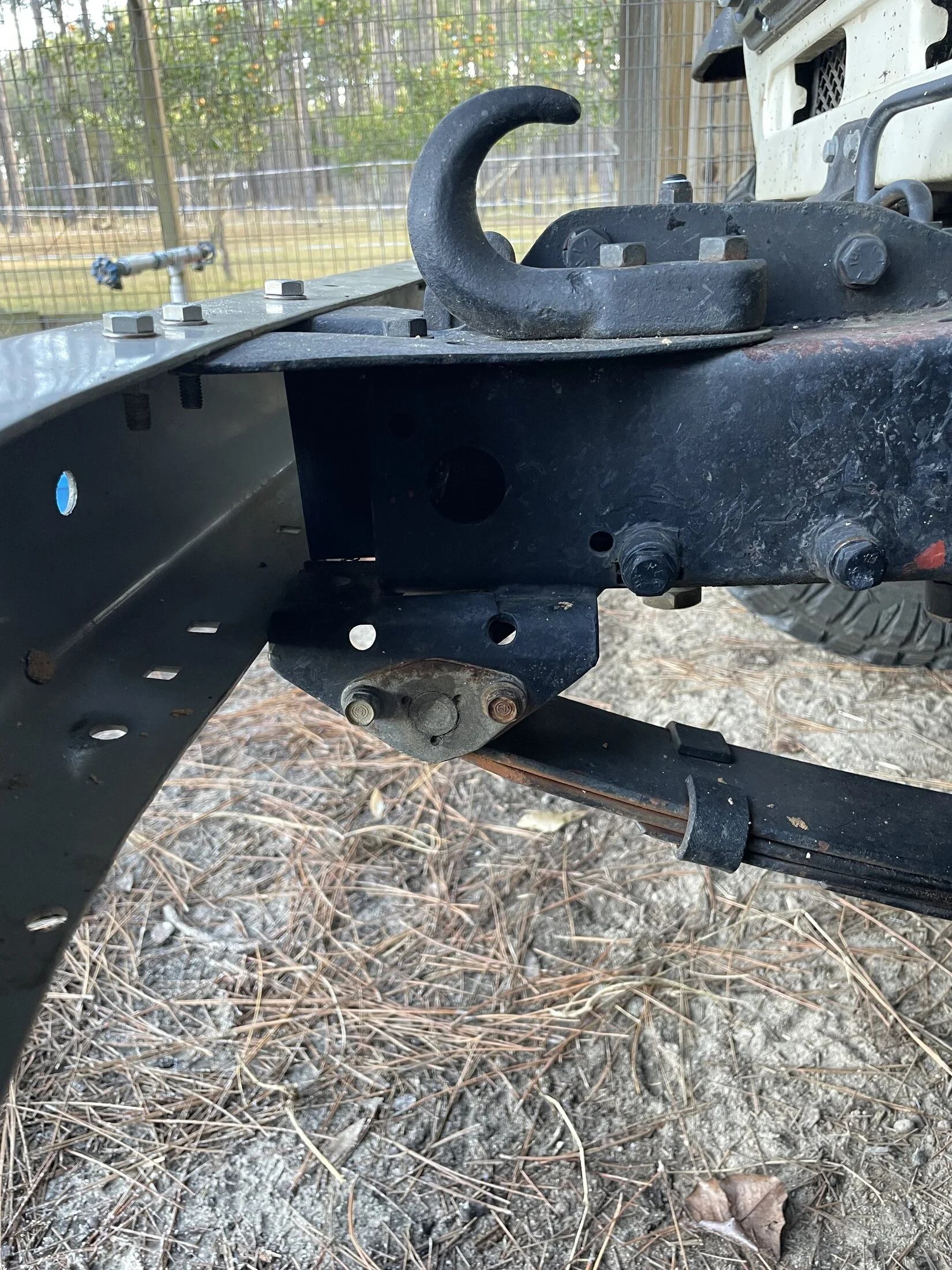

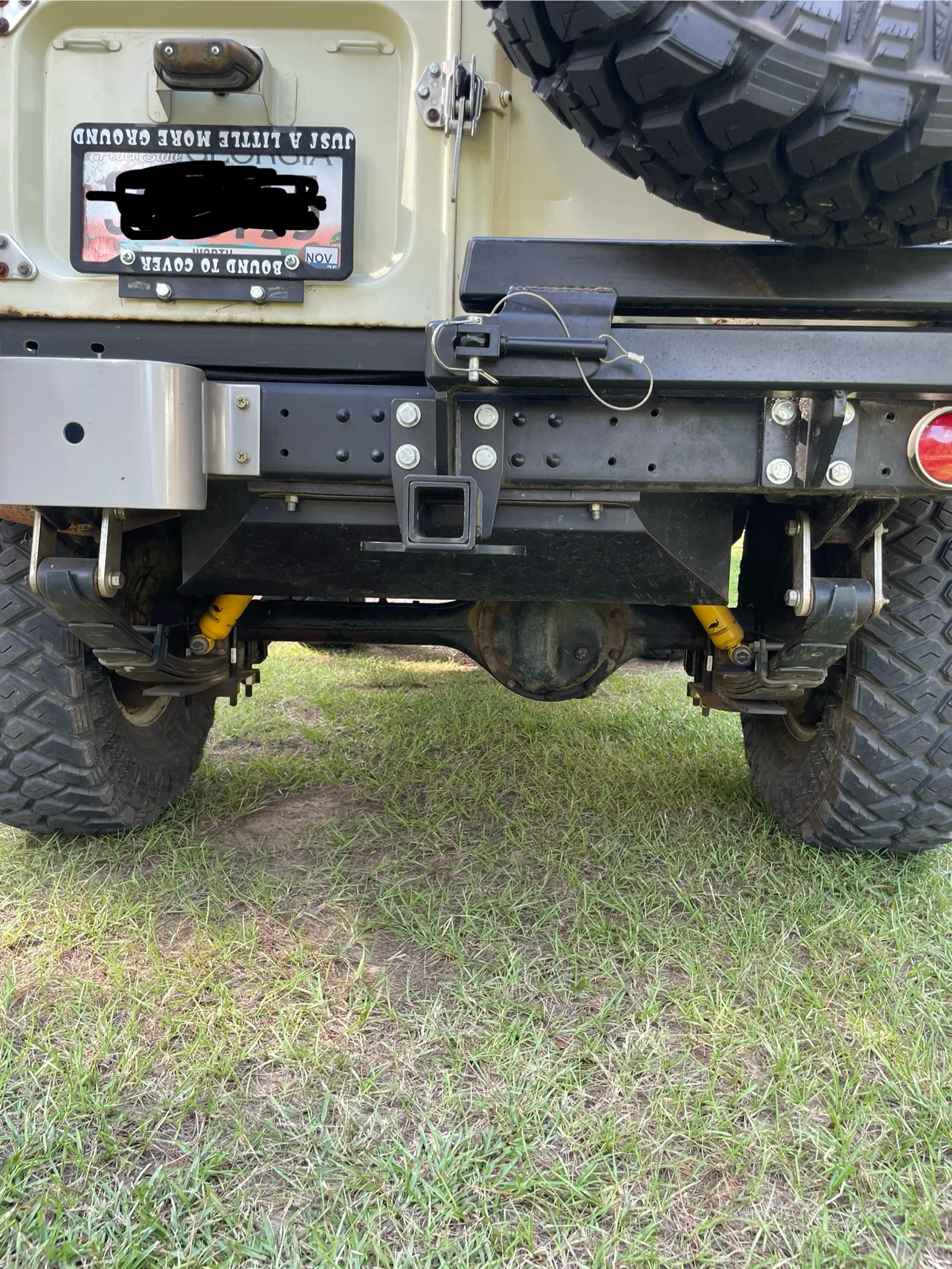

I was curious about what to do about leveling my ‘72 that has a shackle reversal. PO had put an OME 2” lift on the rear to level it out. Now it has a significant rake towards the front. I’m mainly concerned with the front DS putting a back load on the TC since the spring extends backwards when compressed with the SR setup.
Would a longer front shackle make it worse or would a front lift spring be the best solution. Also would think a caster shim would help with the steering so would add that too.
I like the way it rides compared to my ‘75 with Dobinsons and the ims shocks.
You might try a stock length in the rear.
Ideally I would like to just use a longer shackle in the front since that would be simple and less expensive option. I’m not sure how that might affect the risk to the transfer case as the front springs compress with longer shackles on a reversal setup. That’s my main concern. The rear springs were recently added so would like to keep those.
This is home made shackle reversal, the way it is you probably have alot of positive caster, maybe too much , to correct this you can ad a spacer between the front frame horn and spring hanger, or you can remove the shackle hanger and mount the shackle through the frame , this will make the spring more horizontal , than a 2" lift spring in the front will be about level to the rear
