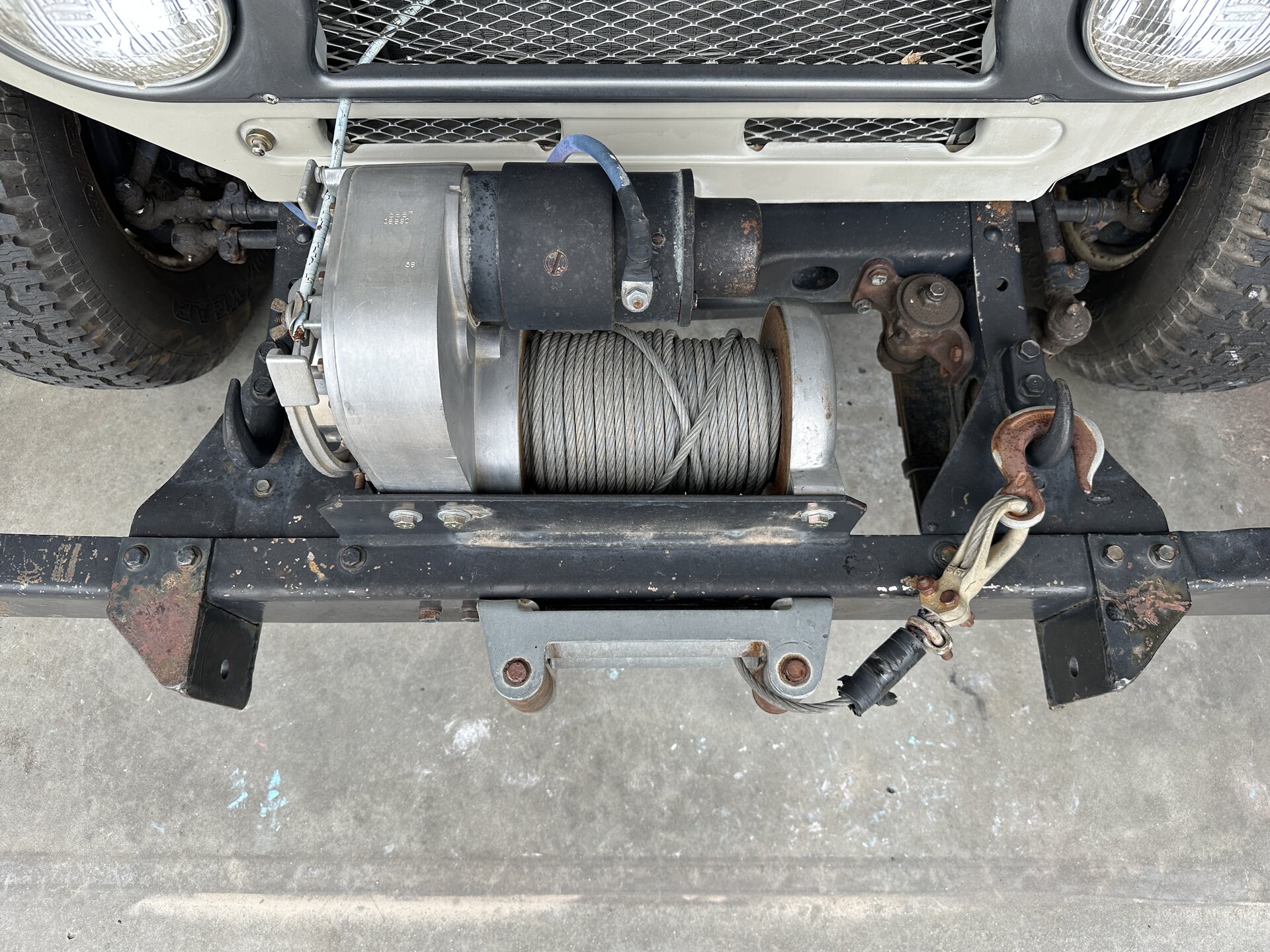

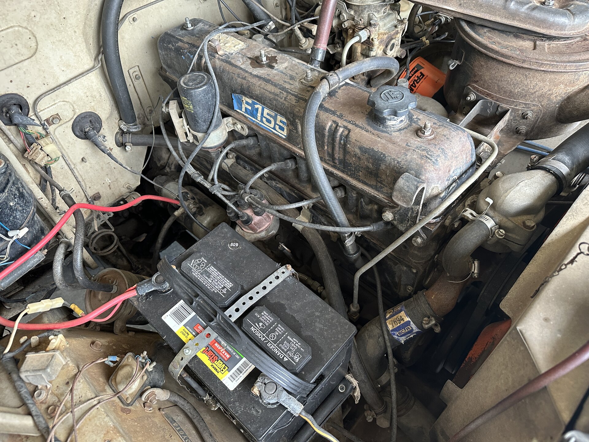

I’ve loved FJ40’s as long as I can remember (who hasn’t?). I‘ve always been a Toyota enthusiast and have owned many Toyota’s but this is my first 40. After searching throughout the western U.S., this 40 popped up 3 hours away. The owner had passed away recently, so his son was trying to sell it for his mom. The original owner purchased it new off the lot in 1972 and had the dealer add the winch and radio. Unfortunately the radio is no longer there. The original owner had previously had rust repaired with new metal and paint so the body is in great condition. Mechanically, the engine seems in good shape but that will get inspected next week.

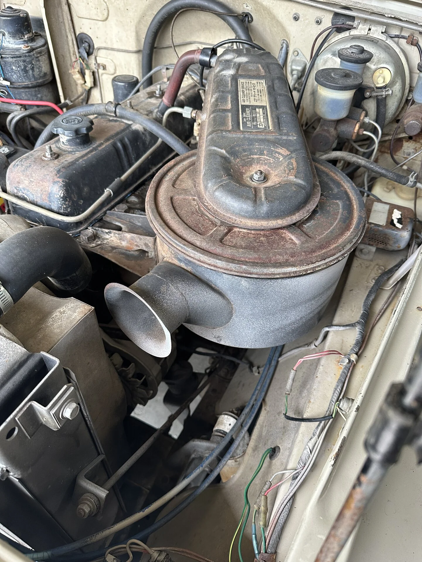

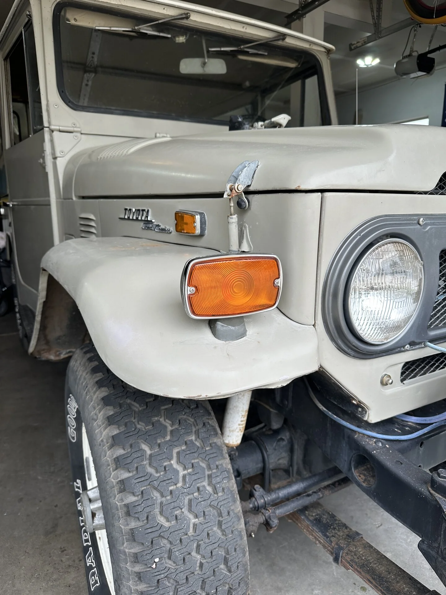

I’m finding a couple of leaks on my garage floor. I’m sure I’ll hear about that next week. My biggest issue right now is the steering. I’m actually a little worried about driving it 30 minutes away to the mechanic. The steering wheel has a lot of play in it and it seems to wander on the road. I’ve tried adjusting the steering box but it didn’t make a difference. I’ve since purchased some new 555 TRE’s. Any suggestions on tightening up the steering would be awesome.
I have a laundry list of “wants” for the 40, but mechanical inspection will come first and then we’ll see what I can do next. As with other build threads, I plan on documenting my progress here. Thanks for checking it out!

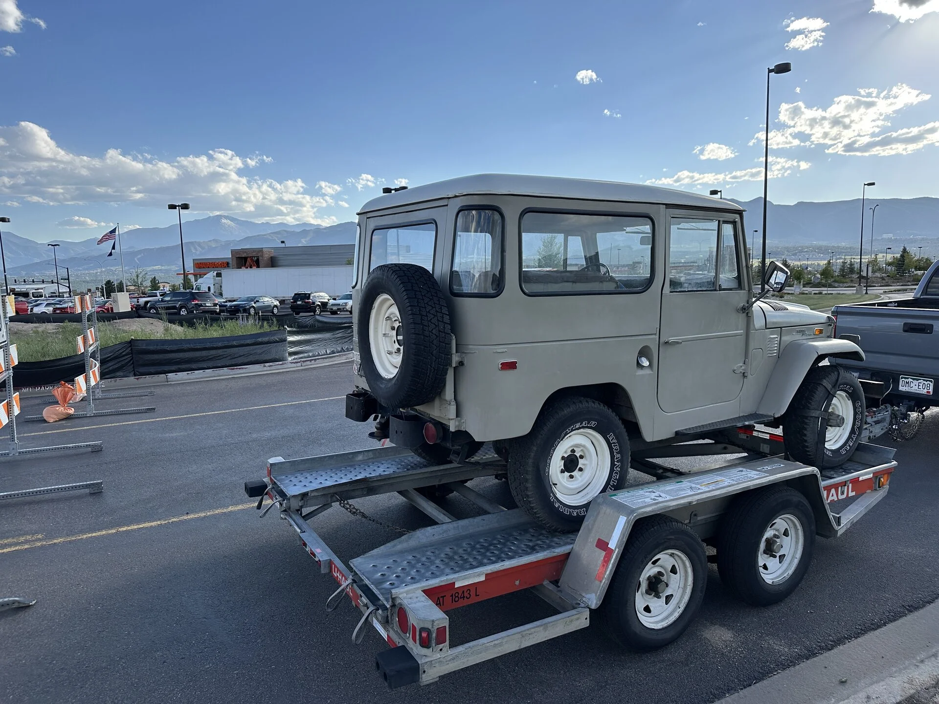

Me and the son of the original owner after loading it up on the trailer
Checking out my new FJ in the rearview of my Tundra
A quick stop at Whataburger in Colorado Springs. Hey Whataburger - please add a location in Northern Colorado. Thanks!
It was dark when I got home and I had barely gotten out of my truck before the first person stopped to chat with me about it. He has an 80 series and was telling me about his regrets selling his 75 40. I was getting eaten alive by mosquitos so we agreed to talk Land Cruisers later at his place down the street.

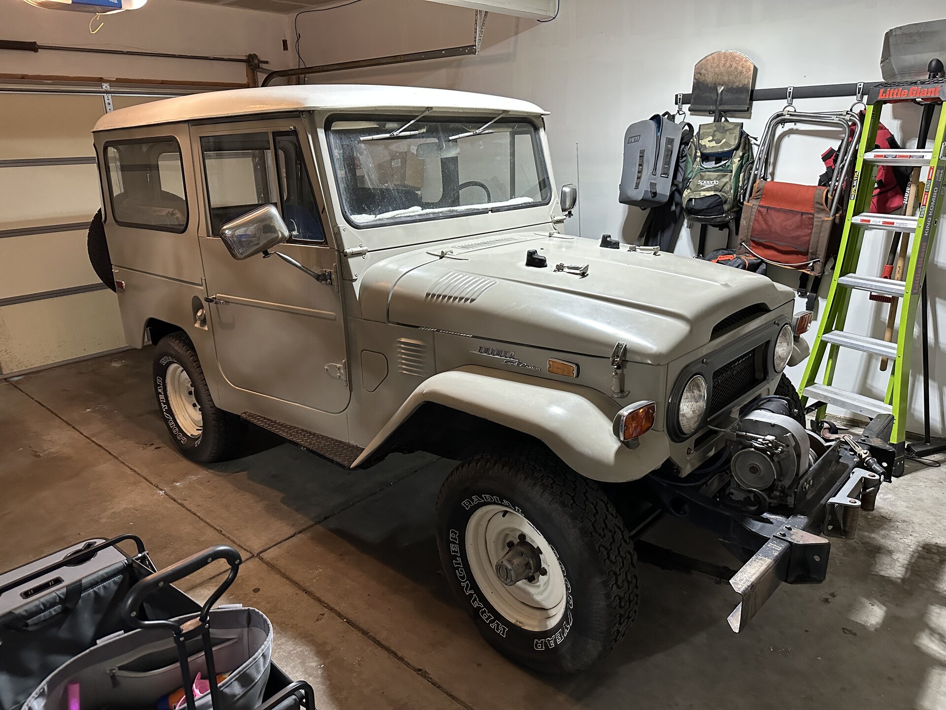

After a long day, the 40 was resting in my garage

Nice find, looks very solid and original. I would start by having someone shake the steering wheel back and forth while you're looking at the tre's, the center link for wobbling. The tie rods will rotate and that's normal. Look at the ends. Also look at the spring bushings, and Ubolts. Jack up the frt end and see if the wheel bearings are loose. Also check the trunion bearings at the knuckles.

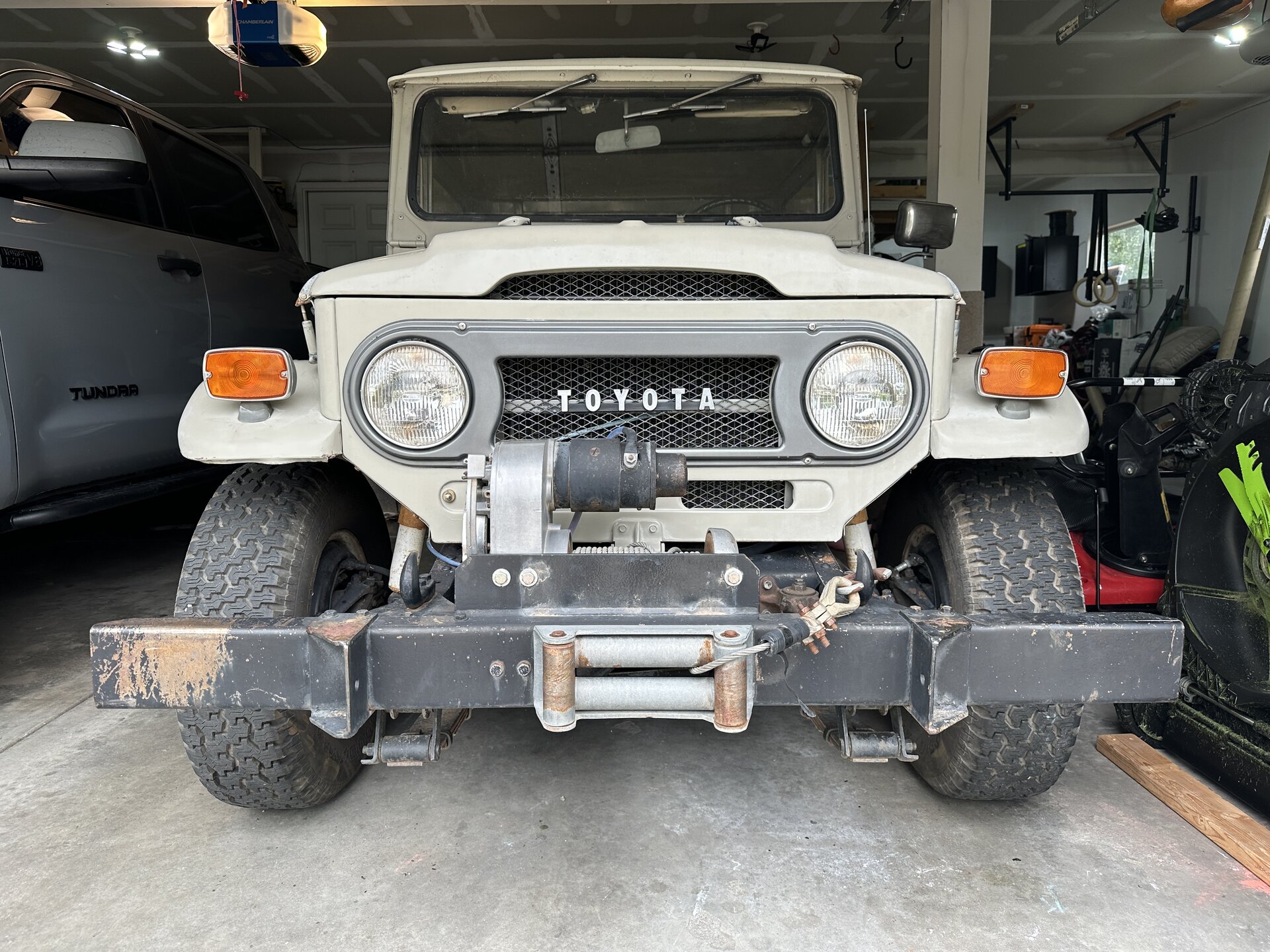

Much better. Gotta make sure my neighbor doesn’t call it a Jeep again.
Tighten the steering gear box adjuster (off the ground and check for binding from lock to lock) and then adjust the center arm (loosen top bolt, tighten nut down snug then back off 1/4 turn), aside from tie rods that’s just about all there is to tighten up. That said wheel bearings and trunion bearings are the only other sources of slop.
One thing to live by on these FJ40’s, never ever throw any of the old original parts that you replace away!!! Put them in a box, a crate, somewhere in marked bags. Nearly everything on these rigs has value and you never know what you might want later.
Looks to be a ‘71 or ‘72. Working on the steering box will be trickier than some might suggest. The bolt on the side of the box is NOT an adjuster; it is a stop which can only be reset after the box is disassembled and the internal shims reset.
