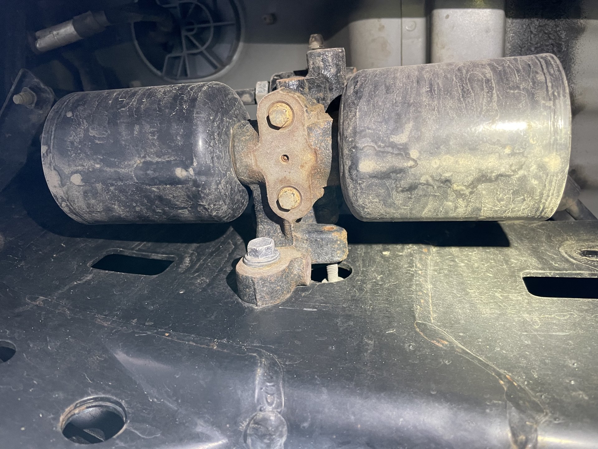

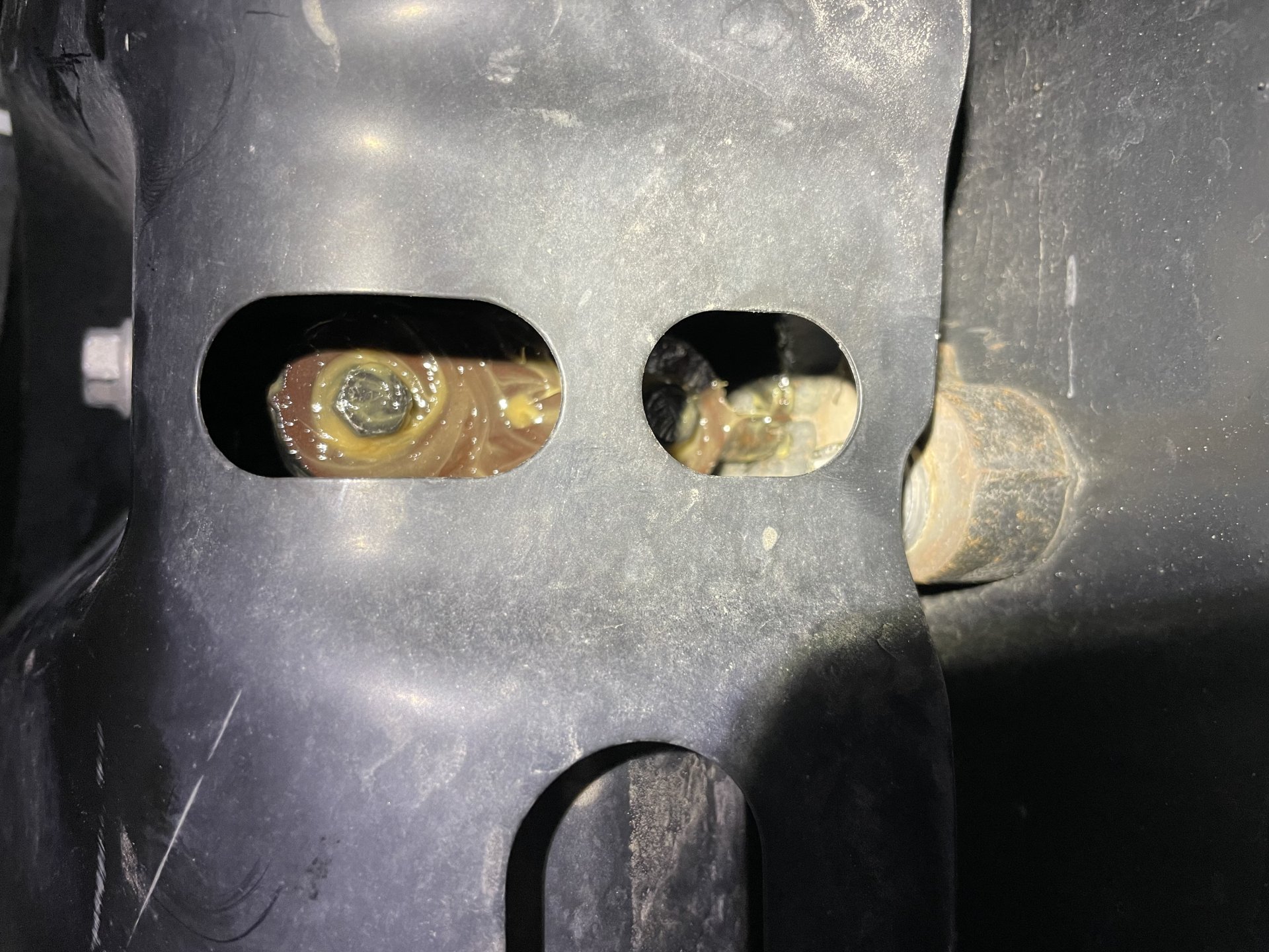

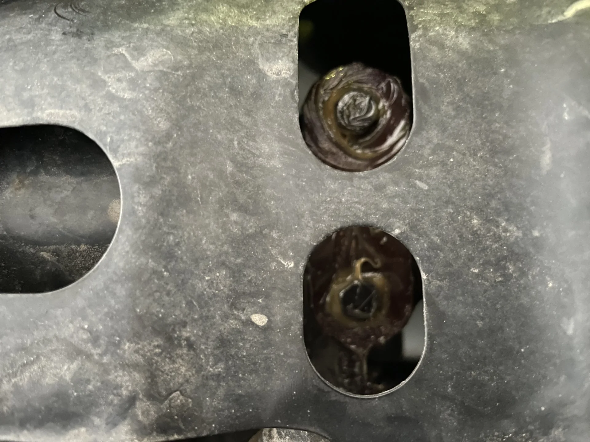

Couple of CO winters and ours doesn't look bad. Wire brushed and marine greased today. Will probably do that every fall and keep an eye on it.

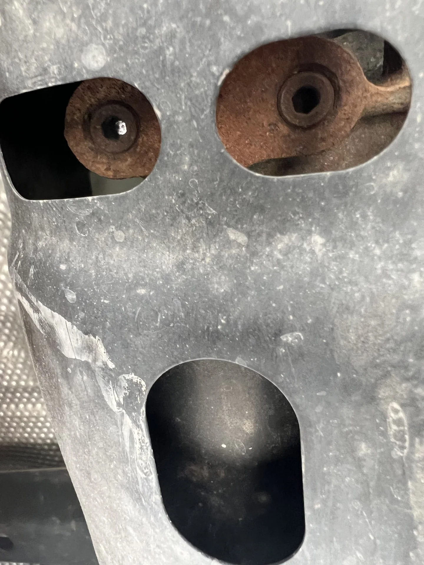

Hex head bolts? Did some MYs come that way or were there replaced?
Somewhere in 2018. Seems to be phased in at different dates at the two factories as IIRC there was evidence of various build dates not being a hard cut off.
Taco said the larger external hex is actually worse about corrosion than the small internal
I don't think they were replaced.
I would think if they were really rusted the hex head would be easier to get out after using penetrating oil. IDK, maybe it would break the head off… Regardless, still surprised Mr T would implement this material.
Yeah I think he said the flats corrode away completely.. whereas the internal hex is somewhat out of the spray so past the end the flats remain.

Fluid film or waxoil once a year then find something else to worry about :)

If it were me, I’d try to see if they move. Just 1/2 a turn. Then I’d grease them up, then tighten them back up. I just do this once a year.
For me…why mess with it if it ain’t broken?! Will it change what you do if it does move? If it does not? No. So why mess with it?
In my mind, cycling them a little every now and again increases the likelihood hood they stay unfrozen for when I do need to open them. I’ll probably never be done tweaking my suspension so that’s important to me. I also like getting a little grease or anti-seize or whatever on part of the threads before I tighten it up. It just gives me peace of mind that’s the only real reason.
