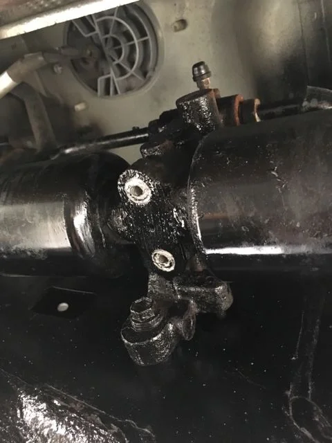

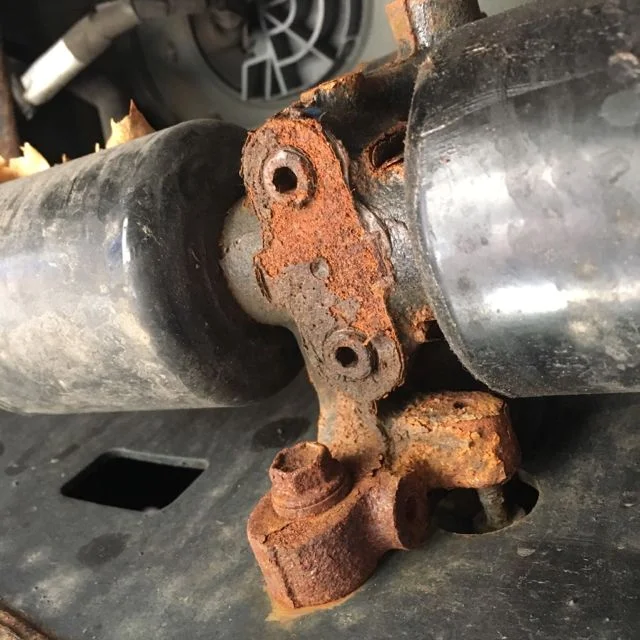

Guys please take a look at your KDSS valve and give it a coating of grease. I had mine replaced under warranty because it was frozen and the replacement looks like this at 12 months old.
I took the wire brush to it and gave it a good coating of Yamaha marine grease. Applied grease with the valves open and worked it in and out never going out more than 3 turns. Don't think it will be an issue forward.

I did the same to mine as well. Opened valves, sprayed PB Blaster, waited 10 minutes, worked the valves open and closed a few times (never opening more than 3 rotations), coated liberally with grease, and then closed the valves shut, making sure not to over torque them.

This part is raw iron from the factory. Mine was frozen shut and I was replaced under warranty. Almost $2500.
I suggest you remove the cover, fire brush it and back off the set screws 3 turns and coat liberally with anti seize or your favorite lube.
here is what it looked like a year after being replaced and again after I tended to it today.

So... For those of us without rusted KDSS systems... What would be a good way to protect it when heading toward salted-street areas? Winding if instead of slathering gooey grease onto it...if something like a light coat of Rustoleum paint primer (rattle can) could work. Wondering if that might form a protective layer still thin enough to turn...
I unscrew mine 3 turns (NO MORE!!). I coat with anti seize and turn it back in.
Wire brush any loose rust, prime, and then paint. I check it every time I grease driveshafts.
