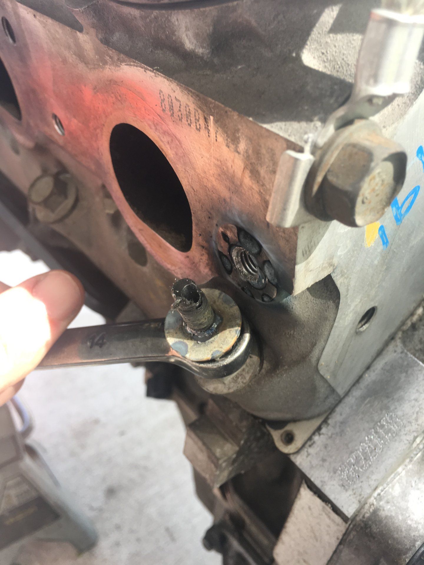

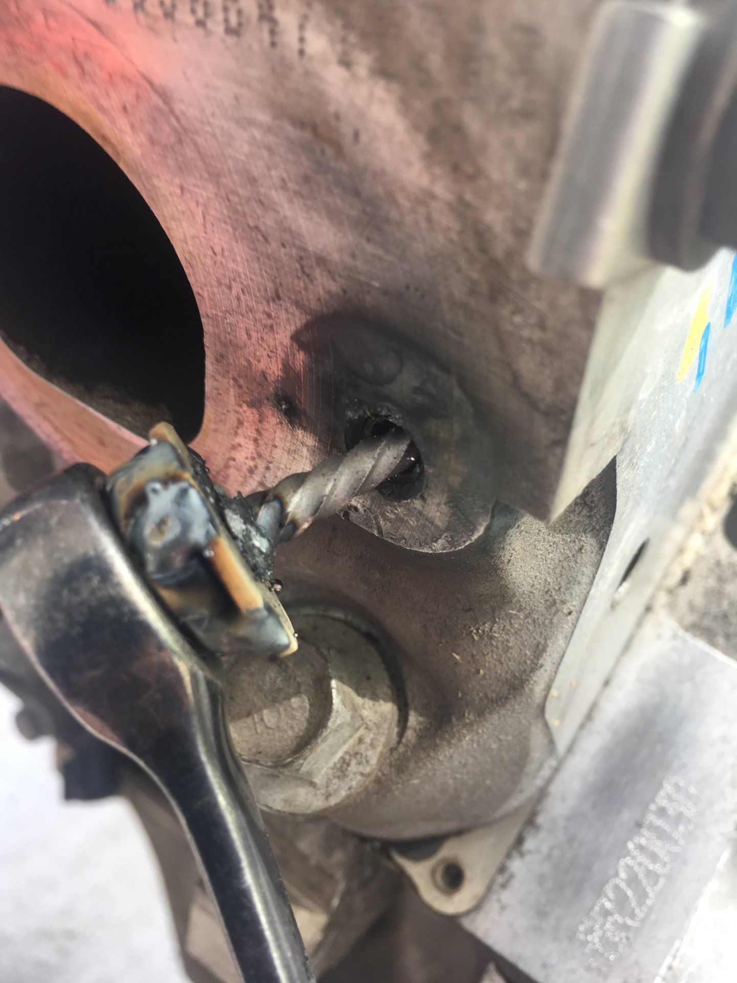

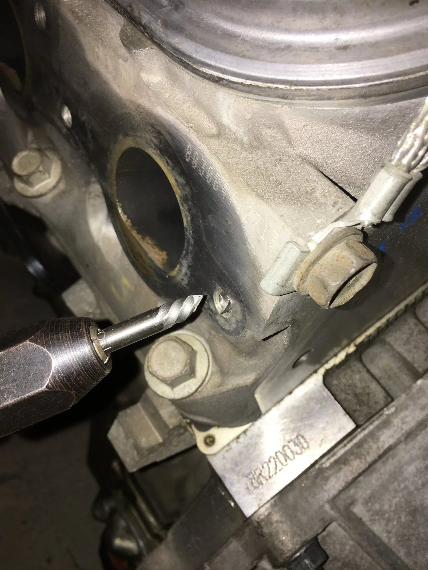

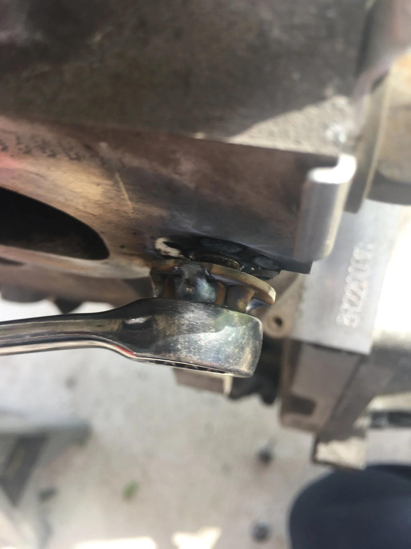

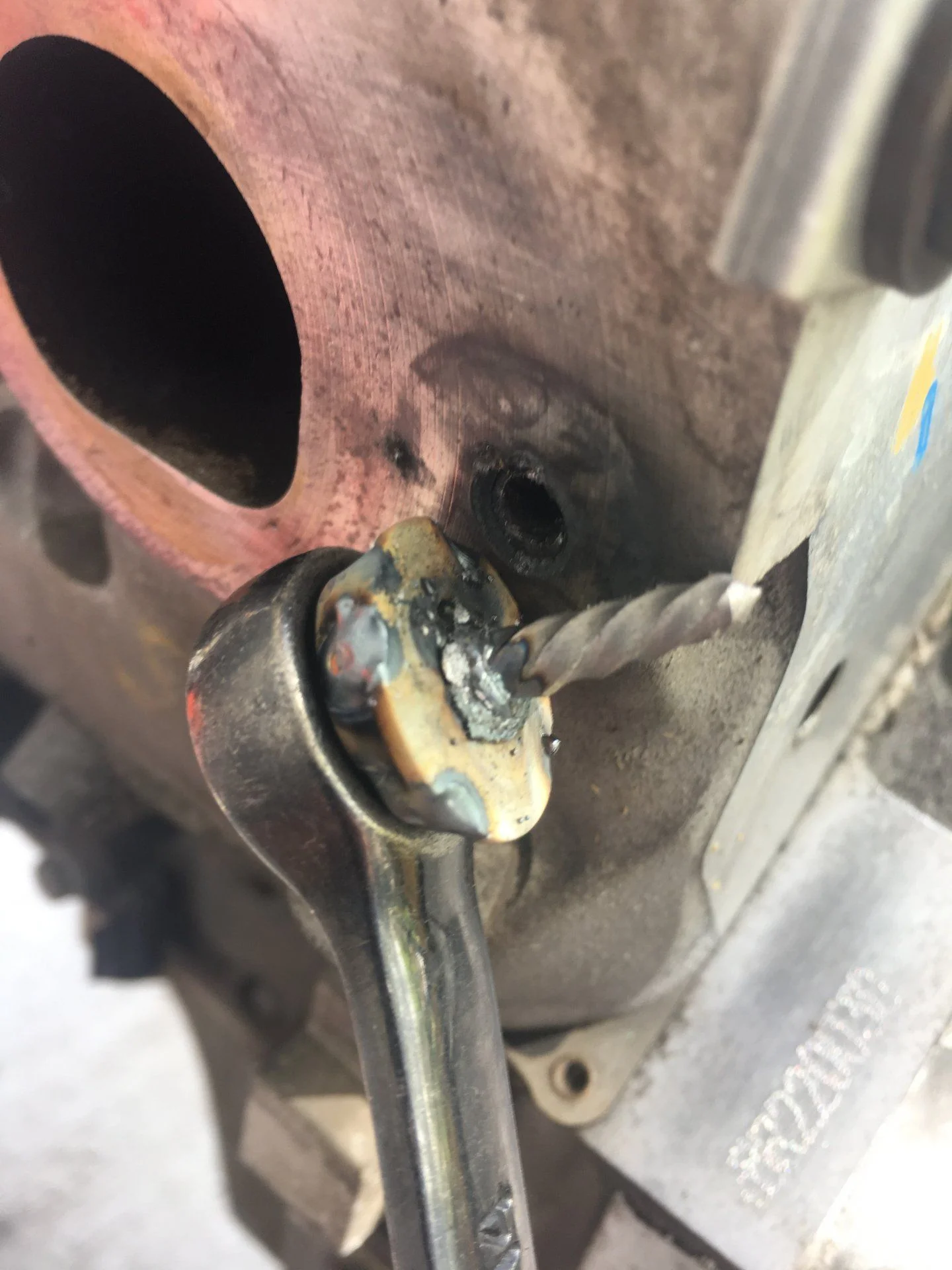

Realized this conversation might be more useful with some photos. This was the broken exhaust bolt on the L92 I put in my 80, with a bolt extractor snapped off in the middle for good measure. The extractor snapped after putting a lot of torque on it.. but after welding the remnants of the bolt spun out like it had just been threaded in with anti-seize. Because it was flush with the side of the head I welded a washer on to the parts then a nut onto that.
