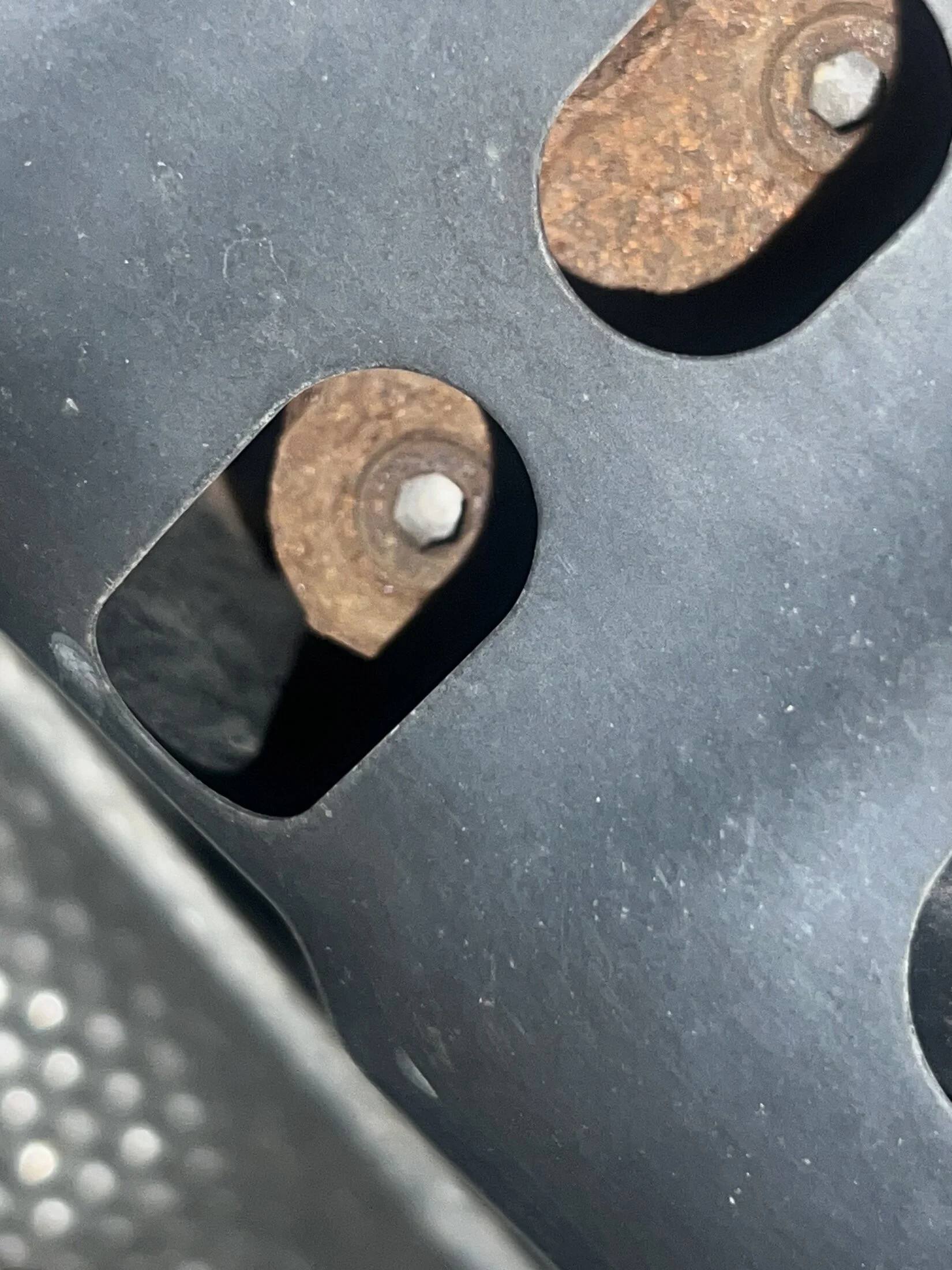

Is this kdss rust?
Yes it is.
I would wire brush them, and then crack them 1/2 turn and 1/2 turn back to closed position.
Then coat with water proof grease.
That’s what I figured. Thanks!
I would hit them with penetrating oil a day or so a head of time if possible.
